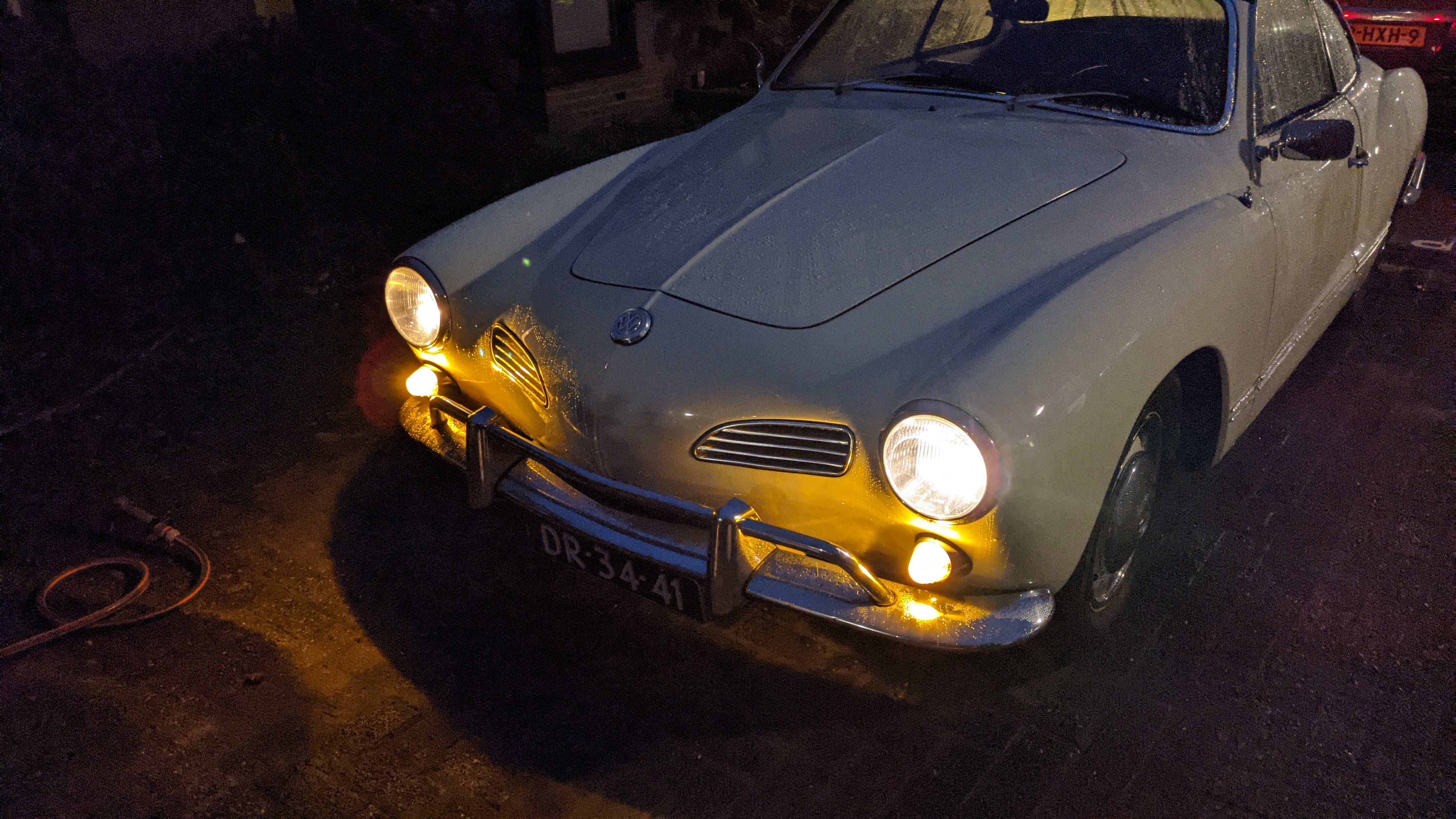

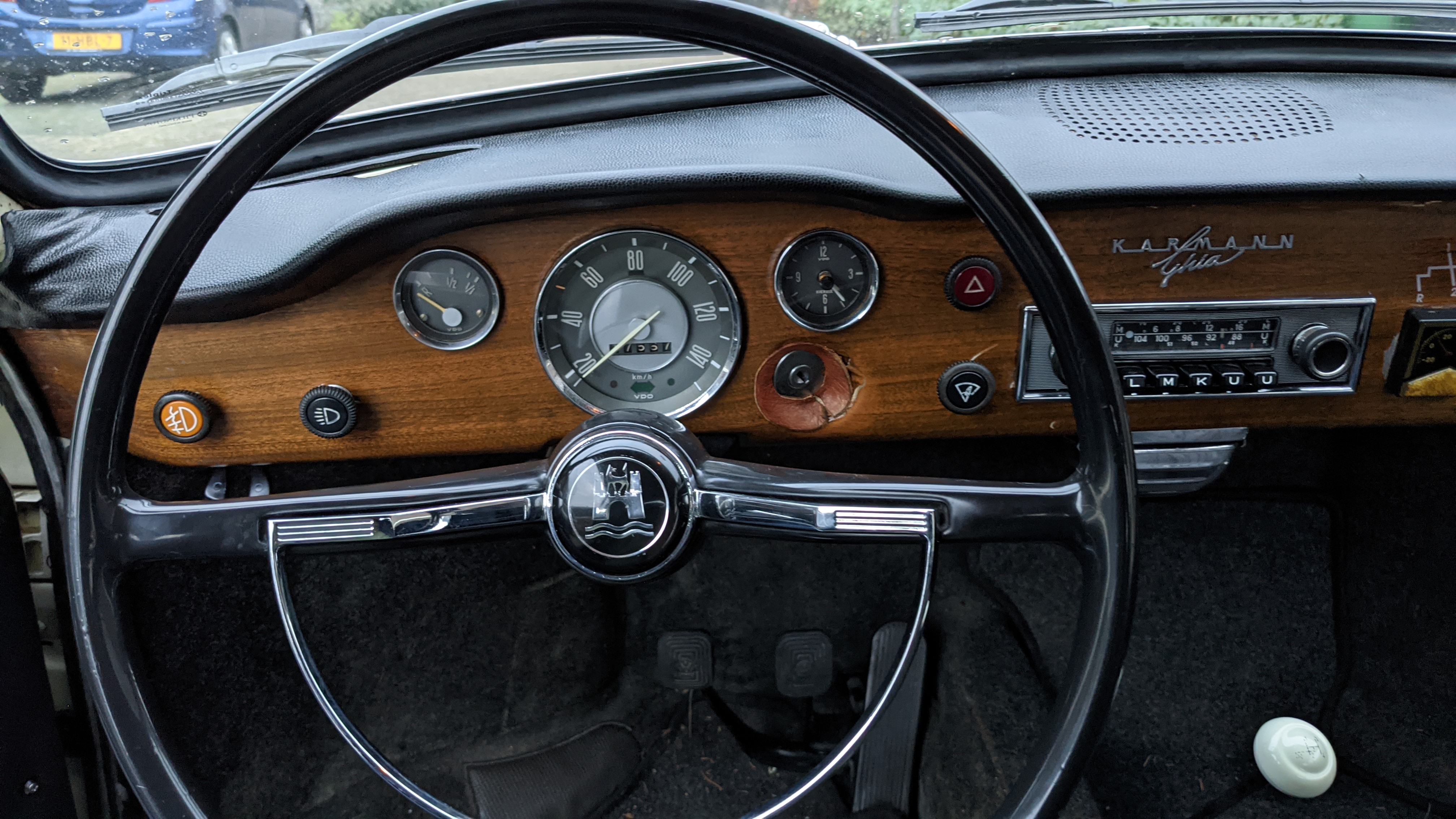

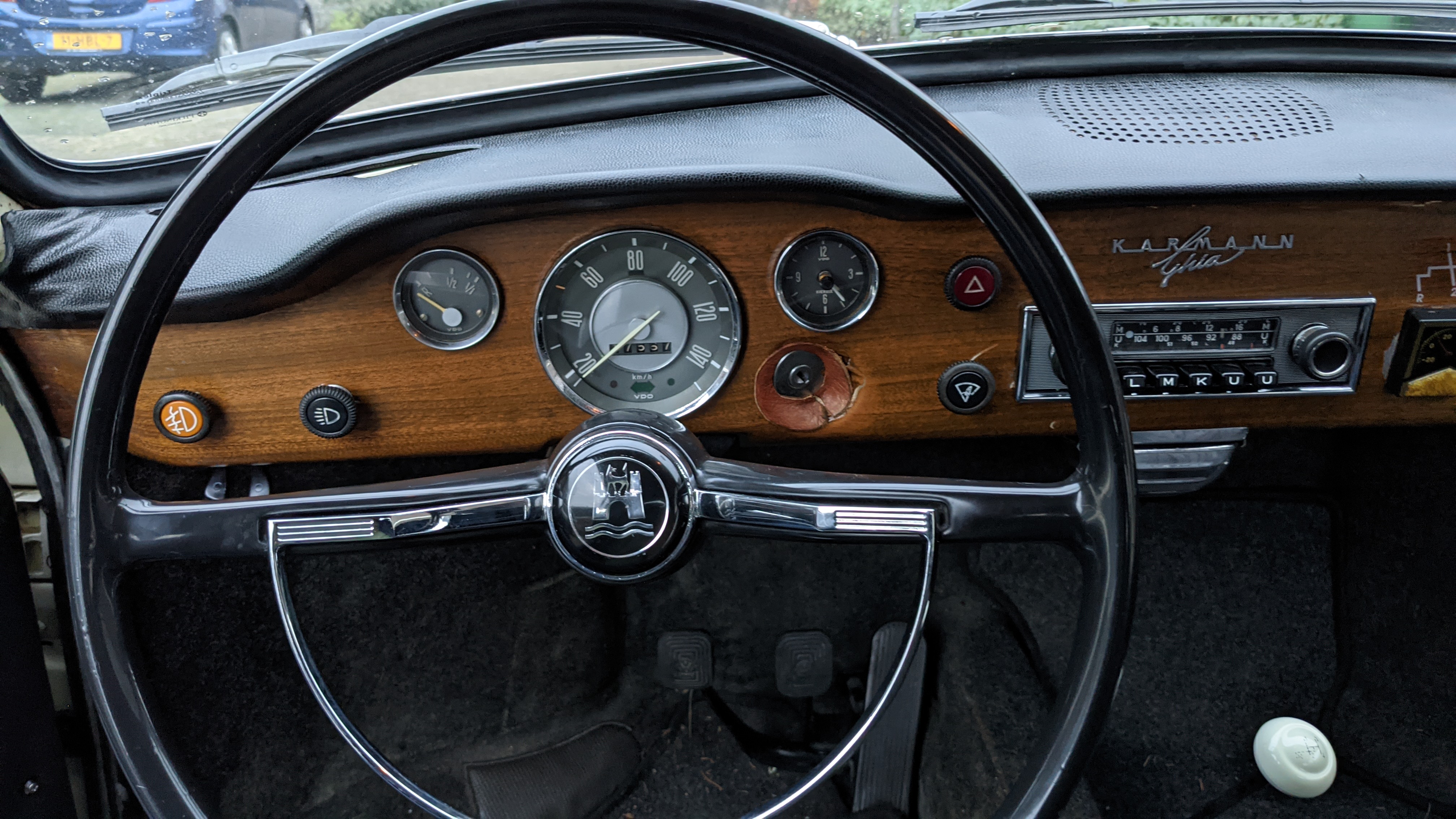

- T5 blue LED in the high beam indicator
2020-12-02 17.18.05.jpg (3.42 MiB) Viewed 17602 times
2020-11-27 16.30.58.jpg (2.56 MiB) Viewed 17602 times

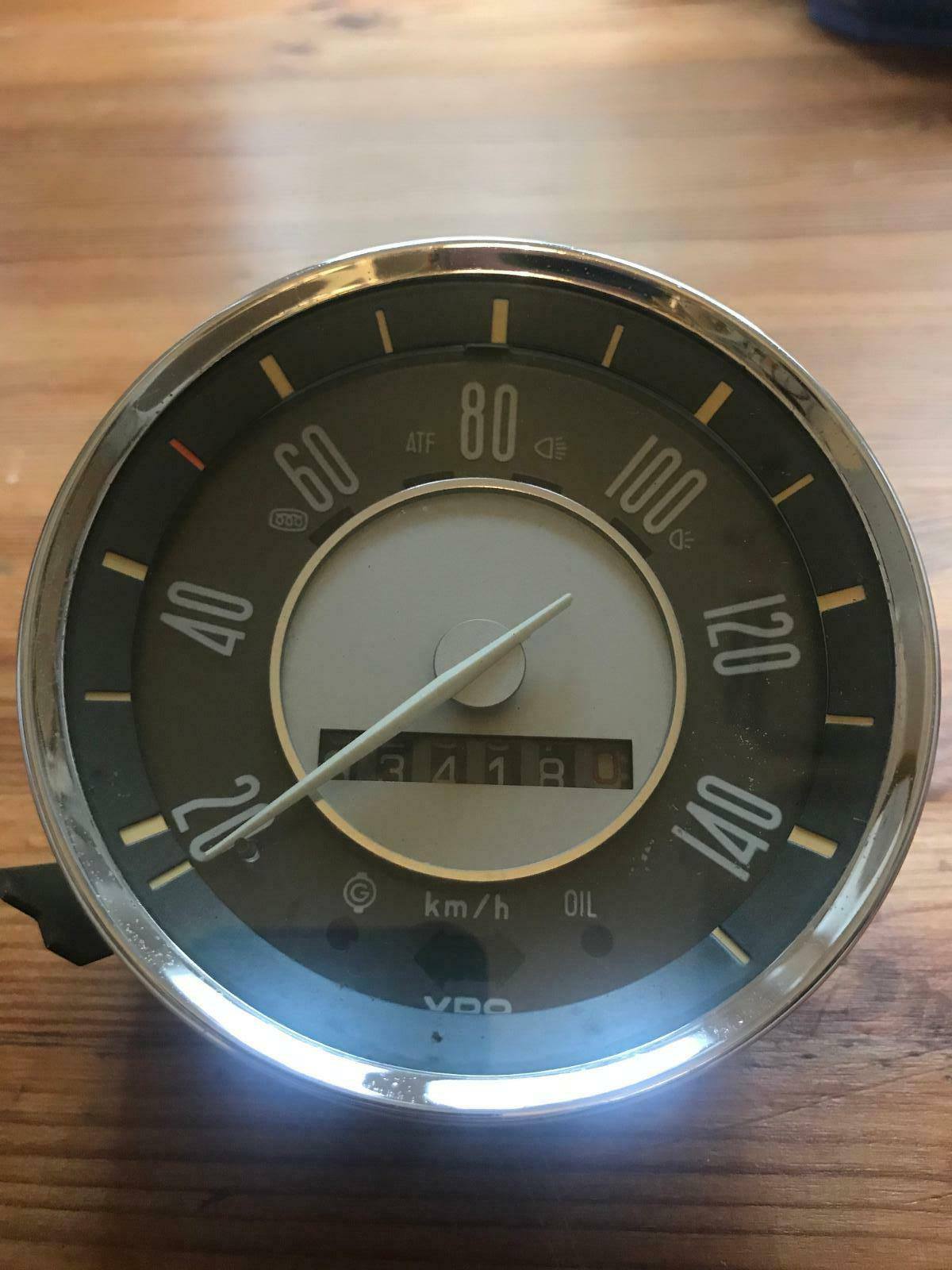

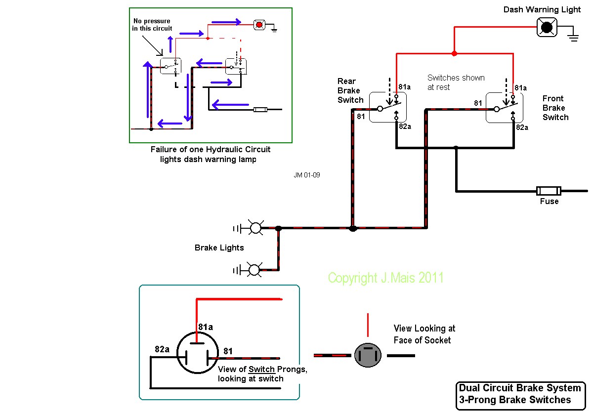

Some mods upcoming:
- Other instrument cluster with warning light for low beam, heated rear window and ATF temperature

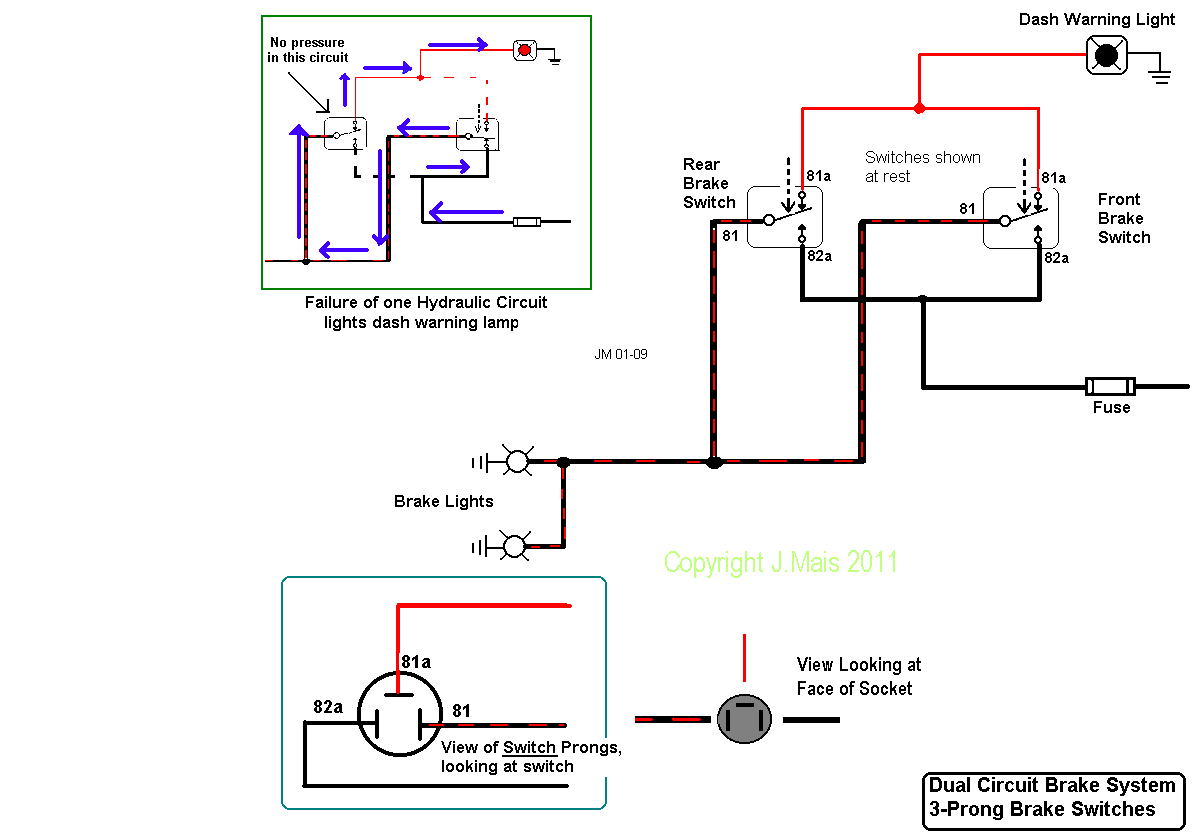

- Brake circuit warning light (will use ATF temp light for this)
Next job is to change the brake light switches from 2-pin to 3-pin versions and I'll be doing that on friday.
Will also add a nice rubber 'hat' to cover the connectors.

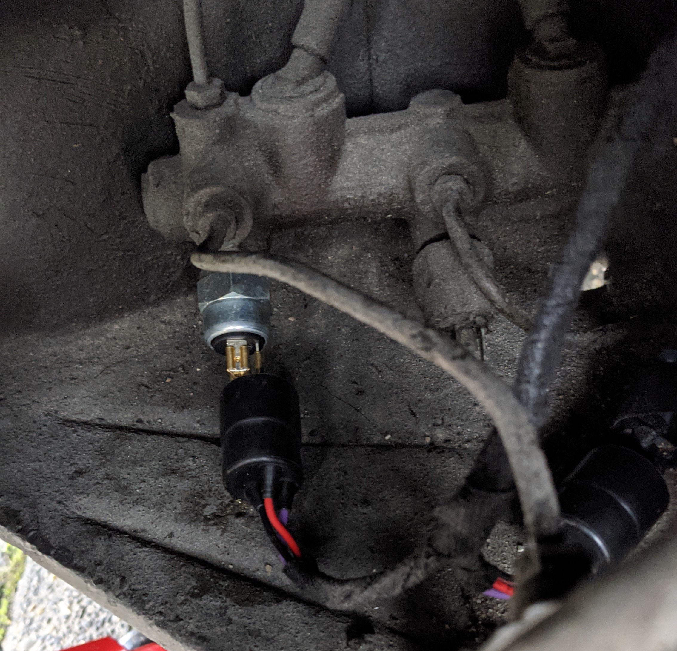

The rubber hat is nothing too special:
It will be an extra protection over the brake light switches as shown here:
2020-11-25 10.53.19.jpg (1.32 MiB) Viewed 17581 times
Now they are in the wheel well and very exposed to water, dirt, sand and other stuff you drive through. Not very nice

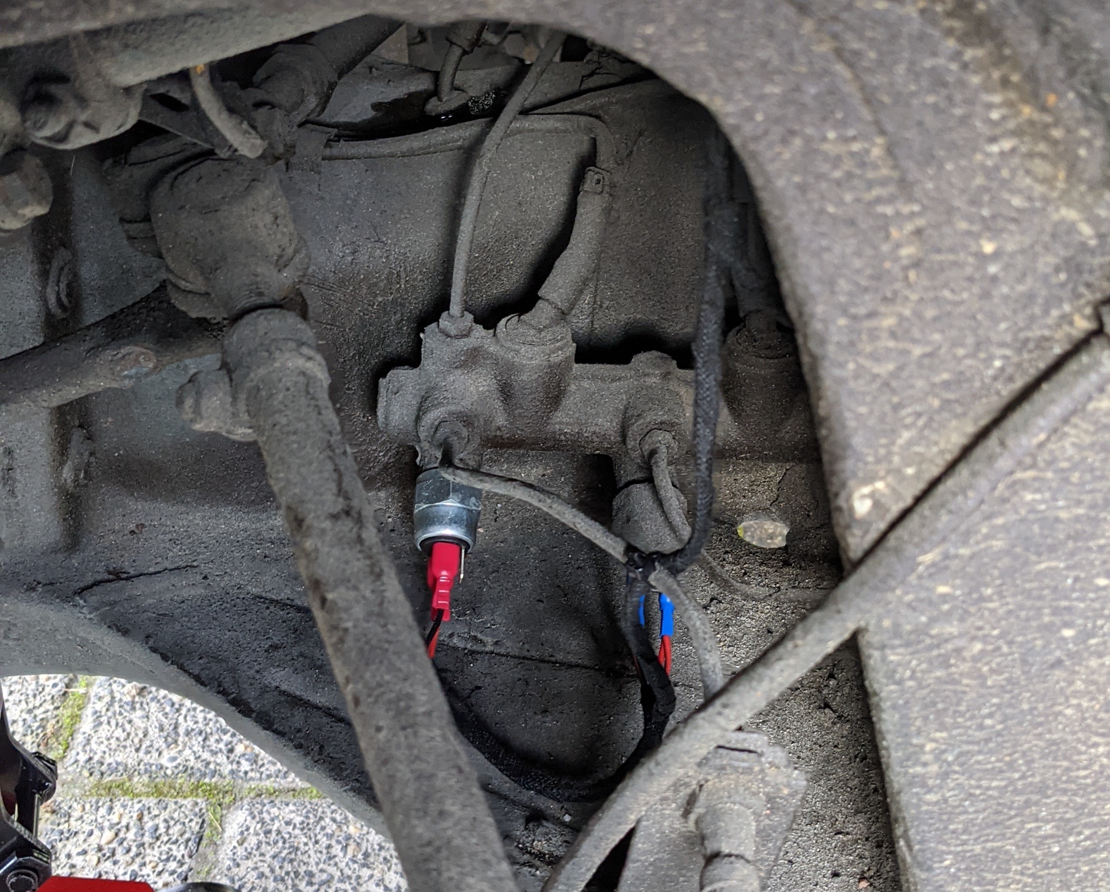

Re: iichels 1967 VW Karmann Ghia 1500 Coupé

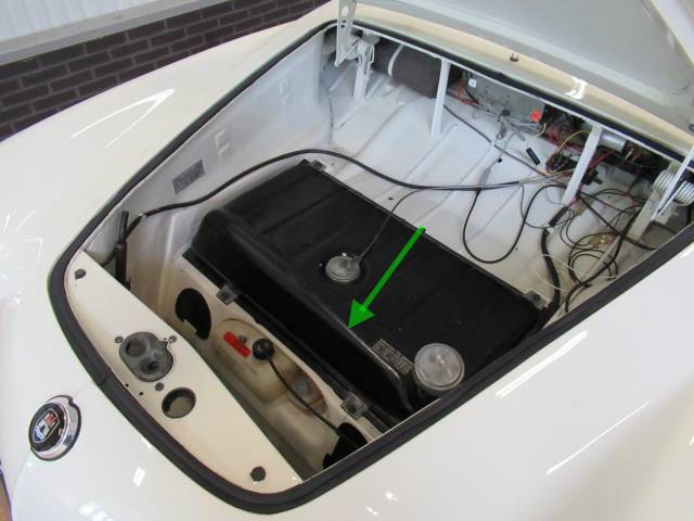

You will also have to find a solution for the oil leak seen in the upper part of the image ... :?:
No haha that's WD40 that I'm using to get rid of the brownish substance that's covering the inner paintwork.
Look on the first picture here on the right --> viewtopic.php?p=577943#p577943
It's now all gone, using WD40 and a toothbrush (no joke).
I took the time to install the rubber boot for the brake light switches already
2020-12-03 10.40.23.jpg (1.51 MiB) Viewed 17574 times
OEM number 311 945 521 A
The cause of death of the previous switches was water ingress and when the membrane tears, it can leak too. Better keep it nice and tidy in there!
Well done!👍 It is a significant improvement, it looks better with the rubber hats.
However I was referring to this oil leak, which is generating a layer of crust and dirt all around.
Yes, we're talking about the same leak haha.
I already dipped it dry, it smells like WD40. It will leak from the luggage compartment to below the fuel tank, driven by gravity.
The hose you're (almost) circling is the fuel line from the fuel tank to the rear of the car (it goes through the central tunnel of the car).
ah ... ok, haha, sorry. :lol:
With the enlarged image I understand it better ... :wink:
