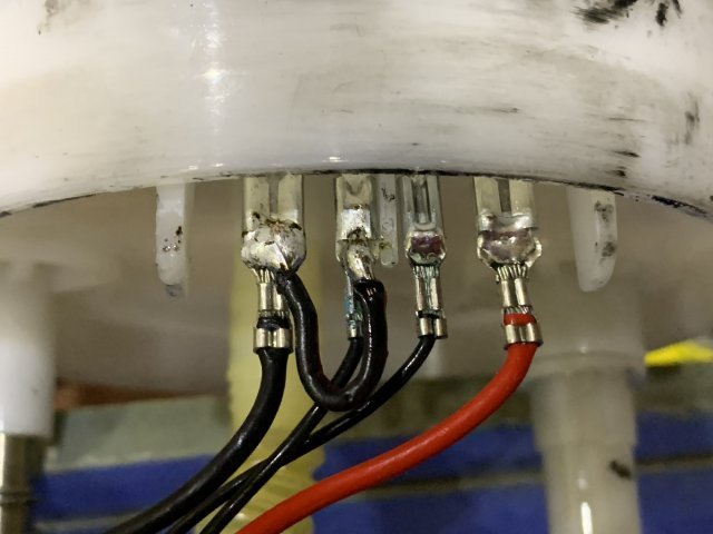

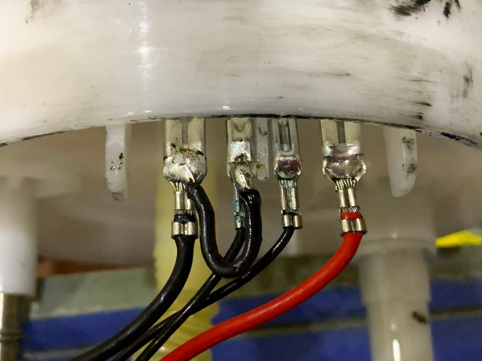

Re: Fuel tank indicating empty when there is plenty of fuel in the tank.
I know this is an old thread, but I thought I'd post my solution to this problem.
I tested the sender earth at the fuel pump plug, and it measured approx 53 ohms to a good body earth. So this meant whatever the sender resistance (between about 70 ohms empty and 300 ohms full), the wiring circuit was adding 53 ohms, meaning the gauge was always reading a lot higher than it should.
I remembered reading this thread, so I didn't bother trying to trace the sender wiring. The pump earth measured virtually zero ohms to a good body earth, so I removed the pump and bridged the pump earth to the sender earth with a small soldered link, as per the photo. The pump earth is a fatter cable than the sender earth, and since the sender circuit only carries a couple of hundred milliamps at most, I figured the pump earth could cope with that extra current. The gauge now properly reflects the float level when tested out of the car.
I left a little note on the pump cover plate, so that the next person who has to change the pump knows about this mod, and knows that there's still an unresolved problem with the sender earth wire in the vehicle loom.
