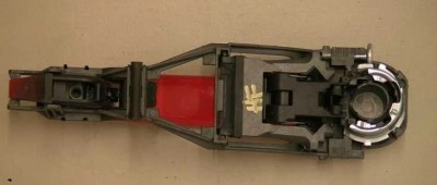

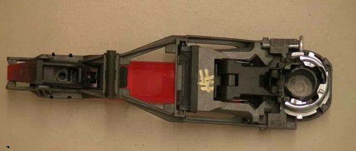

Cause = A little investigation and I've discovered that the T20 bolt that you can access from the edge of the door has been replaced by a pointless small headed bolt (by some idiot before me !) and so the collar around the lock barrel never spins to retain the actual lock (If you look at the attached image, you can see the bolt in question to the top right).

The screw head rotates the barrel locking ring, seen in the OP picture in silver it’s like a C shape
Prone to falling out and landing in the bottom of the door if undone too far

As CarbonChaos says, it’s the T20 screw seen top right in original photo that turns the silver locking ring (silver C shape in top image). If you remove the rubber bung in the side of the door, shine a torch in you be able to see the screw (or lack there of I suspect).
