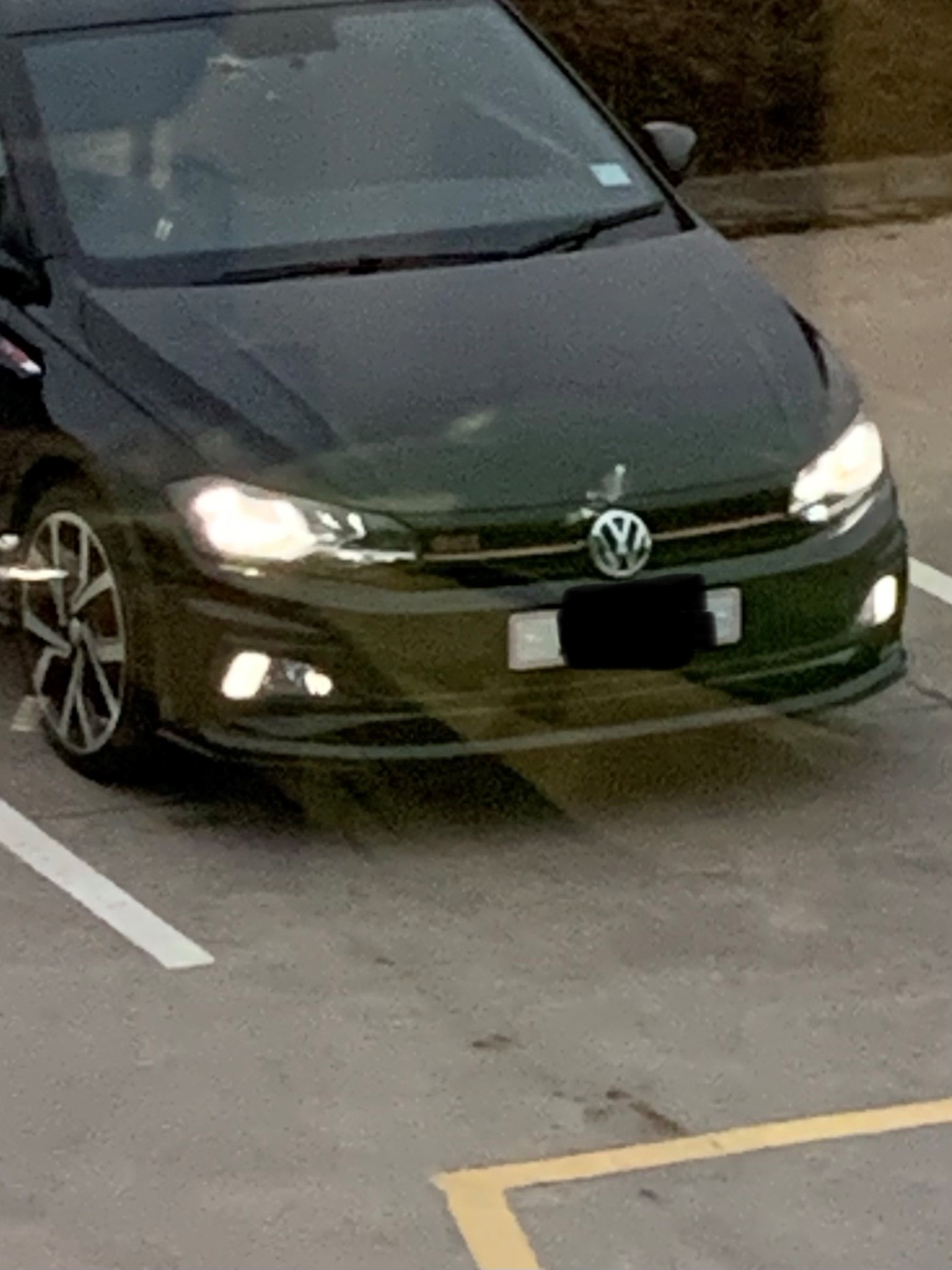

Andy Beats
Posts: 2012
Location: aberdeen
Re: Front DRL LED light temperature
Post by Andy Beats »
Taken from office window so the quality is crap, but you can hopefully see the match is great.
You'd be forgiven for thinking my headlights are LED as well now.
6666
Posts: 22
Joined: Mon Aug 10, 2020 3:37 pm
Drives: Polo Mk. 10 95PS
Location: Dublin, Ireland
Post by 6666 »
Andy Beats wrote: Tue Mar 02, 2021 5:59 pm Taken from office window so the quality is crap, but you can hopefully see the match is great.
Mate that's perfect thanks so much, were they difficult to install?
also fair play for unlocking your car out the window for a photo lol

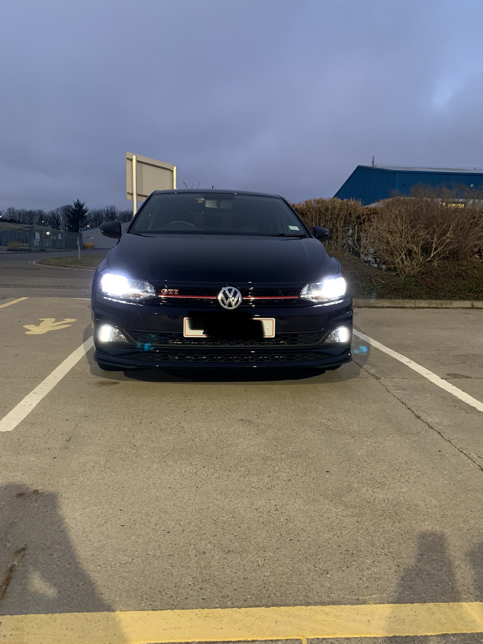

Andy Beats
Posts: 2012
Location: aberdeen
nice2seau wrote: Mon Mar 08, 2021 6:34 pm
Do you reckon it would void my warranty?
I've had two replacement headlight under warranty, as they keep misting up.
The dealer has swapped over the 'illegal' bulbs as part of the process, so i guess they either don't notice or don't care.
