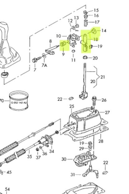

My polo 6n2 2001 has a really sloppy gearstick, the car is in good condition and only 60000miles so kinda feel it's worth spending some money on. Problem is I cannot find the parts. The problem is at the base of the gear stick, instead of a ball it has a double pivot. The top joint where the pin pivots though the gear lever has loads of play. Can i buy this part, I was thinking maybe fitting some brass bushes in it but as it's just plastic don't think they will press in without breaking it. Any help greatly appreciated as I cannot find this part anywhere, or even a part number for it. I see that polo's swapped over to the ball type stick after this model is this because it was a problem?

Highlighted are the worn parts.
