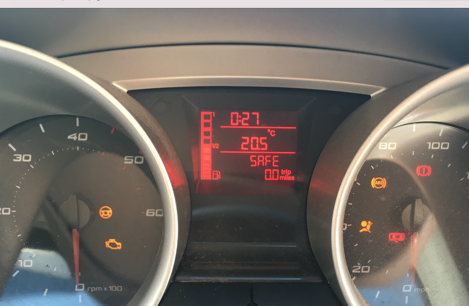

Previous to that I had an annoying fault where when I turned the engine off the dashboard would light up like a christmas tree and beep with the word SAFE displayed.

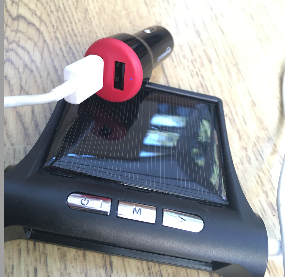

It was then that I thought that my Tyre Pressure Indicator plugged into the 12v cigarette lighter socket could be the problem, it had the ability to charge the internal battery using a solar panel mounted on the top of the case.
This would be highly improbable as both the USB charger and Tyre Pressure Indicator would need to allow a current to flow in reverse.

So with the fault present I unplug the Tyre Pressure Indicator and the fault cleared.
When I measured the voltgae from the Tyre Pressure Indicator at the USB connector it was 4.5 volts and Cigarette lighter plug.
What was happening was the solar panel in the Tyre Pressure Indicator was charging the internal battery to a level high enough yo trigger the BCM into thinking that the ignition was on.
