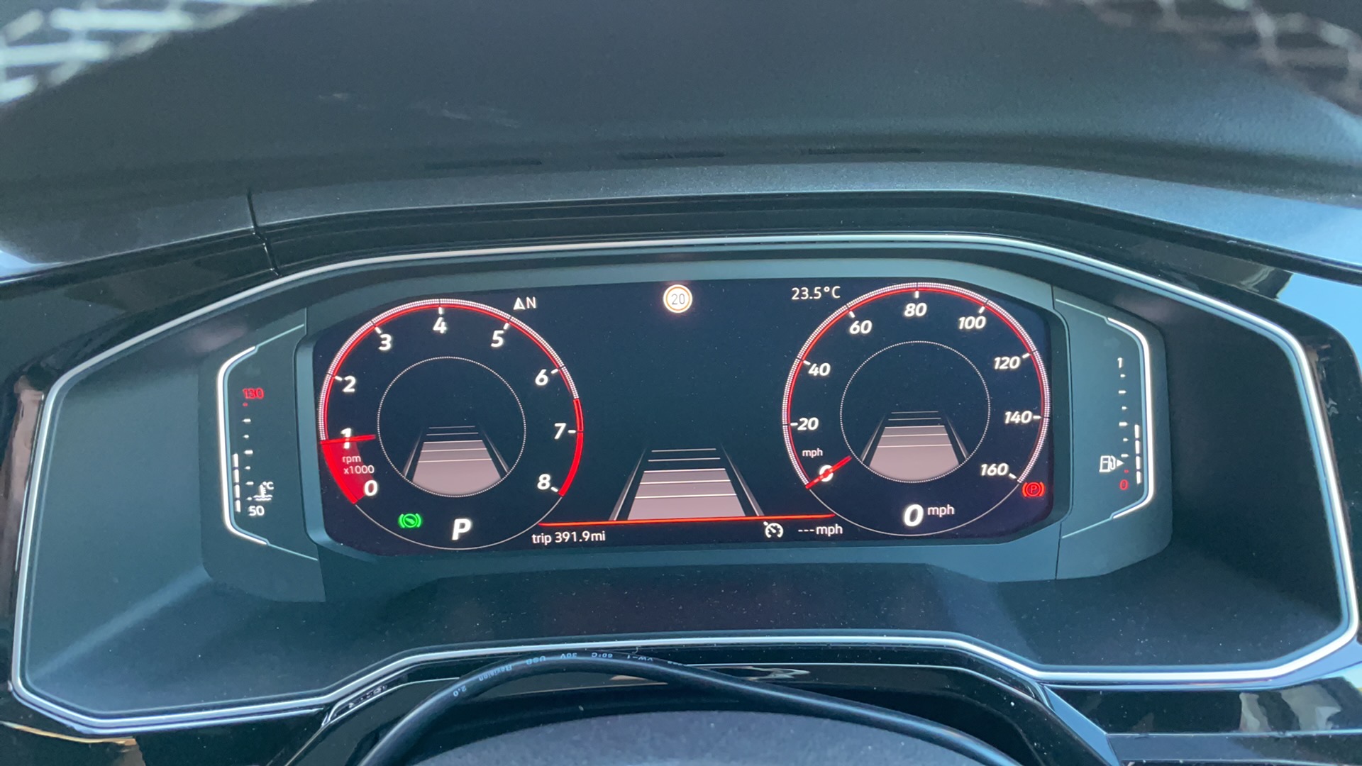

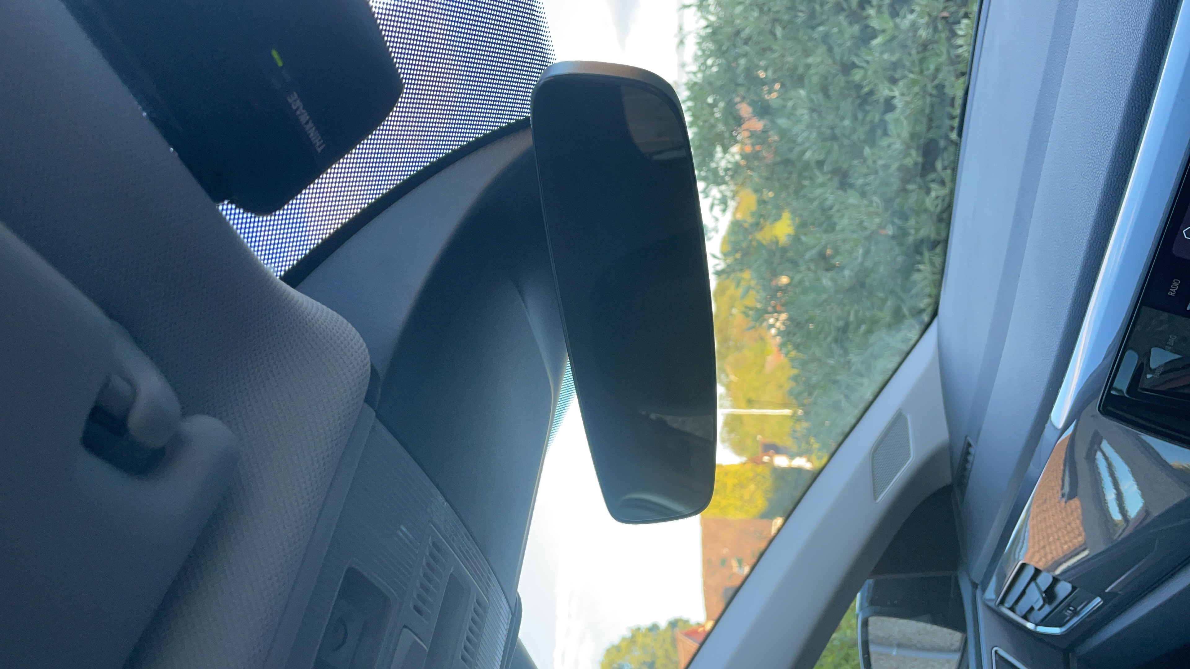

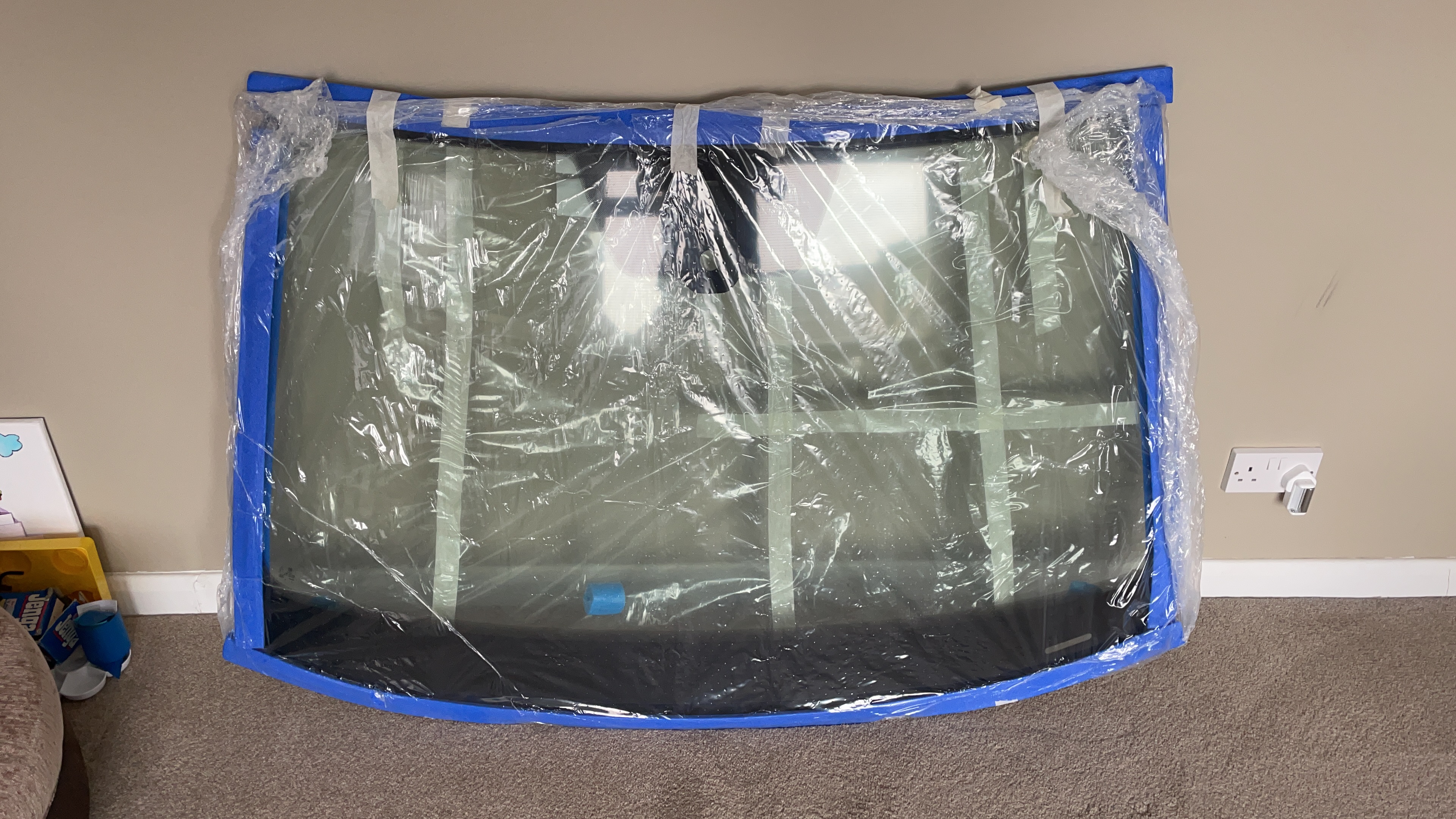

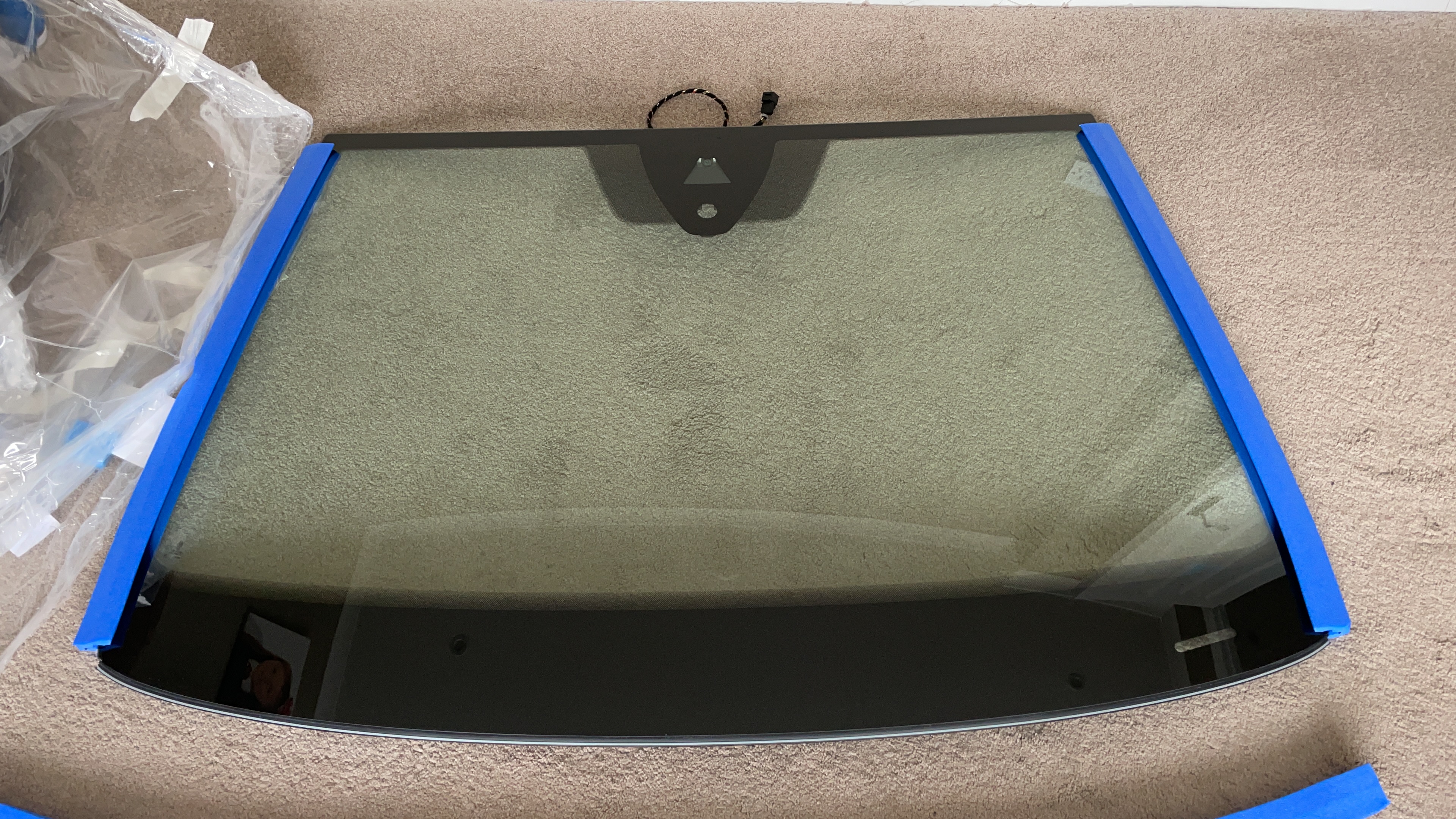

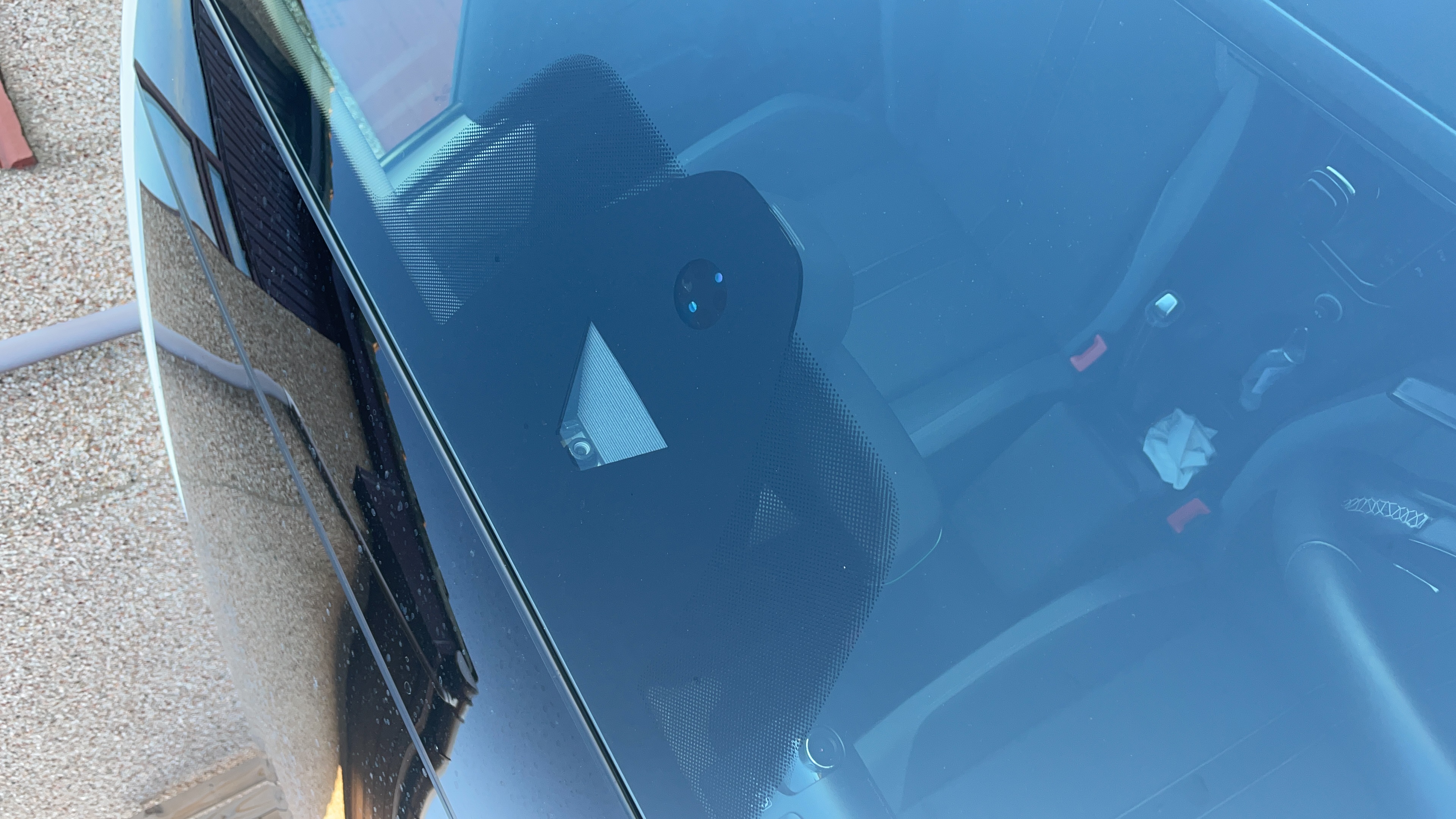

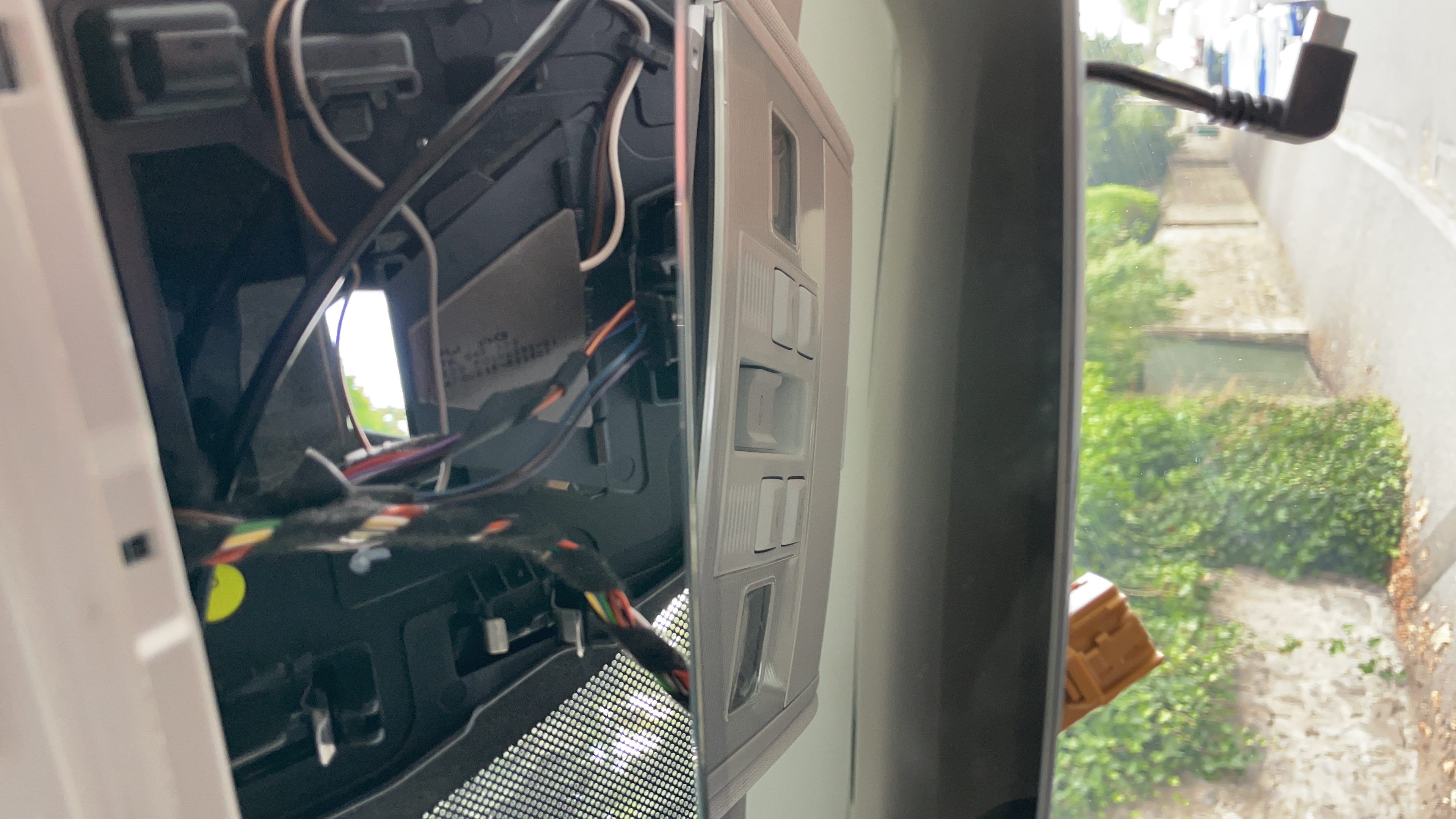

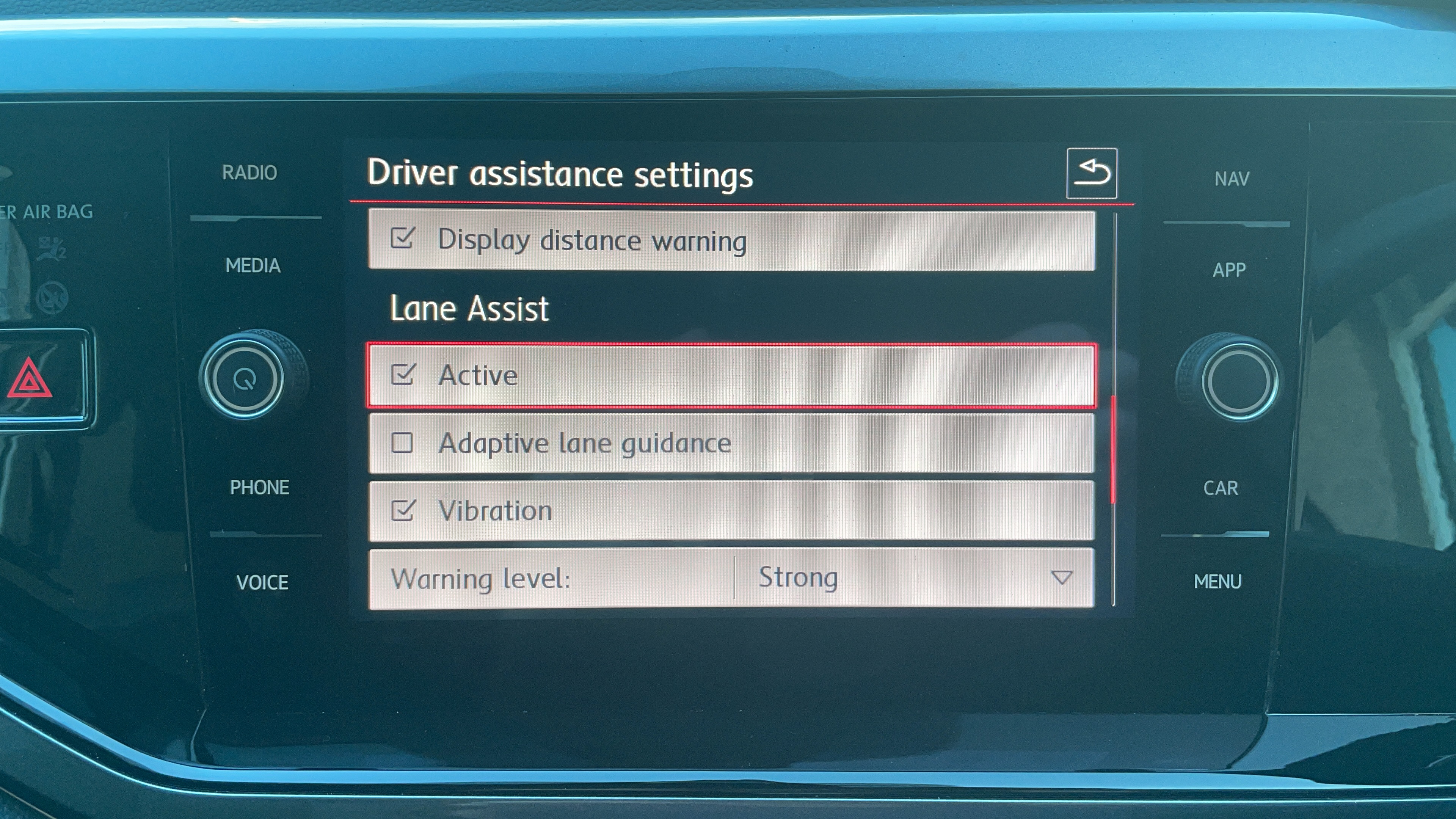

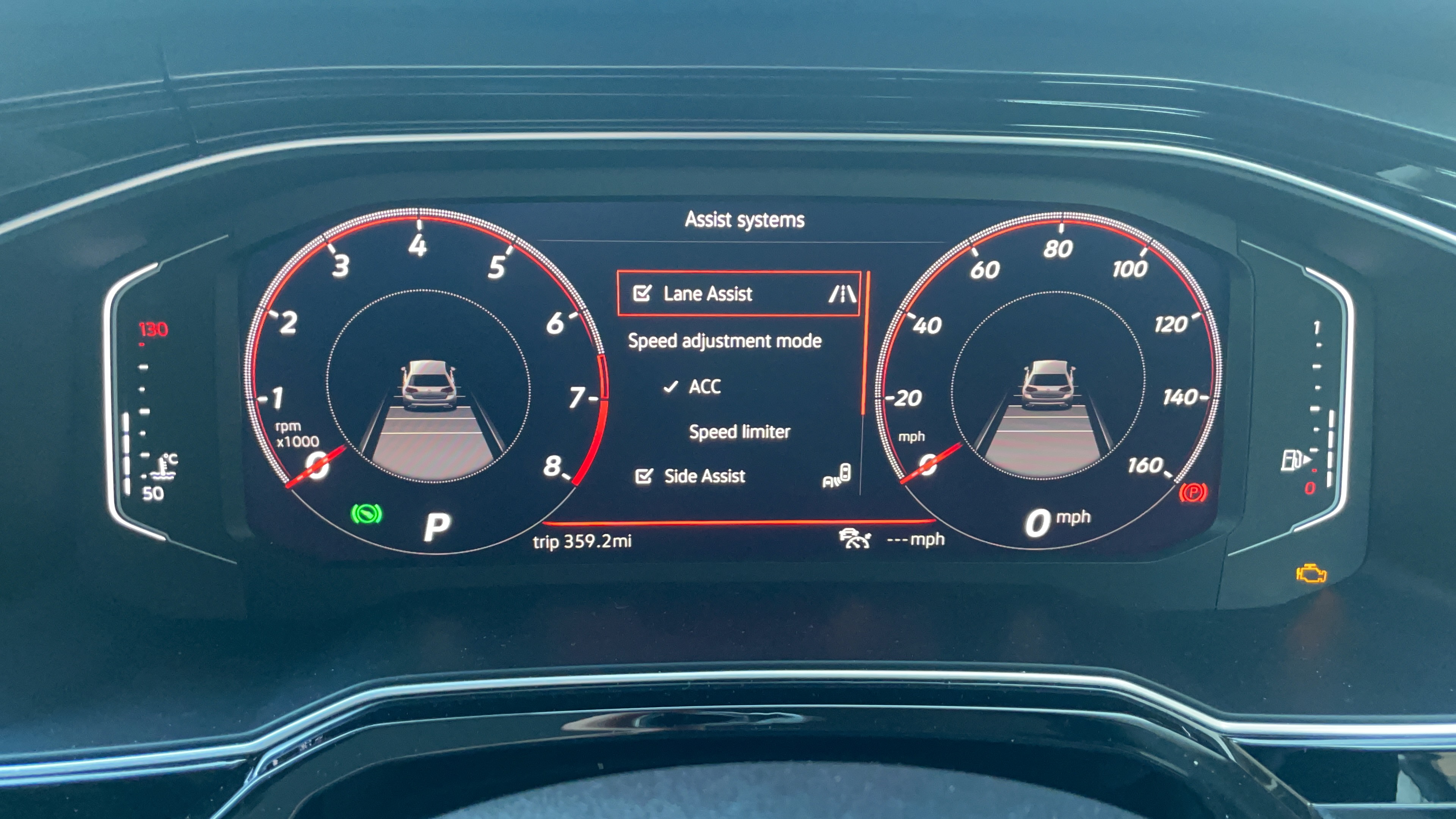

Today I retro fitted the genuine Lane Assist to my 2018 polo
After having a made up solution for a long time it was time to do it right 👌
A new windscreen,camera,trim,loom and flash & calibration & some coding!!!
Scott

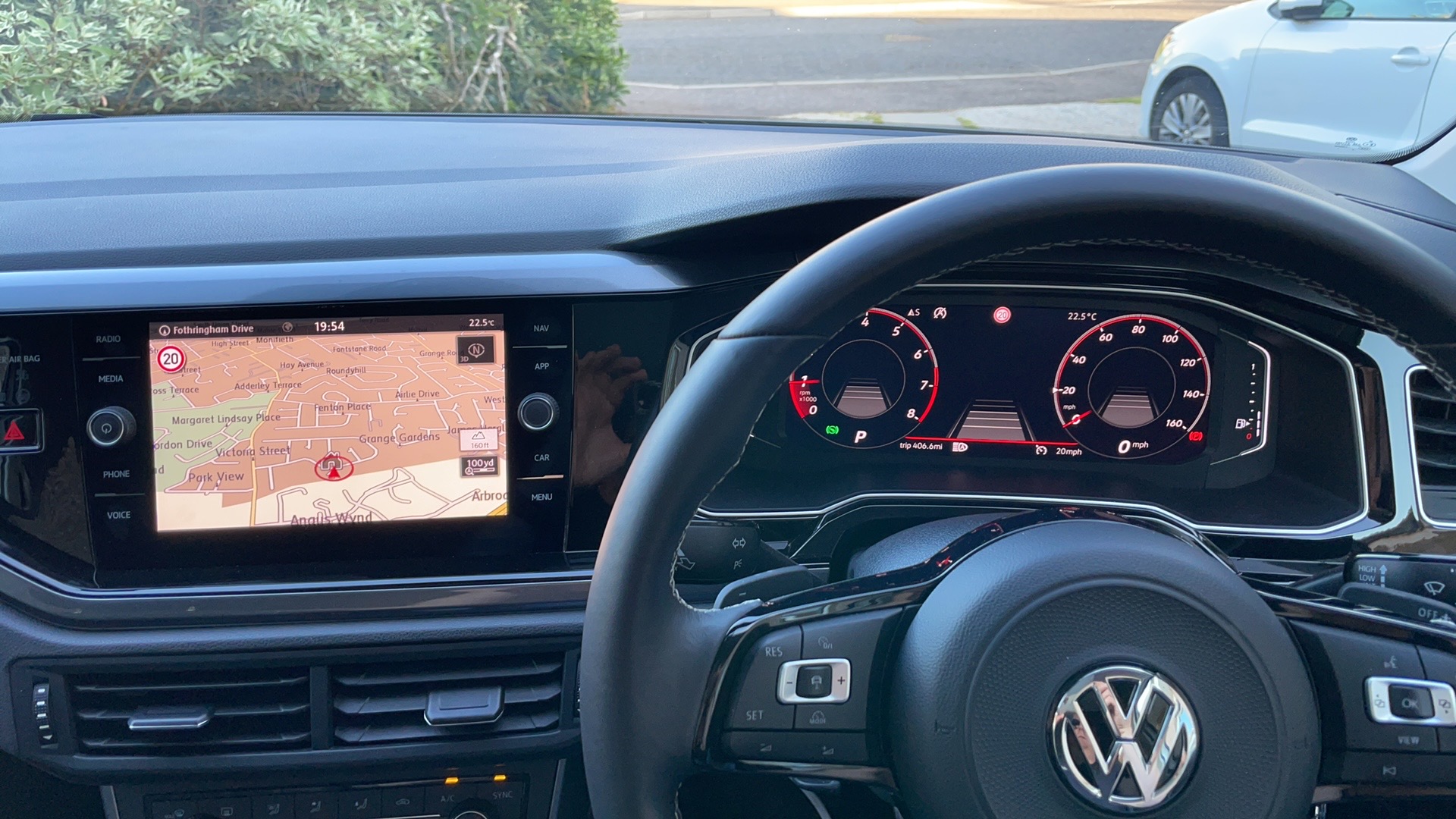

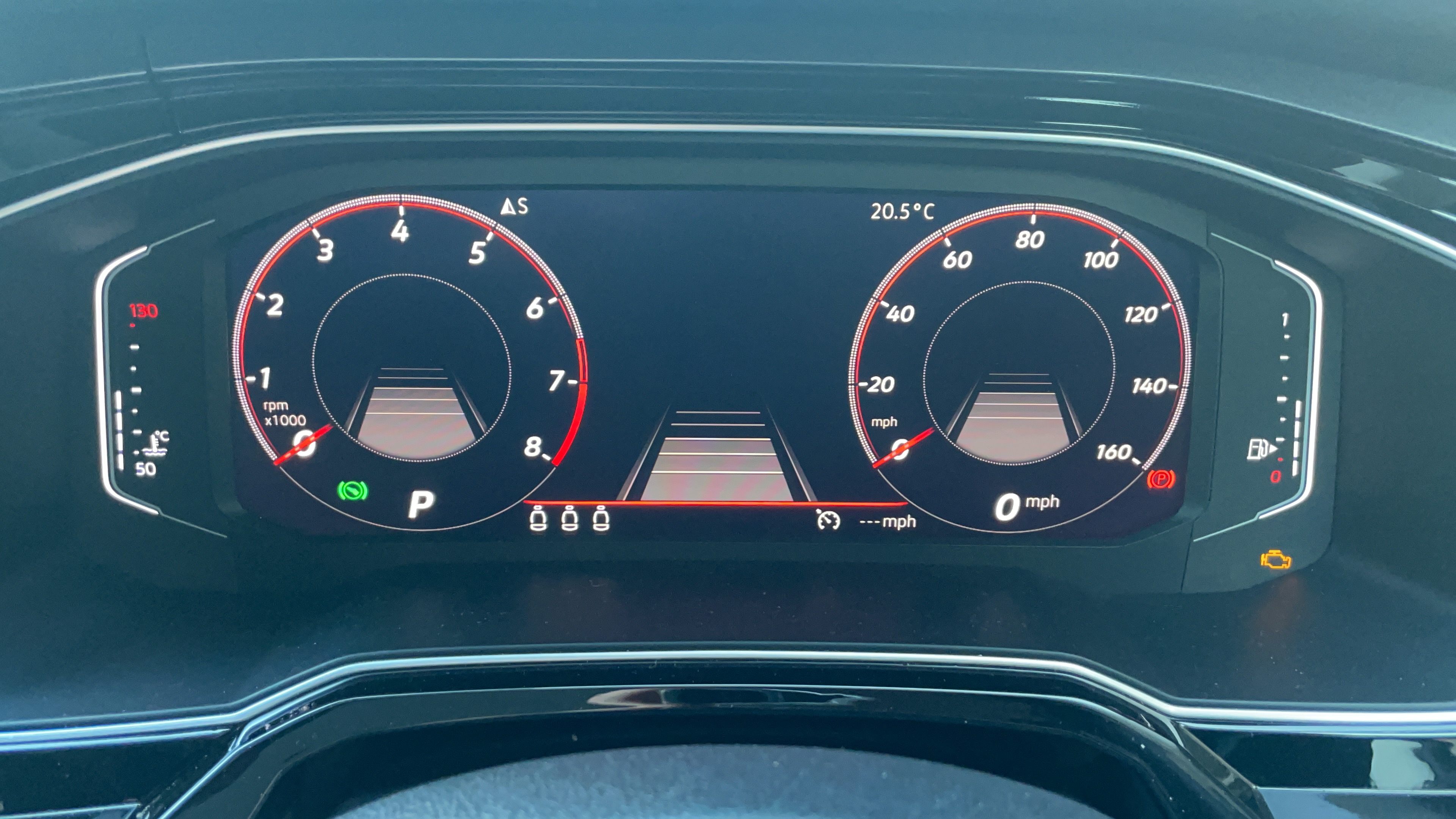

Now with added SWaP feature Dynamic Traffic Sign Assist 👌
Scott
Re: Genuine Lane Assist Retro Fitted
Scotty_boy vw wrote: Fri Jul 16, 2021 9:43 pm Now with added SWaP feature Dynamic Traffic Sign Assist 👌
Scott
You're adding everything I'd like to remove on my ID3! :lol: Technically impressive but a PITA in operation.
The traffic sign assist will frequently pick up a 30/40/50mph sign up a sliproad off the motorway you're doing 70mph on and look to apply the brakes to slow you down to that speed. Pretty much all the marques with this tech have the same issue - Kia, Merc, BMW, Nissan, GM etc.
