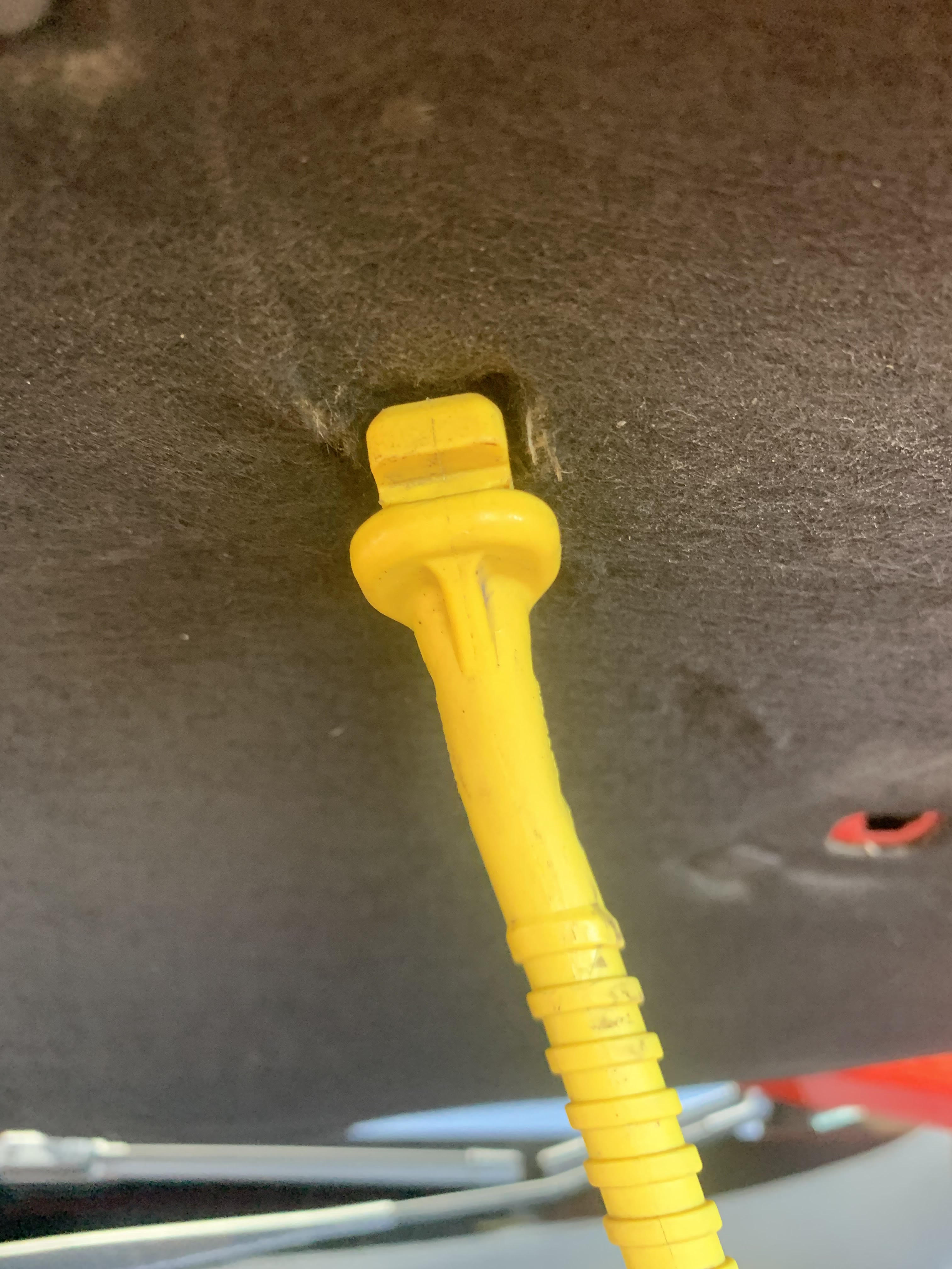

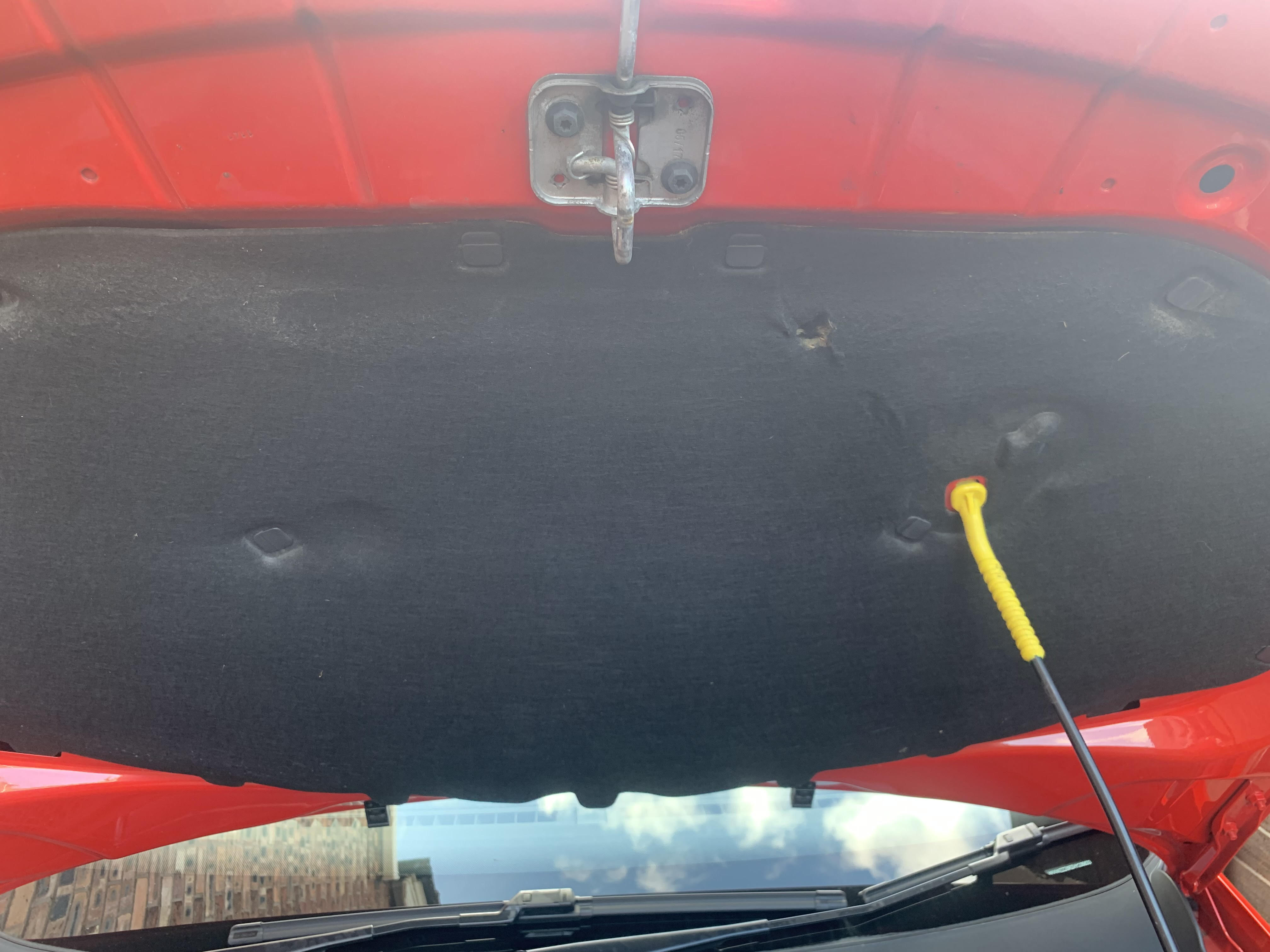

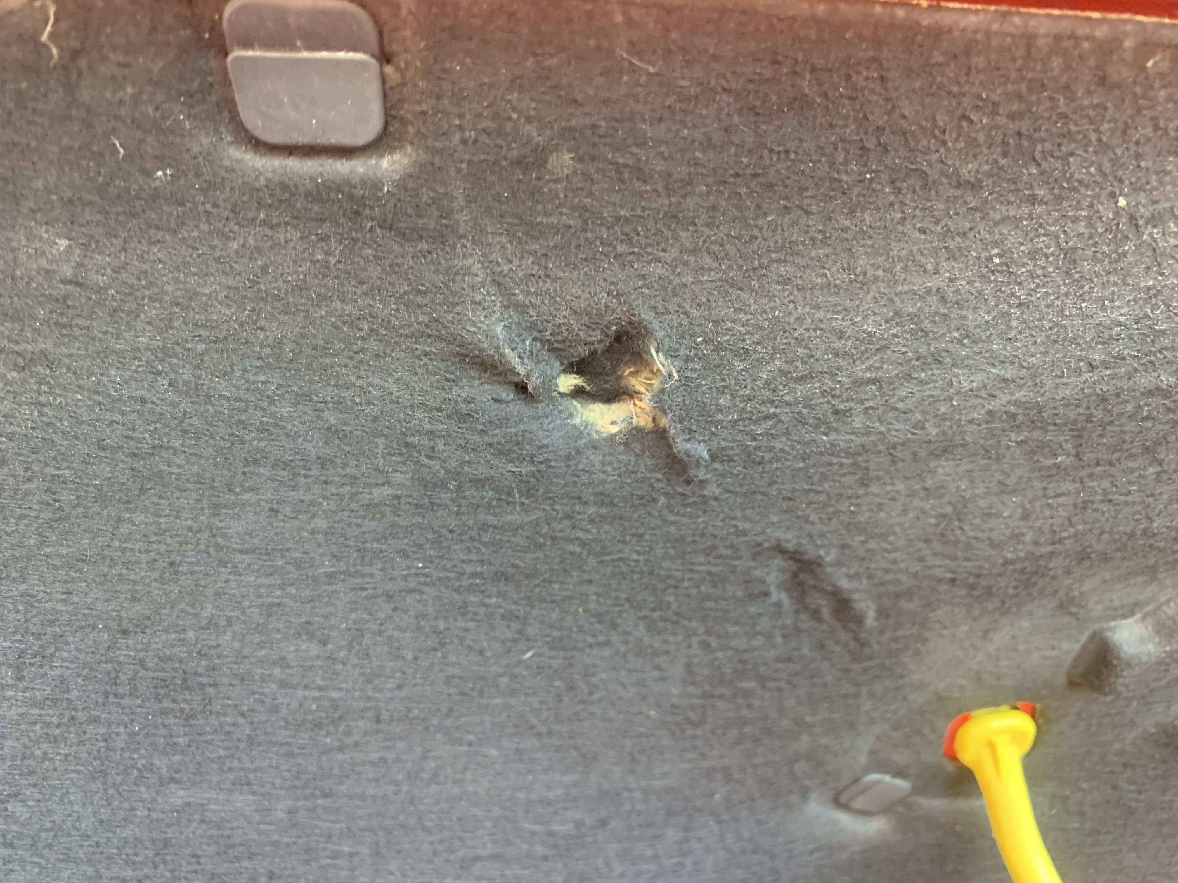

I first noticed that my under bonnet sound deadening had a nice new hole in it from what looked like the bonnet being dropped onto the bonnet prop while it was up and not locked into its position.

I assumed it was from the bonnet prop as the end of it fits perfectly into the hole that is now there. You can also feel (and slightly see) a crease in a straight line between the hole and where the prop should go.

The damage to the sound proofing is just another indication that they were not trying or rushing this job, can you not poke something in there and bend it back into place to minimise the visual damage - that garage will probably look at you in amazement when you ask them to sort that out!
