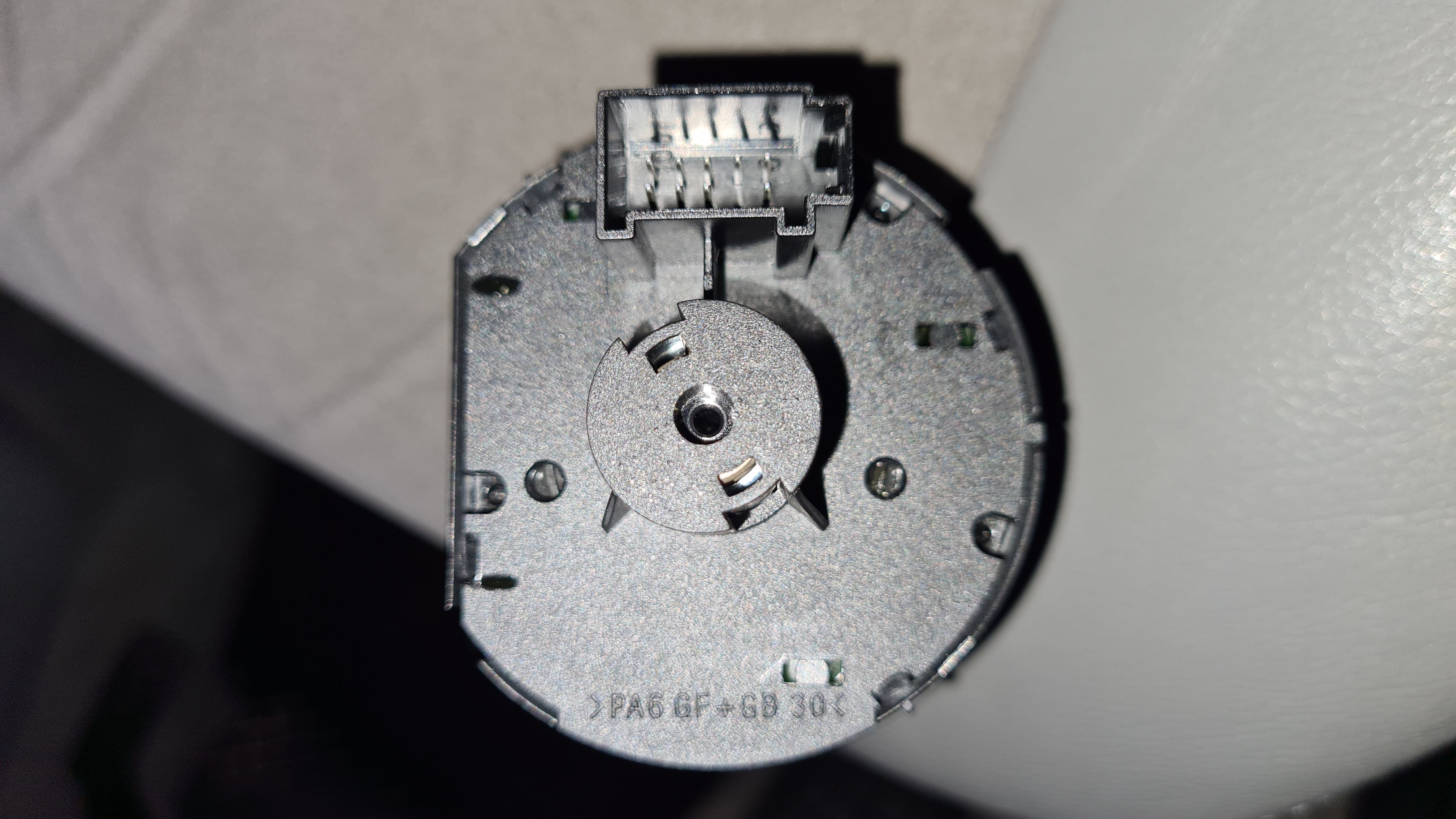

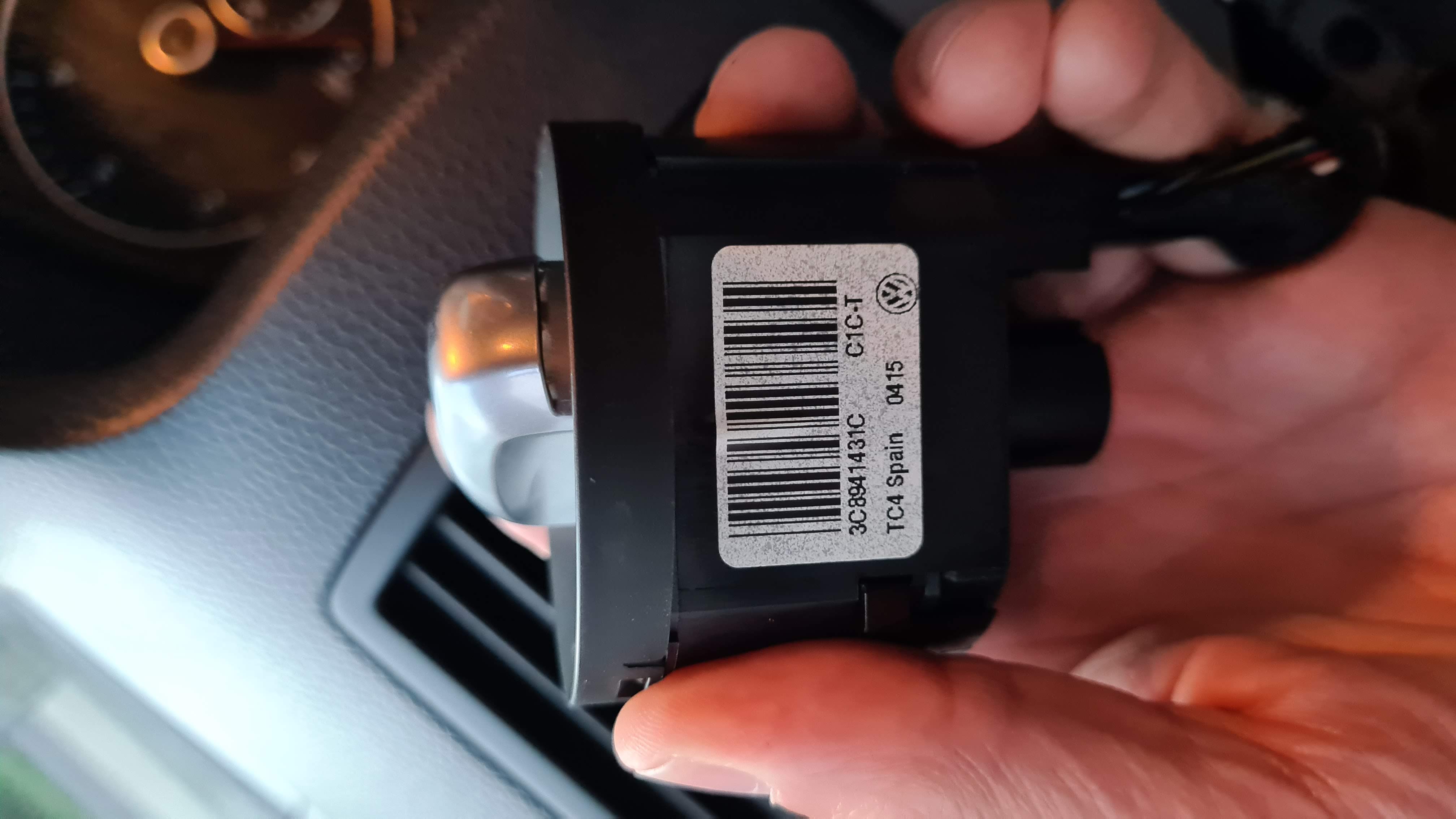

this is how is look like my current light switch. according to your post viewtopic.php?p=577197#p577197, the new one should be 3C8 941 431A XSH?

Yes, you can get the 3C8941431A. The 3C8941431C is front+rear fog. The ...A is front + rear fog + auto function. Should be perfectly fine.
