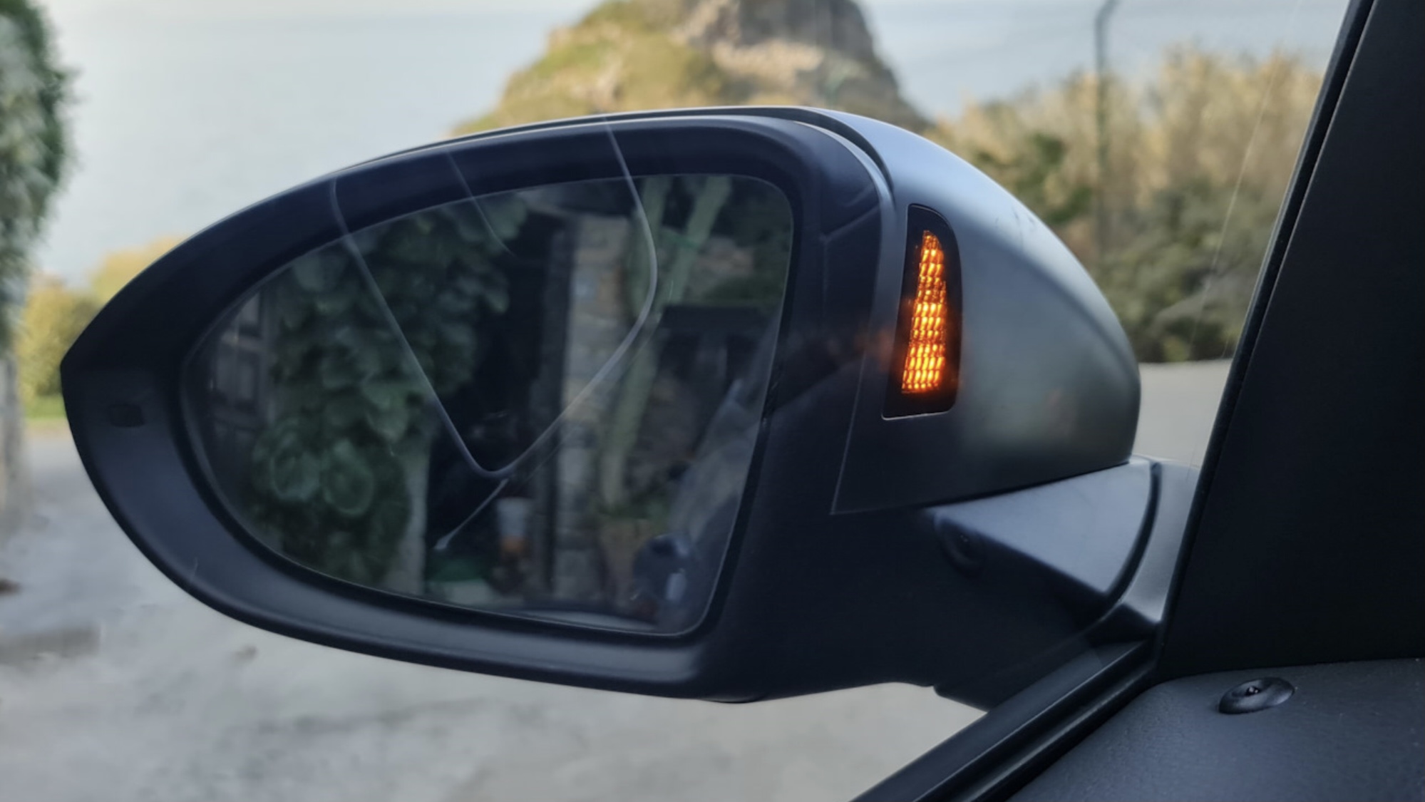

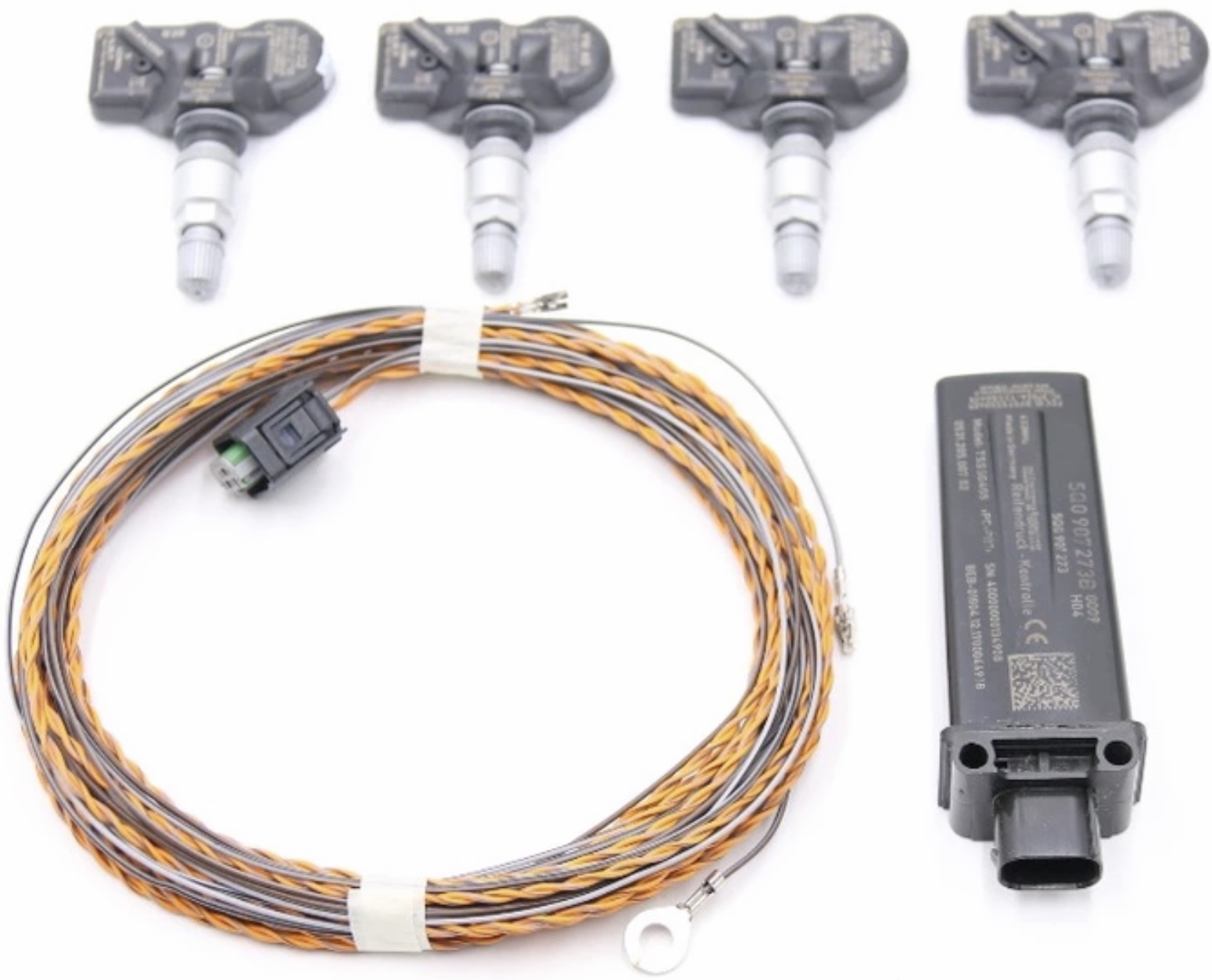

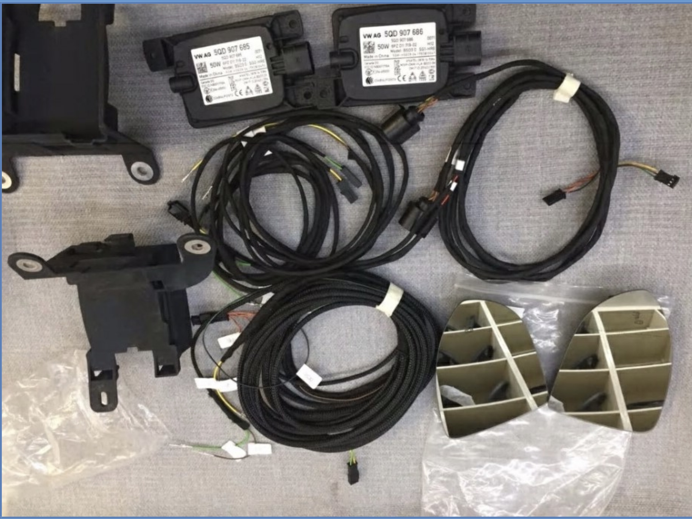

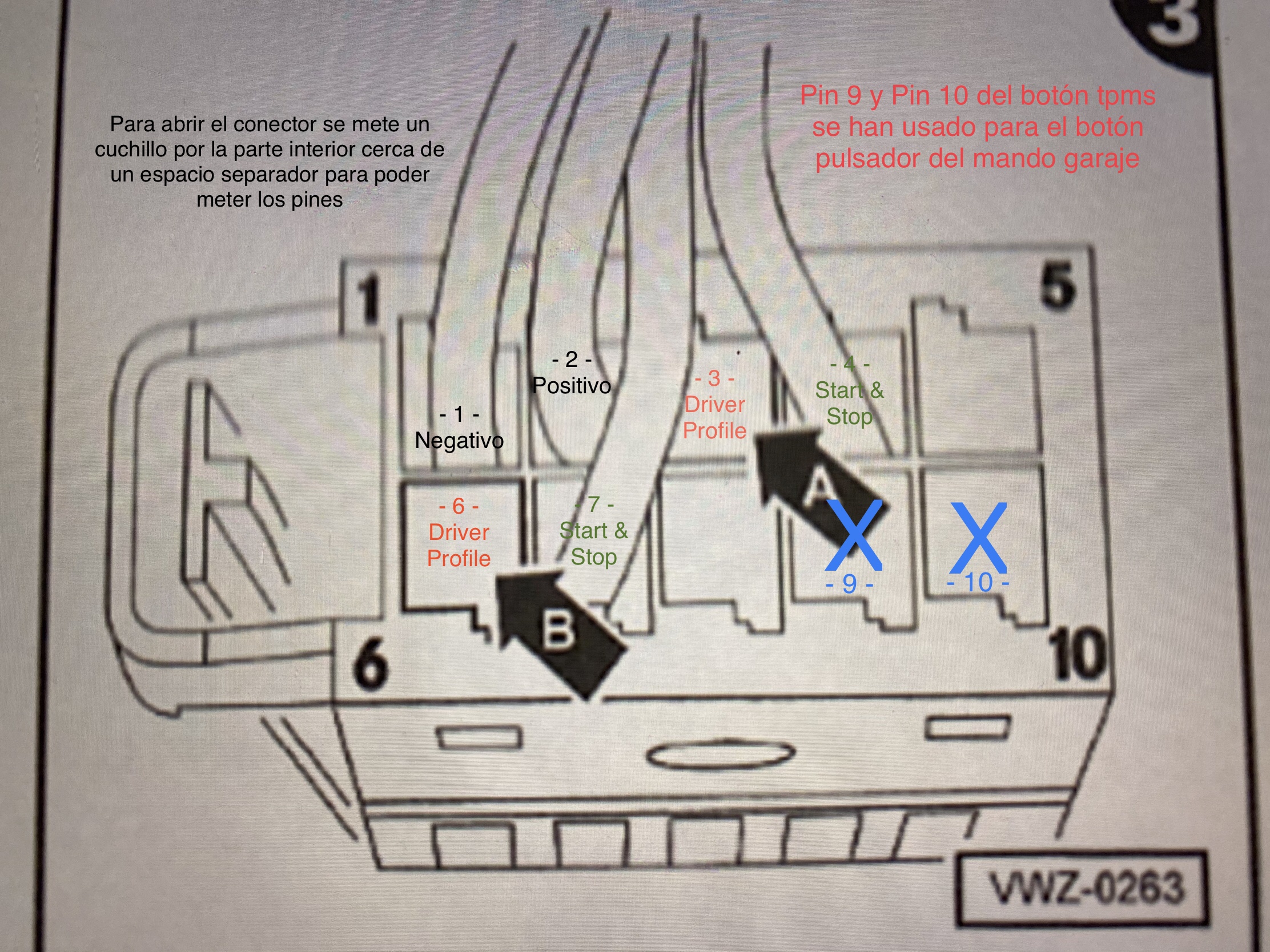

The retrofits in my car was: Side Assist, Lane Assist, Alarm with sensors, TPMS, Dynamic Light Assist, Ergoactive Seats, 312 mm brakes disk (very recommended), change G13 to G12evo, change to MIB 2.5 , Drivers Profile, change front and rear speakers, change doors panel from golf R, insonorización in all doors, ambient lights in front doors, four foot lights, light in middle console, warning lights, open garage door in button of center console, PLA 3.0 (in progress), washer liquid fluid indicator (in progress), soundaktor (in progress), update the rear camera low to high version (in study phase).

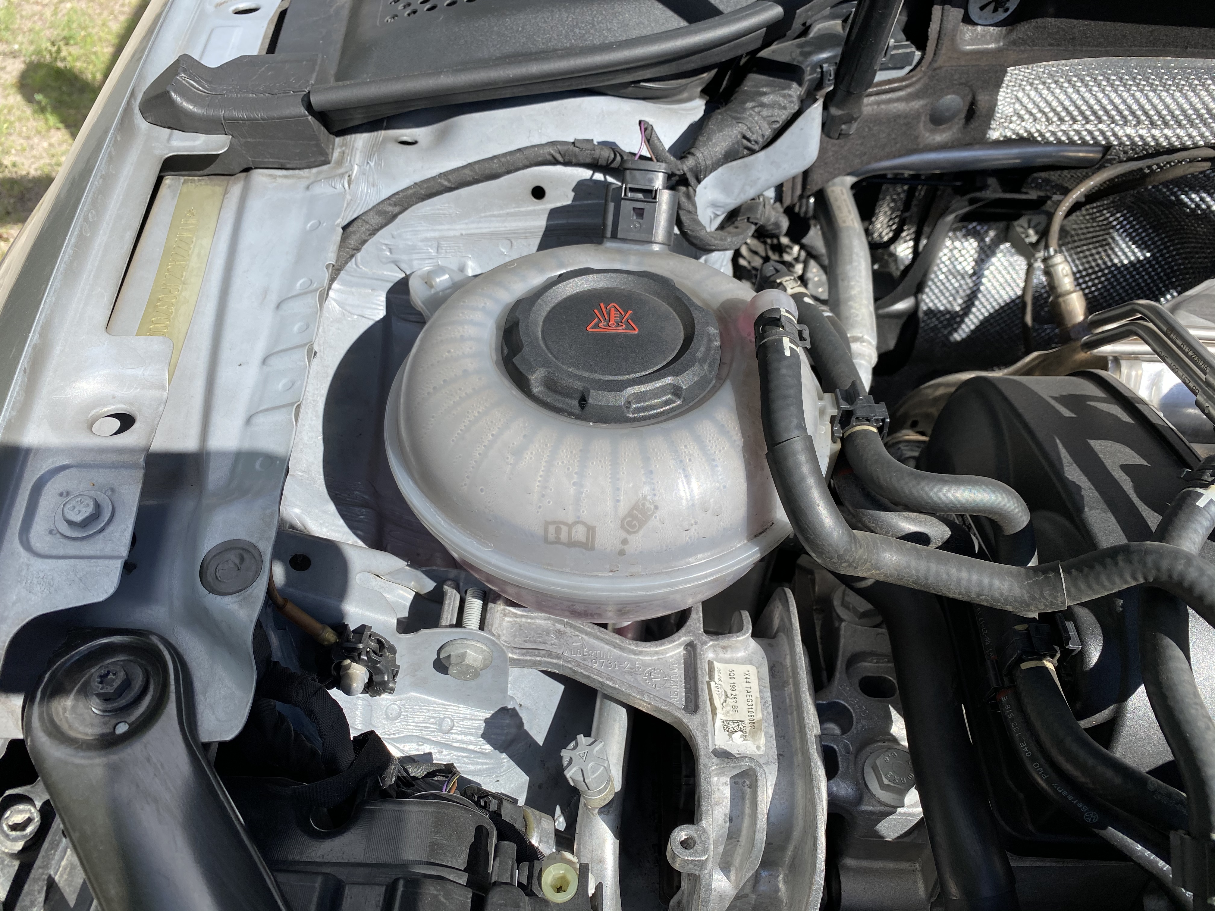

Re: From Stock Golf 7.5 to….

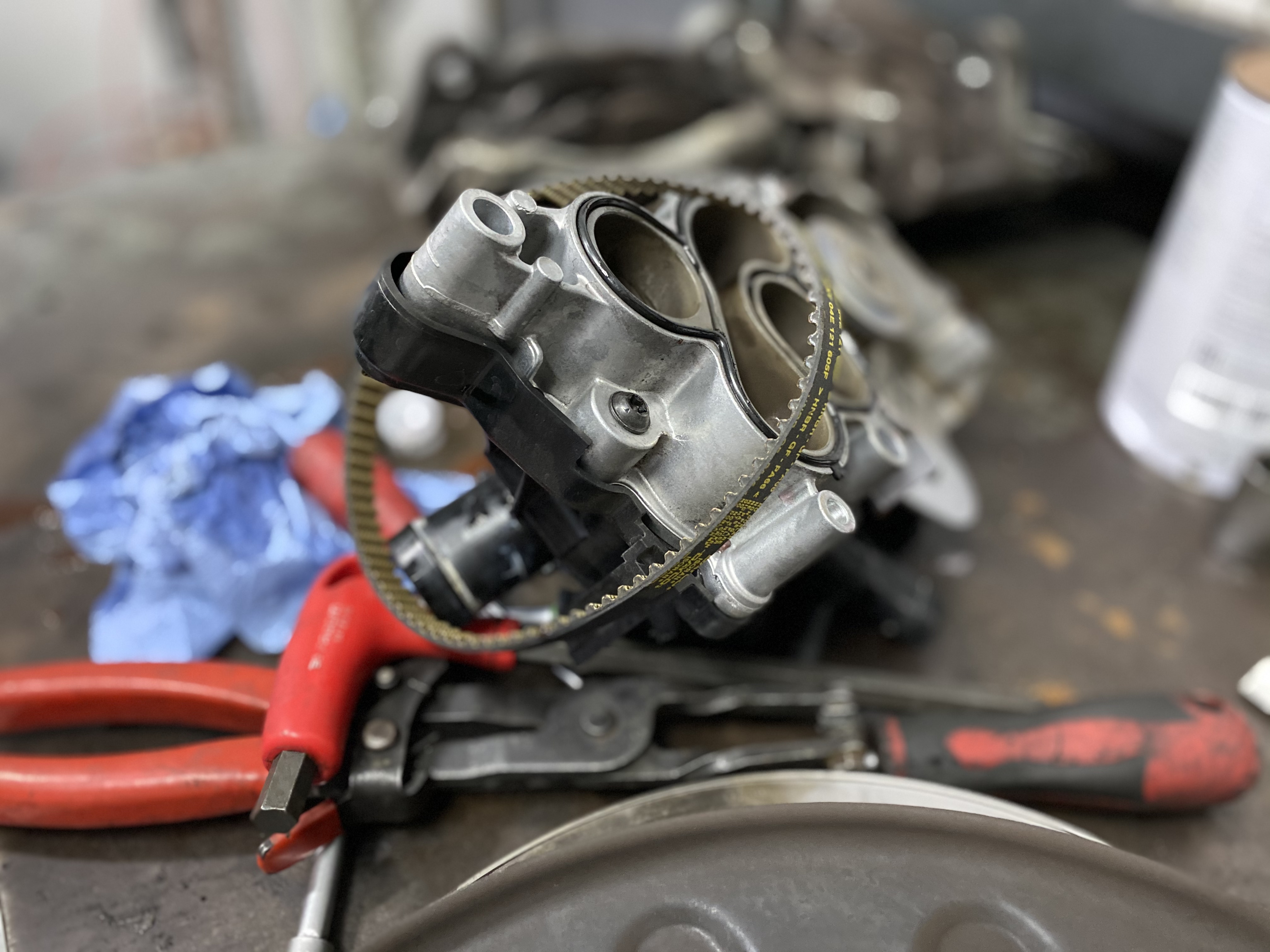

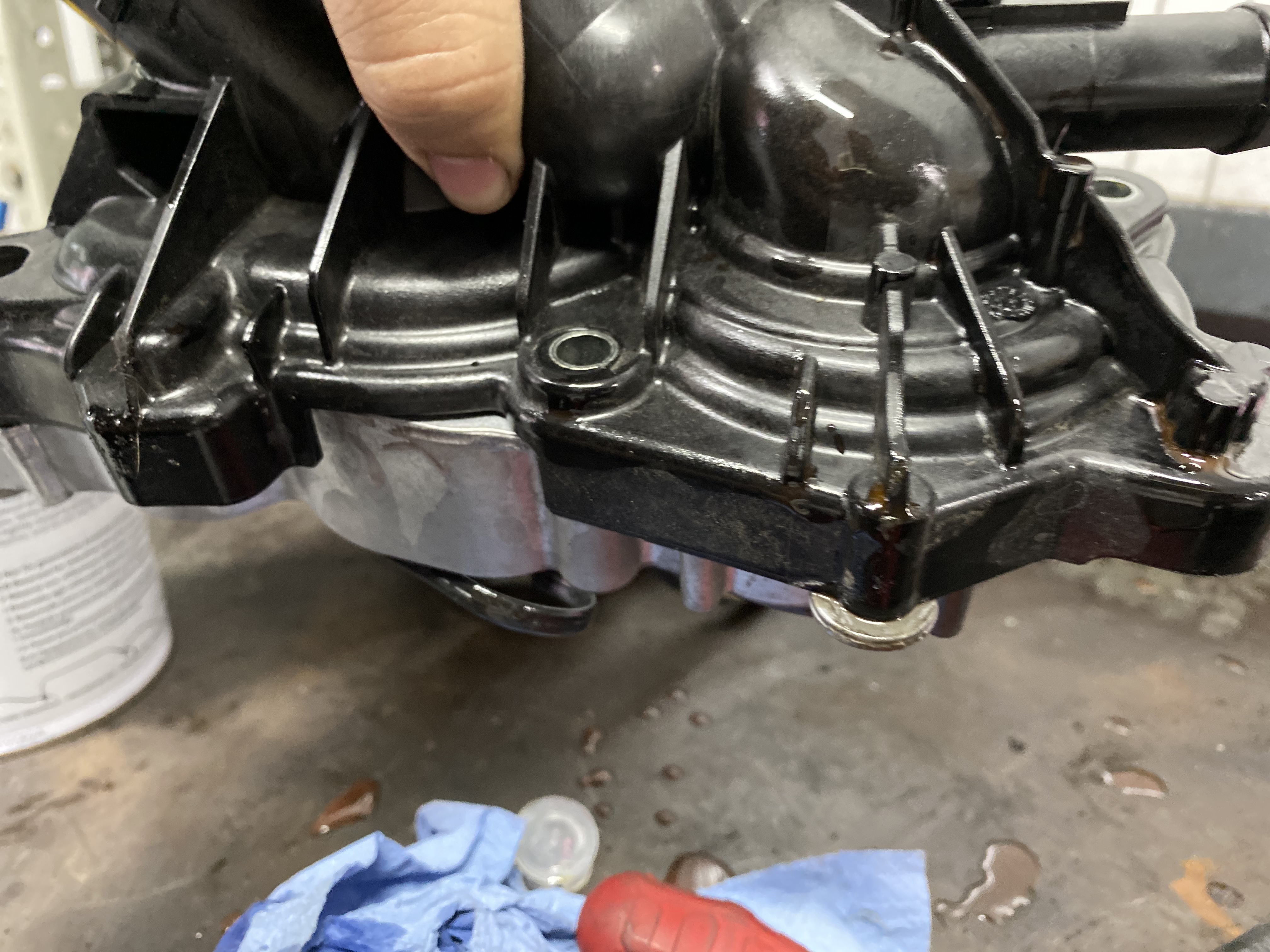

Hello good morning to all.

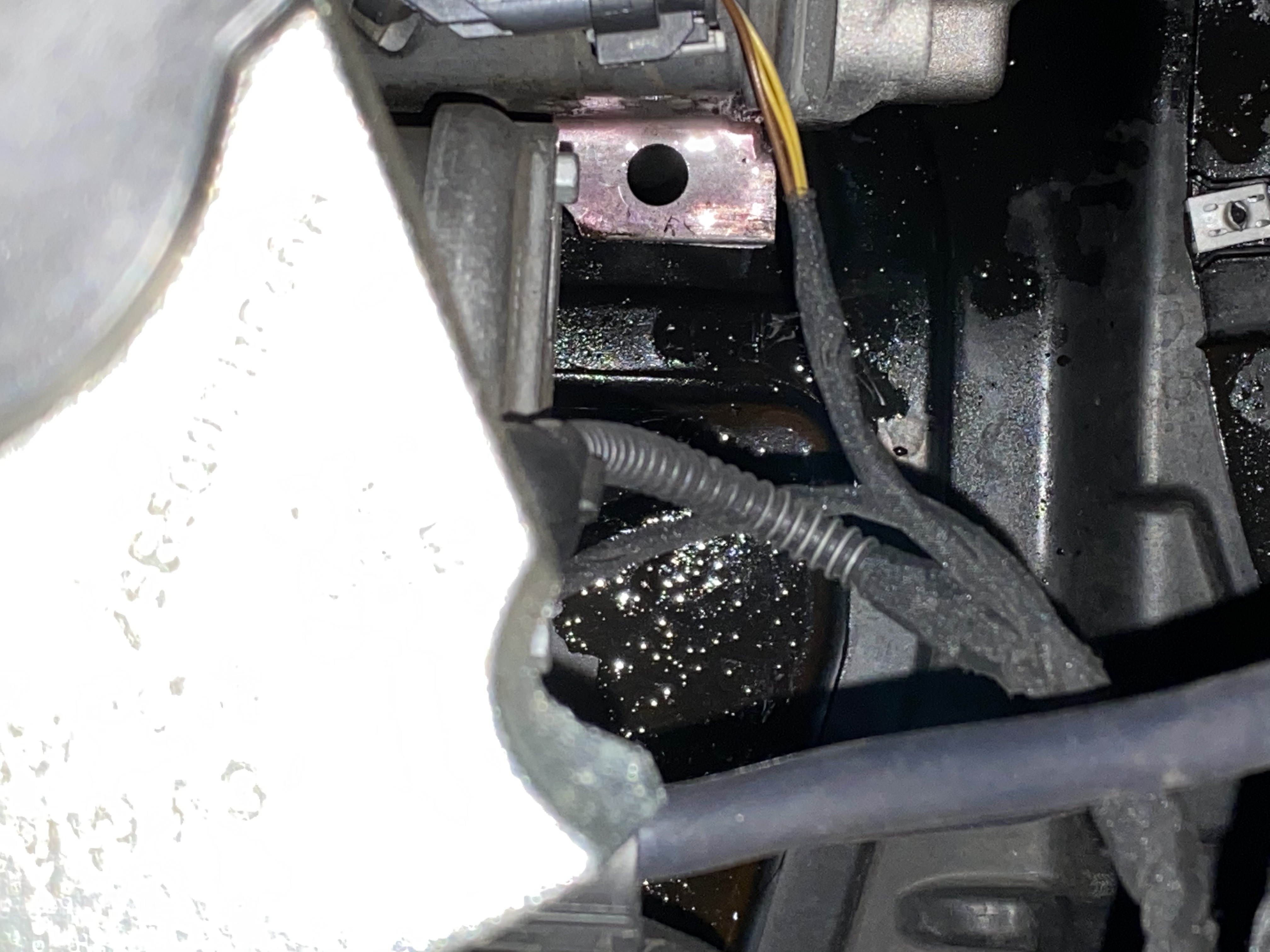

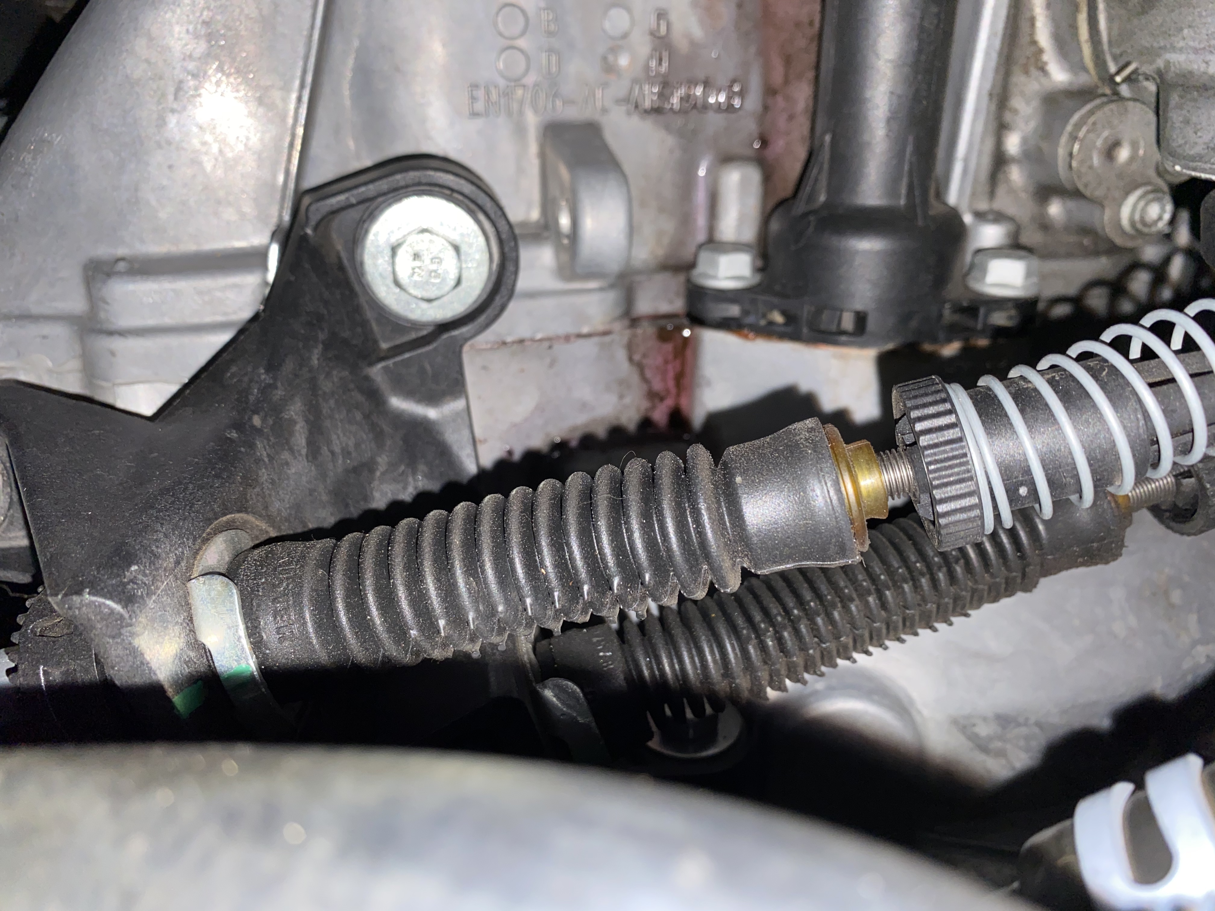

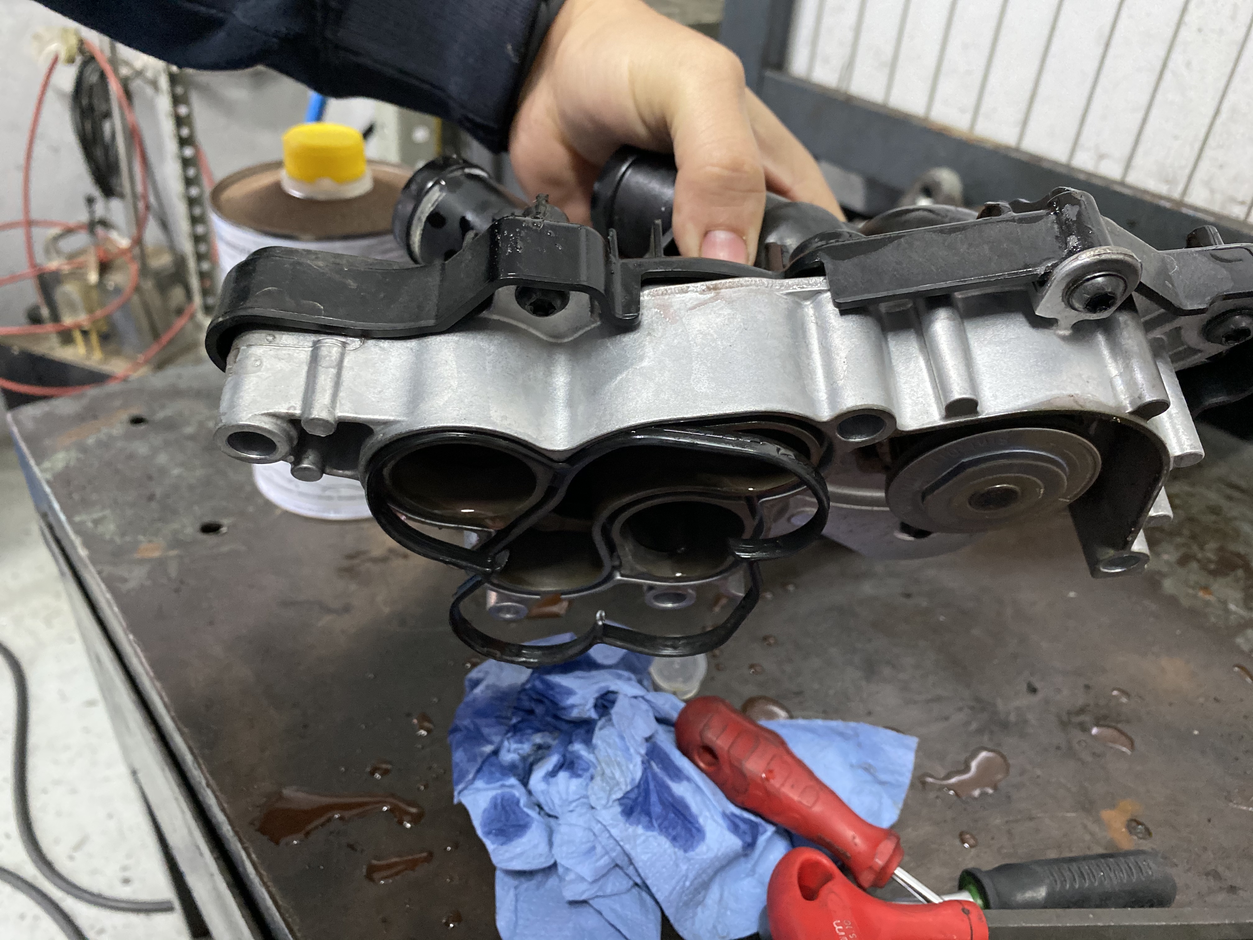

A few months ago I had to change the water pump, I had the problem of corrosion by G13 coolant. The car had 46.000 kms only.
I put photos of the disaster. I have changed to G12 evo, which is what I recommend that you do as soon as possible .....
- 26C12FDC-985F-4F30-8BAA-EA7F36EC20B3.jpeg (3.6 MiB) Viewed 29092 times
- CE720805-BDF7-414F-A958-BD928B9BB885.jpeg (1.61 MiB) Viewed 29092 times
- 185D476C-C0BE-496E-B6B2-DE2C2E7FB052.jpeg (1.87 MiB) Viewed 29092 times
- F8DA09F0-459F-4C9A-8BAA-D9EB4A6A1ADE.jpeg (3.3 MiB) Viewed 29092 times
- AD2427C9-375F-4EA8-B095-ECF83EEA4CC6.jpeg (3.68 MiB) Viewed 29092 times
- 79F97E3E-3827-4E38-86CC-A52FFF9455A8.jpeg (3 MiB) Viewed 29092 times

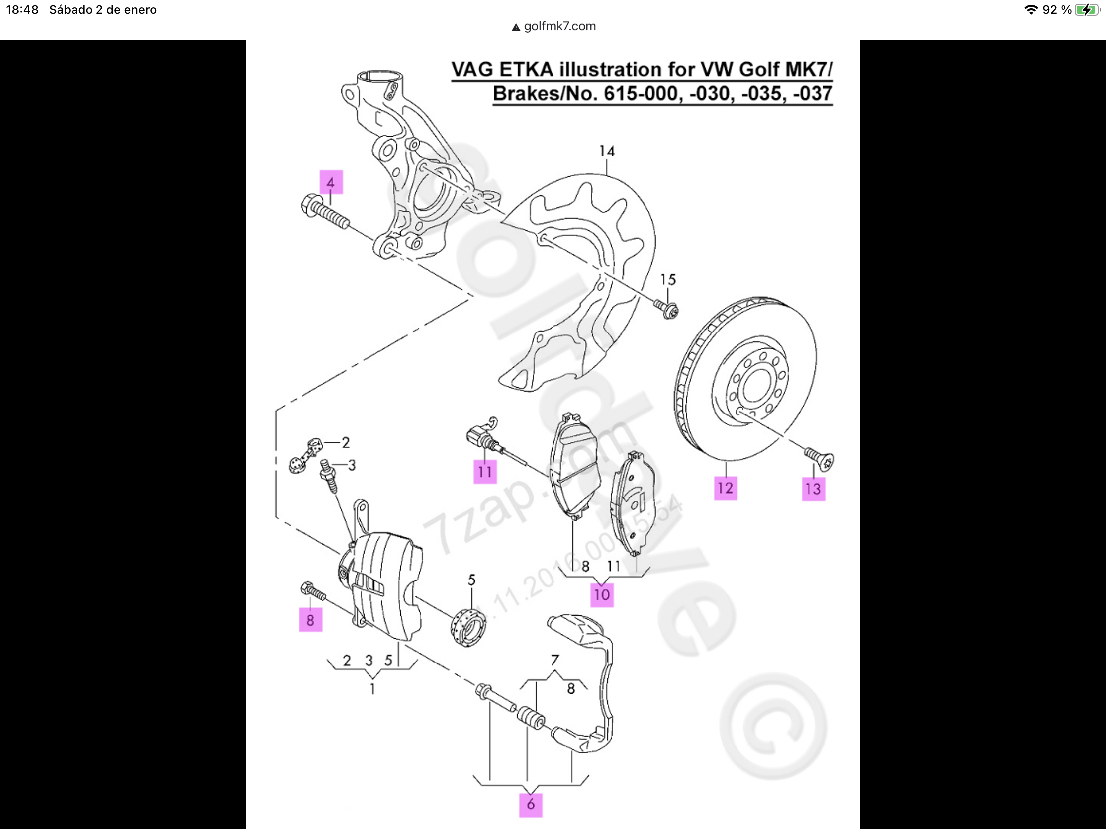

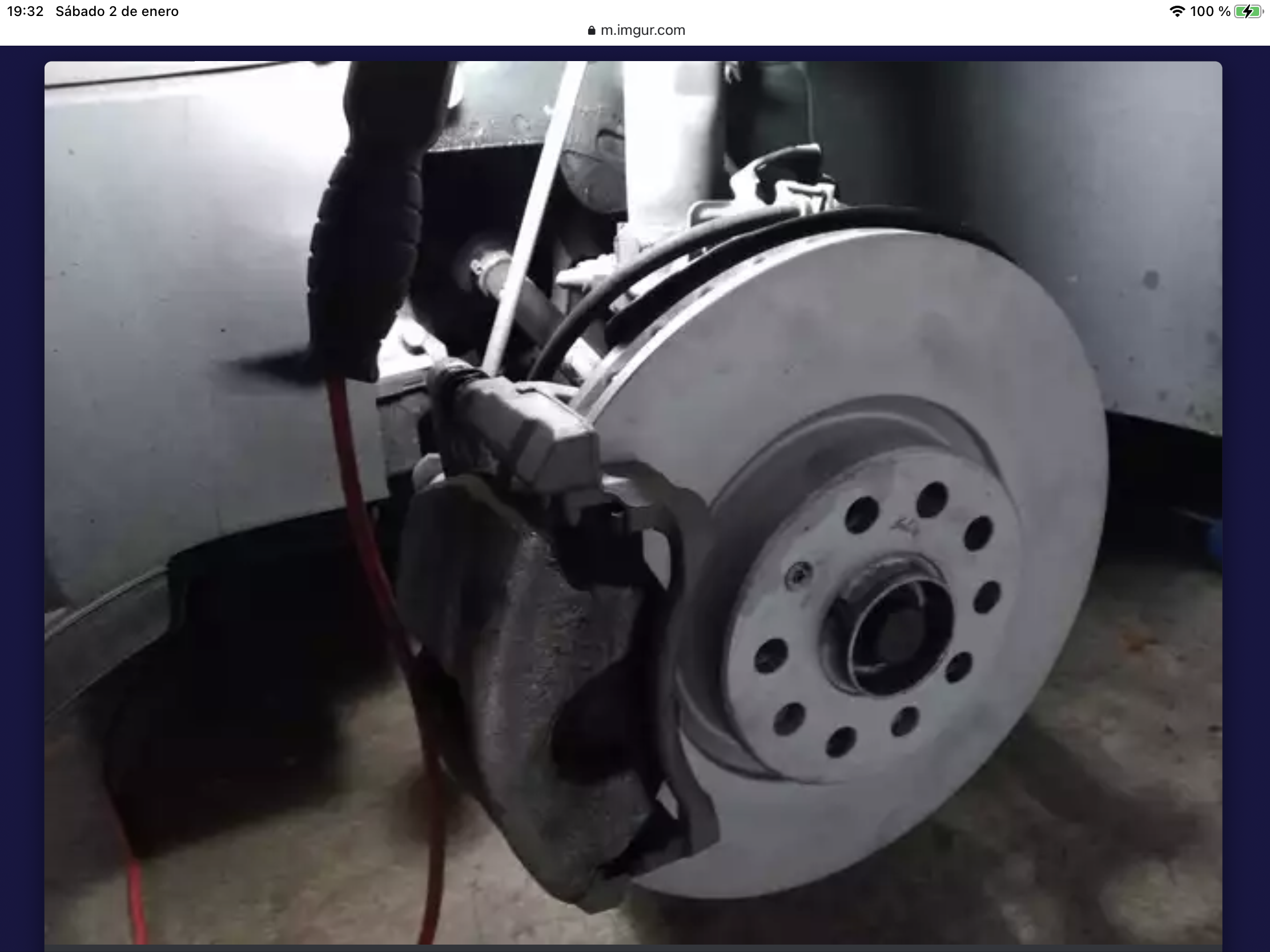

Another very interesting modification that I recommend is to improve the front brake system.
As it is configured from the factory, on a standard 17-inch rim, it can be adapted without problems.
The improvement translates into less fatigue when braking and an increase in the safe distance when braking.
There is more poise when braking and the car transmits more security.
The change consists in putting 312mm discs as in the GTD. Brake calipers and pads are changed.

Hi Carolco.
The Autoscan can only be posted when you have 10 posts. It is true that you should already have more than 10 posts but I deleted the posts from the dcgumis thread (my fault
When you have 10 posts, please edit the first post with the Autoscan (don't forget to do it
Thanks for your recommendation on the brakes, it's a huge improvement.

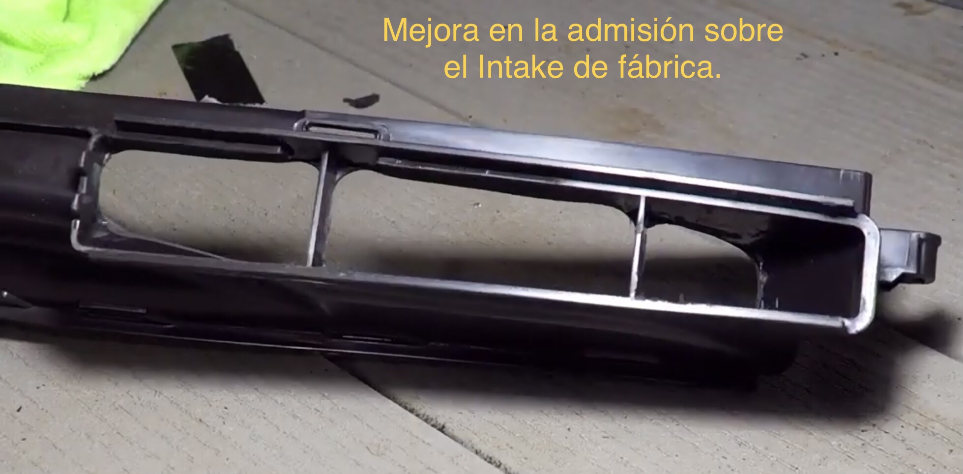

Taking advantage of the occasion, comment that I also made the mod to open the intake, while changing the factory air filter for one of K & N oil. The truth is that you notice a more serious sound in the engine, as if it were roaring more. I like the sound it makes. Modification is easy using a dremel.
Greetings.
Thank you very much for the document sent. I really want to try it. Let's see when I can do tests. I have a low battery level, so I am doing a few walks to charge it naturally.

Carolco
- Posts: 46
- Joined: Sat Sep 04, 2021 8:20 pm
- Drives: Golf 1.4 TSI 7.5
- Location: Canary Islands
Hi there.
I would like to share a very simple mod to open the garage door.
In my case I had two controls, one of them with a broken puker. I have taken advantage of it. With a polymer, the positive and negative are located. When we press the button of the control the circuit is closed. Once these points are located, we solder two cables. One represented the positive and the other the negative, and we soldered it to the push-button of the three-button keypad that I had previously installed for the PLA mod, which by the way to see when I finish it .....
Having this keypad, take advantage of the tpme button that was not used so that when I press it, the garage door opens. It's the pear ...
In the diagram that happened with the keypad, the Tpms button is used with pins 9 and 10 marked with X, to connect positive and negative of the garage door opener. The rest of the buttons are for other uses ...
- FFD099E2-D352-40C3-AAD1-B6ED43F31615.jpeg (1.35 MiB) Viewed 28985 times
- 353BC8E8-A124-468D-9835-35AF9250C623.jpeg (136.38 KiB) Viewed 28985 times

- Posts: 8988
It is certainly a very useful improvement.Carolco wrote: Sun Sep 19, 2021 9:25 pm Hi there.
For my wife's Golf I did it twice, first with the MODE button, but later I installed the driving profiles (FPA) in which it is necessary to have the MODE button operational, so I used the OFF button for TCS/ESP (diagram).
With these two buttons (MODE and TCS/ESP OFF) it is not necessary to make any modifications to integrated circuit board for buttons, just add the wires in the right way and 'everything' will work in the right way.
For our Golf LHD we like the left side better ...
