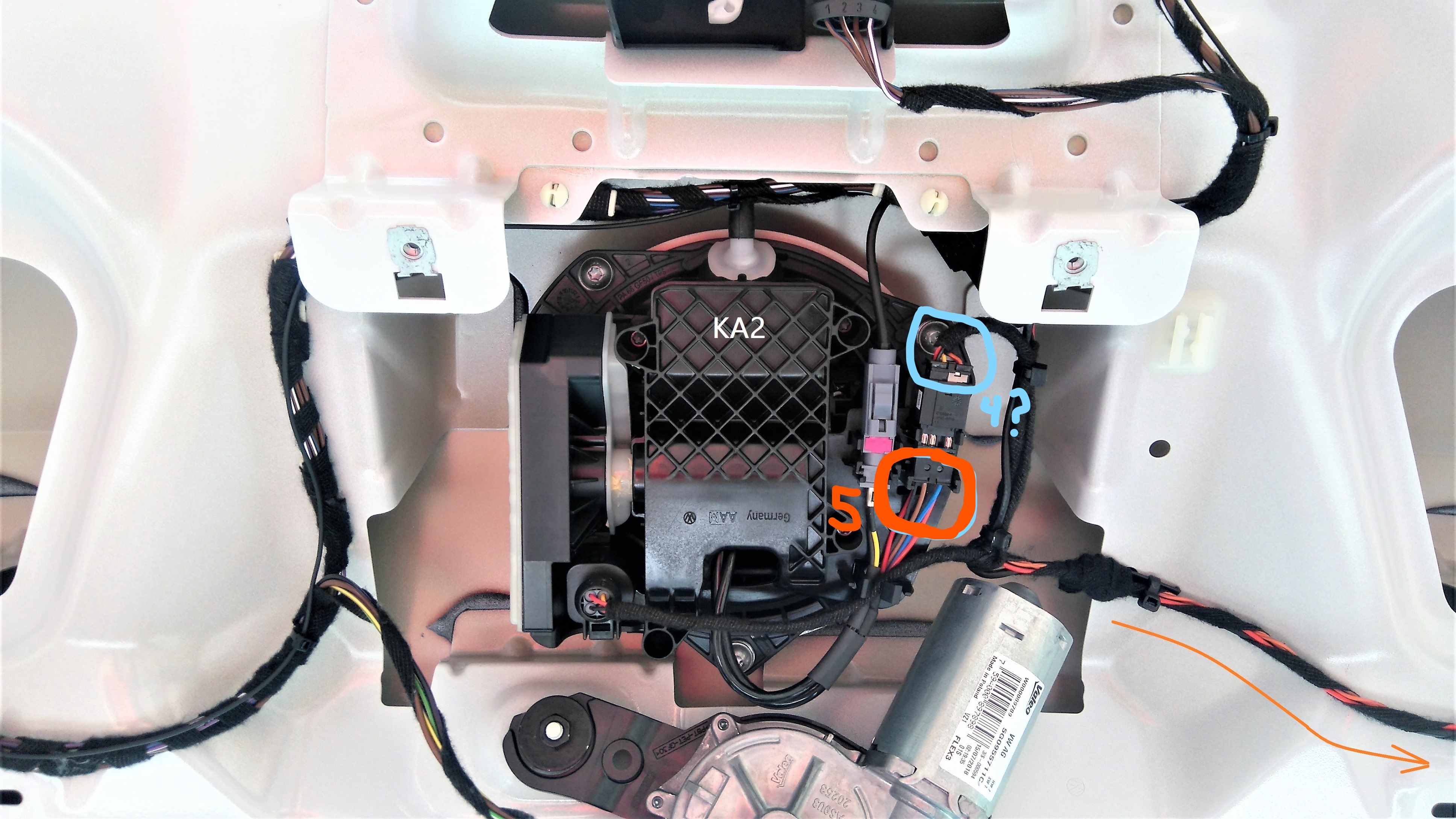

Hi everyone.
I was looking at the photos of the KA2 emblem rear camera adaptation process. I have a question with the wiring.
In a extreme of the T8 conector there are five wires....
I have marked the T8 connector, and I am wondering if there are four wires there, because they would be current, ground and the two can bus.
Or is there also a connection to terminal 3 of the E234 connector?
It is that I do not get to appreciate it in the photo.

You don't need any photos of anywhere, look at the diagram, it is exactly 5 wires. (+, -, H, L, REV sig output)
In diagram you have the correct terminal assignment. Crystal clear.
KL 30a means Terminal +30 (Klemme).... not 30 Amps.

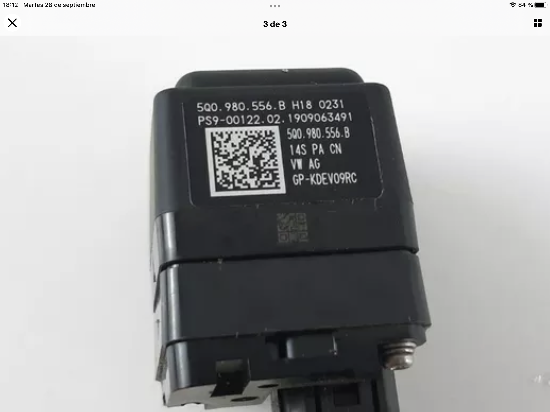

Thanks Fernando.
I buyed this camera. It have the same hardware and software version likes yours.
Only the parameter file mark the diference. The wires came from AliExpress.

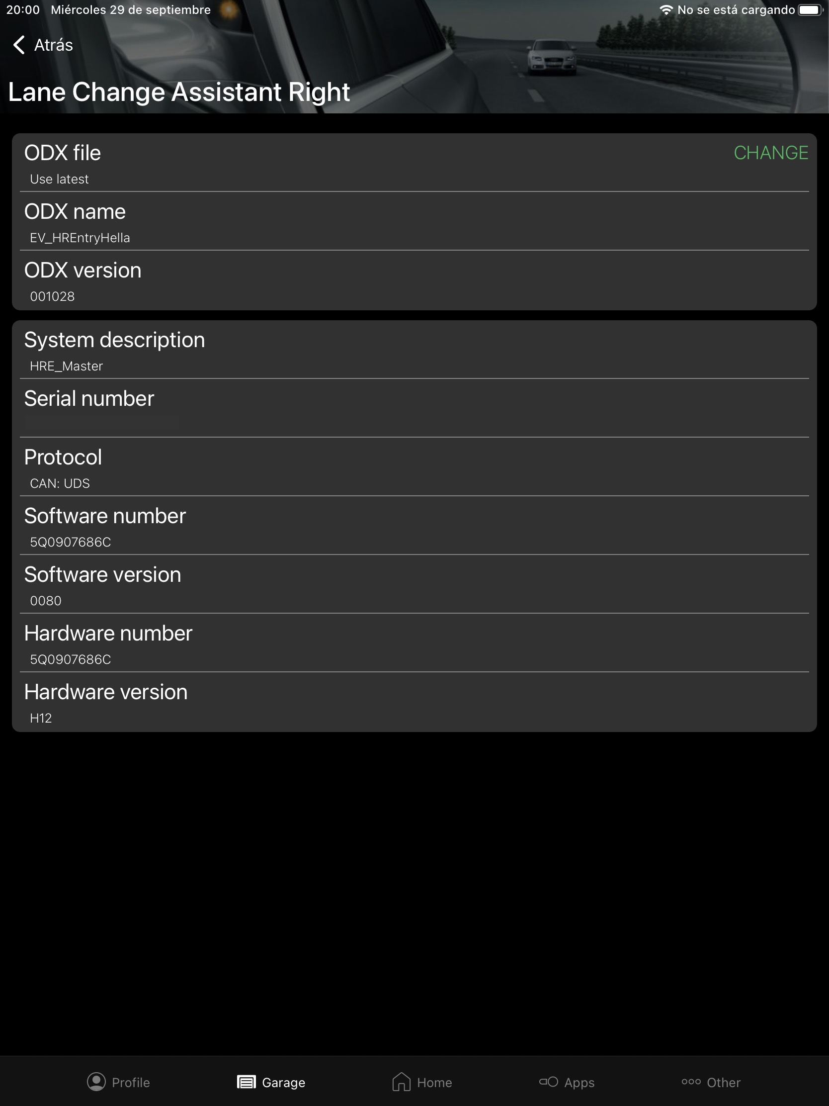

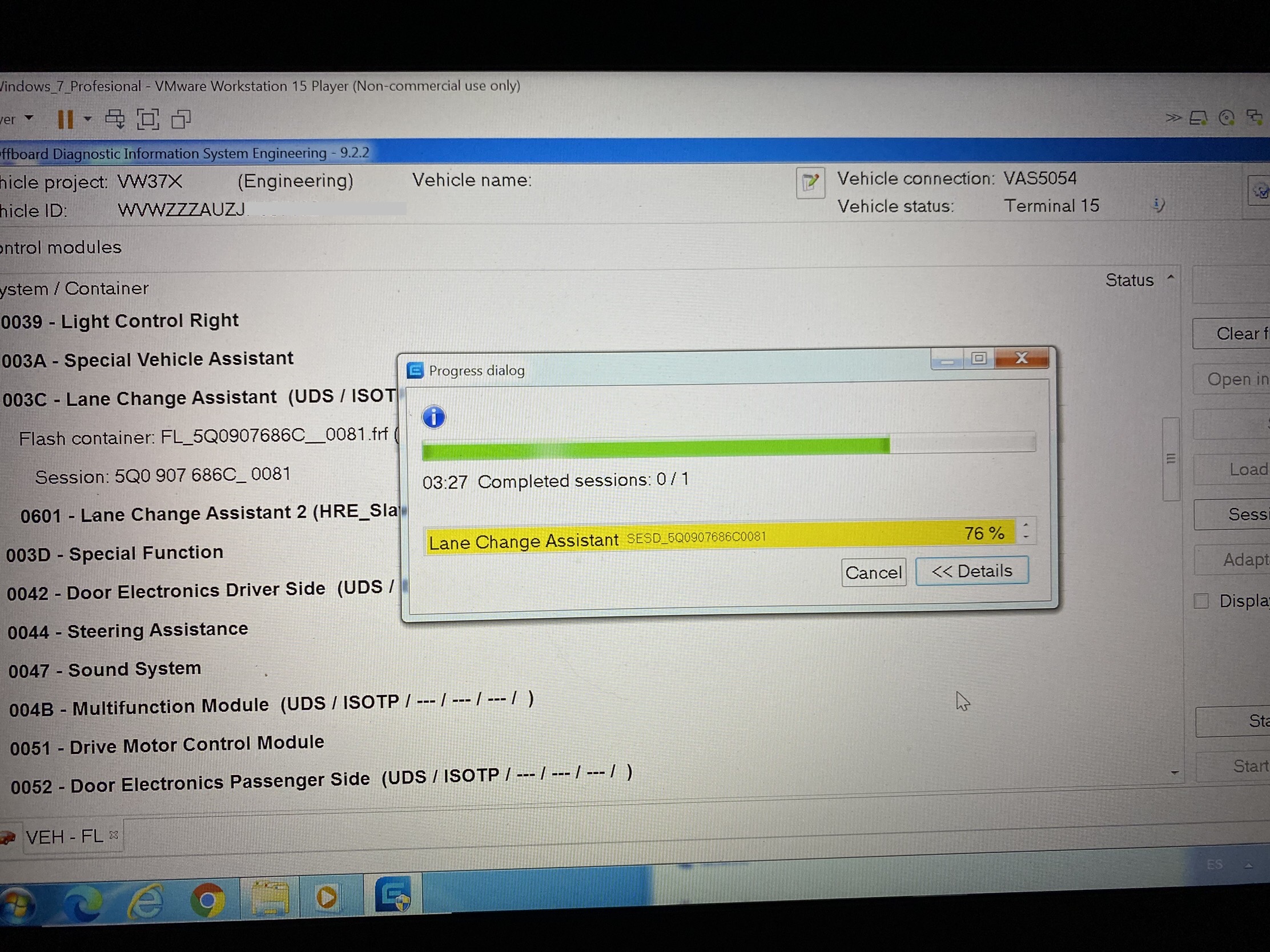

Last Sunday, i updated the 3C module. The firmware file is FL_5Q0907686C__0081.frf and the parameter file for my car golf 7.5 is the V03935258DF versión.
The process was made with odis engineering. I have installed the two odis programs in a virtual machine running windows 7 professional 32 bits. All works fine, except for the little detail that i had not seen the low level of my battery of car. The process was like a christmas tree, all switching on, the virtual cockpit was turned on to the maximum brightness, and errors everywhere flashed and happened next. Luckily the torture lasted only 5 minutes .....
At the end everything was correctly updated to version 0081, from the previous 0080. The coding stayed the same, but the parameter flew...
Do you notice something? .... I see everything the same. all works fine. And the module is updated. I cleaned all the faults.

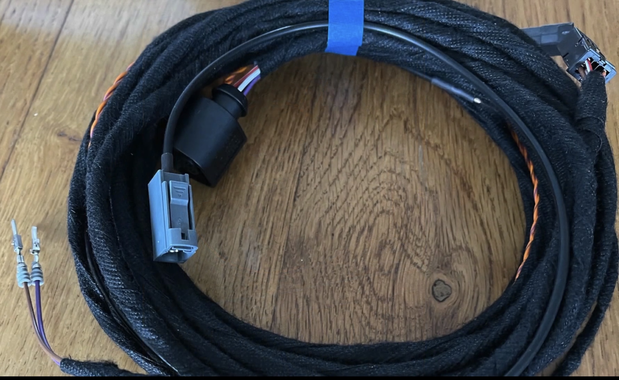

Good morning Fernando.

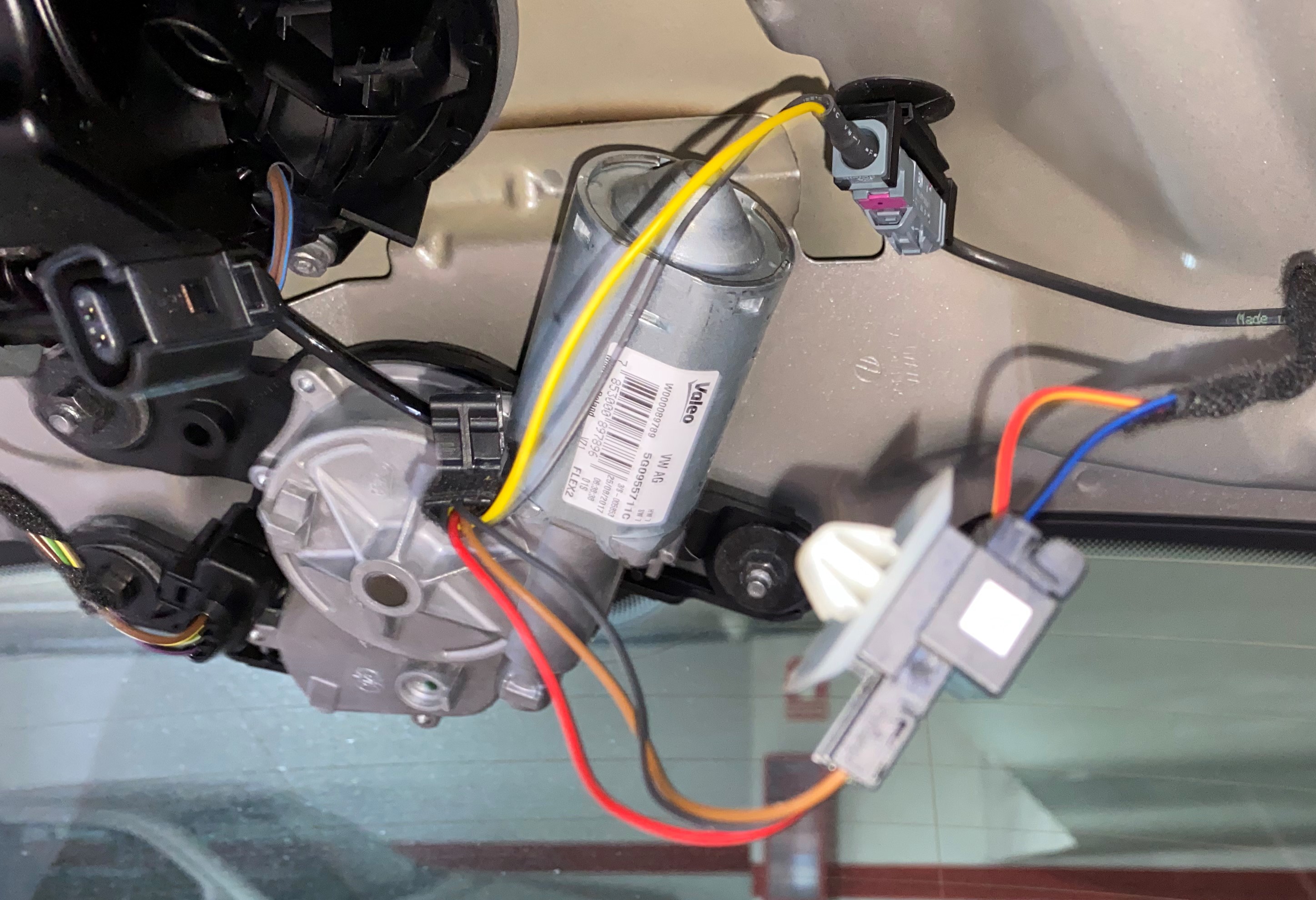

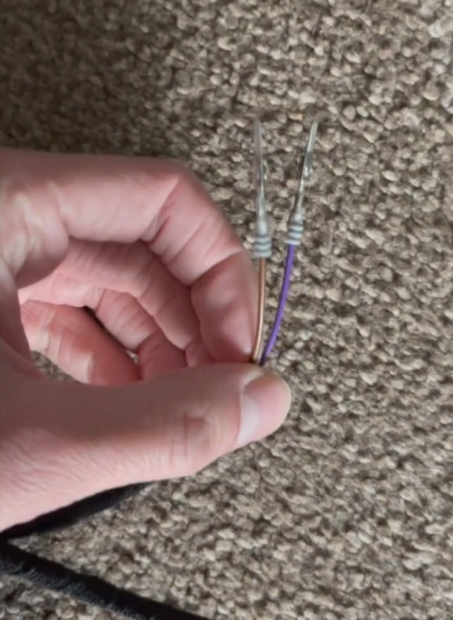

I just received the wires and the camera.
I have a question. In the main wire appears two wires. Where I connect this two wires?
- 14F27FCF-CD45-4D0E-A31D-79242DA46795.jpeg (610.99 KiB) Viewed 21376 times
- F18E24AF-08CF-43E6-A1F0-6BF03B3A2F8C.jpeg (506.03 KiB) Viewed 21377 times
- Posts: 8988
Re: From Stock Golf 7.5 to….
Along with that wiring you must have received a T2 connector that we are going to call 'Adapter', that is where you must insert both wires.
The supposed reason why they are not already installed in the Adapter is that depending on the Golf year manufacture the wires have the numbering of the slots interchanged.
Easy, look at the original T2 connector where you must plug-in said Adapter, and match the wires, brown with brown and violet with violet.

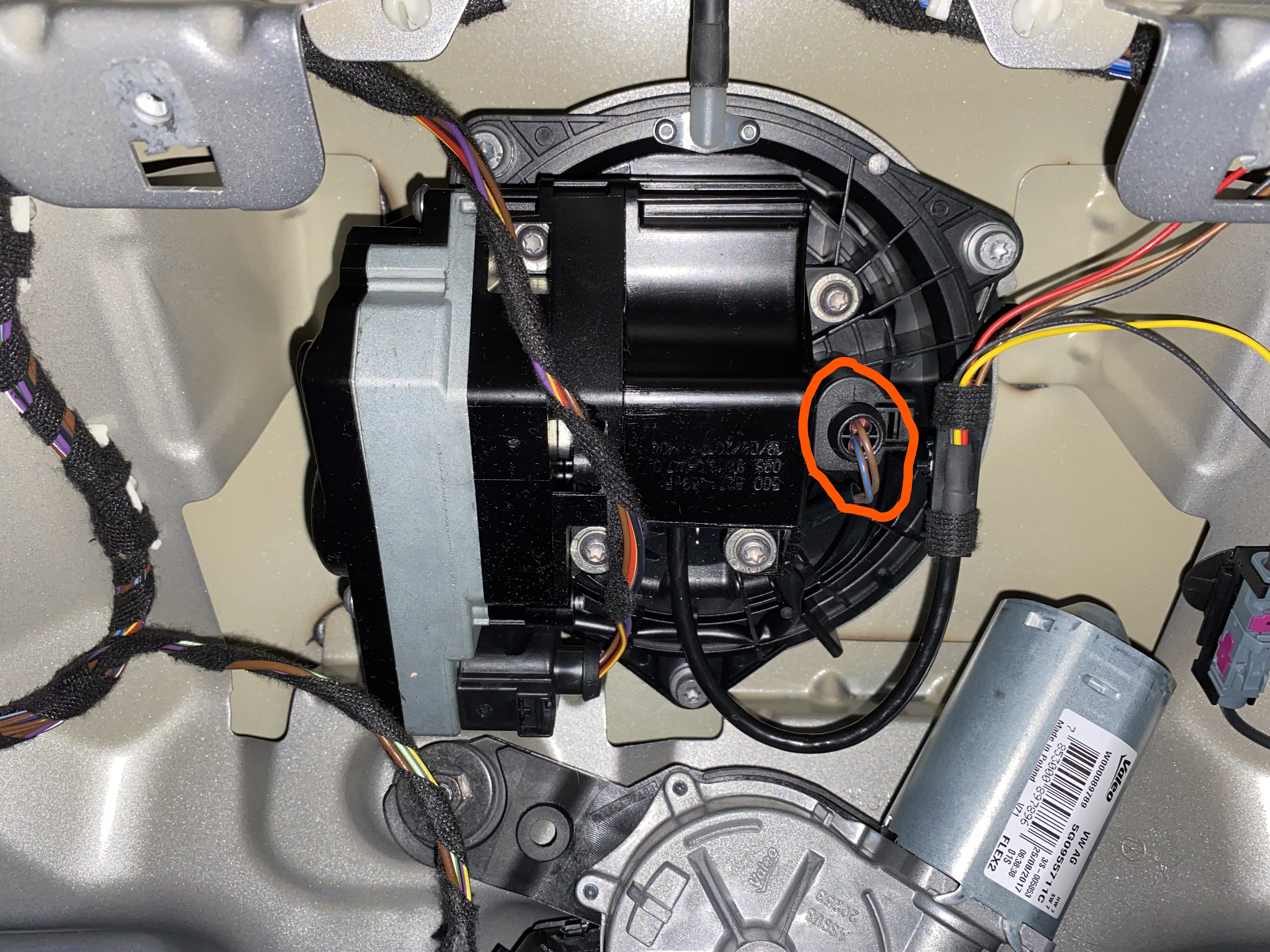

Hello Fernando.
Thanks for your answer and your help. I have the entire area of the camera disassembled. I got all the guts out.
The two cables that I mentioned in the previous post are connected to this connector?
That is, I disconnect it from where it is now and connect it to that adapter?

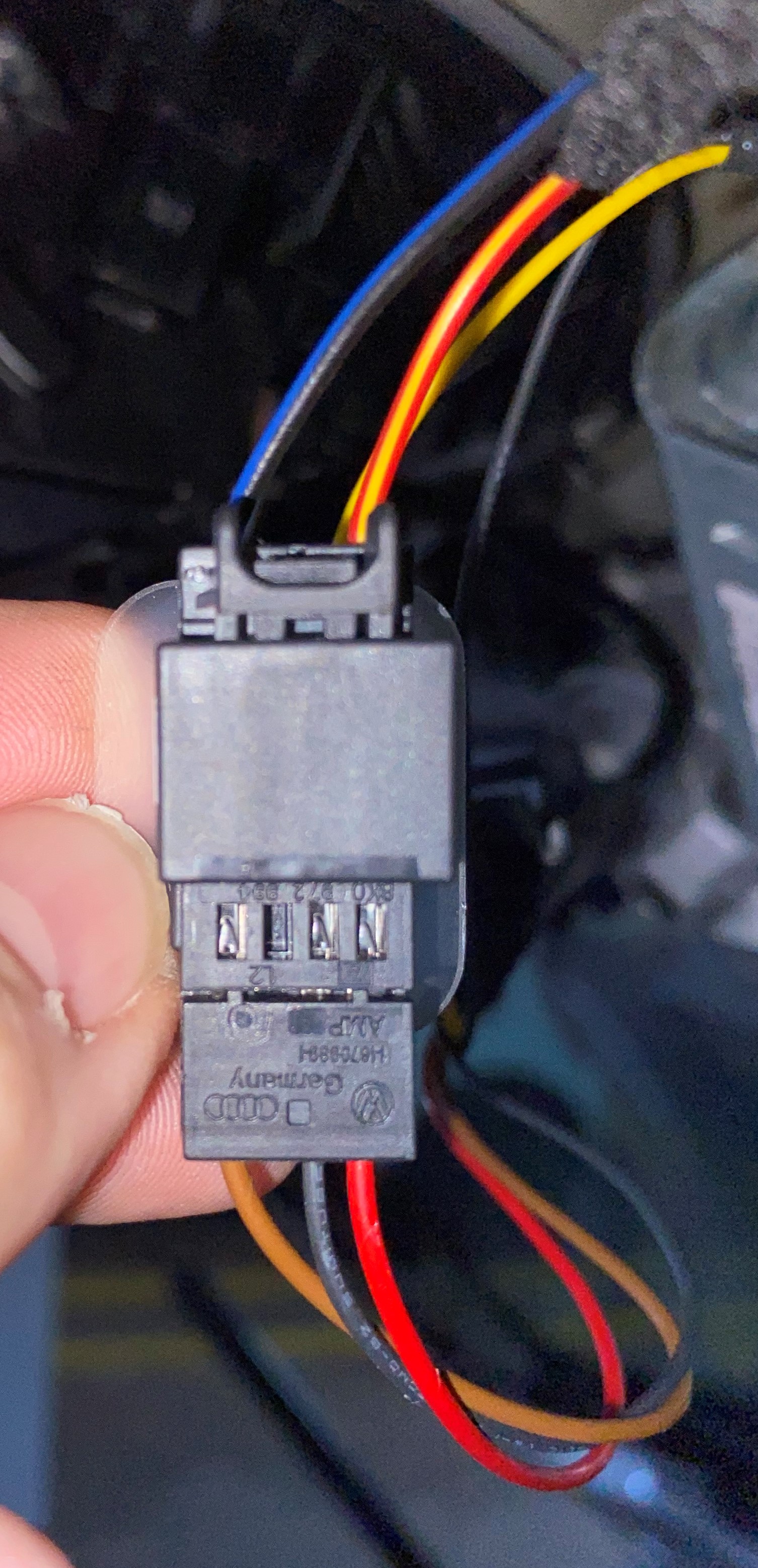

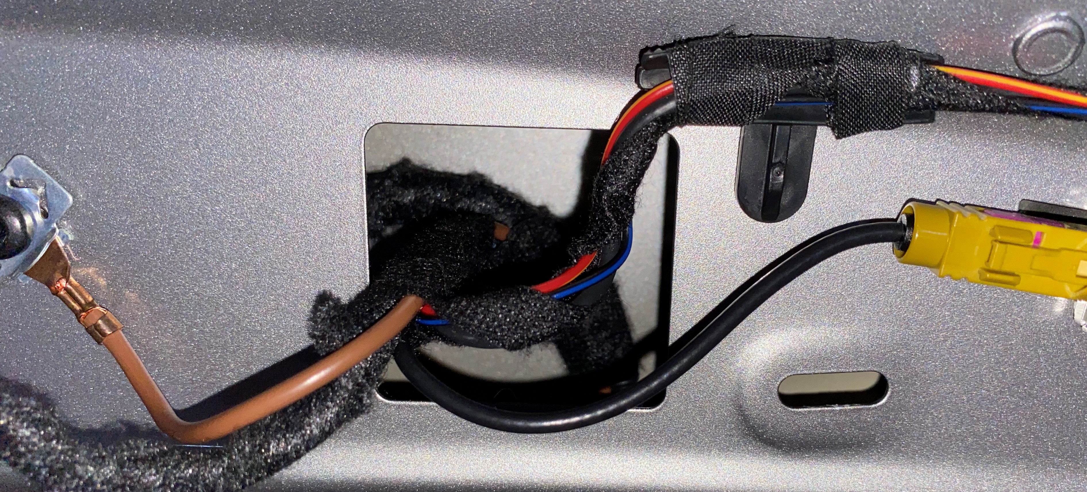

And the second dude, the conexion that exit from the camera (photo named 1) pass from 3 wires to 2 wires (photo named 2)..... and it follow to this point (photo named 3).
The red and yellow wire is the positive (like spain flag) and the other wire black and blue is the negative ?
