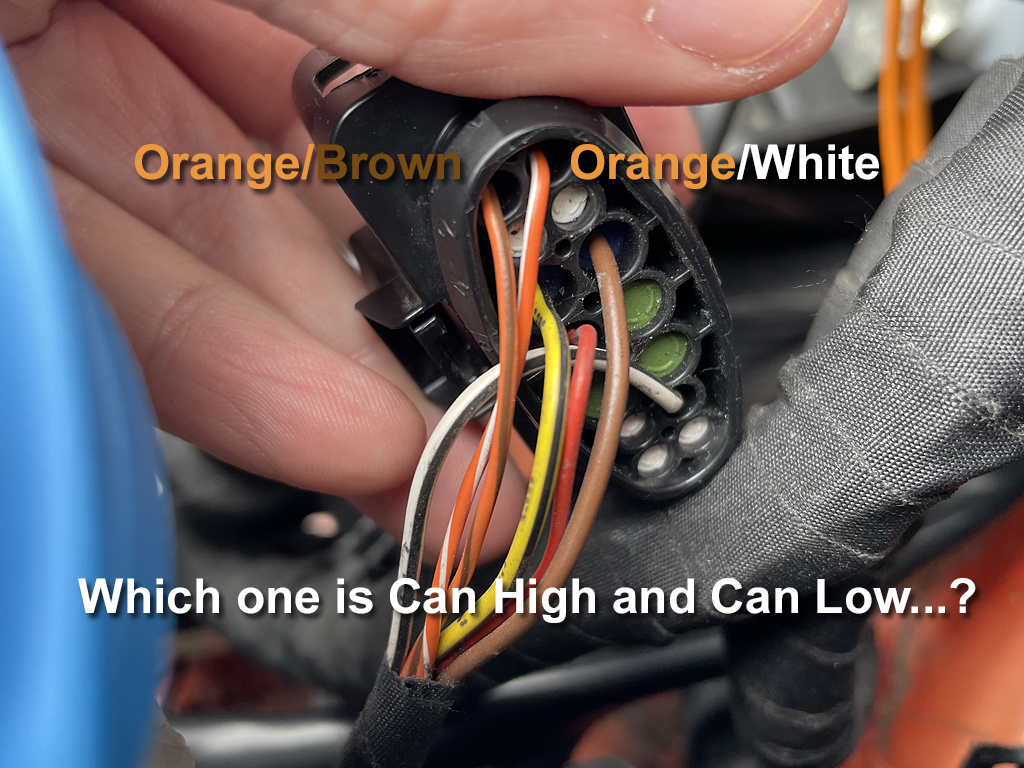

I'm going to add a couple of LED auxilliary lights to my Polo, so I need to tap into the Can Bus system. I got as far as to figure out that the orange cables are Can High and Low, but not which one's what...
The CanM8 is also purchased, so all I need is to figure out this detail before I short circuit the entire system.

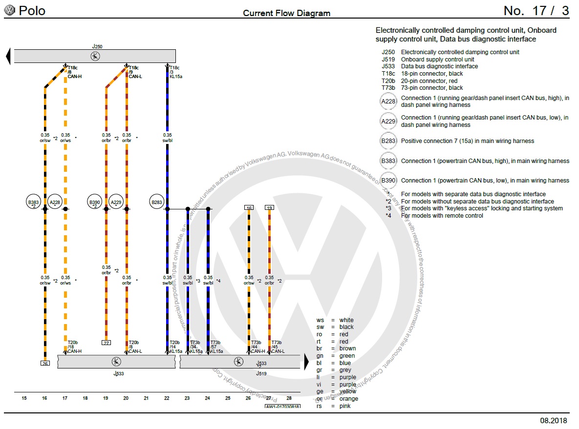

Maybe this will help you:
Posts: 6694
Re: Can Bus High and Low
orange/brown is always low. since brown is always the minus/ground/mass wire, it's easy to remember.

ho8882000 wrote: Thu Sep 30, 2021 6:48 pm Maybe this will help you:
Hey, thanks a lot!! That was awesome of you 8)
Now I just need to wait for the rain to end, because removing the entire front is something I like to do while dry...
Thanks again :D
