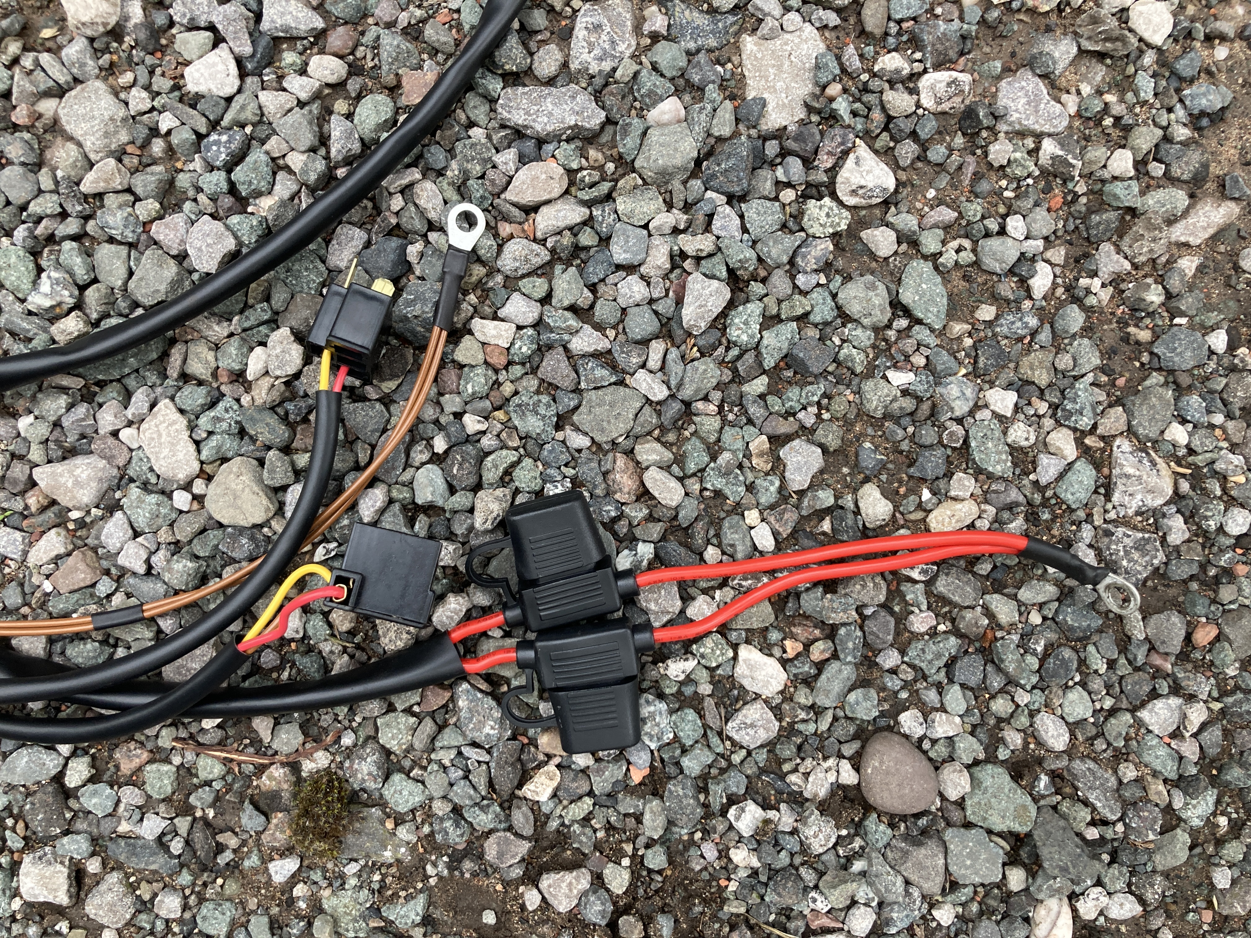

I have the male connector, one of the h4 connectors, the live feed and the relays all bunched up in the one I’ve bought, just doesn’t seem long enough to me

Ah, you have a relay loom for brighter lights
Basically, you need to connect the red to the + on the battery, brown to the chassis or - on the battery
The existing headlamp plug goes into the male plug, then the female plug goes onto the back of your bulbs
Can you post a pic up of the full new headlamp loom?

So has the current loom plug? to be plugged into the male connector?
If so then the cable is nowhere near long enough.

Pop up a pic of the full loom so I can work it out visually

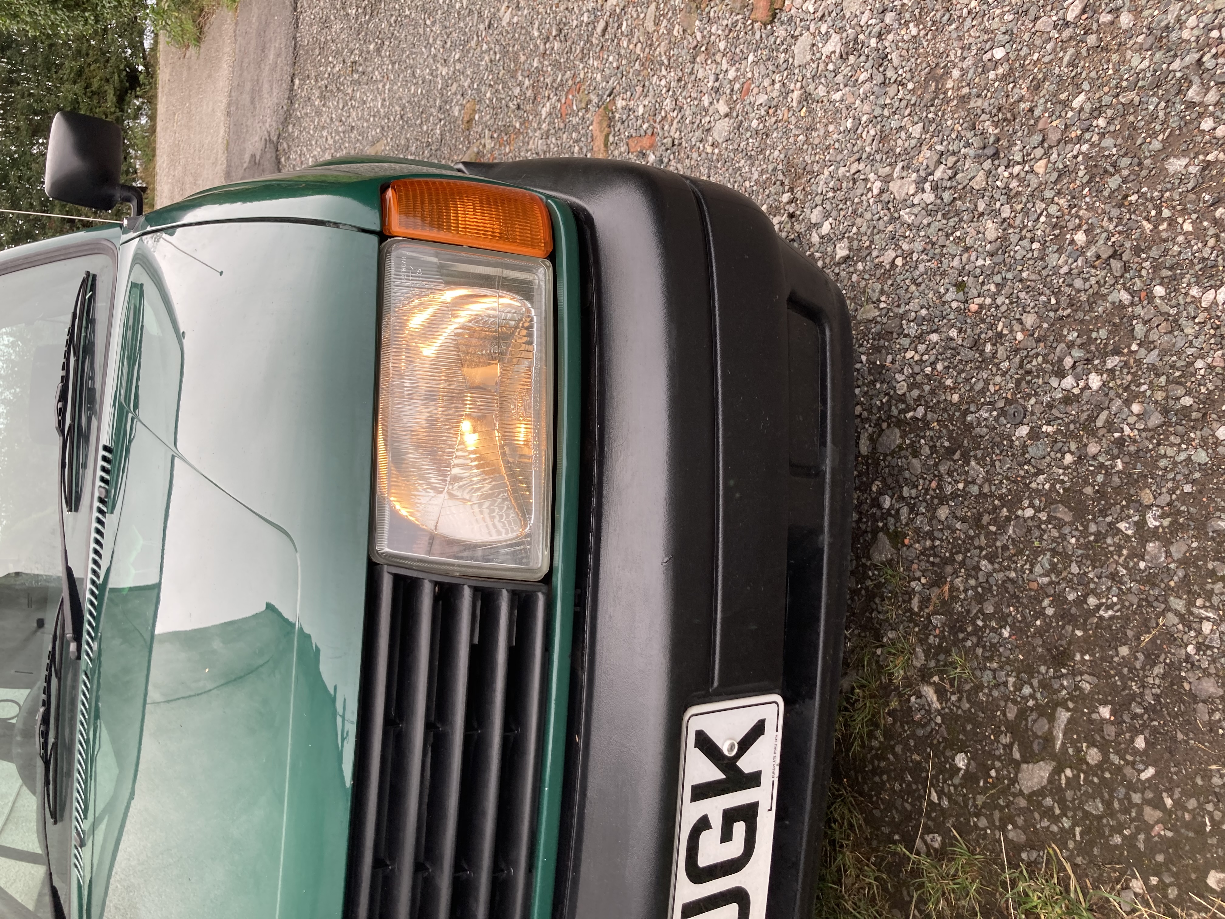

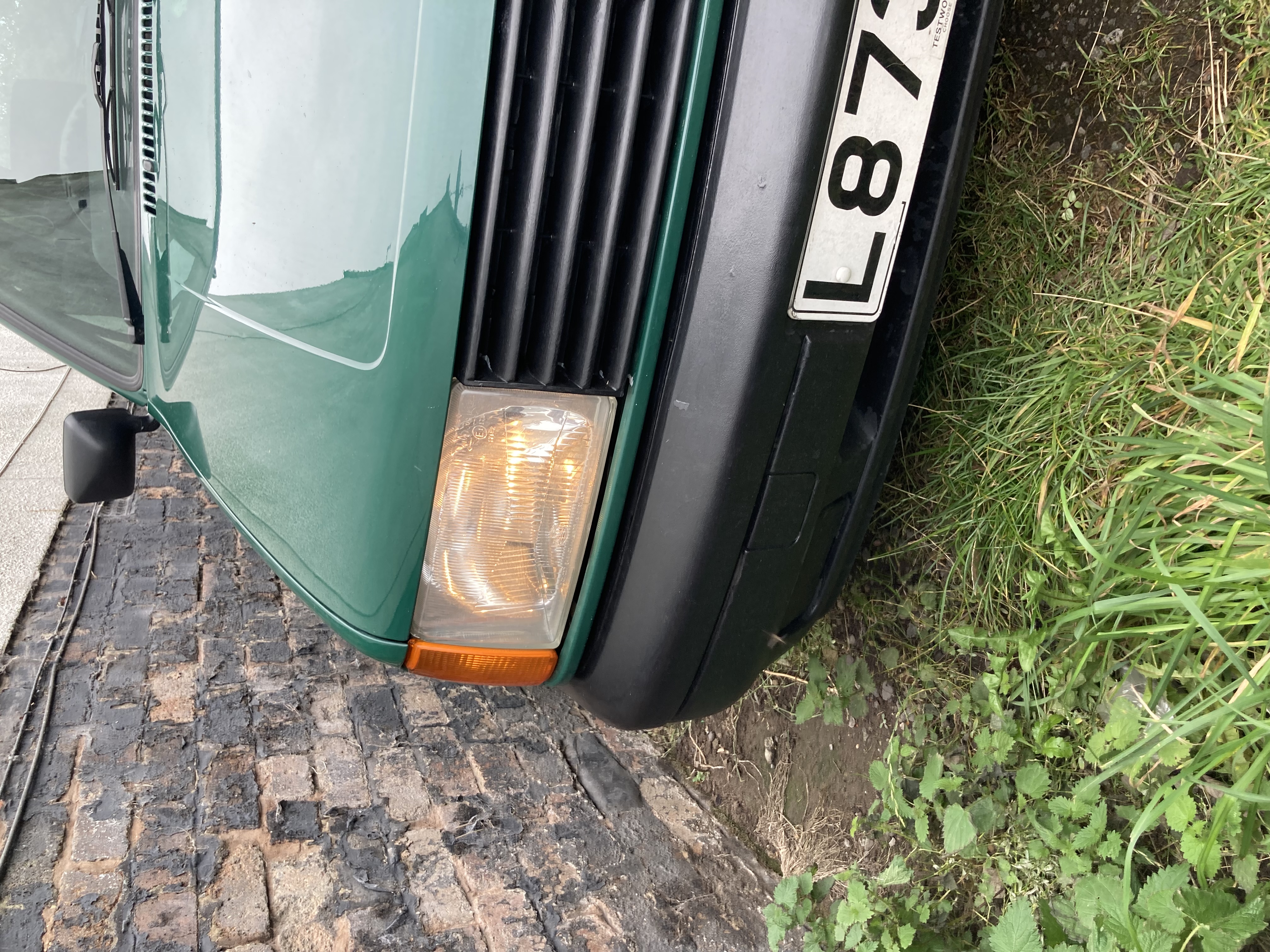

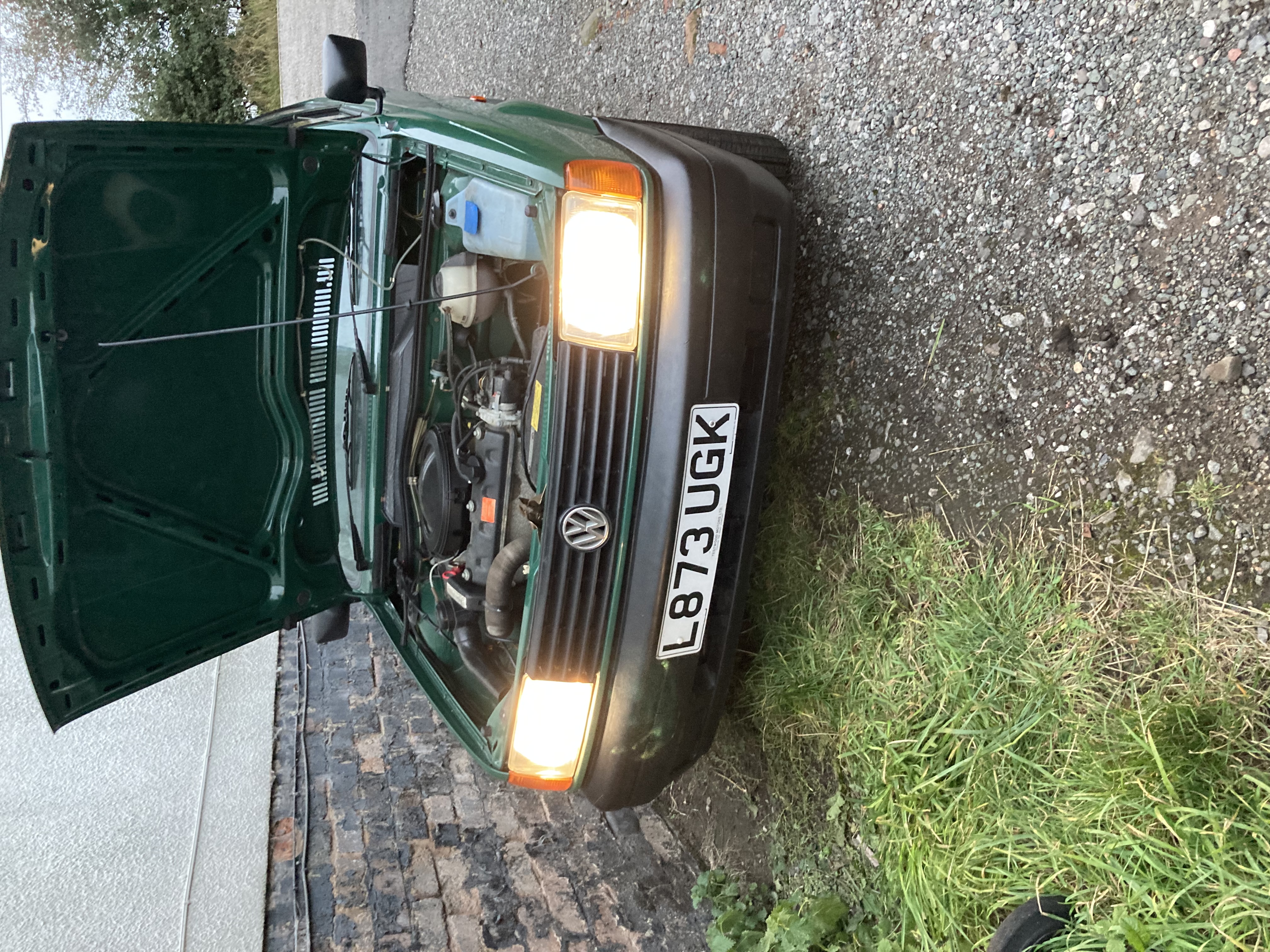

It’s alright mate i cracked it, really appreciate the help!
Some before and after pics

Big improvement mate!!

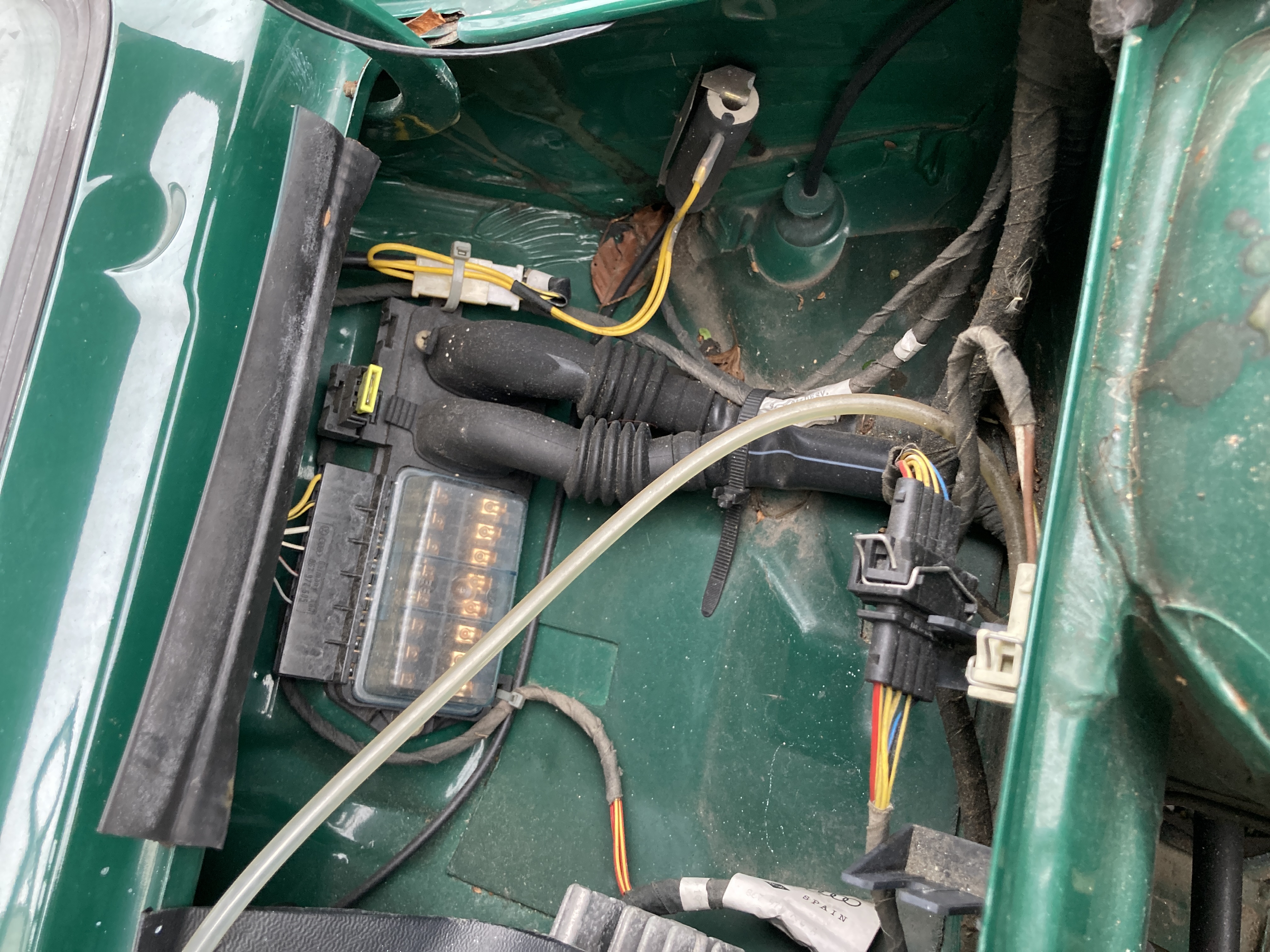

Also, I’d disconnect the big coil resistor with the yellow wires by the fuse box. They have a habit of bursting into flames as they overheat
