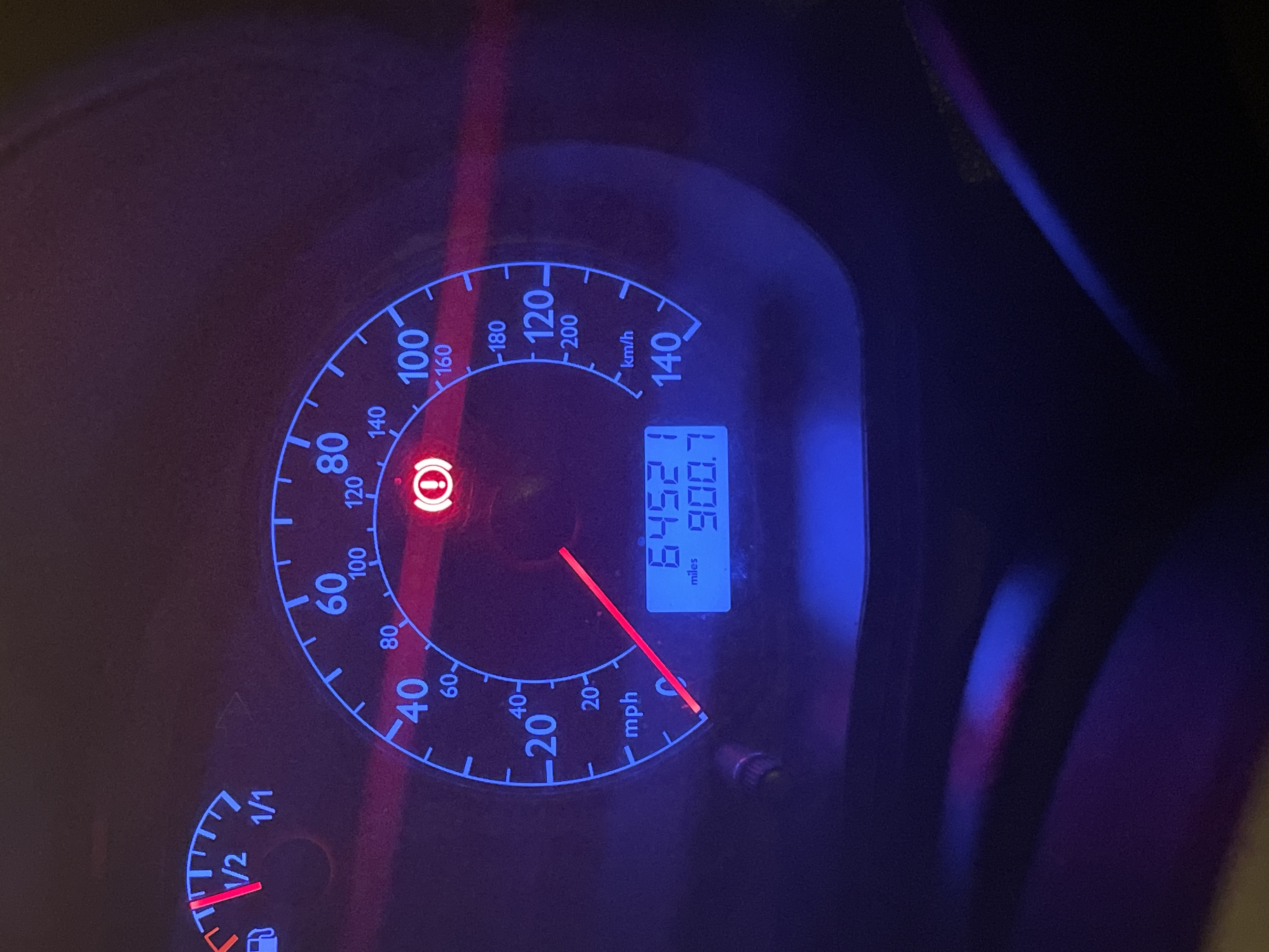

So are you sure its the parking brake symbol on the dash ? not the low brake pad warning lamp or low fluid level warning lamp ?
you can post a picture if your unsure

I’ve also got a video but I don’t think I can attach it here.
