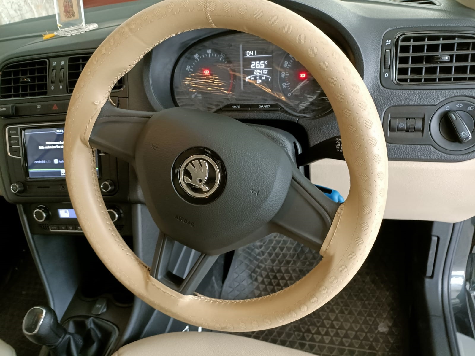

i have skoda rapid rider 2020(india) petrol 10. TSI. Its a PQ25 car.
My current instrument cluster is: 5J5920860H
BCM: 7E0937089D
Steering control : 1S2909144P

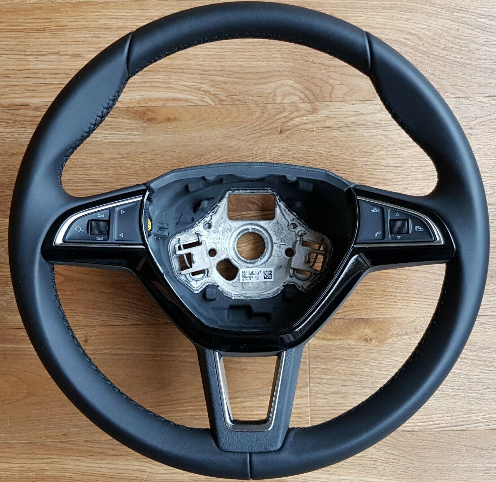

I am planning buy steering wheel with part no "3V0 419 091 L CWE"
1. Will this fit my car?
2. Also since i dont have MSFW in my car. I believe i will need harness.
Will airbag/steering harness "5JA971584" go with "3V0 419 091 L CWE".?
Current Steering
Current Steering
current steering.jpg (325.07 KiB) Viewed 64011 times
Proposed steering
Proposed steering
3V0 419 091l CWE.jpg (422.38 KiB) Viewed 64011 times

I am not an expert on the subject but I don't believe that those buttons are going to work for you.
Steering wheel will fit physically, but the button wont work cause they are from Suberb III (3V0).
When it comes to PQ25 and MFSW I would recommend you sticking with buttons ppl have tried before.
I have a list with the tested buttons an old post of mine
viewtopic.php?p=561978#p561978
I general you need to look for steering wheels with code 3T0 (Suberb II facelift)
airbag/steering harness you say, I believe it should work, provided you install the 2 missing cables at T41 connector
viewtopic.php?t=54171

I also figured i will need either 5E0919719E or 5E0919719F for switches
