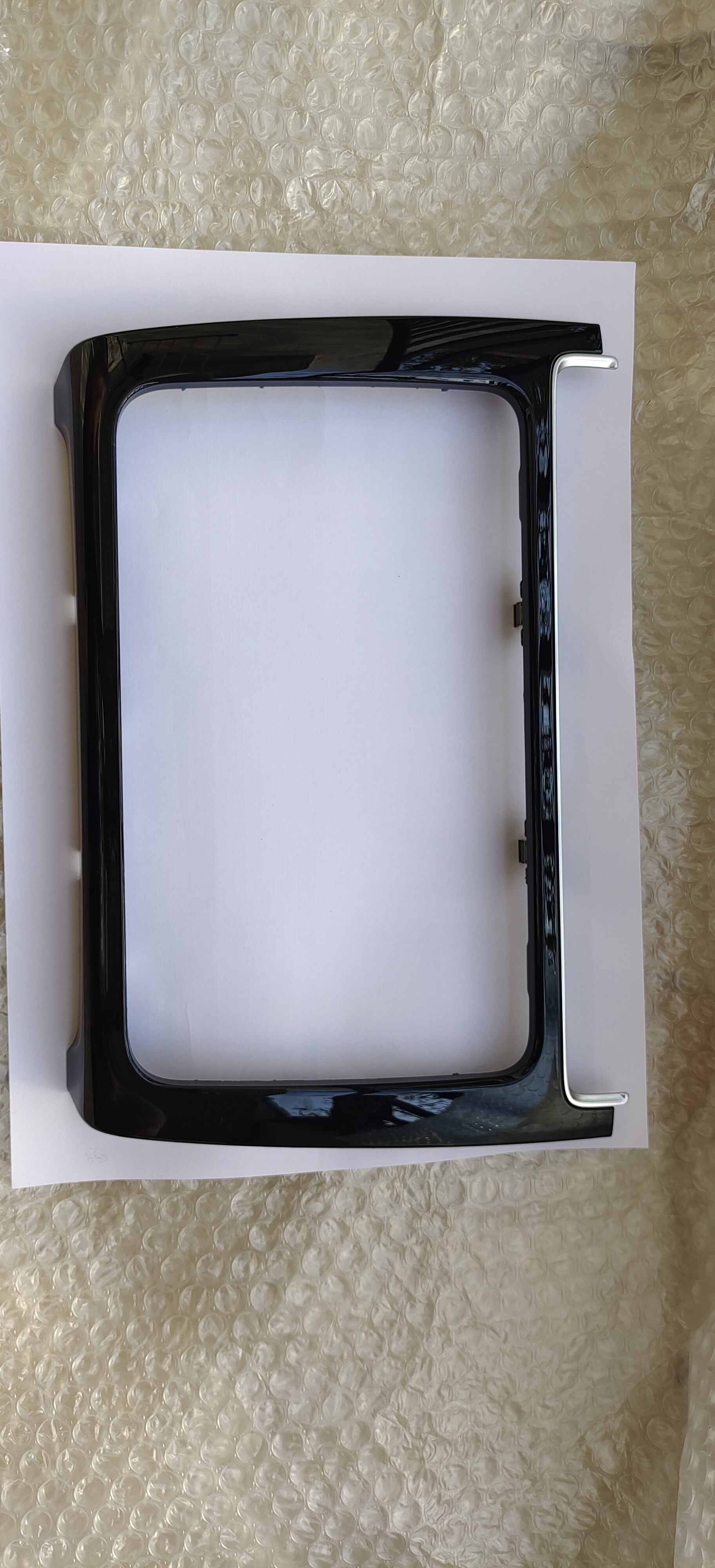

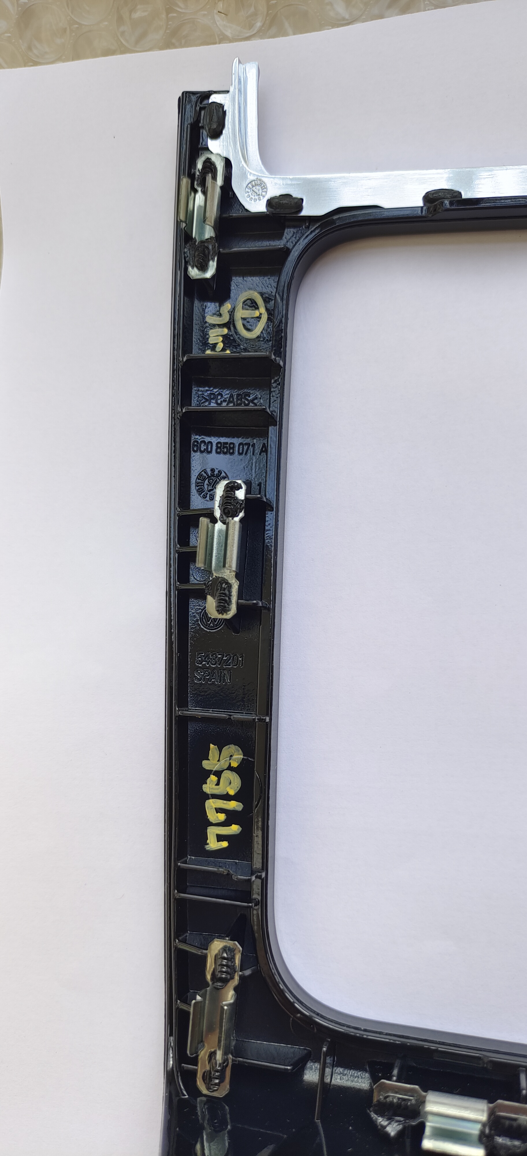

Found 6C infotainment system trim in Japan. And I Got it . Its a used one. But in super clean condition.
6C0 858 071 A
this trim came in Japan Polo GTI.
Adding picture
- IMG_20220128_090024.jpg (1.79 MiB) Viewed 5910 times
- IMG_20220128_090042.jpg (1.64 MiB) Viewed 5910 times
