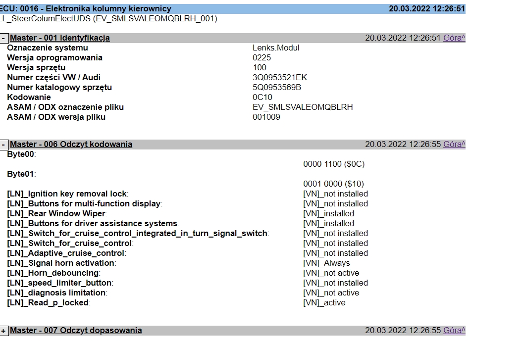

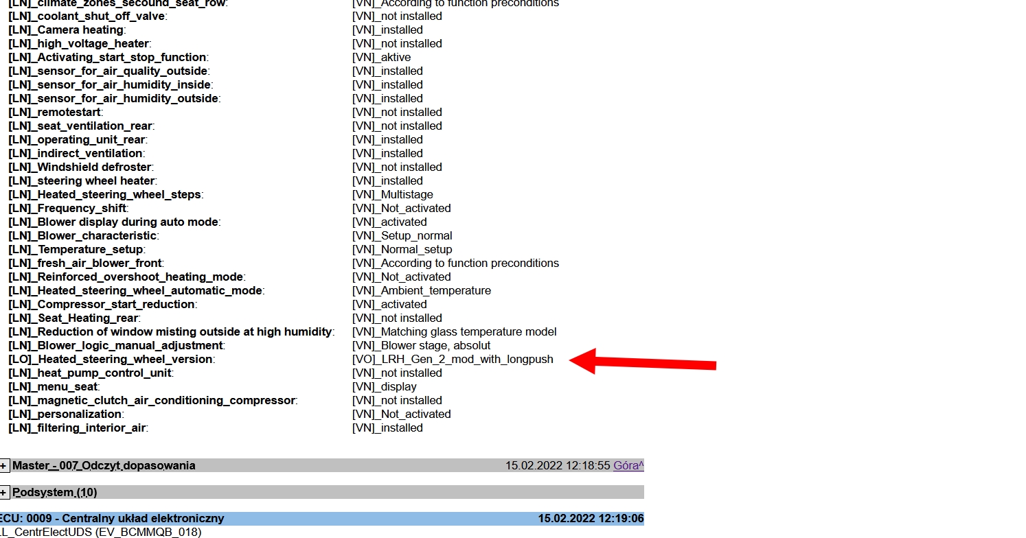

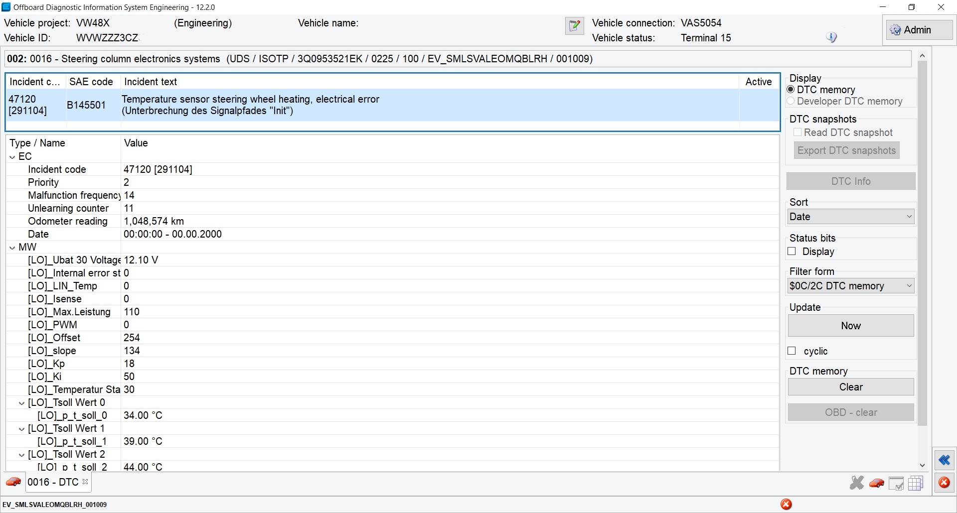

Hello the heated steering wheel button works :D but the "VIEW" button does not work for me :P
I installed PLA 3.0 :) works very cool :P
https://youtu.be/MUoZFf2Khyo
5G0919398A
5G0919397A
5G0919400F
5G0919399F
Module 5q0919298d
Sensor:
5Q0919297B 2x
5Q0919275B 2x
Plug:
4h0973703 2x
4h0973703A 2x
Will the TMPS module do well in this place?
I am thinking of colored lighting, but I would have to change bcm :x
Thanky You

Do you know how to solve my problem on Passat B8?
