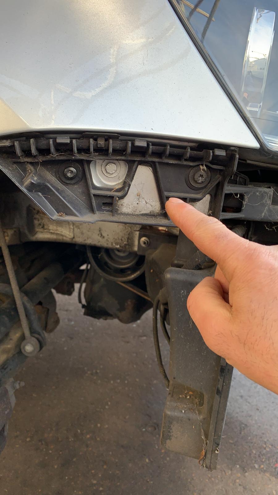

What bracket is this? Bumper to left wing bracket under headlamp?

Hi guys
Had excellent help here before so trying again, the part supposedly sits below the left headlamp and it’s job is to connect the front bumper to the left wing. I have replaced the left wing, about to replace the headlamp and fit a new front bumper and bonnet.
Attached is an image of my car pointing at the damaged bracket that needs replacing; searching online I find two products that sound like they’re what I need, but neither of them looks similar:
https://www.ebay.co.uk/itm/332932547229 ... SwJ7RfrRW5
https://www.ebay.co.uk/p/1317046521
Does any one know what the part it is that I need? It’s the one I’ve attached. Thanks!!

Edit: 2010 Polo 1.4L petrol SE model.

the bracket is part of the headlight carrier, so the one in your first link.
