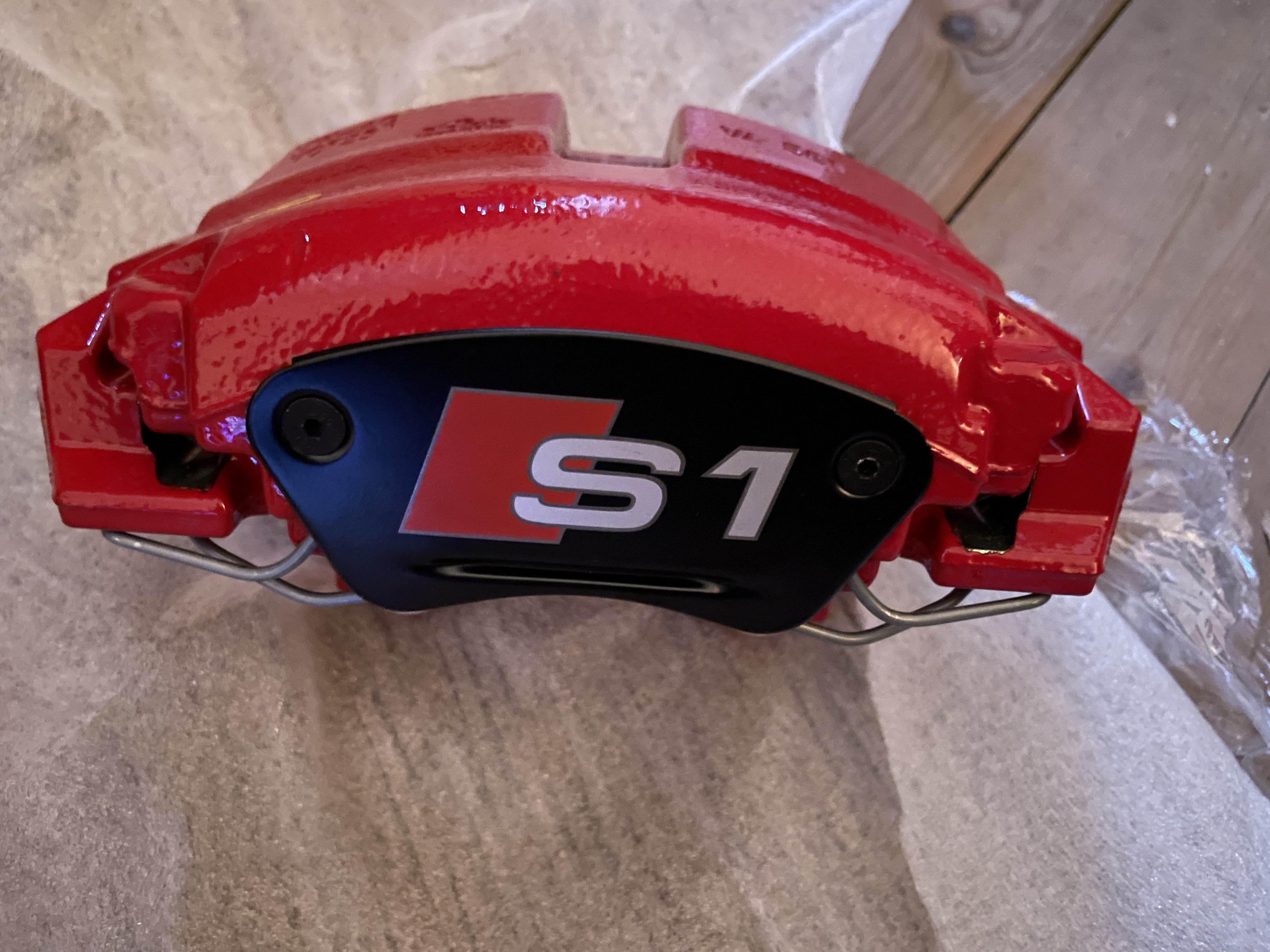

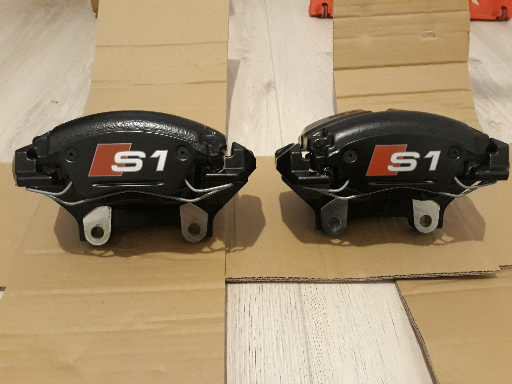

Likely 288 or 312mm with Audi S1 caps

Na 99% są to zaciski z audi s1 8X0615123A, 8X0615124A. Plus tej blaszki jest taki że jest przykręcana i można ją odkręcić i pomalować jak się chce :wink:

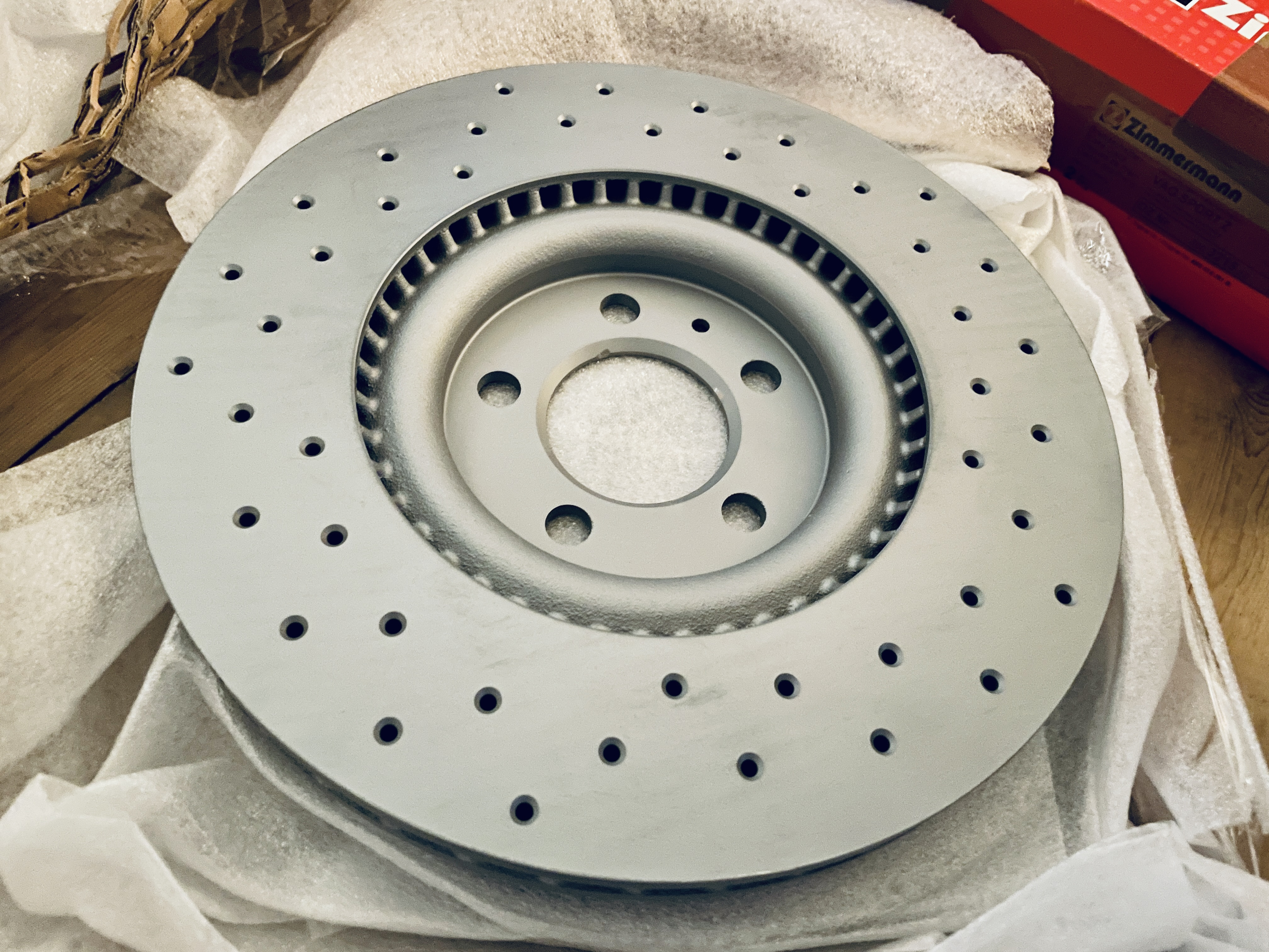

What brakes are you running on the front there Peter, looks like some Audi RS?
Close :-)
Audi S1 brakes and Zimmermann 310 mm sportdiscs

Thanks Peter, did you have to make any modifications to fit them or are they a bolt-on upgrade? I believe these are the same brake callipers as a GTI right?
Re: Polo 6R/6C Photo Gallery
It's a bolt-on upgrade (only change the carriers) if you have the 288mm setup.

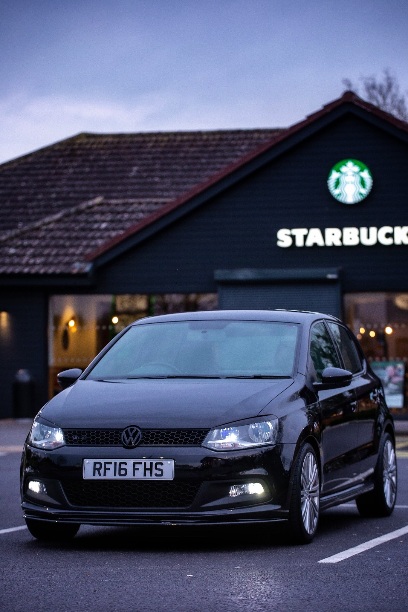

Here's my Blue GT, I've completed the 6R GTI front end swap including a TRC front splitter. For the lower grill sections, I painted them with black PlastiDip to get rid of the horrible grey finish for a more blended appearance with the bumper! Next up, I've got some Porsche wheels waiting to go on...

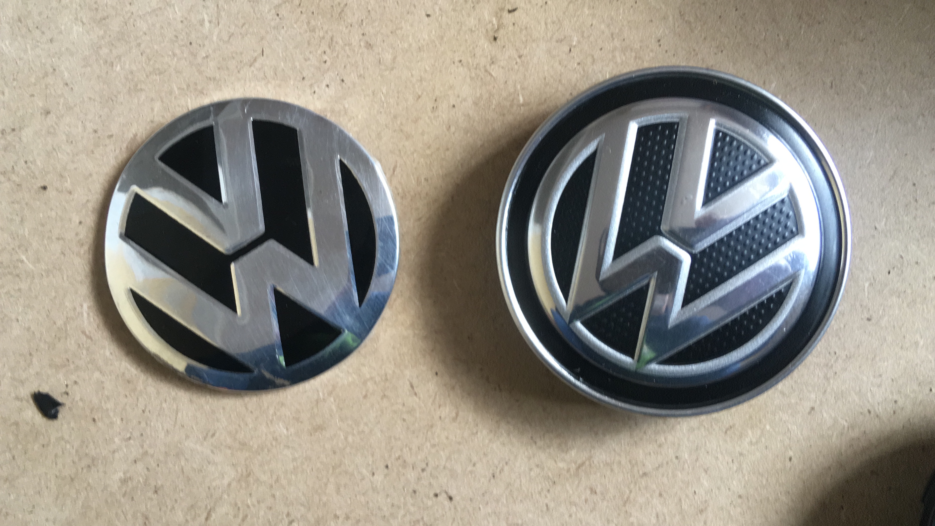

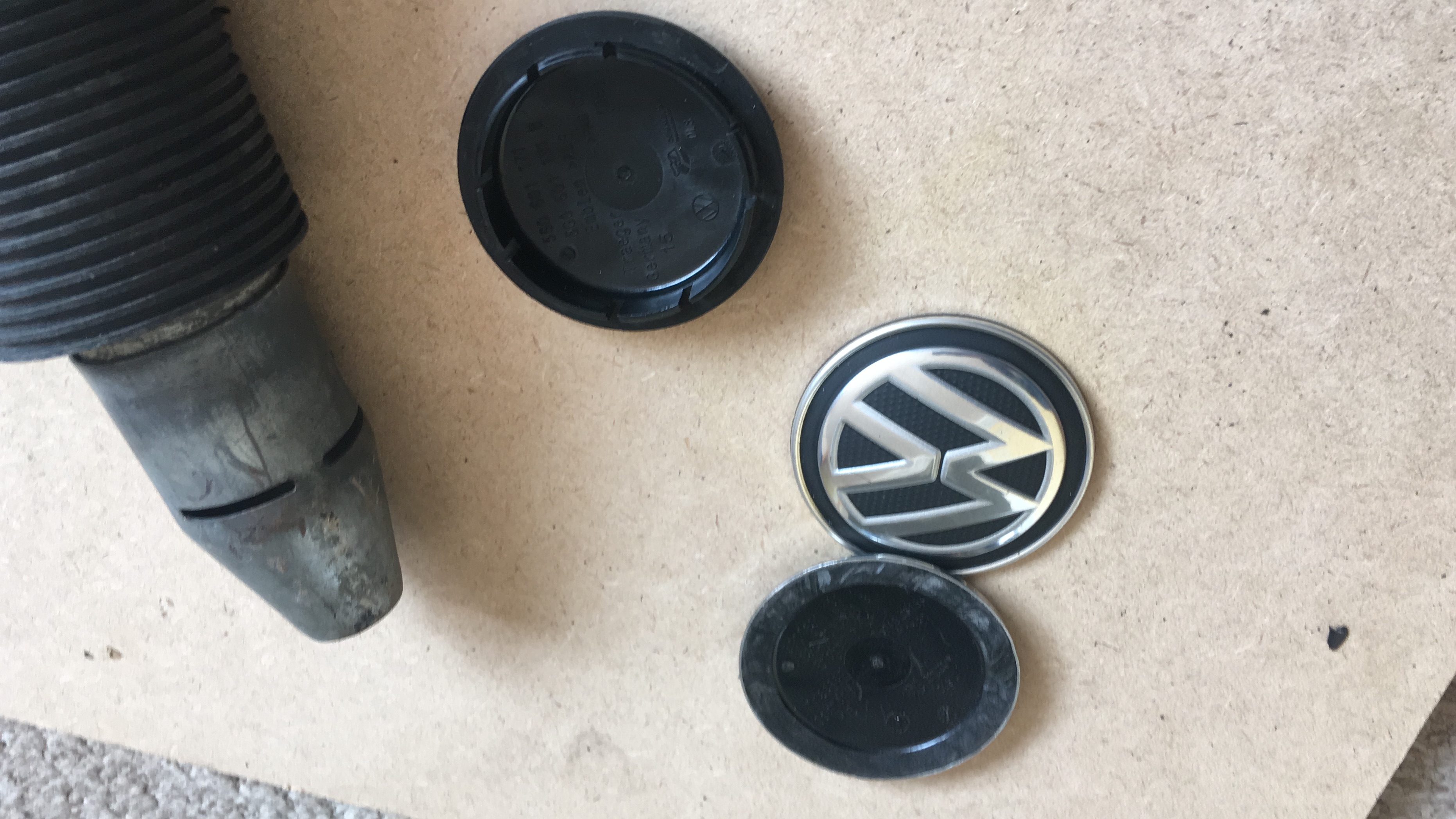

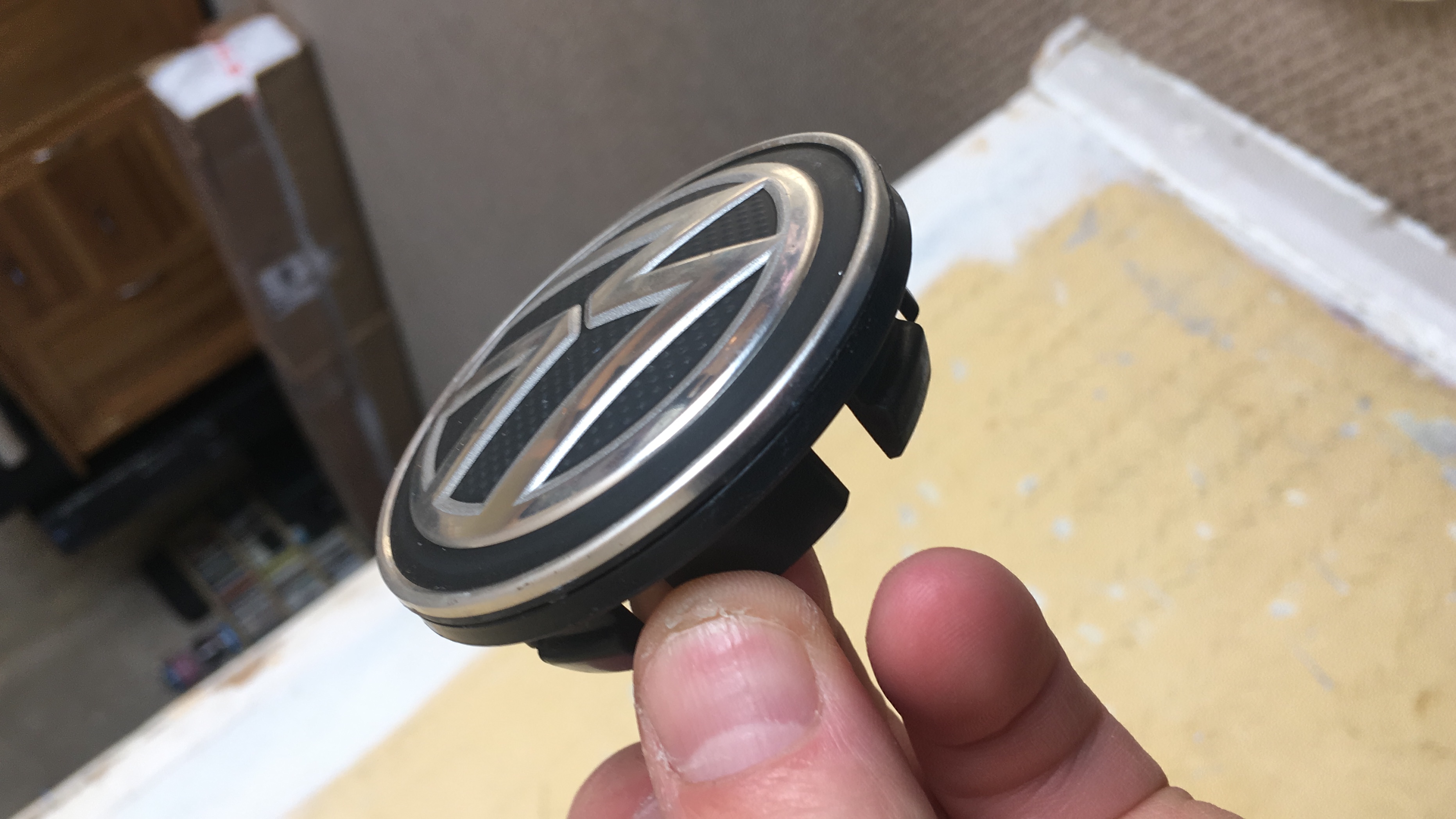

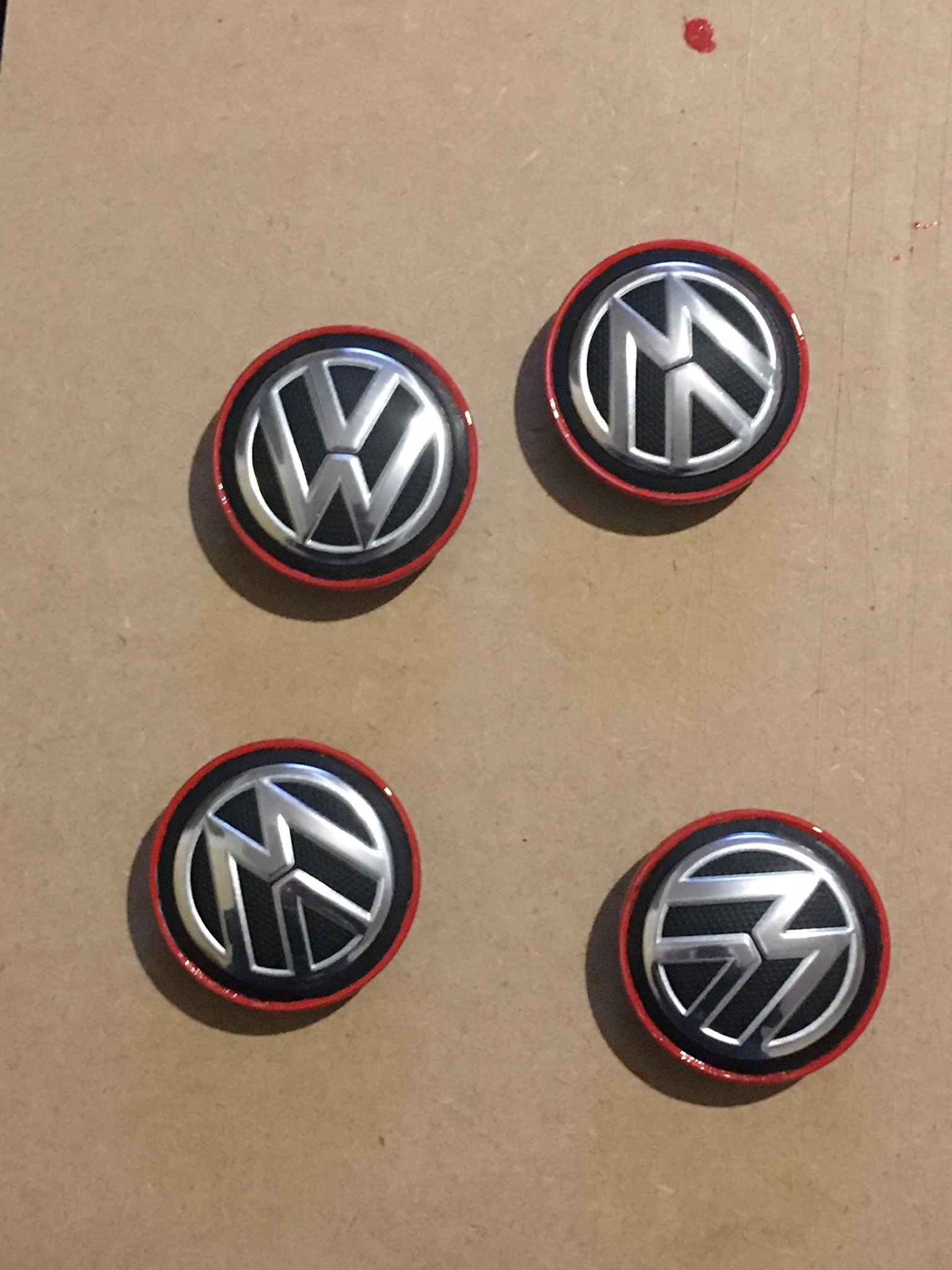

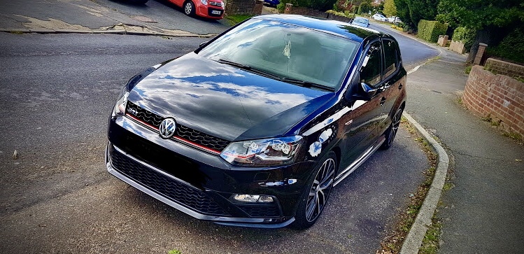

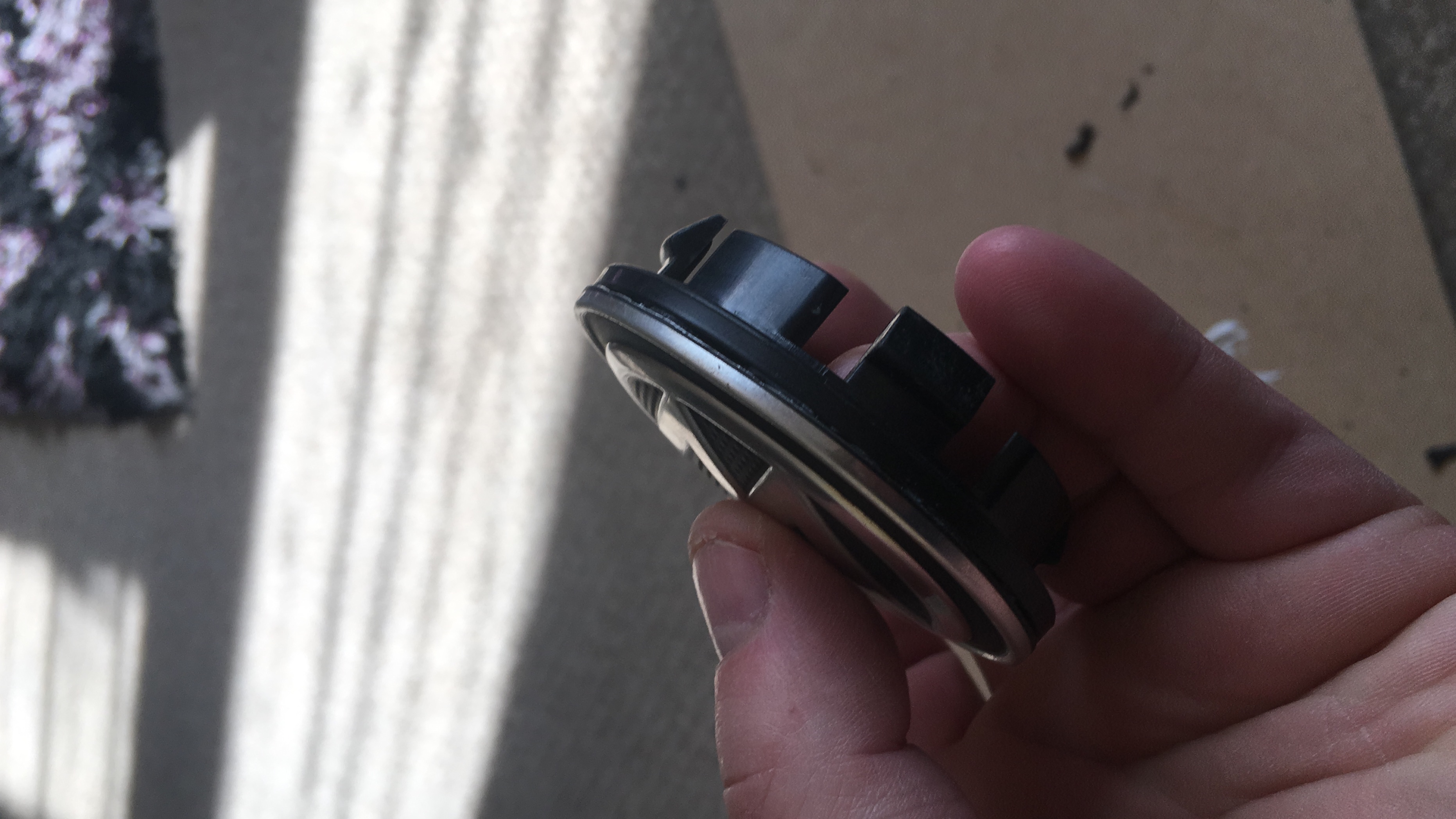

I purchaced a set of aftermarket alloys that look exactly the same as the original wheels the polo came with, i curved the original alloys so needed to refurb them, the only issue was that the hub logo’s were smaller than the original one on the original alloys, i looked online for some hub logo’s & i saw the golf gti hub logo’s which looked smart but they were being sold from dealers for £75 a set so i wernt paying that so i purchaced a set of caddy hub logo’s secondhand in great condition which have the same details as the smaller ones that came with my polo, purchased some red heat resistant spaypaint & some lacquer & made some golf gti center caps, for a fraction of the price , i use the backs of the caps that came with the aftermarket alloys because the caddy ones wouldnt clip in the alloy as the clip bits were shorter so i spliced & grafted them to fit & hold tight in the alloys, then painted & varnished them , they came up a treat & looked well polished against the new alloys , to this day they are still looking good , the pic of my car was before i done the caps , but thats my polo 2016 gti 1.8 192hp tsi bm all waxed & machine polished .😁
