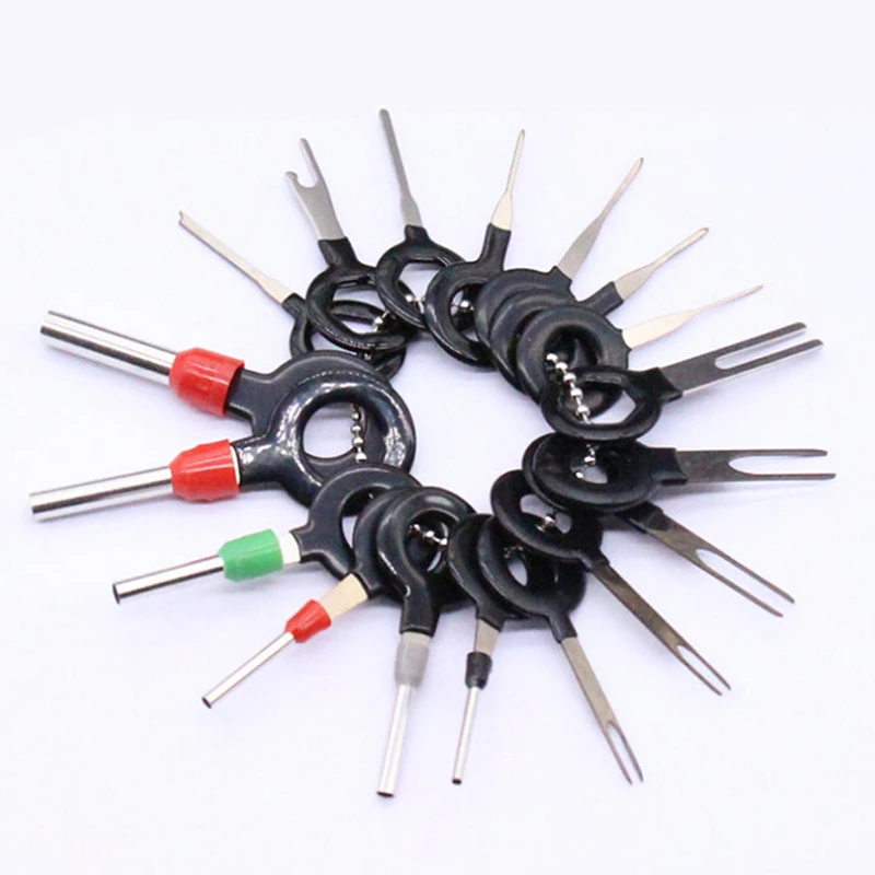

These types of cheap tools are very effective for these jobs with small terminals:
https://ae01.alicdn.com/kf/HTB1lzvlX5zx ... .jpg_.webp
You can find them on Ali, ... with the most basic and cheap kit it will be enough. I recommend you buy two.

I have just managed to get the pin 29 sorted. I did break part of the blank off. so for all that don't know you need to pull the bottom of the connector down and the purple lock in through the side, seems like the bottom coming down exposes the purple lock.
Once I had the wire guide down I could move the silicone gasket that's inside down then I was able to push the broken part down from the front with a pin and grab it from the back with tweezers.
Nothing has changed the cruise light doesn't come on the dash when I flick it. Hopefully I can get that 1 bit coded to the ecu and it will work.
