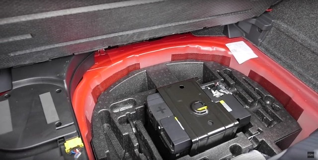

I’m not sure the Helix sub would fit in the Polo GTI. My understanding is that the Helix sits in the spare wheel well, and you have to sacrifice your space saver spare wheel if you have one. With the AW Polo GTI, in the bottom of the spare wheel well is the car’s battery with the car’s tool kit in a polystyrene holder around the battery and for cars that have a space saver spare wheel, the space saver fits on top of the battery. With everything in place looks like this;

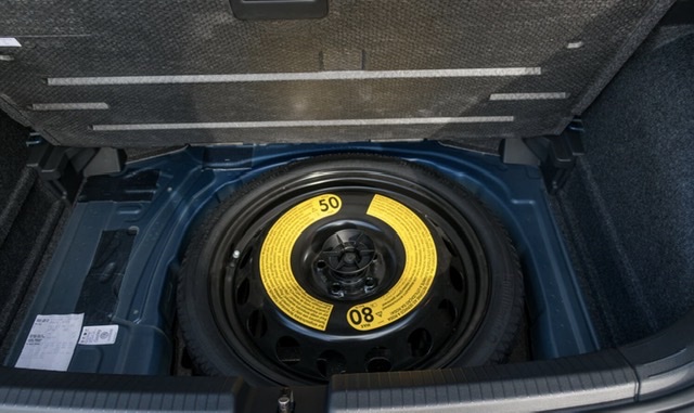

And this is how much space there is in the spare wheel wheel with the space saver spare removed or in cars that don’t have a space saver spare wheel (this picture has the Beats sub in the space to the left of the spare wheel well);
