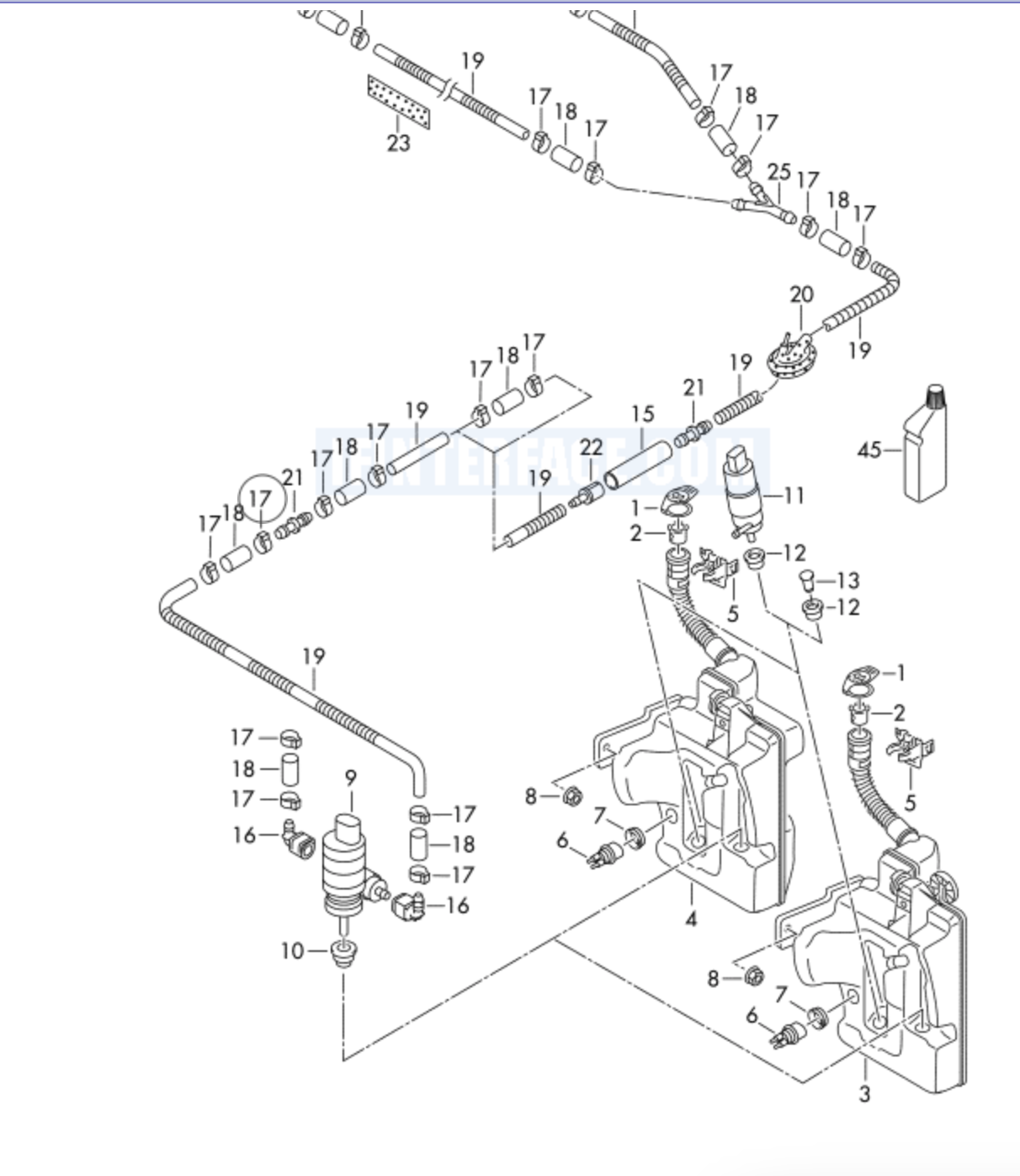

I have no issues with you doubting me. I'm a scientist, we do it all the time. So that's fine.
if you look at the catalogue, it's a separate part, so that means it's replacable.
Screenshot 2022-11-22 at 12.29.25.png (434.37 KiB) Viewed 1239 times
There is no mention in the workshop manual to replace it, but I've replace a sensor before.
