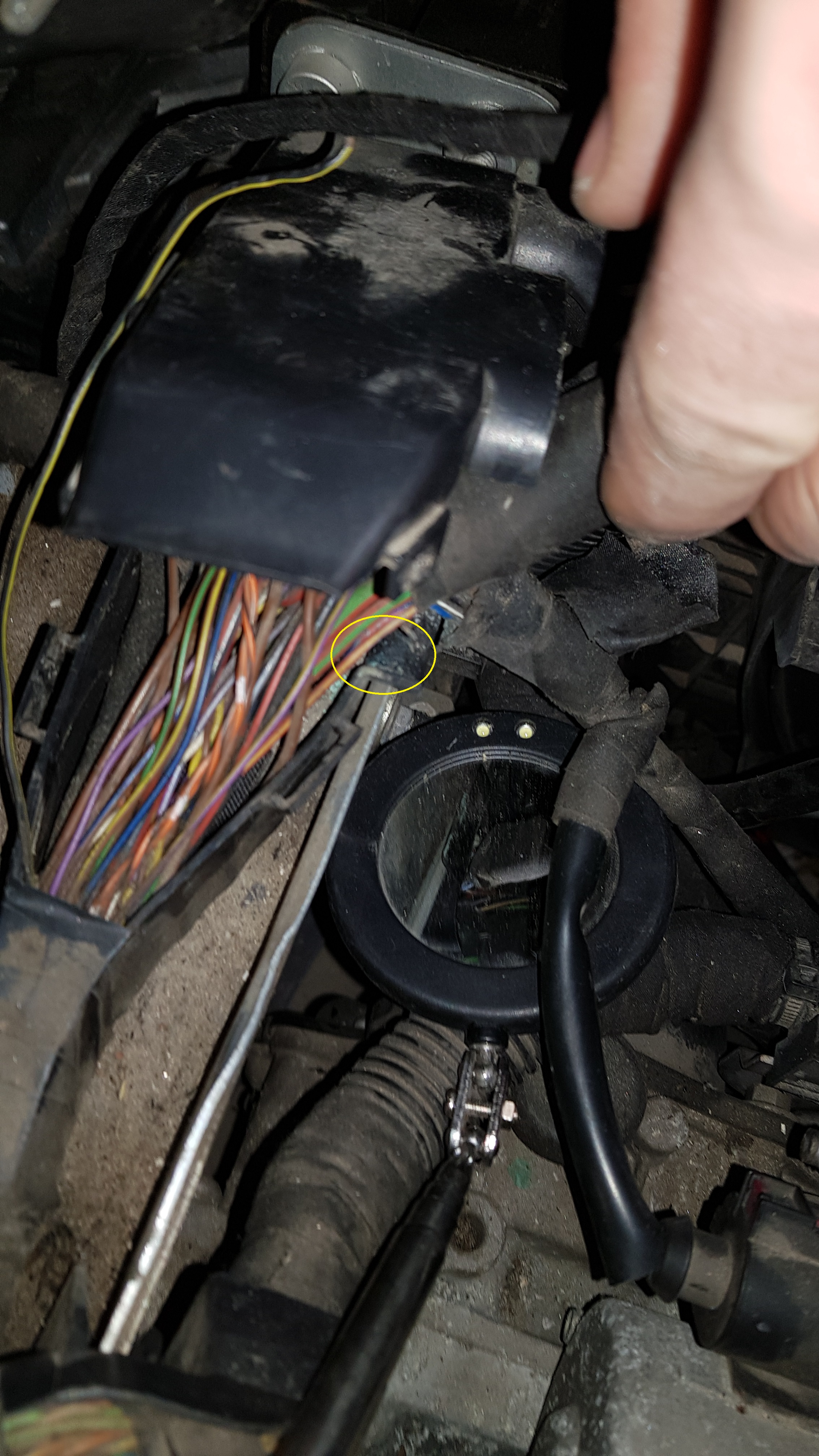

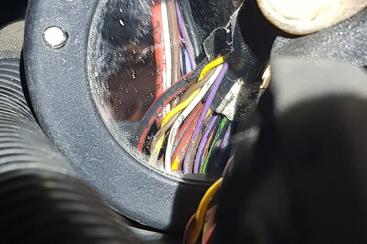

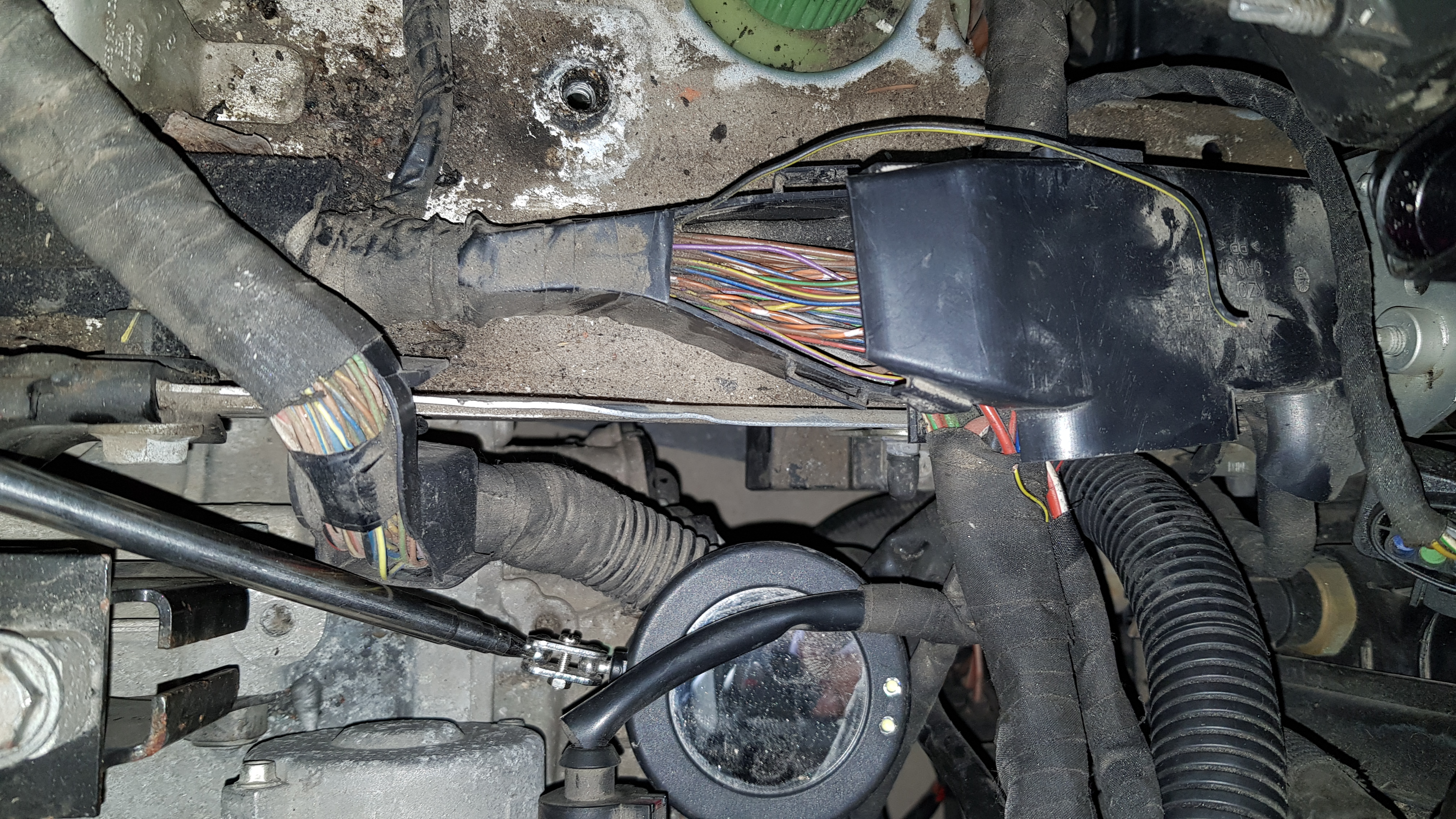

I renewed communication with ASB module (Temporarily) . The problem was under battery. I found to wires in bad condition( blue/red ABS 7pin--> SC4 fuse responsible for communication and one glow plug yellow/black) . Last week I was checked a few times 7th pin there was 12,7 volts :D.
I still have some problem: left rear abs sensor electrical error in circuit. I checked all ABS sensors with LED test-looks good. ( My wheel sensors are actvi type).
Eihho
Posts: 3
Joined: Sat Dec 31, 2022 12:24 pm
Drives: Polo mk V 1,6 tdi dsg
Location: Lithuanua
Re: Polo 6R problems
Post by Eihho »
I found more damaged wires
