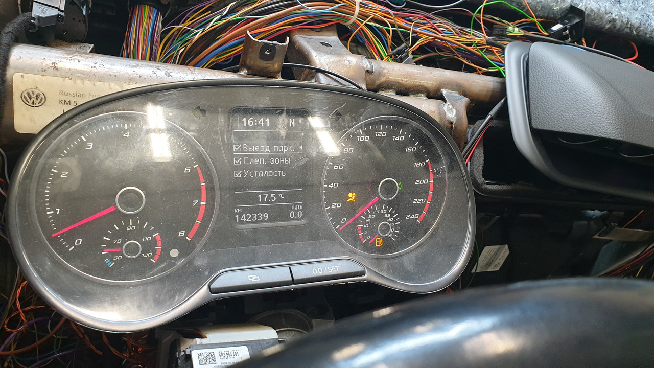

MrCollayder wrote: Sun Jan 15, 2023 7:35 pm
So, I've finally done some tests with 2q0 BSD radars =)
Now I have only 2 errors in 3C: no warning lamps))
Parking exit assistant is now active, but BSD isn't yet because of these errors.
Long coding is 52 95 24 A0.
This coding is for PQ.
• BSD/SWA is ON
• WITHOUT ecu for draw bar
• left-hand drive
• BSD/SWA warning lamps via PWM
• WITHOUT pre-crash_rear
• RTCA is ON
• parksystem installed
• NO break intervetion
• WITHOUT lane assist
Next week I'll try to connect both lamps and activate RTA.
• BSD/SWA is ON
• left-hand drive
• RTCA is ON
Cool, thanks for helping out. Really appreciated. What dataset are you using?
Today I've connected the lamps. So, there aren't any errors in 3C =)
Dataset's from passat_usa: 003C_2Q0907686B_0150_1VWMA7A31MC000090_USA
• BSD/SWA is ON
• left-hand drive
• RTCA is ON
