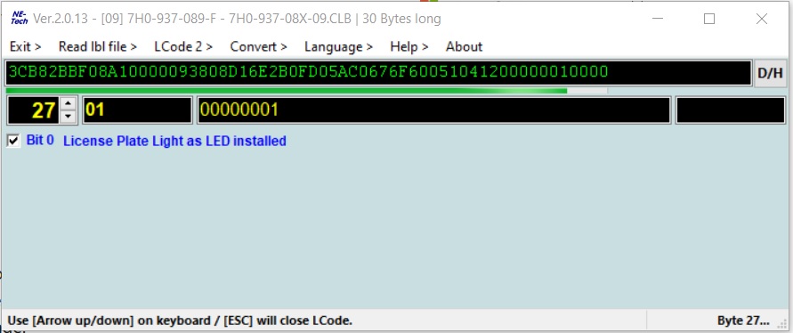

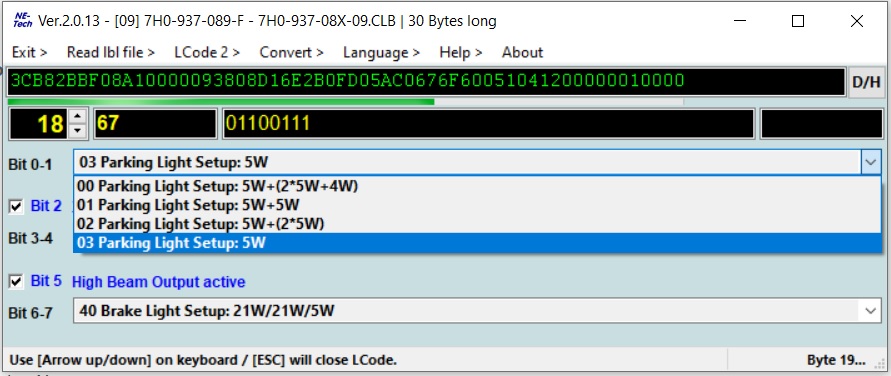

i installed LED bulb in my tail light.got light error code. looking to set it in BCM as proper LED bulb. i have VCDS but 09 byte 19 only have option for License Plate light LED.
please help.
i have polo gti with bcm 7H0 937 089F
Help.LED light error

what you're describing works prefectly fine for an MQB based 6C but will not work on the 6R. that must be done via long coding. i'm sure vcds has a label for that.
Bepis
- Posts: 332
- Drives: 2017 6C GTi Manual
- Location: North West
Re: Help.LED light error
Is that done via Byte 18 then for the 6R?iichel wrote: Fri Feb 10, 2023 7:39 pm what you're describing works prefectly fine for an MQB based 6C but will not work on the 6R. that must be done via long coding. i'm sure vcds has a label for that.
Cant find much regarding coding in individual LED bulbs just replacing the light cluster altogether.
this is what i have from byte 18 for byte 27, only license plate option availableBepis wrote: Fri Feb 10, 2023 7:48 pmIs that done via Byte 18 then for the 6R?iichel wrote: Fri Feb 10, 2023 7:39 pm what you're describing works prefectly fine for an MQB based 6C but will not work on the 6R. that must be done via long coding. i'm sure vcds has a label for that.
anyone have any idea?right now my temporary solution is by checking "Lamp Diagnostics for Taillights Inactive" option
