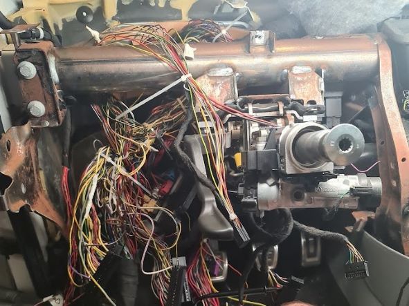

Hi everyone !
Finally I was able to allocate some time to work on the bcm conversion and fix some other things
OMG ! it was a very time consuming process and definitely not for the faint hearted.
Because I am a tall guy the option to remove everything instead of crawling underneath the dash was more viable.
I rerouted most of wires and added some new as needed. it took me 4 evenings after work.
Added some extra things in the process like Front assist radar and High beam assist mirror.
I need to flash the mirror to pq25 and code the radar (maybe remove component protection) - Pending !
I made same coding alterations to bcm but as I am not so familiar with that level of of configuration , I will share it here to get usable info.

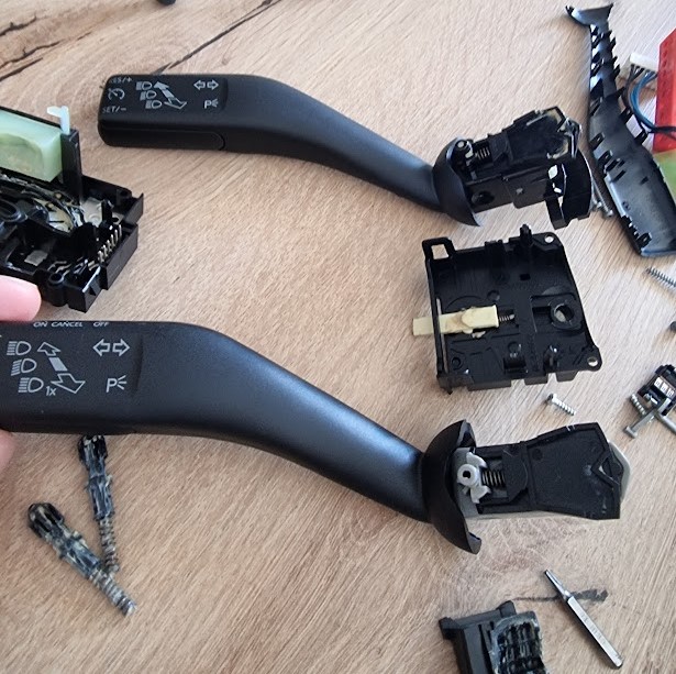

I am using a 5GG light switch temporarily because I am unable to find the one that I need , it may raise some issues.

Problem 1 .
dipped beam fails , I thing because I have aftermarket HID lamps and ballasts.
main beam works only when you pull the stalk .
Problem 2
front fog lights does not turn on
no static lights
rear fog lights does not turn on
Problem 3.
DRL switches off on the wrong side when you turn on the turn indicators (wiring or coding related )

Updates:
Problem 1
I tested everything at night , but now I found out that even in daylight headlights turn on in auto position.
Also sometimes I get "Light Assist Failed " message on instruments - Is this HBA related or something else ?.
I installed halogen h7 bulbs , errors turn off and dipped beam turns on ok.
Also high beam turns on now with pushing the stalk and stays on even if i set it to 0 position, to turn it off I have to pull it all the way to flashing.
Is it normal ? I thought that I had to push it again and set it back to 0. Auto HBA does not show on instruments.
Problem 2
Have to get an appropriate switch to test fogs.
still no static lights
problem 3
I mixed the L and R wires , I have to switch them.

about the 7E0 stalks , I do not thing that they physically fit in my car without changing other parts.
My original 6RA stalks look more like 6C0 stalks on the part that is attached to the steering column.
So do you know if there is a version of 6C0 that will work on pq25 ?
about the mirror, I flashed it with a mqb to pq conversion file that I found on drive2, all the errors about missing communication messages between modules are now gone.
I have not tested it yet though , I will get back when I test that it is functioning correctly.

Also I bought a used golf 5K0 hba stalk hoping to convert my 6RA to non-latching with the correct icons but this was not a match.
Stalks themselves (if you disassemble everything) can be interchanged but you cannot interchange the non-latching part because it is physically different.
As a next step I will try 6C6 or 2Q0 newest style variants that acording to etka are combatible with my slipring and mount, posibly with internals intercange.

you can use 2Q0 if you want, I had those on my Up! and they are a replacement for 1S0/6RA stalks. 6C0 won't return to center like 7E0
