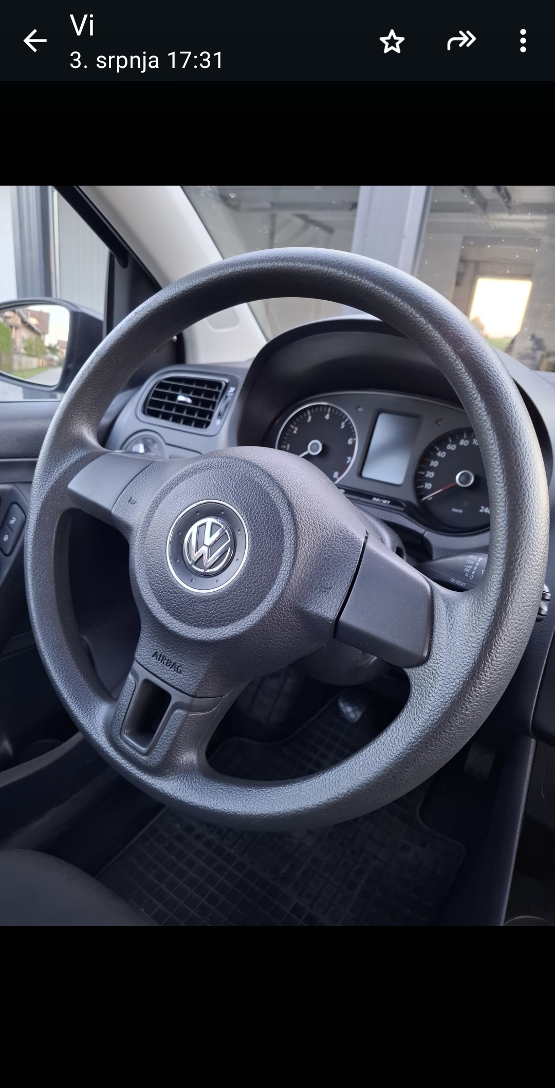

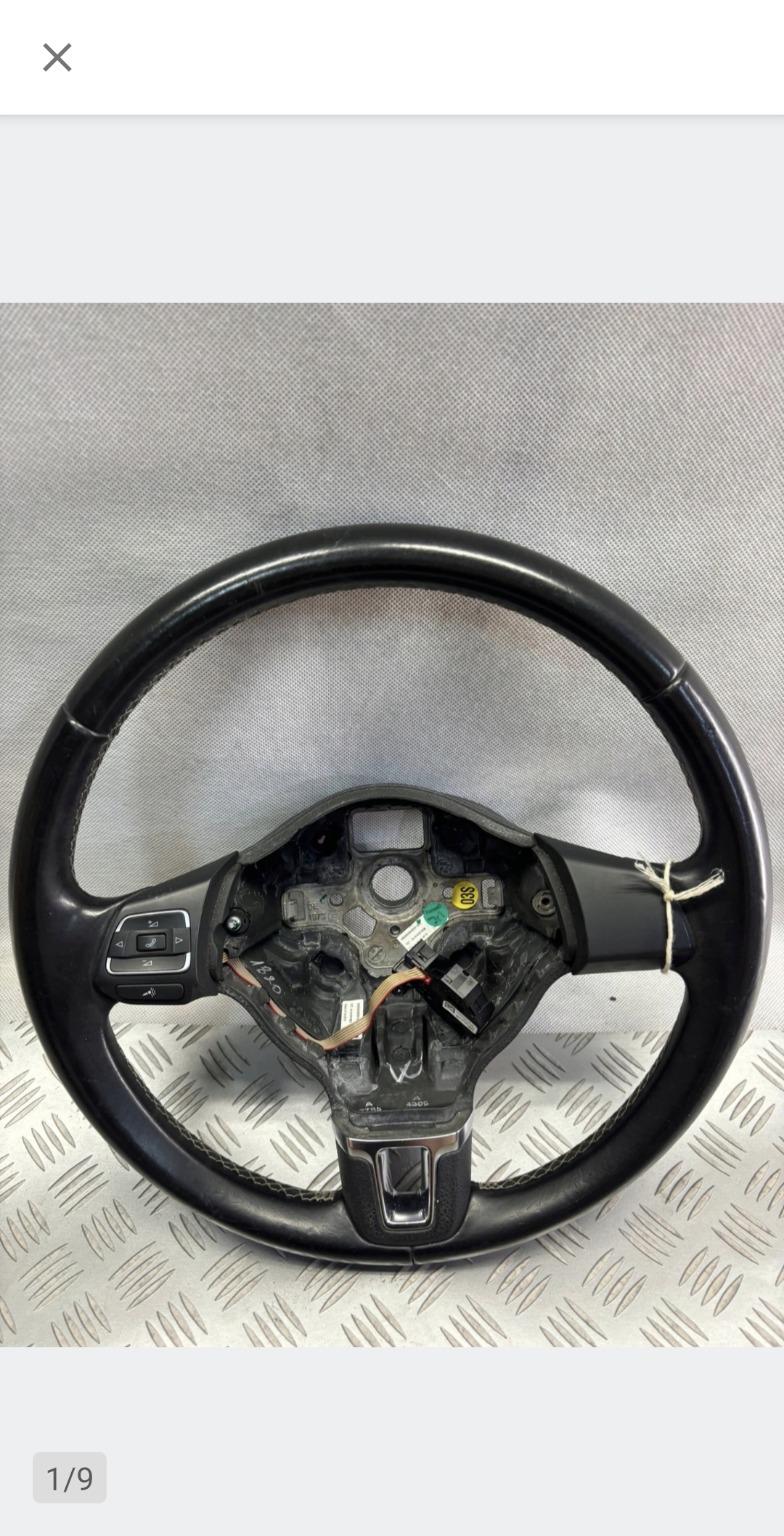

I have 2012 polo 6r. My wheel is standard plasticky or rubber?!? wheel with out buttons.
I saw a wheel with buttons on the left side for radio and bluetooth answering.
Will this wheel fit without changing the airbag it self.
The new one
The new one
The current one
The current one
Re: 6R - Multifunction Steering Wheel Retrofit
No you will need a new airbag too

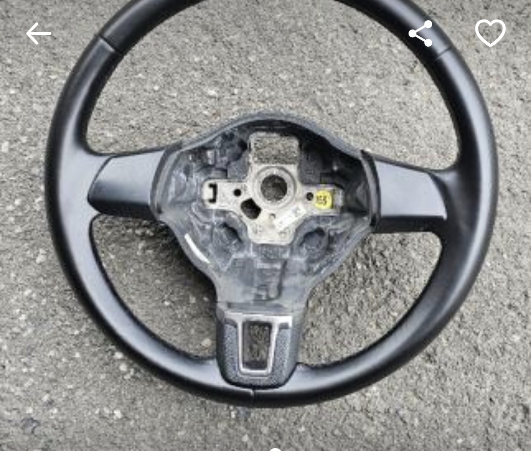

Also if the wheel is made just from leafher without buttons will I need to replace the airbag?
Here is the picture of the leather one..
Thanks.

Please can somebody confirm that the leather one without buttons is direct retrofit to the rubber one without the buttons?
Thanksss
jammydodger
Posts: 298
Joined: Thu Apr 18, 2013 7:26 pm
Drives: 6R GTI
Location: Manchester
Post by jammydodger »
Buci wrote: Tue Jul 16, 2024 6:50 pm
Buci wrote: Thu Jul 11, 2024 4:44 pm
Buci wrote: Sun Jul 07, 2024 9:38 am
Can somebody help?
Thanksss
Yes direct fit :D
