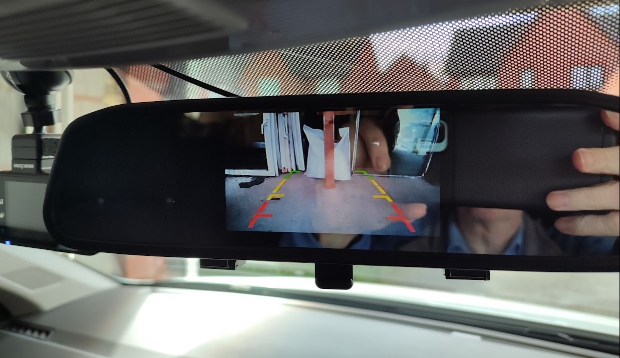

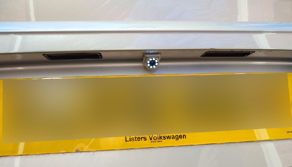

camera fitted between the number plate lamps.. I did buy an IR version but didn't like the mono colour effect displayed so went for white LED version and you can make out things in the LCD much better.
The Mirror LCD image is fine for the purpose. I guess if I had to buy the relay I needed (I already had it and didn't need it for my dash cam install) It could have added another £6 on top of the parts
£15 for the mirror wireless sender/receiver and camera (not usable due to large bracket fitting)
£3.50 for LED camera (in photo)
tried it today whilst out in car park.. bright conditions and LCD display still usable. Pleased for the minimal outlay and my needs. Wiring up and finding the proper method (avoiding powering the camera directly via the reversing lamp feed, took the time; along with hiding the wiring from the front of the car to rear.
