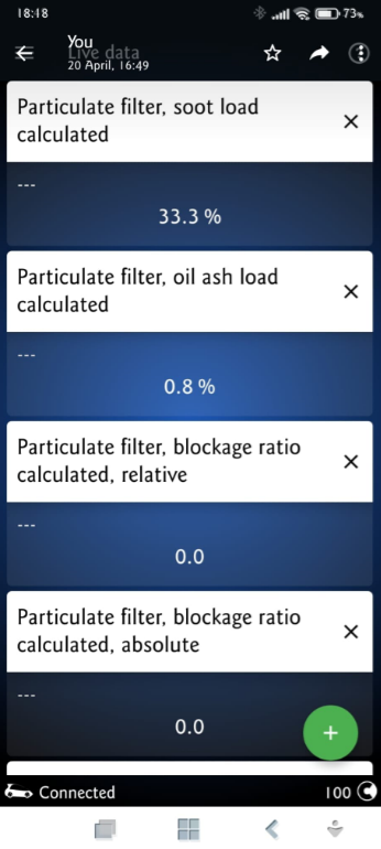

I found more selectable data on the OBD app.. one reading was 33% before taking it in to the garage (from most of my research this is not 33% of 100 but confusingly, out of 250% The figures still do not mean anything to me.. 33% could be high?
GPF data.png (117.56 KiB) Viewed 4317 times
I don't know the criteria.. hence my asking many questions on this and other boards.. still no real information to go on.

My Scanner suggested 33% soot load calculated and seems low compared to the very often quoted range of up to 250% (strange to have a 250% figure I know) It can take 30 -60 minutes to force a regen.. they phoned me back to tell me they did it 20 minutes after I left it with them; you must need 5 of those minutes to get the car in the garage and hooked up!. I'm not convinced of there regeneration (and not charging me for it?) now. Perhaps there was an update/recall that fixed this problem and they never did it previously. It's all supposition but frustrating at the same time.
Anyway the 33% figure was nearly zero when i got it back from them and re-scanned it. Since then I am keeping an eye on the figures just to see how my driving and trips locally affect the levels. one figure (Oil Ash Mass) since getting it back was 1.83%.. after a day of 40minutes travelling including some high traffic, I expected it to rise but didn't even one bit! I began to wonder if the reports from the scanner/app were working at all. I took it out yesterday on a short trip and cold and it went up to 1.84% whilst the Soot load calculated was still 0.0% (was 33%)
It would be nice to know what these figures actually mean in real terms. I will just keep and eye out from now on. I have asked many questions on various forums but not getting much specific feedback (this is not a moan). Pointless asking OBDEleven as it would be like buying a spanner and asking how to use it on.. (take your pick) It would be too specific.

The Particulate Soot (screenshot in post further up) load calculated was 33% and was close to 1% after getting the car back. However since it seemed my driving routine caused the blockage (short journeying/ shopping trips etc) and was going to push up this figure again I was more than a little concerned; especially if this 'seemingly low' 33% figure indicated a total blockage as the garage claimed; I got a bit paranoid over it and checked the particulates routinely every few days for a month.
Now after 6 weeks of the same short journeying the figures have hardly budged .. I accumulated some very low water load for a day.
