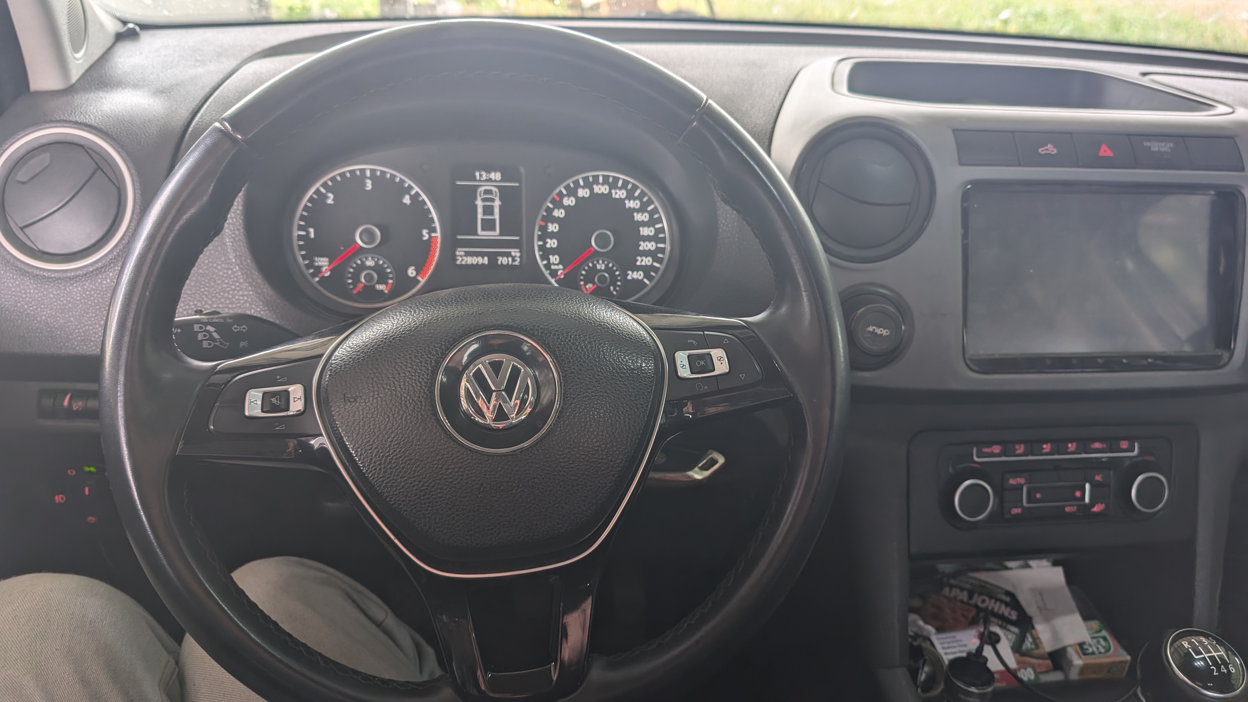

I was already able to make some improvements always doing them in an OEM way.
Install original steering wheel with your OEM steering wheel controls
I changed the instrument panel for the most complete one [Remaining a few small details that with the new updates should be 100%]

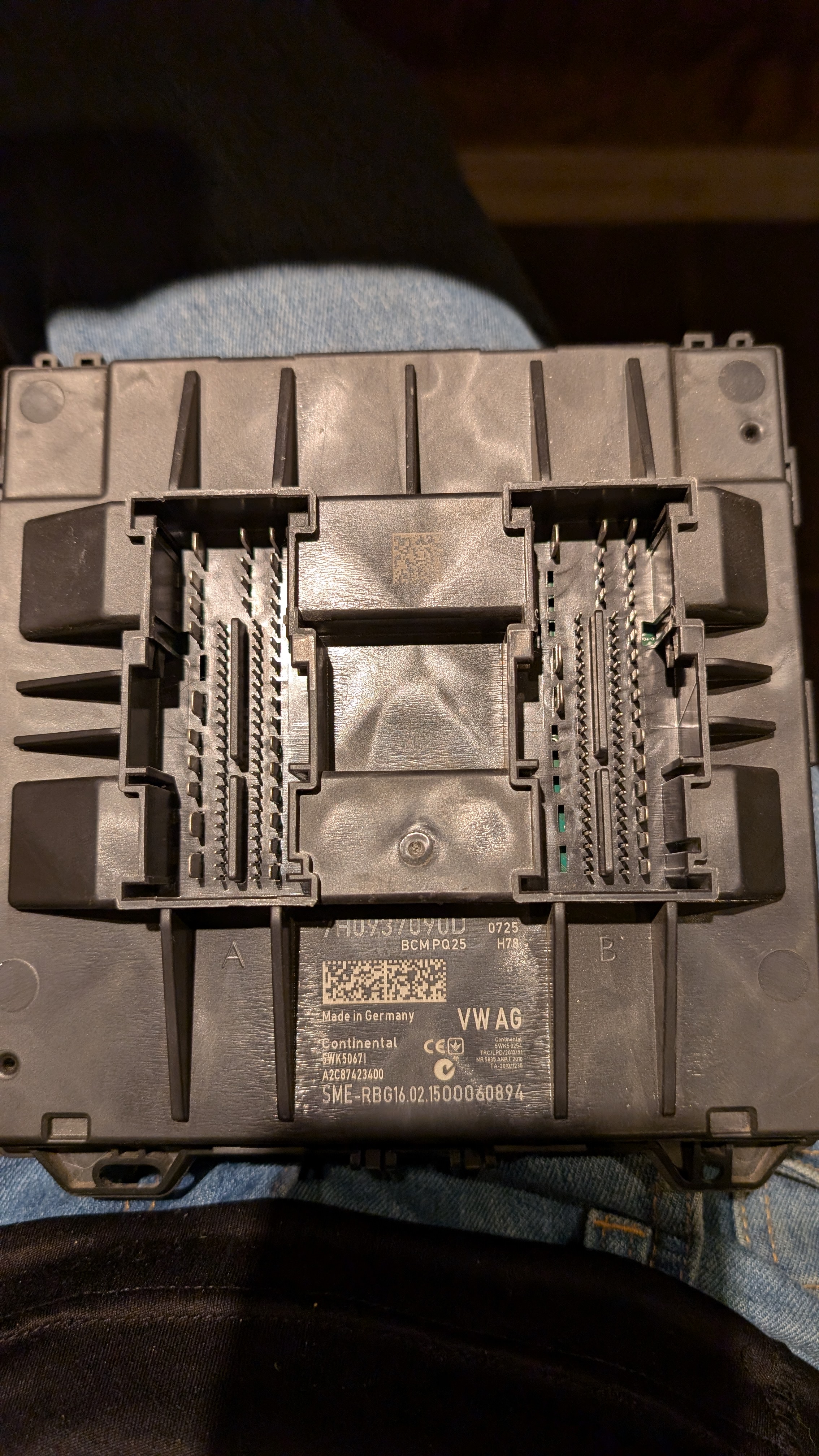

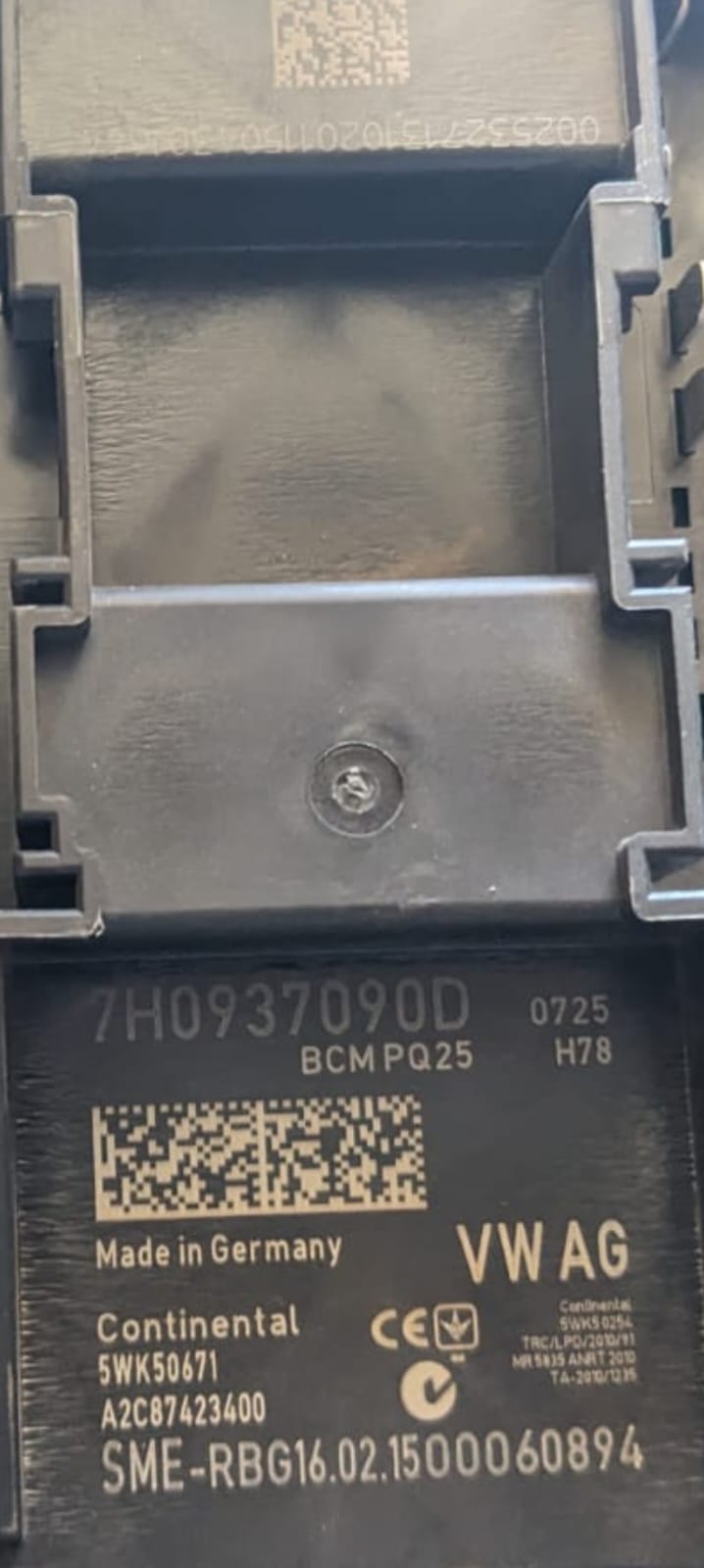

My VW has this BCM 6R7937087H from the factory and I already have the 7H0937090D in my hands, which is the most complete BCM, not installed yet.
- My VW does not have OEM installed the RLS {rain light sensor} is the first thing I should install because of the comments I have read
- Then install the new BCM 7H0937090D, with the 2 CanBus signal cables to the instrument panel.

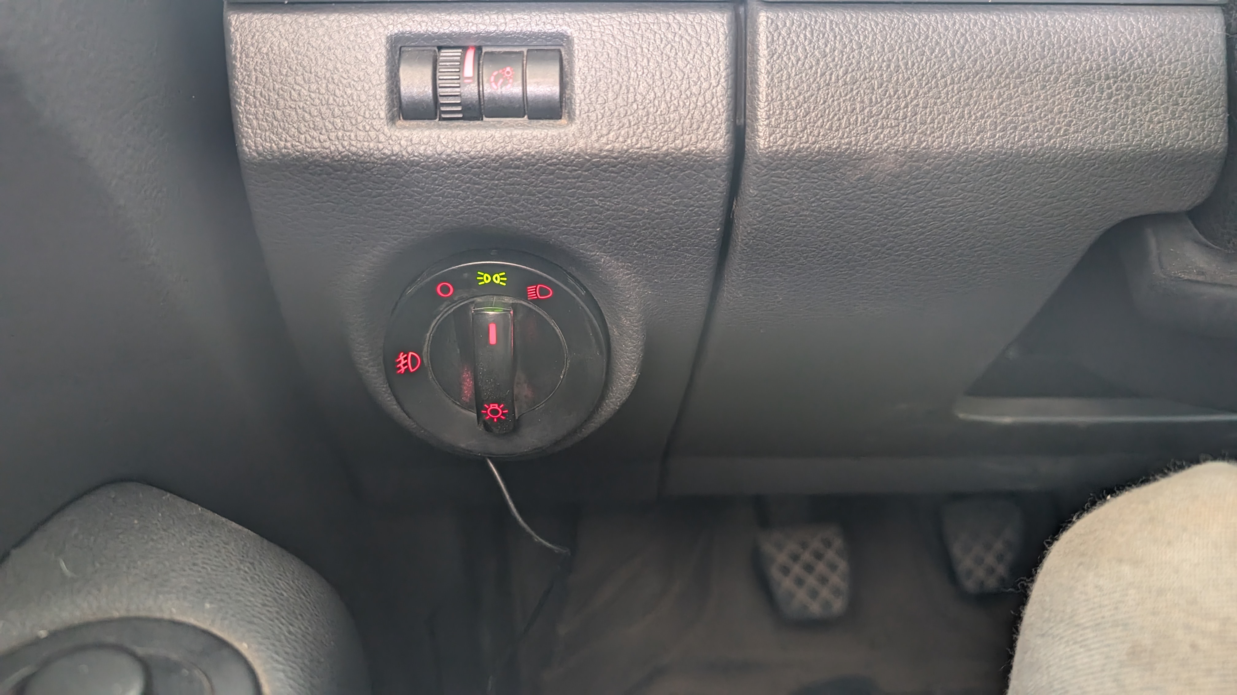

- From fabric I have installed the dimmer switch

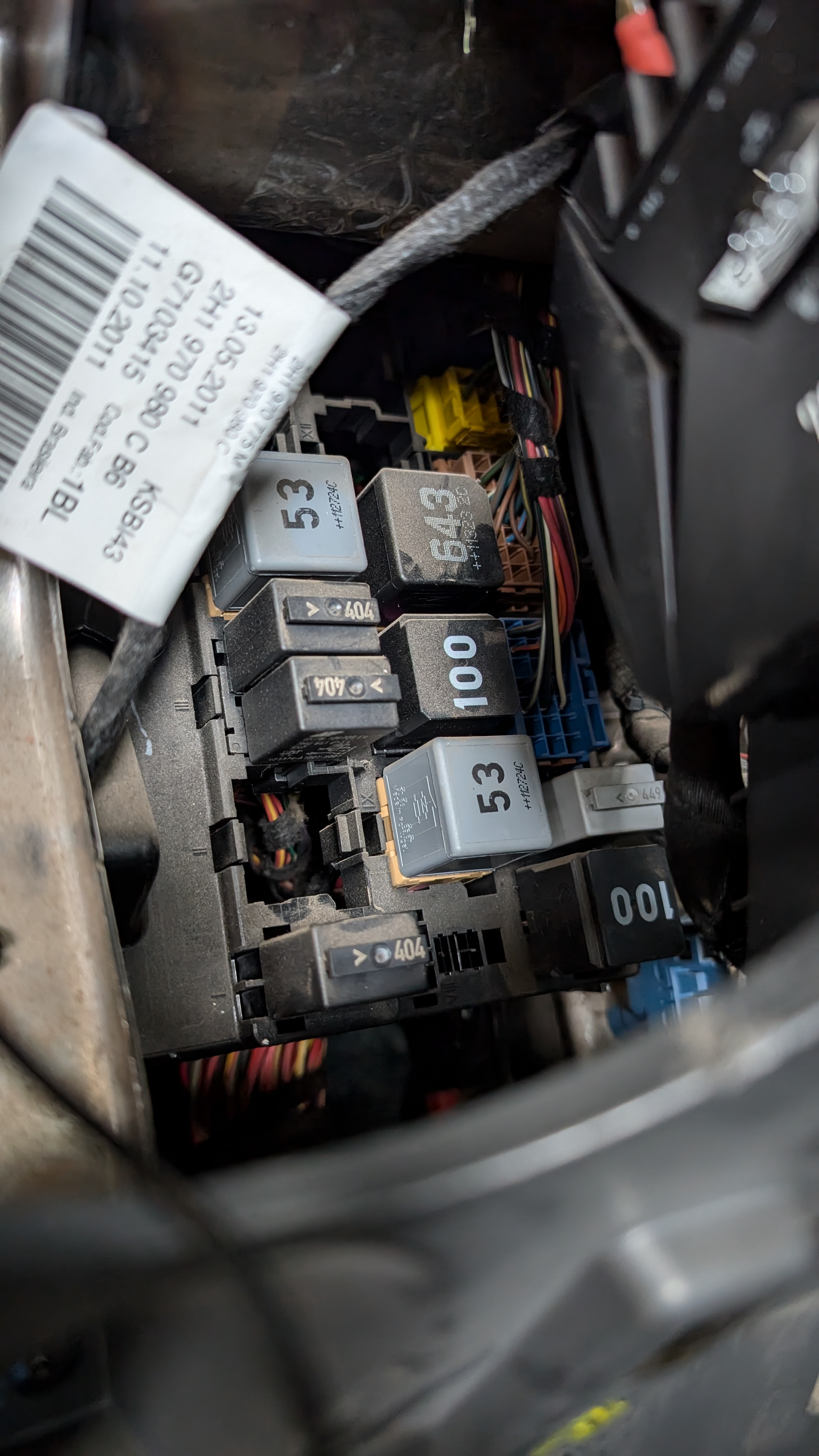

The sale is because the connectors and the relays and relay holders come practically ready {the same as the originals} I do not have a part number for the spare parts of the relay holders
or the models of the dupon connectors and plugs of the wiring looms to do the retrofit.
I have the interior light dimmer and front fog lights installed from the factory

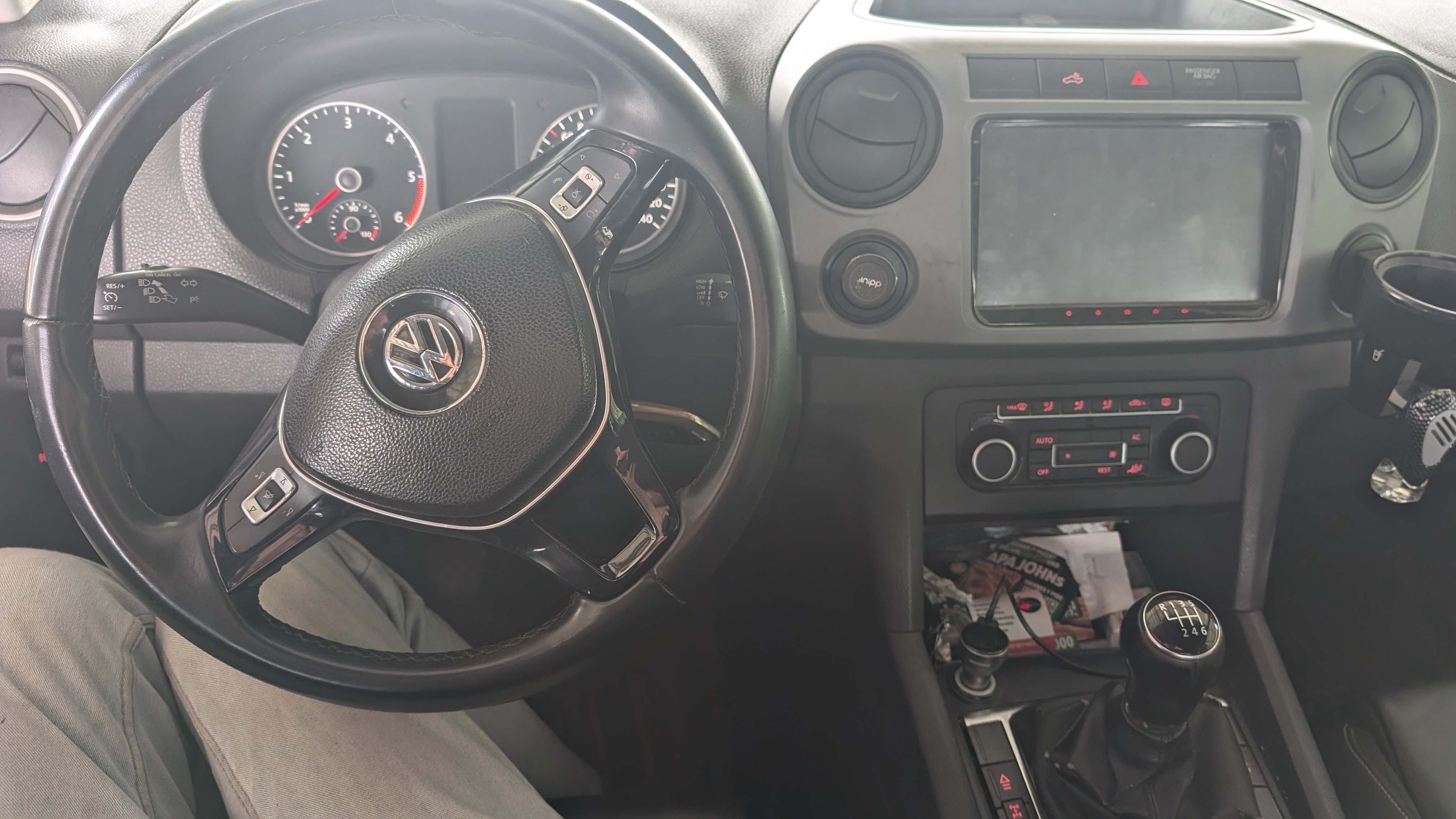

I changed the instrument panel, mine was 2H0 920 853 B, I changed it for this 2H0 920 871 A, I had some details that I think can be fixed with VCDS
I have to install an oil level and quality sensor while deactivating the warning so that it would stop coming out, when I turn on the fog lights I don't have any witness on
the instrument panel or synoptic, I do not have an oil pressure witness or warning and the conford sensor for panel lighting works opposite { when the light hits it, the lighting of the instrument panel increases
And when it's dark, it only lights up the clock hands.... I think that will be solved by retrofitting the lighting and connecting the Canbus signals

I have saved the New BCM, not the one and installed 7H0937090D

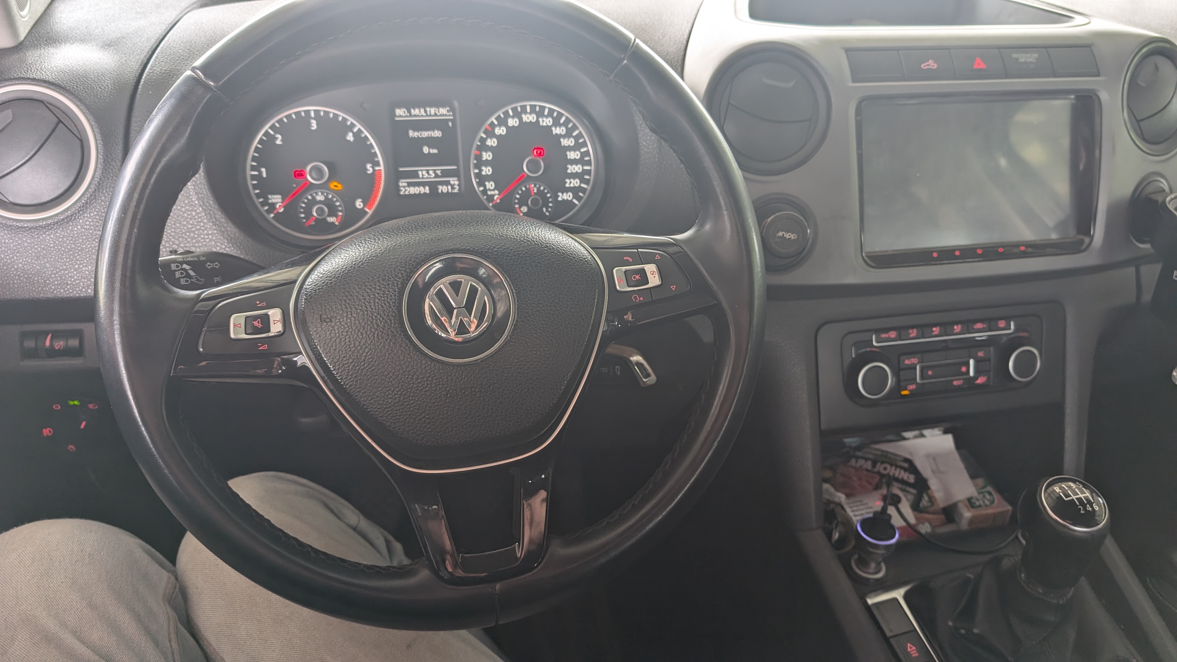

I can send photos of what I have done so far and what I have gathered to complete the project or whatever information you need, I am at your service.

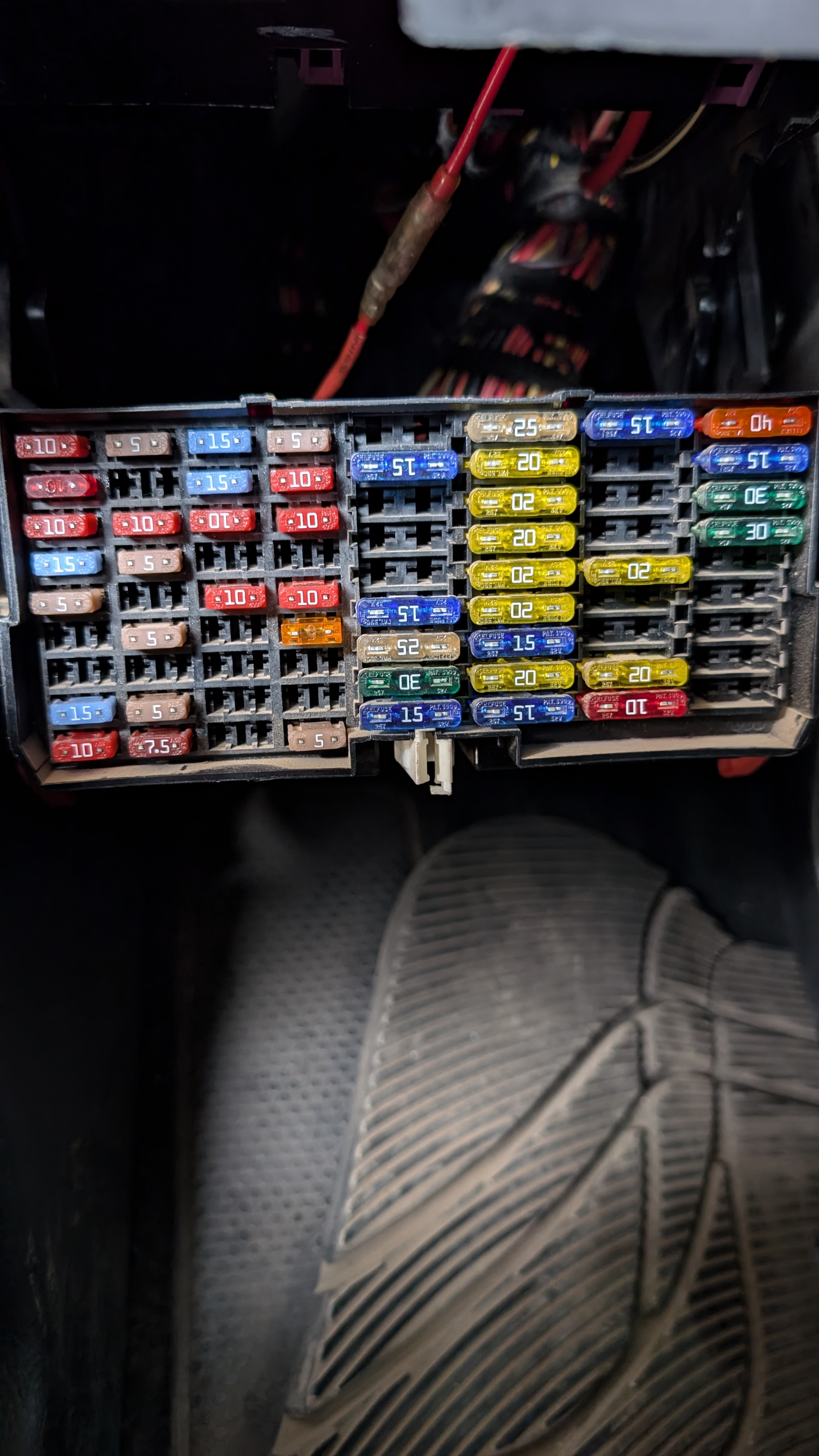

- What is my car currently equipped with? This will require your effort in making pictures and compare them to the wiring diagram.
This is for all wires from the light switch and dimmer to their endpoints and all external lights and their endpoints.
That's a lot of work. It must apply for every single wire and it must be exact:
All wires from light switch
Front: DRL, low beam, high beam, front fog lights
Rear: license plate lights, reverse light, rear fog light
The indicators, parking lights and brake lights are controlled by BCM anyway. You can leave them out your study. It will save complexity and time.

I think you will be able to do a lot of wiring in the area between light switch, fuse box and BCM.
But some will perhaps require you to run wires to reverse light, rear fog light, front DRL, front fog lights, high beams?

I am going to explain how I believe for what is studied that the change of the BCM is made (pre -preparations for the BCM update)
Eye first the Pin out of the BCM 90D to make the comparison
1 ° Make a complete scanner with the VCDs with the original BCM 087 to have the longcode
2 ° Take photos of bits by bits of the settings that BCM 087 has
3 ° Do a SCAner with VCDs in the selection (Application - MAP channel control - Controller Adress 09 - Select Adaptations (I highlight that selection) and that.
4 ° Then I install the BCM 090 and disconnect from the BCM branch the 2 Cambus signal cables that go to the Pin 28 and 29 instrument box
(Because these cables are disconnected when connecting the new BCM?)
and disconnect from the BCM of the white connector (b) the pin 54 and 57. Detail disconnect it at both ends I do not eliminate it to see what happens (because you have to disconnect
That change signal ????? Or do I have to do the Cambus cable from the BCM to the instrument box to connect it?
4th Install BCM 090 and I made a complete scanner with the VCDs with the original BCM 090 to have the longcode
5 ° Take photos of bits by bits of the settings that BCM 090 has
6 ° Do a Scaner with VCDs in the selection (Application - Channel MAP control - Controller Adress 09 - Select Adaptations (I highlight that selection) and that
7 ° Then I enter Module 09 and I begin to take out the modules that I do not have and select the ones I have installed
8 ° Then I go bit by bit reviving the settings to have the same as I had before the change or I can also paste the long -bcm longcode in the new
9 ° Configure the 2 key remote control or keys to work with the new BCM (there are tutorials how to do it and have seen them but I never have it)

Where I would have problems is to make the branch of the relays that sold cycle with the connectors and adapters of the dimmer and the lights.

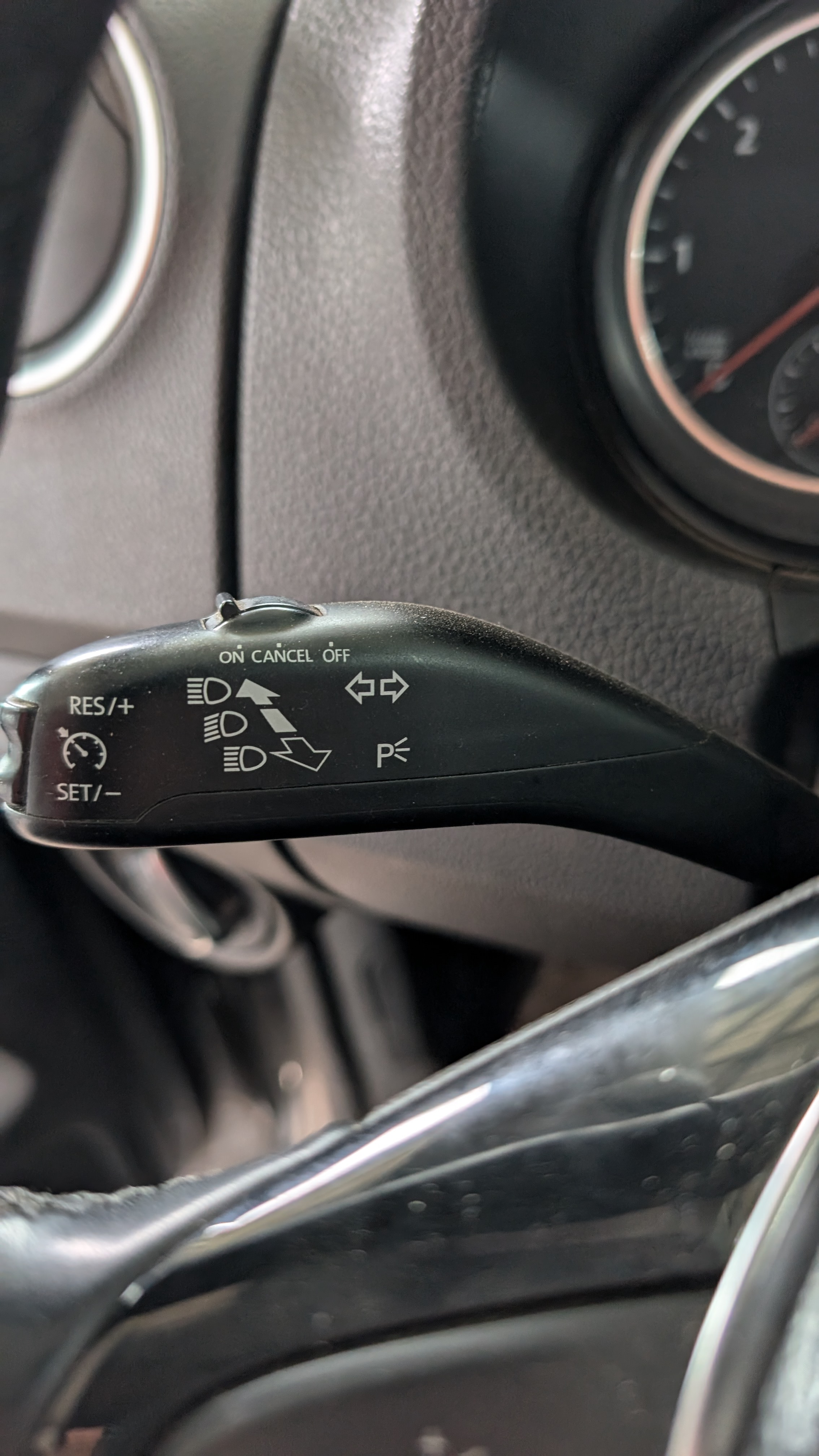

Chassis WV1ZZZ2HZCA026354 manufactured in Argentina 2011.
I have the original BCM installed 087H and I have a BCM 90D that I bought from a 2016 Amarok (I installed BCM 90D to test it and it configures my keys which I already did and I left mine 087 H again)
I also have the 5nd 941 431 b xsh switch and the connector from the same Amarok that I bought the BCM 90D
I have the wiring to install RLS that I bought from Aliexpress to be able to install the mirror and sensor.
I also have the Amarok xenon LED headlights that I completed and repaired little by little as they did not have the ballasts or the bulb and were missing some fixings. I have already repaired and completed everything
I have already read and studied each page of the forum and each case of the Amaroks displayed here that managed to make the updates with the help of Ciclo and iiches and I only found 1, a member of the forum Dkakavas who had a chassis number like mine 2HZCA
but as Ciclo says, the electrical installations of the Amaroks vary according to the years and I have not been able to find the exact electrical installation that fits my case

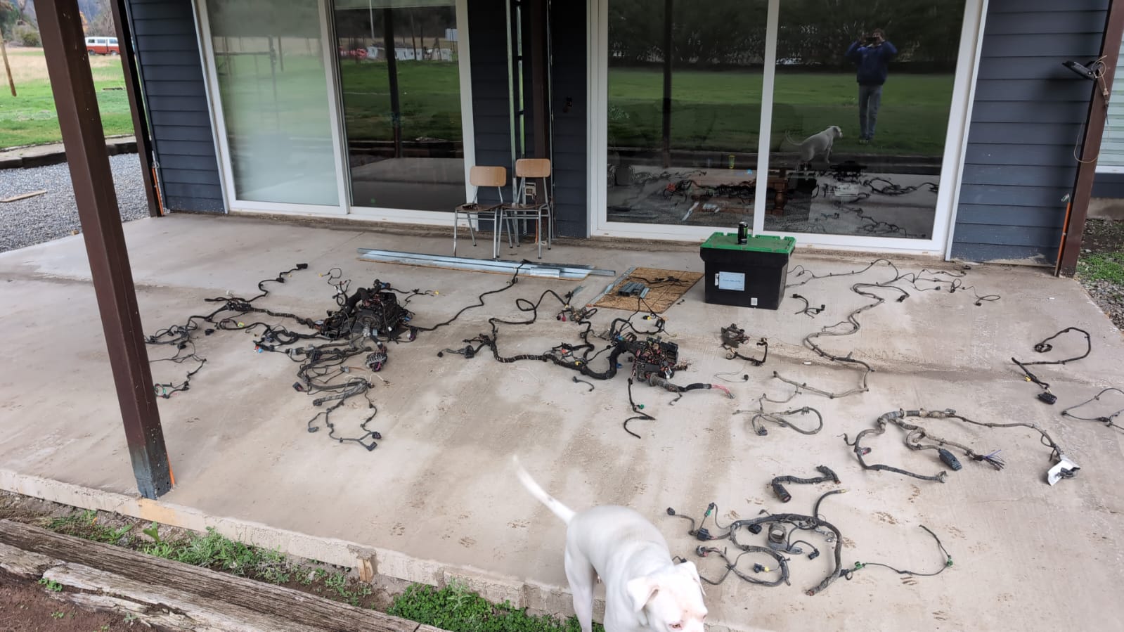

I also have the complete interior harness with the carrying box with the relays and the fuse box of the Amarok that I bought from the BCM 90D
which has the following chassis WVZZZ2HZFA047969 (Amarok 2016)
I thought at the time of taking out my harness and installing that one but I would have to move my 4wd module and the corresponding wiring.
I have already realized that I have to take power from the fuse 30 that is on the battery in order to start doing the updates as Dkakavas said and I send him the link to x step of a transporter T5 (viewtopic.php?f=56&t=70736&start=45#p528735)
Why when updating to the BCM 90D do you have to disconnect and isolate the original CanBus lines to the instrument panel and connect new CanBus lines to the BCM 90D instrument panel?
Could you guide me to be able to do the update and have everything OEM. Bixenon automatic lights etc.
I know that with you it is done and it is done well as it should be. I do not like things adapted poorly done and with poor quality things and I know that you are the only ones I have found that can help me to make everything perfect. Please
What I have gathered
- BCM 90D
- Switch 5nd 941 431 b xsh
- Optical 2H1 941 016 AF
- Optical 2H1 941 015 AF
- Cable for the mirror and RLS sensor
- I have 1 Complete cab interior branch and its lighting system and everything that goes to the engine etc. and as I mentioned from an Automatic Amarok 4motion
- I have another branch only the interior part of the cab of a mechanical Amarok 4x4
Can you help me?

changing a full wiring loom is probably a dash-out job. i'm not sure that would be the favourable way to go, but if you do it, you could use the opportunity to make some sound isolation and other retrofits at the same time.
if you're handy with wiring, i'd recommend you make your own.
the basics of every bcm max conversion is like this:
- make the correct inputs of terminal 30 to the bcm
- make the correct inputs from the light switch to the bcm
- make the correct outputs from the bcm to each of the external lights
sometimes you'll have to do some other wirings
- T73/4 to the instrument dimmer
- 2 new canbus wires to the instrument clusters, if you take a 7e0 bcm
unless you are ciclo, you probably dont get all the wires right the first time. you'll notice a light isnt on and you'll investigate.
i've done a few bcm max wirings for customers in my workshop, that usually went like that.
i never did it remotely and also not on a chassis i'm not familiar with, i never did an amarok. so i'm not very comfortable with making a wiring for you
i'm not able to judge your skill but if you are able to read a wiring diagram, add 1 and 1 together and you can make your wiring, you'll be able to do a lot.
and of course you'll need to have a diagnostic tool like vcds.

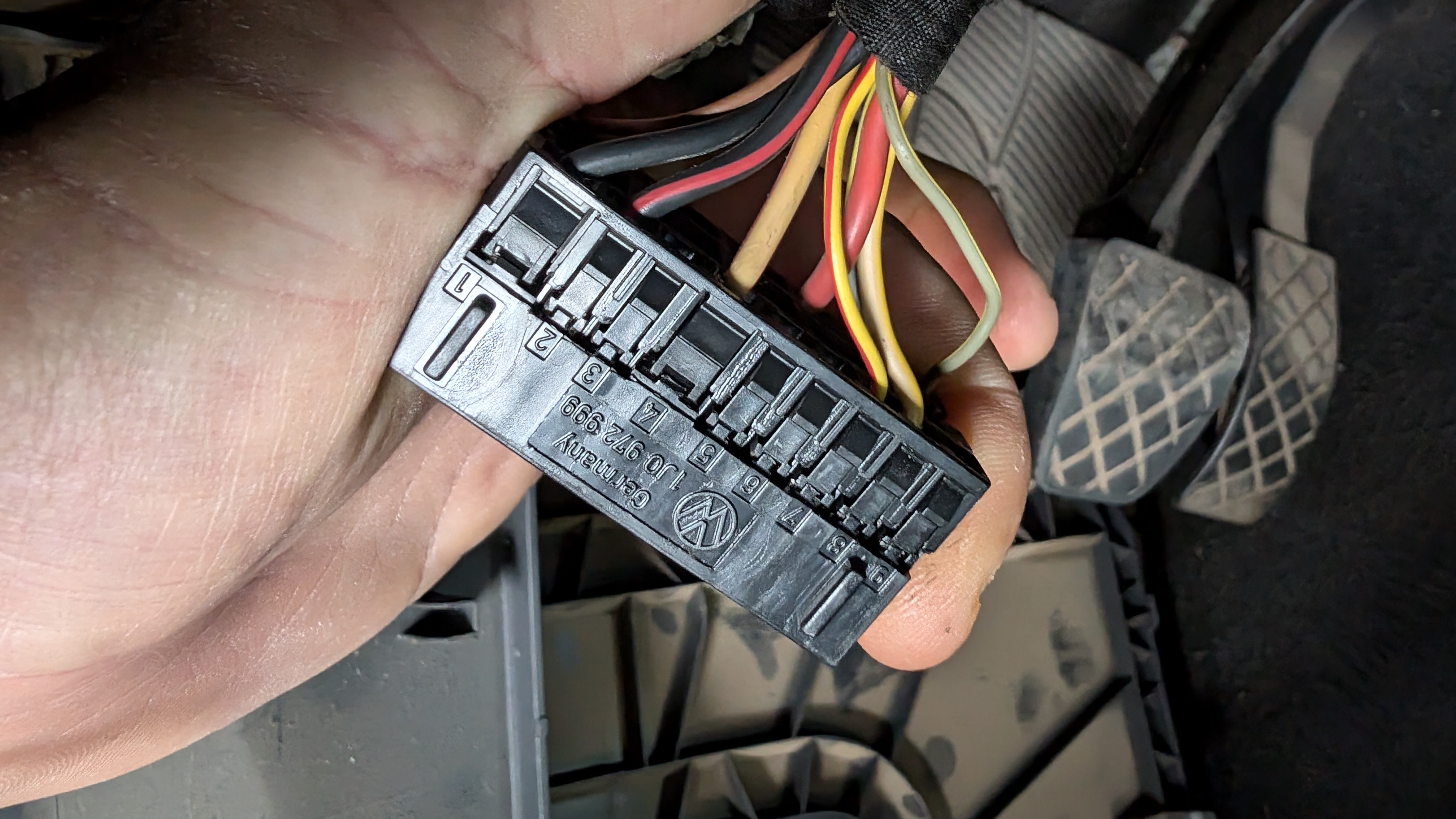

Re: Loom wires Automatic lights BCM
Dear friends, I am attaching the images of the fuse holders and relay holders so that you can know the connection pins or which Amarok guide of all those on the forum is the right one for me.

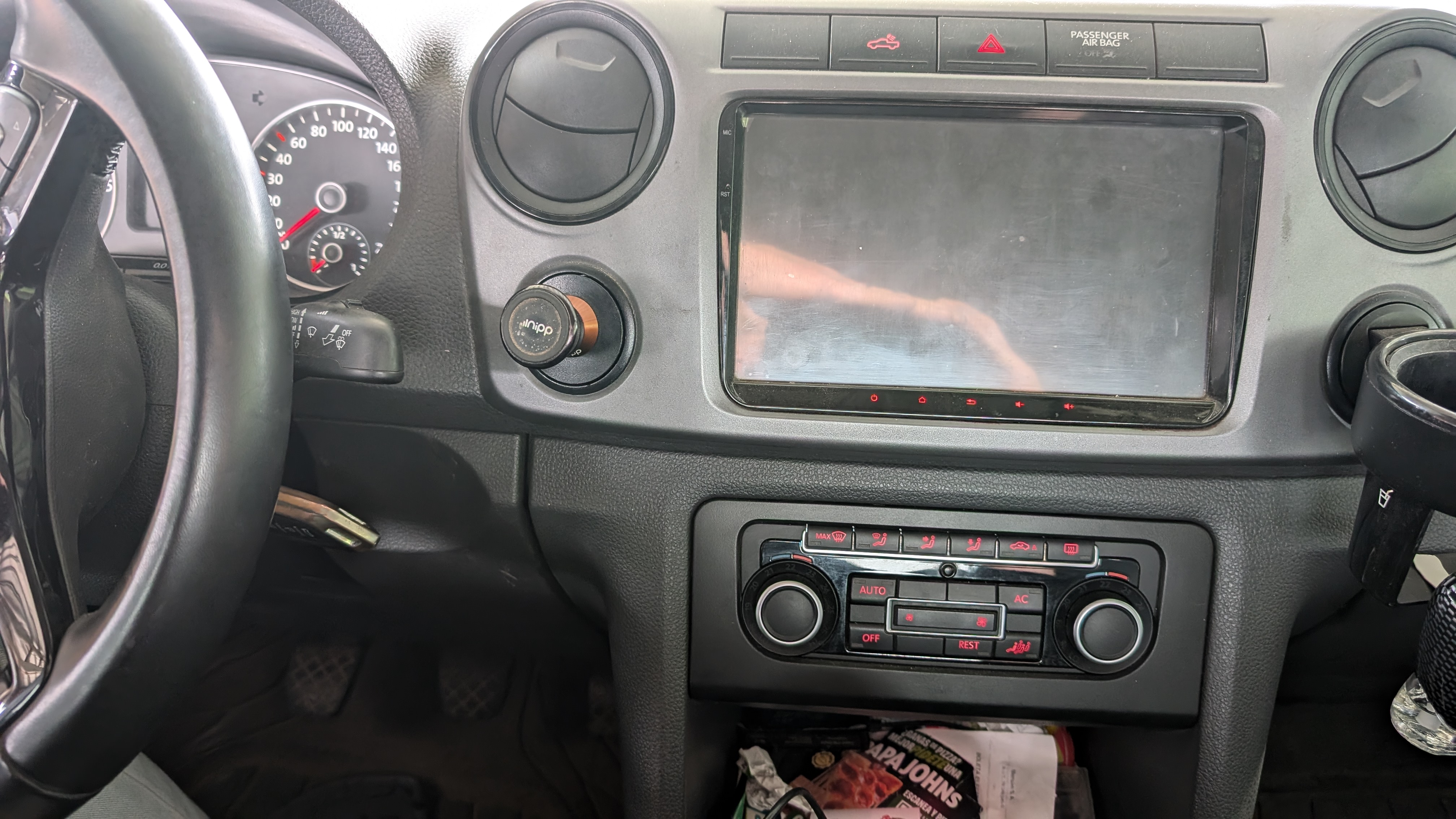

Sorry, I missed some photos of the interior cycle I was asking for

Actually, changing the entire wiring harness
does not give me any guarantee since it is from an automatic Amarok 4motion and I would have to do the wiring to the 4wd gearbox module and to the buttons for activating the 4x4 low and 4x4 high or without traction {as the mechanical Amarok 4x4 has)

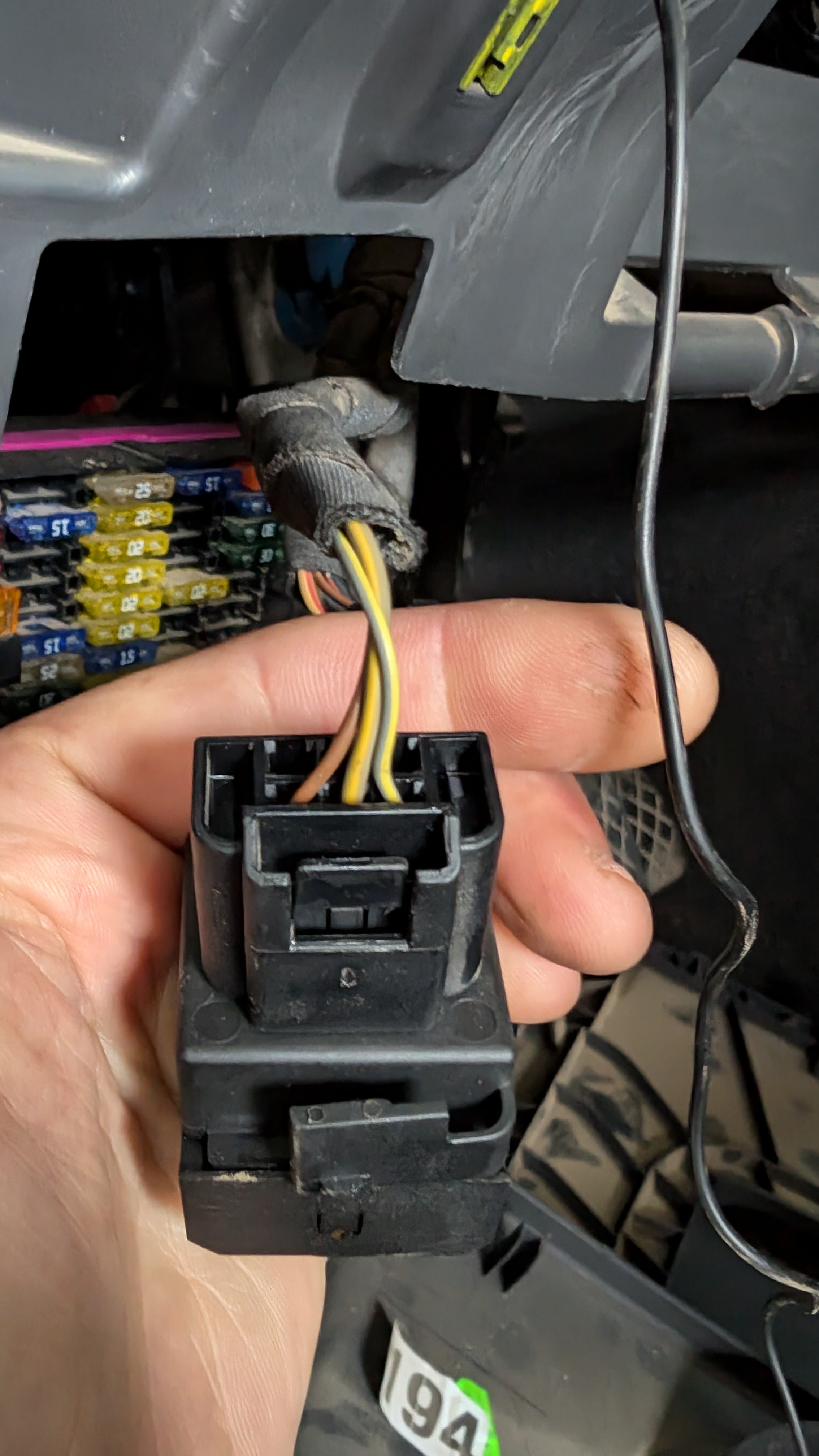

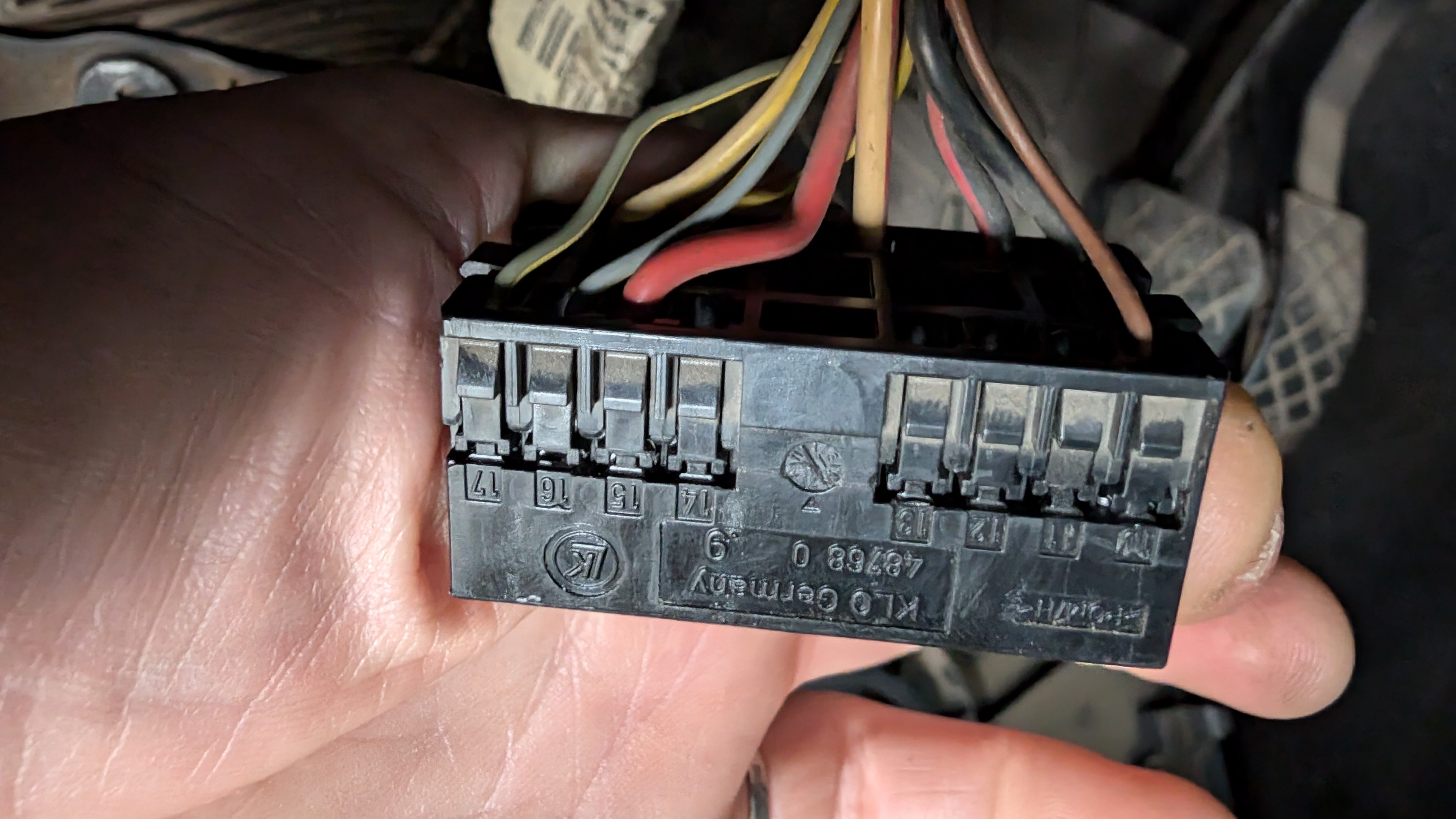

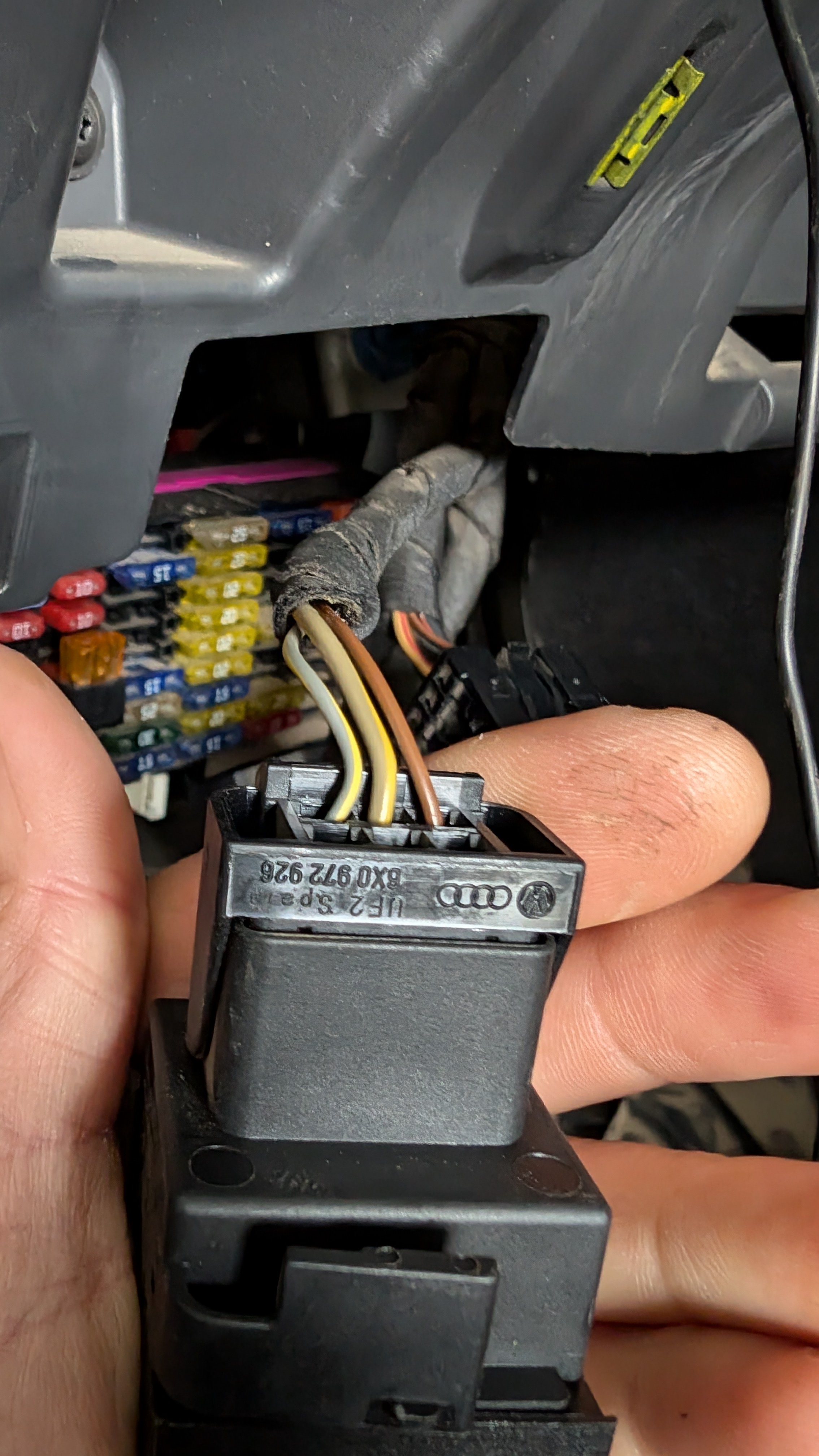

I have attached below photos of my fuse holder and my relay holder and of the interior of the truck as it requests cycle so that I can see if someone can guide me to the correct links of which of all the guides that are on the forum is the one that I have to do because there are many guides on how to do the wiring of the automatic lights and the connection to the xenon headlights with drl and RLS.
My Amarok Tre Factory Front fog lights
dimmer for instrument panel lights
The objective:
BCM 90D
OEM automatic headlights
OEM xenon headlights with DRL function
OEM 10-pin light switch
Install RLS and its photosensitive rearview mirror
We can use Cable or relay holder etc. From the branches that I have from the automatic Amarok with 4motion or what I have from the piece of branch from the mechanical Amarok, its fuse holders or fuse holder, etc.
We need to know which is the correct installation guide that I should follow as I told you because there are many to eliminate any margin of error
if this is the same connection guide that fits me
viewtopic.php?t=70902&start=30
And if I have to add the Volkswagen T5 guide to get the 30 Amp power supply to the interior to feed the fuse or relay to the BCM
I have attached photos of the VCD scanner and images of my fuse holder and relay holder
I attach an image of the BCM to be sure that I have the correct BCM unit.
I installed it just to configure the keys and it is OK and then I reinstalled my original one.
I can attach images of the branches that I have highlighting the fuse holders and relay holders

- Ramales Amarok.jpg (186.16 KiB) Viewed 24048 times
- Foto Completa BCM 090D.jpg (2.77 MiB) Viewed 24048 times
- bcm 090D.jpg (81.71 KiB) Viewed 24048 times
