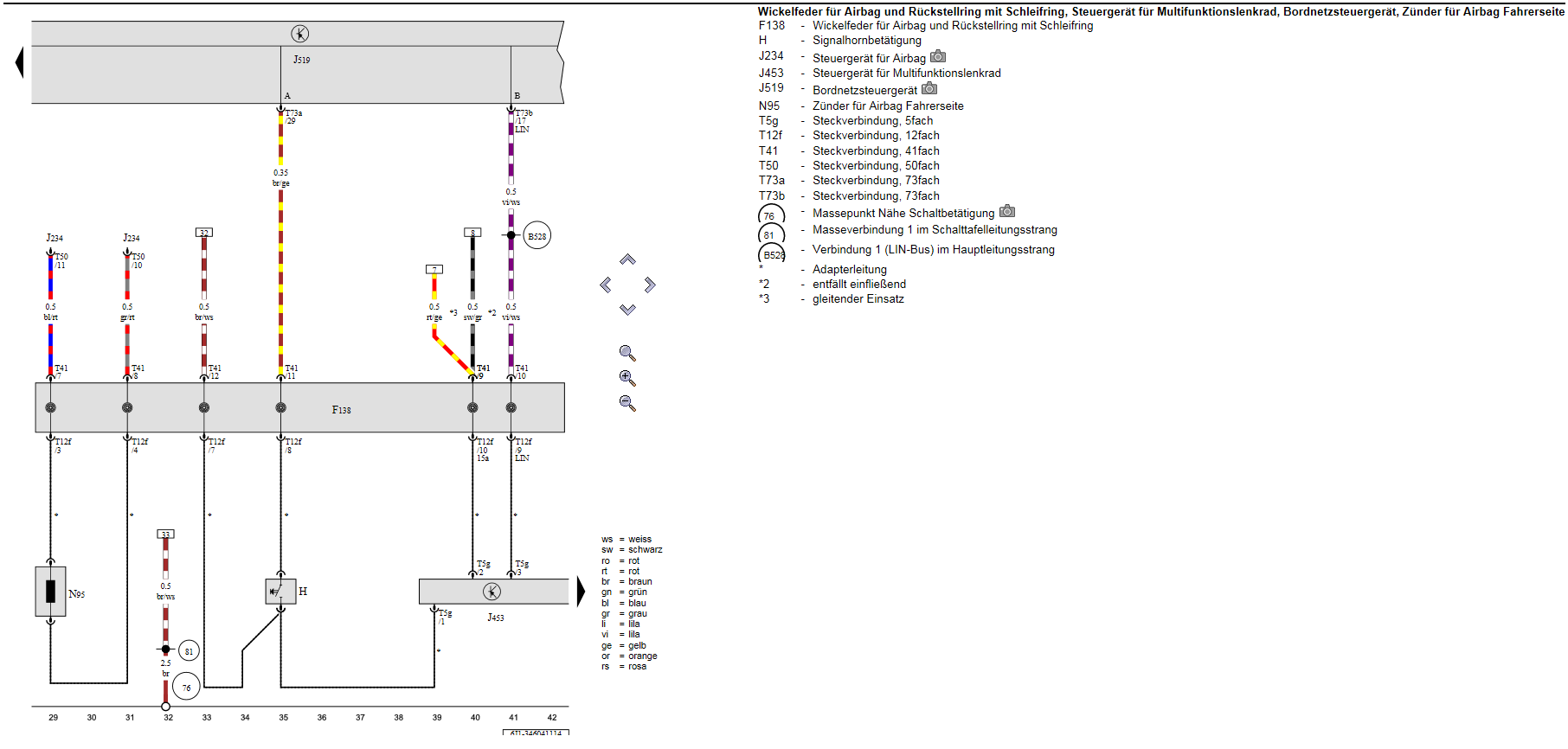

The circuit diagram of my ibiza looks (at least when it comes to the raw pins and connectors) the same as the in the polo.
I might just need to pull some wires up to the clock spring, as my car doesnt have shifters (because no DSG). So I guess, Seat wont put the Lin and +12V cable up there.
Wont be an issue at all.

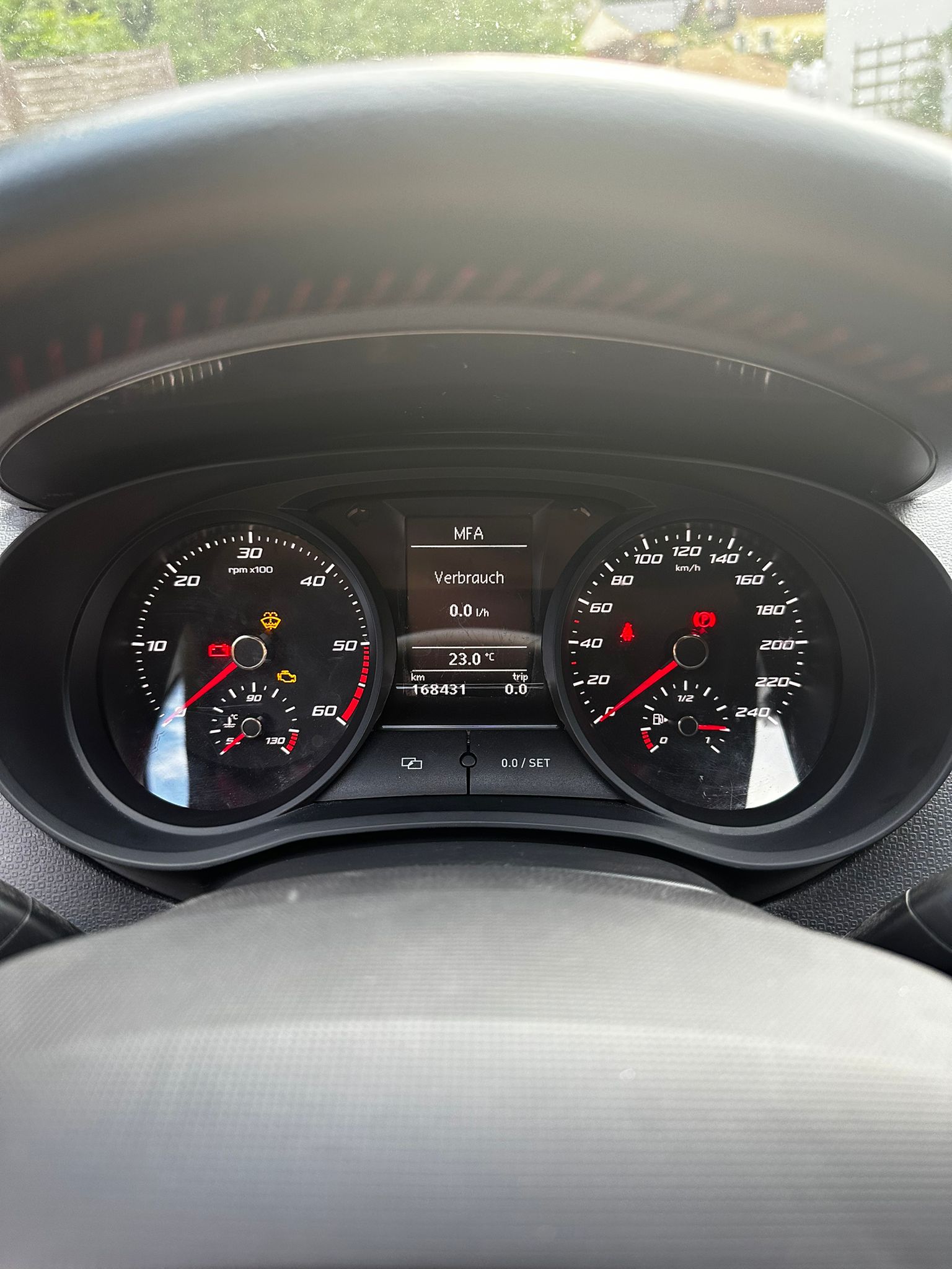

Today the first cluster (of 3 dashes in total) I bought arrived.
Its a skoda rapid dash from 2010.
Put it into service mode. Did some coding, had some trouble, because the immo data from my car is "2014" and the dash is 2010.
But after some playing around I figured how to do that.
Changed language and stuff. But didnt had many options, because this dash only contains a 24C32 EEprom. Which surprised me. But it is what it is.
I just bought it for the white LEDs and indicators. So it was more a proof of concept and playing around with it.
Put it in my car, switched ignition on and everything works. ABS happy. Engine happy. Central electric happy. Immo happy. Cool.
I hope this will work the same way with the actual toledo dash I want to use in the end.

Yesterday all the parts for the correct toledo dash arrived.
Thankfully everything went along and the dash works as intended. One thing I noticed on the skoda rapid dash, as well as on the
toldeo with mph and kph, you can change also the menu with the normal MF stalker, when you press "ok" and "up" at the same time. Interesting.
I just played around and found that out. Thought I will need a MFSW to make use of the dashboard.
Additionally, I pulled some wires up to the clockspring and tried to use 2013 Leon 5F MF key(pads). Unfortunately. The BCM dont seem to understand them.
At least... the VCDS takes some more time to load the "Extras" they also get sorted different and the BCM throws an error: wrong coding, which disappears,
as soon as you "code" the msfw into the BCM. But no PN inside the "extras". So it seems to recognise there is something... but it doesnt seem to like it.
Any ideas or is this the farest I can go with this BCM (SW-Version)?

Thank you very much for this info. This helped a lot.iichel wrote: Thu Aug 31, 2023 9:42 pm have a look at ciclo's Polo topic. He was the first here on the forum to install 3AA TPMS to the PQ25 platform, after some discoveries and hard work in Russia.
viewtopic.php?f=56&t=58703&start=3645#p525012
viewtopic.php?p=517336#p517336 wiring
In the "wiring" link it says its Pin 19 and 18 on the BCM. I guess thats from the Amorak?
I checked the wiring diagram of my car and pin18 and 19 are CAN-H and CAN-L for the drivetrain, so I guess thats not correct?
Via several more links thru the threads I got linked to this page: https://www.drive2.ru/l/461592849478059310/
Where it states its Pin 28 and 29 on the BCM.
On my wiring diagram it says those are free spots. Nothing attached to them.
Do I assume right, that I need to connect it there? Or am I totally wrong and I actually need to connect them to the other CAN wires?
- Posts: 6695
Re: Seat Toledo Maxidot with MFSW retrofit
Trust the ciclo diagram. (that works all the time).
Powertrain can is what you need.
- Xtremefunky
- Posts: 7
- Joined: Wed Jun 21, 2023 10:20 pm
- Drives: Ibiza 6J 2.0TDI
- Location: Germany
iichel for president
Thank you very much for lending me your hand!
After looking a bit more into the wiring diagram, I saw that those Powertrain CAN-H / CAN-L wires are connected to several other unit units.
Airbag, Dashboard, ABS, Engine control unit, etc.
So putting the TPMS module on there only makes sense.
Thank you very much for helping me to clear things up! I hope I can give you some back, in one way or an other.
Now fingers crossed, everything will go in line.
Due to the mindbending location of the BCM, I will connect the TPMS in the near of the dashboard connector. Makes more fun to work with.
Connecting the LIN-Cable for the MFSW was already the biggest pain Ive experienced while working on this car.
