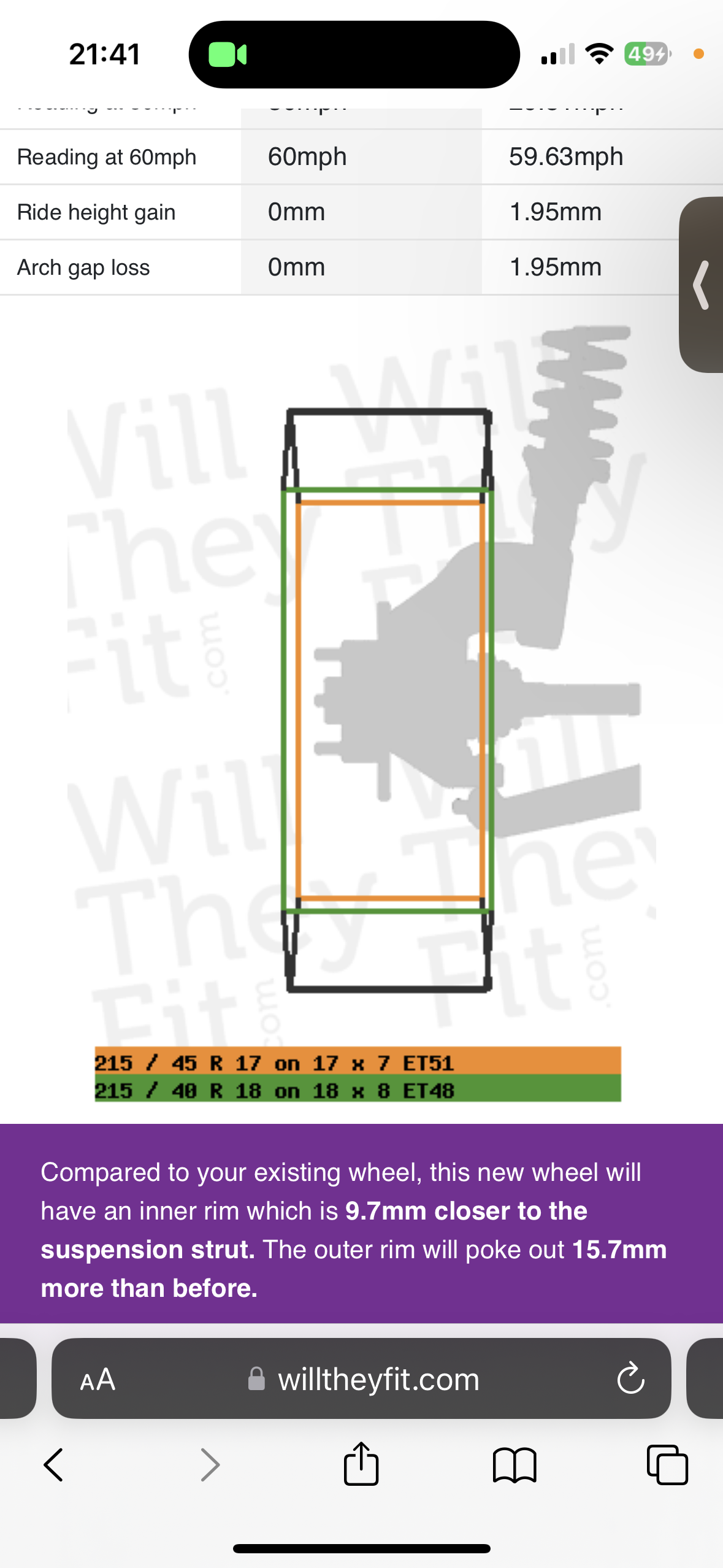

Hi, I’m wondering if anyone can help me. I’m looking at purchasing 8J R18 ET45-48 Wheels for my polo. I’m currently running stock 7J R17 ET51 tortosa alloys. I have checked that 8J wheels will fit and I have enough clearance. I just wondered what is a good amount for new wheels to ’poke’ out compared to the stock ones. Willtheyfit.com has said Et48 wheels would stick out 15mm. I want the wheels to poke out compared to my stock ones but just wondered what is a sensible amount as I’ve seen ET35s can poke out too far.

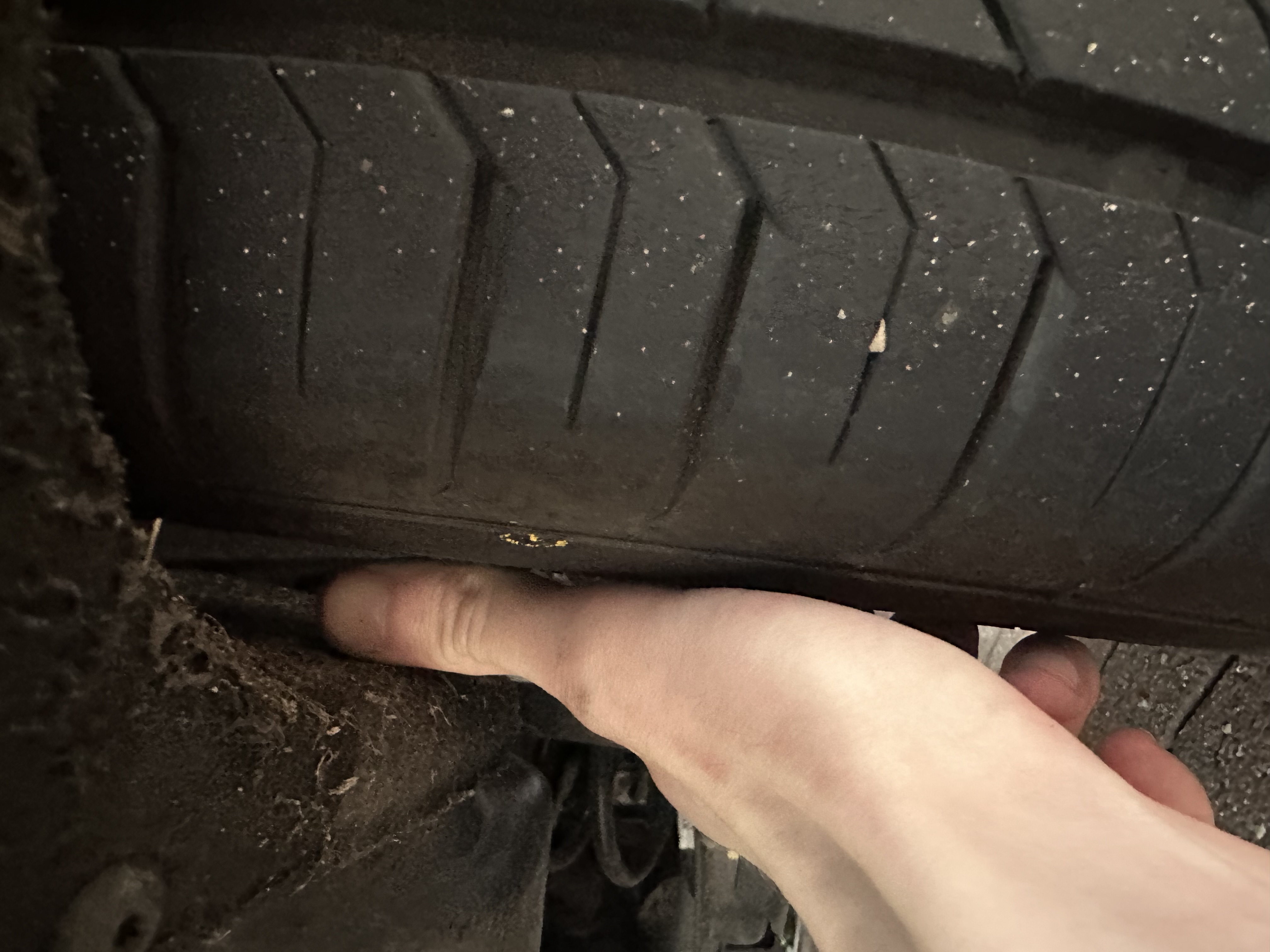

ET 48s would sit 9.7mm closer to my suspension and I have around 15-20mm clearance currently (the width of my thumb) so I think they should fit and every website is telling me they will. I’m probably overthinking it, I just wondered if anyone had any experience of fitting 8Js to a polo AW and what extra poke to standard wheels is a sensible amount?

There’s been forum members who’ve fitted 18 x 8J alloys with offsets of ET45 and ET48 to their AW model Polos so they ought to fit. There’s some useful / relevant information in the posts at the links below;

Be aware that the rear wheel arch liners are sometimes poorly fitted from the factory and even the GTI with factory fitted 7.5J x 18” ET51 alloys have had the inside face of the tyres rubbing against the liner.
An offset appropriate for the Polo is an important consideration to avoid either;
https://www.uk-polos.net/viewtopic.php? ... 8”#p573667
https://www.uk-polos.net/viewtopic.php? ... 8”#p564590
https://www.uk-polos.net/viewtopic.php? ... 8”#p558386
You’ll probably find other relevant posts if you use the forum advanced search facility (top right of screen - click on the cog wheel symbol and search on ‘offset’, restricting your search to the AW/BZ forum board).
- the inner face of the wheel and tyre being too close to the suspension strut
- the outer face of the wheel protruding out too far as you may experience tyre rubbing issues, especially under certain manoeuvres such as enthusiastic cornering, when the car is fully laden or if your car is lowered.
- Ensure the new alloys you’re considering have a bolt pattern of 5x100.
- When considering potential clearance issues, it’s important to allow for the extra width of the tyres when reviewing the results from the calculator on www.willtheyfit.com website, as tyres will add a few extra mm’s to the width of the wheel.
