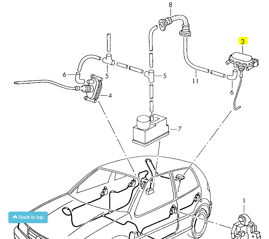

Normally all Polo's 6N1 are fitted with pneumatic locking. I believe electric locking for the Polo begun in 2002 with the Polo 9n. Both 6N1 and 6N2 Polo's should have pneumatic locking. Reading your reply, I assume a previous owner removed the central locking for some reason. The original part number is 6N0 862 159A or 6N0 862 159B.
CV Polo.PNG (93.4 KiB) Viewed 17578 times
In the picture above you can see nr. 3 is the vacuum actuator which belongs in your car. I took the liberty to share the website where I found this information so you can browse around for yourself. I hope you have enough information to carry on with your repair :mrgreen:
Source: volkswagen.7zap.com
