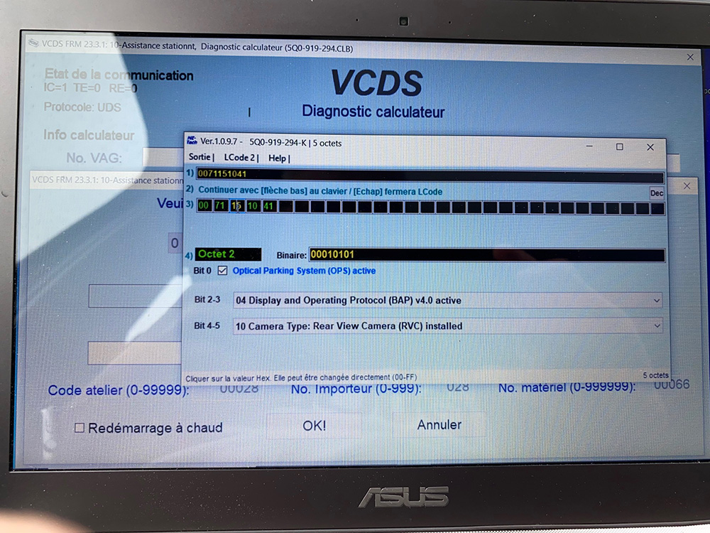

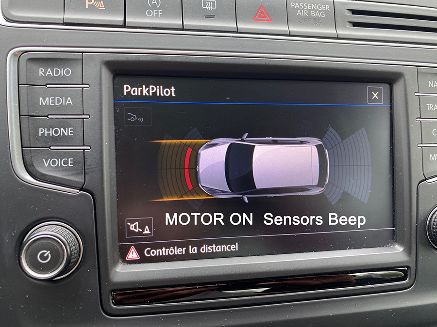

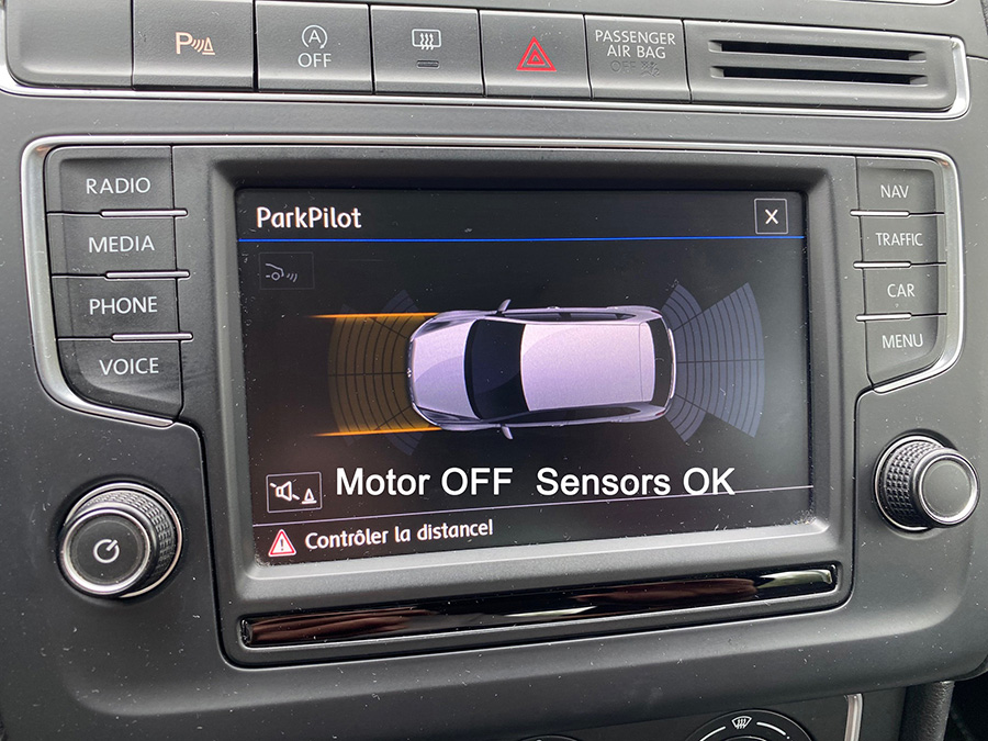

Hello,
I retrofited my park pilot 4k to 8k, oem, except for the front radars that i bought on ali.
I coded all, but i 've got a problem, when engine is on, front radars beep continually, when i stop the engine with contact on it's ok.
I don't understand why, front radars are painted, Polo 6c got abs and esc and i installed the pdc button.
Any idea ? coding seems to be ok. Other, my wiring come from passenger hole, so the the left and right sensor are inverted on OPS, is it possible to swap it by coding ?
Thanks !

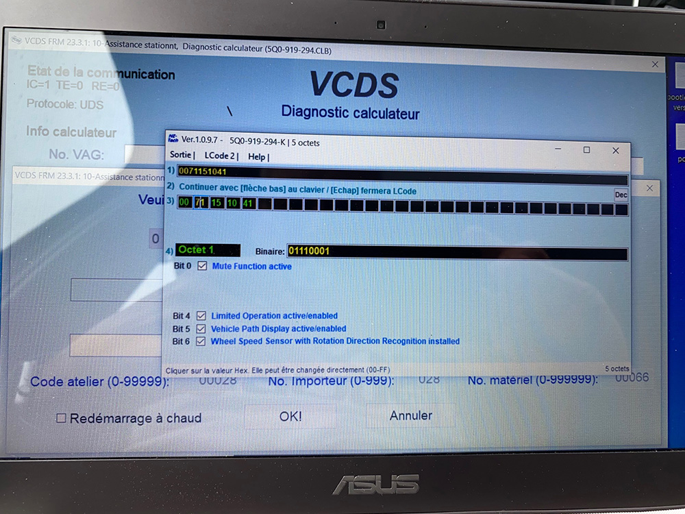

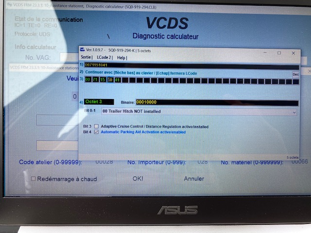

Oem kit from carsystem, it.s a good idea for coupling point from rear bumper, must found diagram.
Other an idea about my problem ?

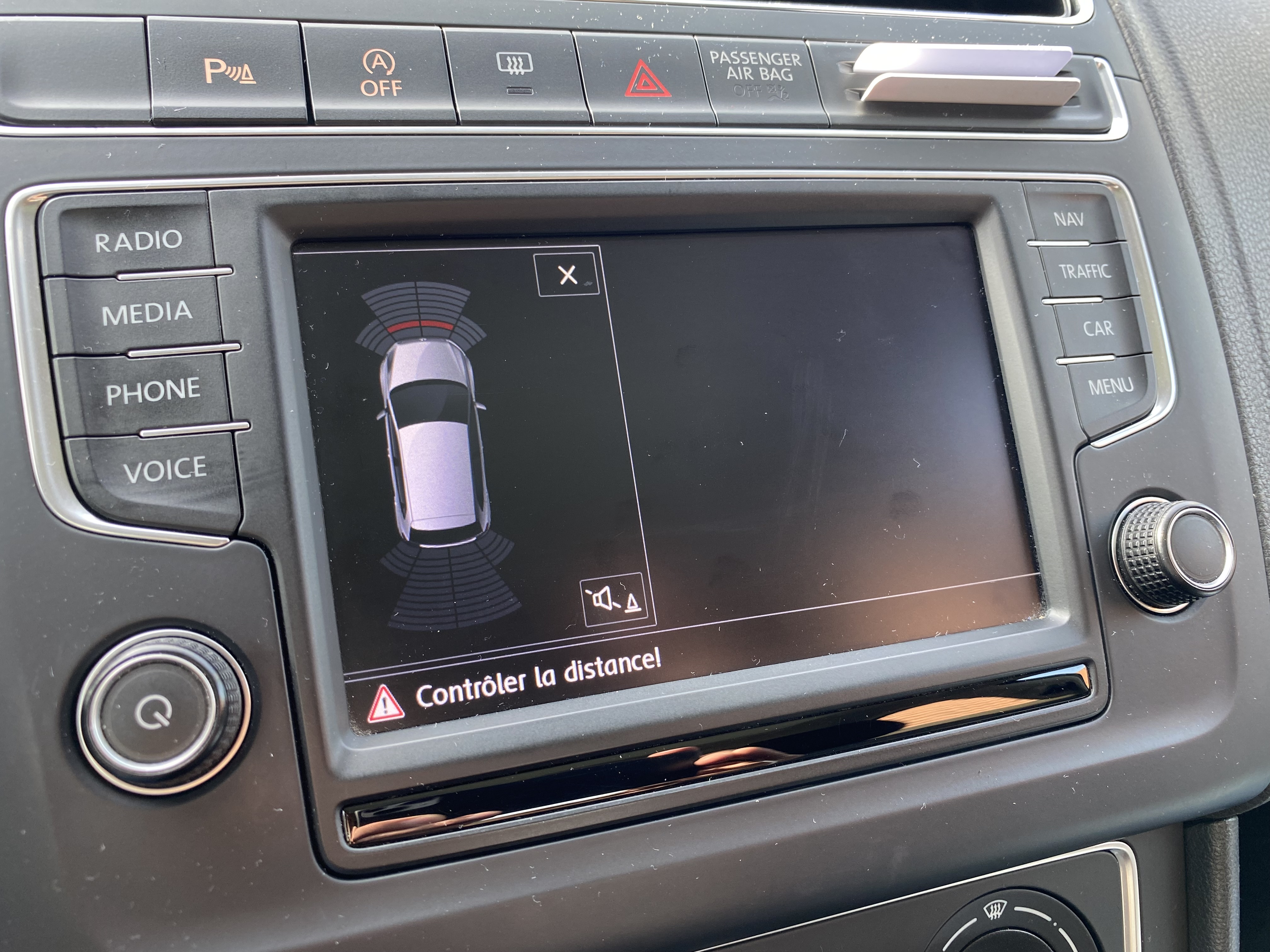

I fix my problem with new originals sensors.
On carplay, when pdc is on, the screen become black, do you have same thing ? Or i need a new coding ?
On radio or gps no black screen.
