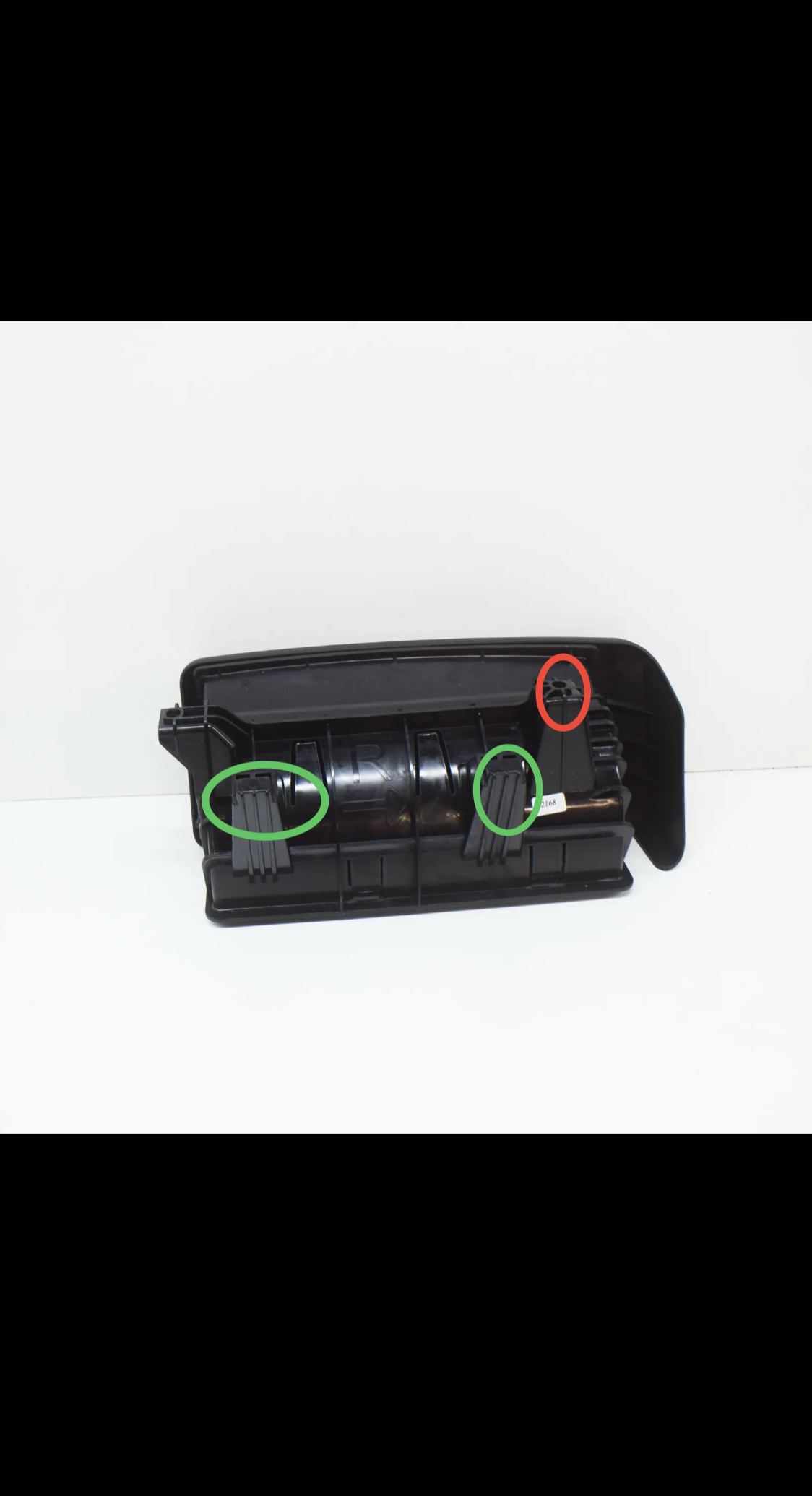

Teee wrote: Thu Feb 11, 2021 5:05 pm Today I installed a under seat storage box it’s originally from a Audi a1 or seat Arona & possibly other cars. after a bit of digging around I came to realise the metal structures/skeleton under the seats on these cars are the same but the foam cushions are different. The box is Probably not as big as I’d like but it’s better then nothing. Overall I’m happy to have extra storage to keep things out of site.
Hi Tee,
Just read this. What model of Polo do you have?
Interested to see if this will fit my GTI AW pre facelift.
Was it an easy fit?
Images below are from car wows review of the seat arona.
Part numbers:
Storage box : 81A8826024PK
Speed nut : N90088003 (x2 pcs)
Oval Hexagon Socket Head Bolt : N90737101 (x2 pcs)
I have spare nuts(8) and bolts(8) as it worked out cheaper to buy as a pack of 10 so if anyone is interested in doing this retrofit pm me I’ll send them out for free as I have no use for them. (Uk only)

@Teee’s forum signature details (top right corner of each forum member’s posts) shows their car as a Polo GTI+ which is a pre-facelift (AW) model.Grumpyolman wrote: Sun Sep 17, 2023 10:00 pmHi Tee,Teee wrote: Thu Feb 11, 2021 5:05 pm Today I installed a under seat storage box it’s originally from a Audi a1 or seat Arona & possibly other cars. after a bit of digging around I came to realise the metal structures/skeleton under the seats on these cars are the same but the foam cushions are different. The box is Probably not as big as I’d like but it’s better then nothing. Overall I’m happy to have extra storage to keep things out of site.
Was it an easy fit?

I have a polo gti + 2019 & fitting was pretty straightforward only part that was a bit fiddly was one of the bolts isn’t easy to access, I’ve circled it in red in the picture below. The area circled in green just hook on underneath the seat. Hope this is some help all the best.

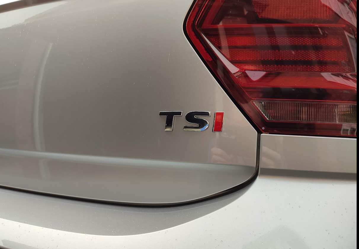

Hardly ground breaking but I fitted TSI Lettering to the rear hatch today
I love the front design of the front of the AW Polos but the rear is very plain and the small polo badge is lost on my silver metallic paintwork, too.. it is just an expanse of metal (the hatch that is) I know i'm not going to the expense of spoilers and diffusers etc. I just thought of fitting something appropriate (meaning real) to balance things up a tad and a distraction for the eyes.
Ironically it wasn't going to be easy; as anything not level or not matched with the existing badge would just look like an eyesore. I have a laser level (fortunately) so that bit was easier. I taped a plastic ruler to the laser line and made sure to use the bottom edges of the letter for level as the letters are italic/slanted and I wanted to keep the distance between the letters the same as well.
anyway it was a cheap project and my Polo does have a TSI engine

Here in South Africa the model just below the GTI is fitted with the same TSI badge you fitted to your vehicle. Is that not the case there in the UK?grazuncle2 wrote: Thu Oct 05, 2023 11:57 am
anyway it was a cheap project and my Polo does have a TSI engine![]()

Interesting.
In
I've not seen many badges on polos.. See a few with the small and slim rectangular bluemotion badge
Perhaps others will know better?

I've always thought that were VW supply a car with 2 power outputs from the same engine design/size, why don't they make the "I" red in the higher powered output cars.
I keep meaning to check which Golfs use the red "I" to see if that is the way it is done to Golfs.
My only issue with a car having a red "I" fitted to it after it has been sold new is, most insurance companies would make the point that it is making it more attractive to "nasty" people, and so the risk is increased.
Edit:- maybe you can see where this is going, ie if I hadn't had that insurance issue thought, I'd think that my wife's 2015 VW Polo 1.2TSI would by now have a red "I" !
