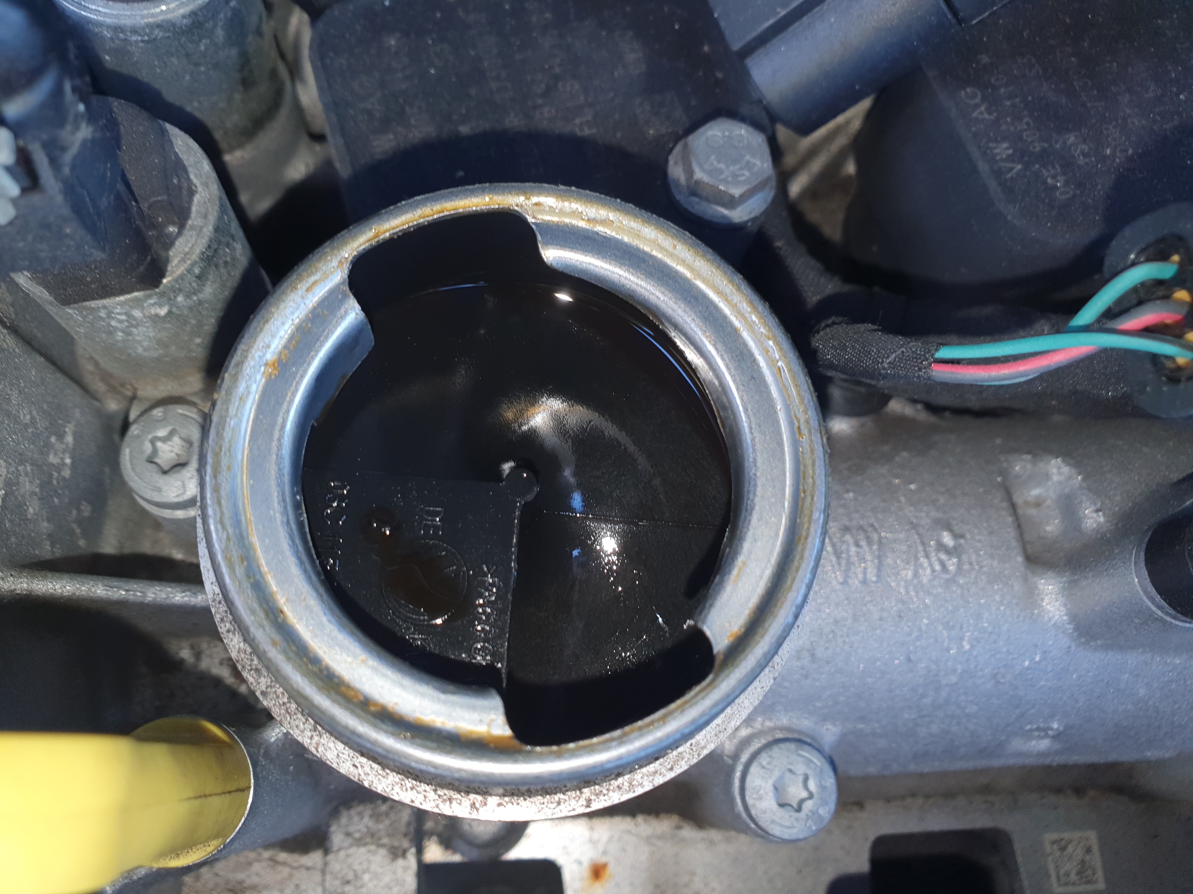

I have a 2016 1.4 tsi with active Cylinder.
I want to change oil and in the oil filling I have a plastic thing which slows oil filling. Is there a tool or something to make filling less painful.
Last time I filled it via the dipstick using tube and hung oil above so gravity did its thing.

Maybe I'm lucky, but years ago I bought a filling funnel thing that fits into/onto that cover flange perfectly and the oil flows down that (restricted) point easily and quickly.
Unfortunately, as I discovered when I changed the oil in my daughter's 2019 Leon Cupra, the oil filler has moved to the drive chain area - but turning the clock back 20 or so years and using a suitable plastic funnel worked fine.
So, maybe in your case, you should try to get a plastic funnel that fits down past that baffle plate - just a though as I have other ways of doing this as outlined above.
Edit:- there are now some maybe slightly more expensive "flexible" options to what was available when I bought my one which was a Laser Tools offering, now the funnel part tends to be sold as one part and the adaptor to suit your specific car, as a second part.
Ie https://www.ebay.co.uk/itm/385219145207 ... p_homepage the individual adaptors are listed at the side of that ebay listing.
Also just stuff "VAG oil filling funnel" into ebay etc for other options.

Sealey make a funnel that fits most vw engines which uses the same fixing as the oil filler cap , so you secure the funnel on the same way you would put the filler cap on. this in turn makes filling a lot easier and quicker.
Just google sealey vw funnel for results .

The Sealey version is exactly the same as what I bought branded as a Laser Tools item, the one I included a ebay link for is a 2 piece thing and much cheaper, with the option of buying new adaptors for other cars within the VW Group and others.
