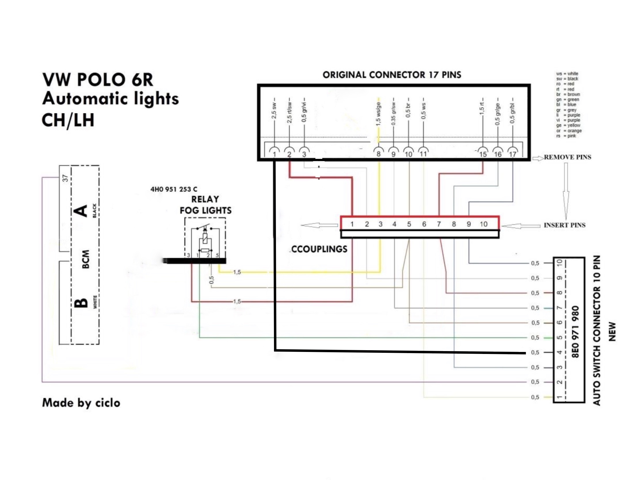

So I have a 2018 skoda rapid(NA) top line and would like to retrofit auto headlights. I read through multiple auto headlight thread for polo 6r polo/polo sedan but there are a few quirks which I need help in figuring out. I also looked at ciclo’s pdf with wiring and it was very helpful, but again I am lost on little details.

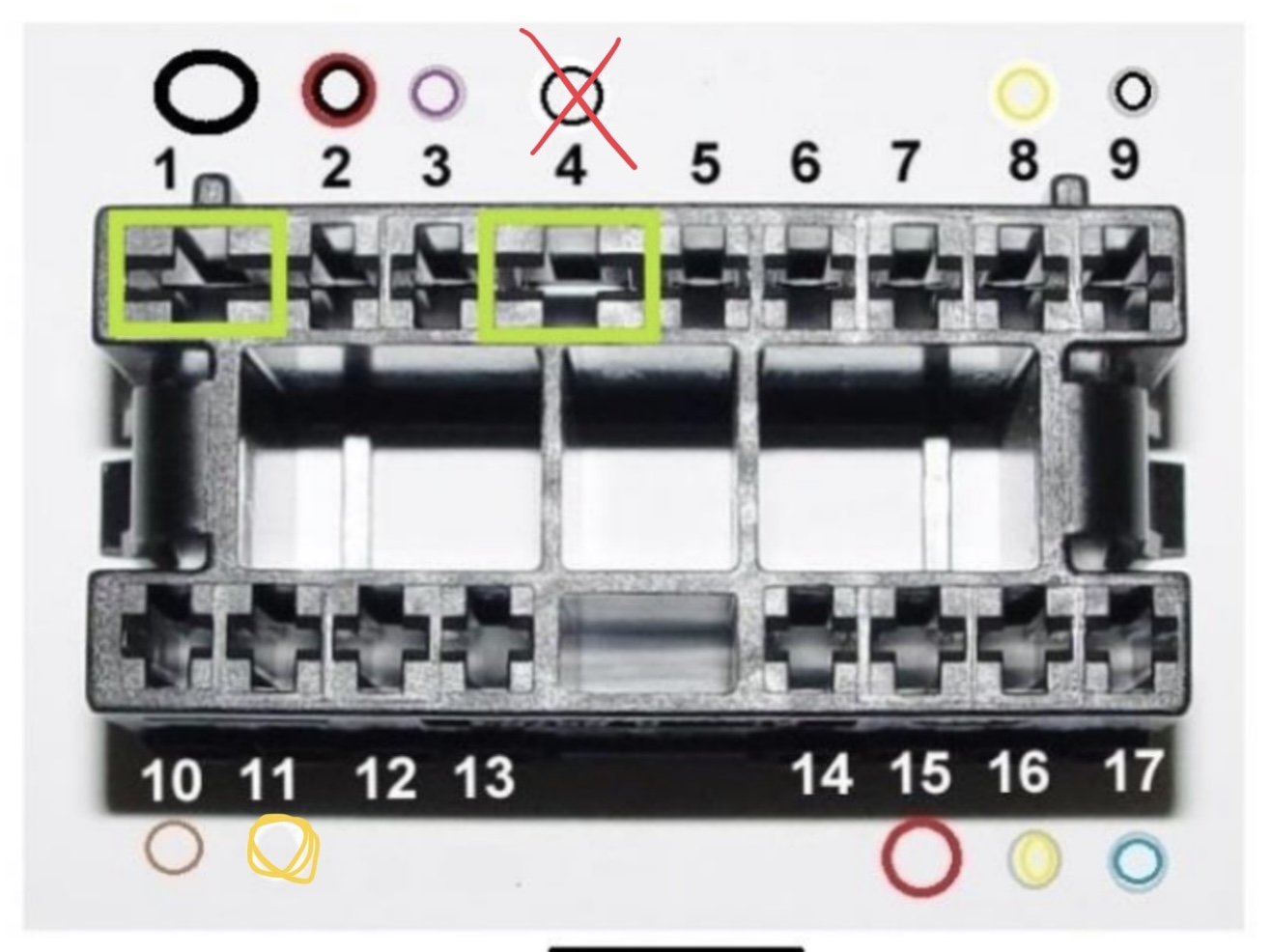

As you can see, I have some features of bcm max and I assume not a lot of wiring will be required(hopefully). According to the wiring picture in the pdf, my connector differs slightly as below. Compared, I have total 10 wires. And then 11 is yellow(not white) wire, and 4 wire is missing so I don’t know what should I do with the relay connections. I assume that is a crucial part of the circuit.

it makes sense that number 4 is missing (terminal 56 power supply); your stalks are very likely already in T6/VW Up! FL configuration. So you don't need the relay for the headlights/high beams.
You can install the 10-pin light switch easily now, just make the conversion from 17 to 10 pin. It's very easy in your case.

1.Is this the connector I need? “10 pin connector F 191972725” (I’m not sure because in the guide it’s a red connector)
2.So following the guide, I will have 9 wires connected to the 10 pin connector, should the remaining black wire(pin 1 in original connector) be left isolated?
3.Is there a part no. for male 17 pin connector? I will de-pin original if required, but thought of making a converter instead using this.
4. In coding, I need to enable CH,LH and assistant driving lights?
Posts: 6694
Re: 2018 skoda rapid auto headlights + CH/LH
1 doesn't matter as long as the male and femaie connector are a match
2 the fat black one goes to T2 connector
3 no there is not
4 yes and many more

I would still need to wire a relay for the fog lamps right? I assume the oem switch bridges 2 and 8 for front fogs, as the 10 pin switch doesn’t have a slot for “contact X” and the relay bridges 2 and 8. I initially thought I didn’t need this relay, hence the confusion.
Re: Q2, following the wiring diagram, the fat black goes to t2 which also has t56 power supply(slot 4 oem). Since I’m missing this wire t2 connector will only have one wire(slot 1 oem),the fat black wire which goes to 10 pin switch slot 4 from the coupling. Should I connect this wire directly to 10 pin slot 4? Or will I have a headlight relay from factory and need to add the wire there? I’m completely lost regarding this.
Thanks for bearing with me iichel and answering my questions patiently. I’ll look into the required coding changes too. I guess I need to add a VCDS to the parts list.
I thought my specific wiring looked like this, I assume it’s wrong then?
Posts: 6694
Are your fog lights with static cornering lights? If so, you don't need the relay. If the fog lights are powered directly via light switch, you do need the relay.
