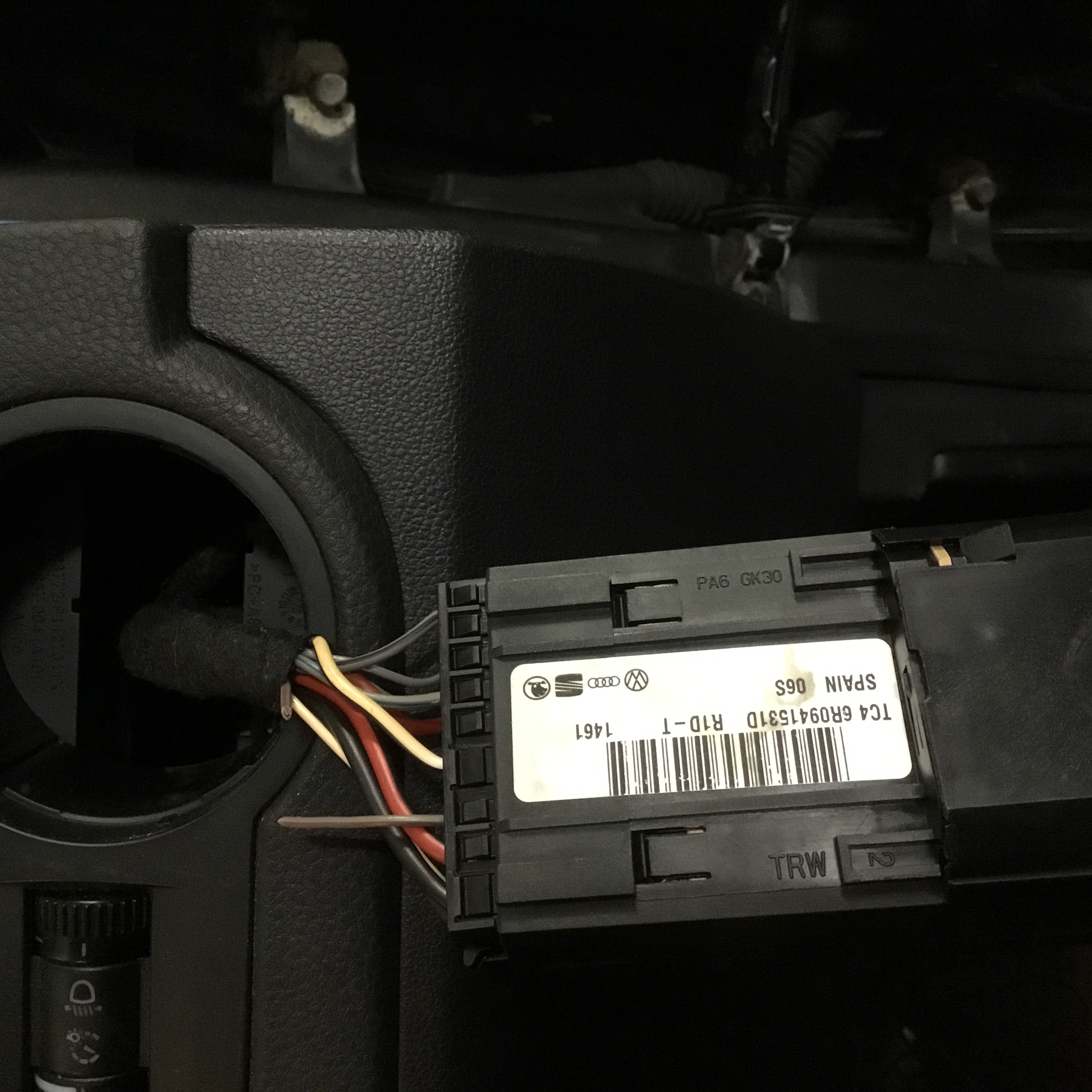

Anyone got an image of the switch showing pin to remove?
Do the pins easily pull out?
Re: Prevent low beam from turning on as drl
Bobupndown wrote: Mon Dec 25, 2023 1:43 pm Anyone got an image of the switch showing pin to remove?
just put a small piece of electrical tape over the pin
its the TFL pin ( on your light switch) , third on the bottom ( from left)
Here ya go... though as you can see I didn't apply the suggested finesse approach of removing the terminal. Instead I simply cut the wire and insulated both ends using heatshrink. :cry: (excuses, excuses... I didn't have the terminal tool to hand)
I can confirm that the only effect I'm aware of on my 2011 base 'S' model is that the dipped beam filament no longer illuminates when ignition is 'on' and lighting switch is set to '0'. :D
Maybe of help too, on my 2011 base 'S' model the wire in question was a grey with purple tracer located just as amer6R says "third wire along"

Thanks guys, in the end I just bent the pin so that it no longer goes into the connector. DRL headlights off, the bulbs will perhaps last longer now.
