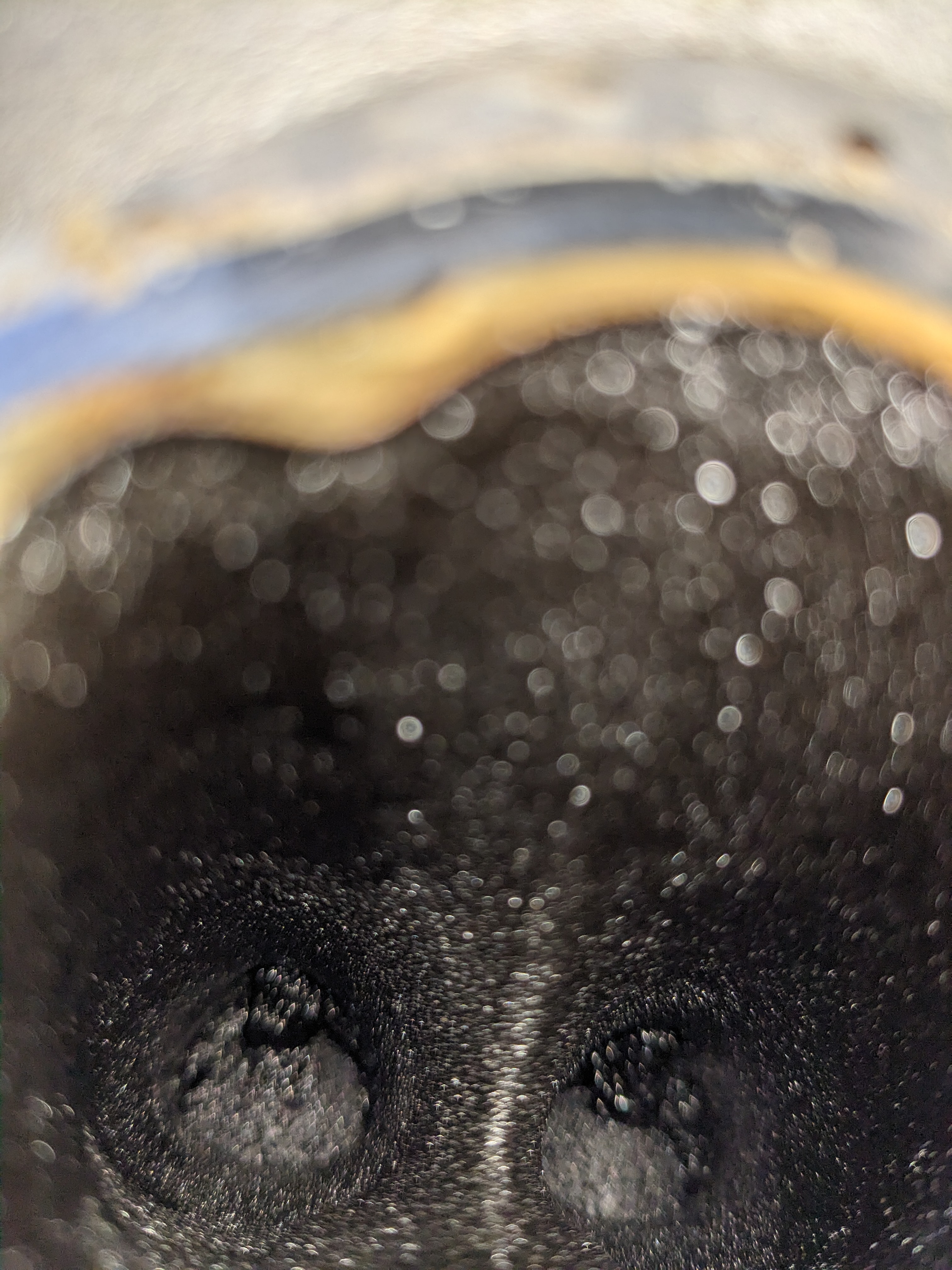

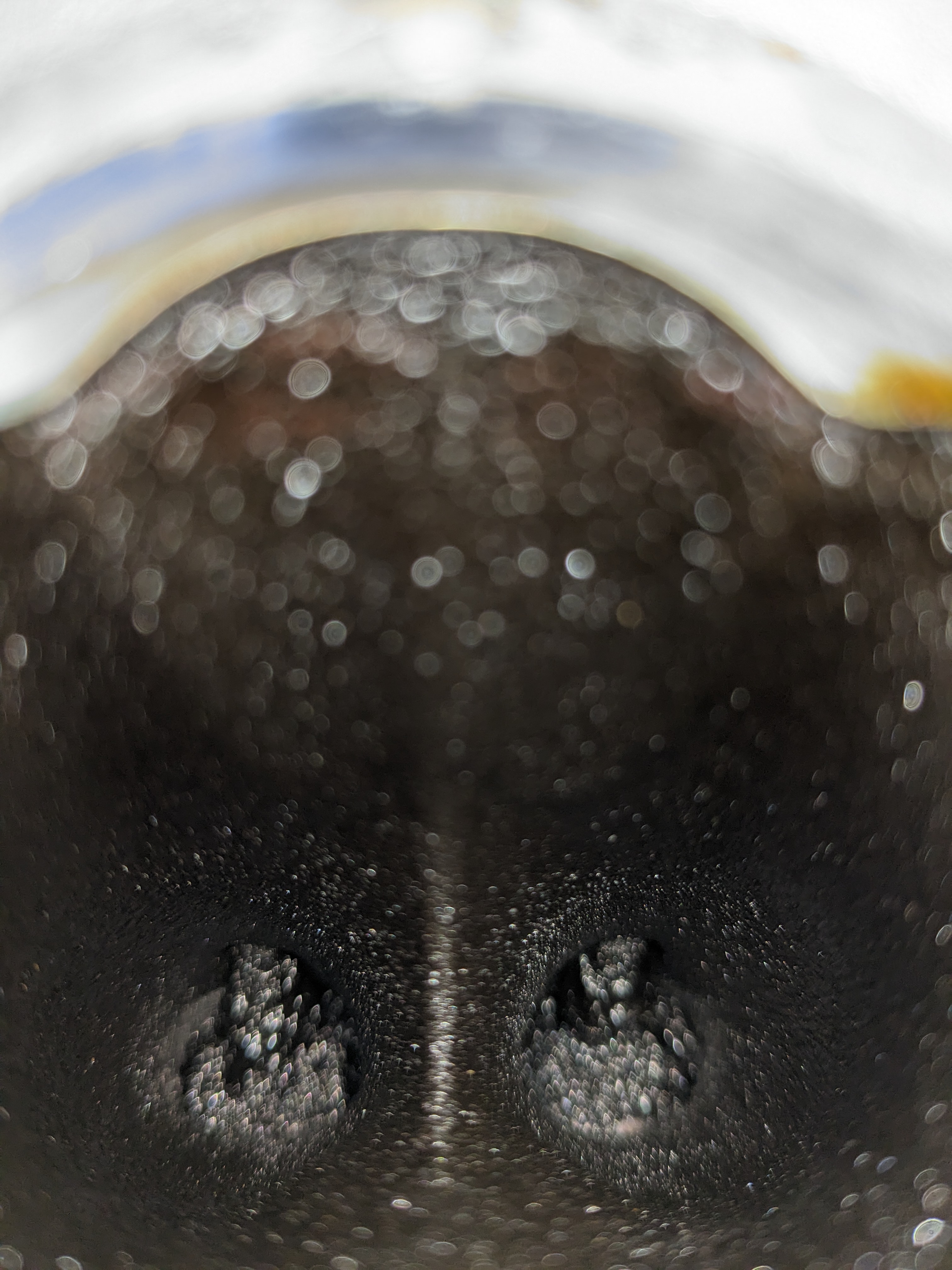

Hey fox,
After many years of troubleshooting why my engine is running rough on cold day and why I have some missfire, I took, fews days back, the decision to remove the intake manifold to check
my intake valves.
And with no surpise, they are full of carbon build up thanks to direct injection.
With the older port injection, valves were cleaned with fuel and with time, stay clean.
Pictures of my engine (Cylinder 1 and 2):
For info, this car is my daily. Running only on premium fuel and premium oil (0W30 Shell), changes every 10000 km.
Only highway, almost no city.
I have to fix an appointment with a specialist to clean this crap.
But, now I'm looking to avoid/reduce this ammount of crap for the futur.

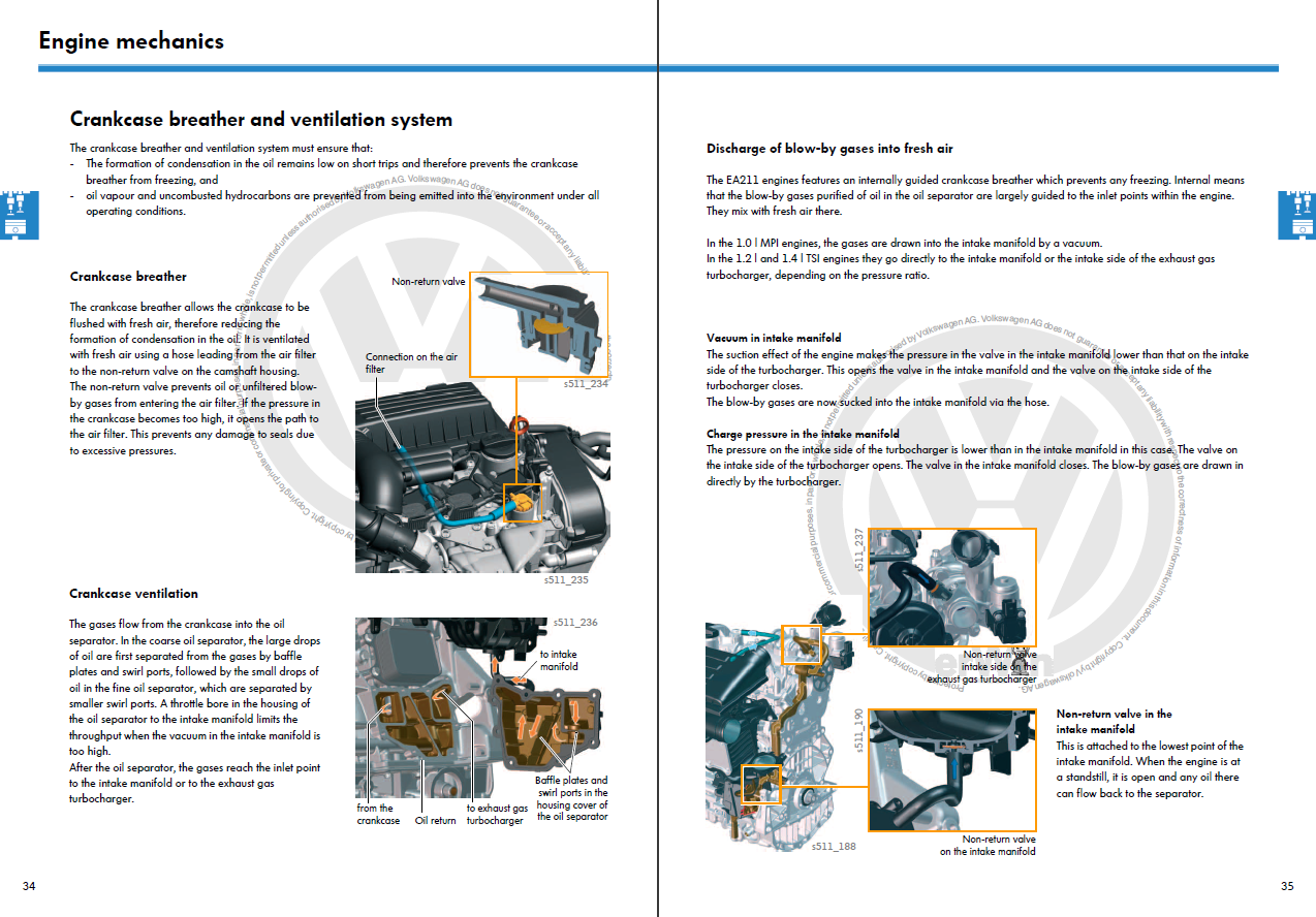

An Oil Catch Can seems prettry obvious. But because EA211 engines are not made for sport/racing car, there is no official kit like the 2.0 TSI.
This engine have a PCV installed on the bottom.
But depending on the pressure ratio, oil vapour will be sent or in the intake manifold, or in the low pressure side of the turbo.
-At idle (low speed)/engine off: non return valve on the intake manifold open. On the turbo low pressure side, it close.
-At high speed (boot demand): non return valve on the intake manifold close. On the turbo side, it open.
So I'm hesitating for the installation: turbo or intake manifold side.
I'm considering mainly turbo side because on this engine your are driving mainly on torque and so, turbo pressure.

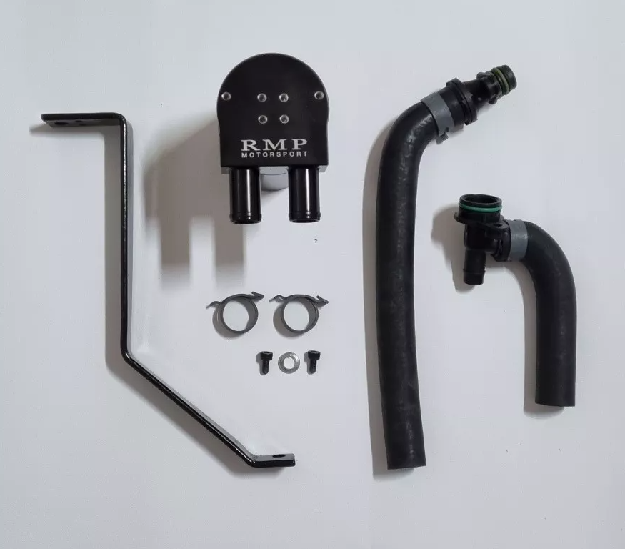

My idea is simple and it's like this kit (from brasil):
Bought an other foam hose (between engine over head to turbo) cut the hose in the middle and keep the two VW connector and install rubber hose between each connector to the oil catch can.

Regarding the catch can pictured above: where can one get those hose connectors on the 2 pipes?
Probably easy in Brazil with VW manufacturing down there. Surely they aren't salvaging those.
I also looked up the price for that kit and it way more expensive than a Provent200.

To get this connector, you have to remove or buy an other one from your local VW dealer. Remove the isolation foam, cut the plastic tube inside as the required lenght and it should be okey.

Le_Combattant wrote: Wed Feb 21, 2024 7:15 pm To get this connector, you have to remove or buy an other one from your local VW dealer. Remove the isolation foam, cut the plastic tube inside as the required lenght and it should be okey.
Ah, I suspected that. I hate proprietary connectors like this especially given that they're mostly Normaquick.

Le_Combattant wrote: Thu Feb 22, 2024 11:17 am I also considered the Mann+Hummel Provent 200 Oil Catch Can as a good option but, the fact there is no tank to catch oil is a major design flaw in my opinion.
It mean you have to design/buy an other tank, found some place in your engine bay to put it.
So for me it's a big no.
Understood. A drain hose has enough capacity to hold quite a bit of oil though. The diesel guys in Australia do a similar thing.
As for space, there's a huge open area just next to the ABS pump above the gearbox. A bracket connected to the battery tray mount and bolt of the ABS mount will allow mounting it in there. Well, that's the spot I had in mind; the actual size of the Provent200 will be the ultimate decider on fitment.
Provent was really design with drain back to sump in mind. It's not ideal for sure.

Le_Combattant wrote: Thu Feb 22, 2024 11:17 am Your idea is good (with the "T" piece connections) but there is a design flaw.
On the intake manifold the non return valve open when engine is stopped or running on idle. It means, oil will go back to the engine.
With a T piece connection, oil will be trapped inside the hose and couldn't no longer go back in the engine.
Not entirely following this one.
Are you saying the oil condensing in that very short tube is what is running back to the engine?
That's a very short run and under strong vacuum (limited by the pipe diameter in that document). The oil separator has pulled out most of the bigger drops of oil (mostly).
There should be no flowing oil in that pipe. It's messy vapour.
The hose from oil separator to catch can will run upwards. If oil condenses in it it will roll back. If it's flooded with oil it will sucked up by the catch can vacuum.
The hose out of the oil sepator to the valves will be cleaner vapour, we're hoping.
If I have to think of a flaw it is how the vacuum signals will react.
The catch can T-piece is joining the vacuum sources.
Now the intake valve when closed under boost will now also be experiencing a vacuum pull from the turbo side; possibly increasing stress on it.
Then again, the turbo intake is pulling on it anyway, just through the valve cover and then crankcase space. It's just probably way less vacuum.
It's a tricky thing; I'm just trying to cover both vents to reduce as much vapours as possible.
Le_Combattant wrote: Thu Feb 22, 2024 11:17 am That's why I'm focusing on turbo side only.
By doing that I catch all major oil vapours and by leaving the factory setup at the intake manifold I could let oil go back to the engine.c
Turbo side is the simplest approach, for sure.
I think the effectiveness will be good. If you think about it, blowby gases are maximised under boost anyway.
This would be the simplest starting point to see effectiveness. It will definitely be greatly reduced. If not, then I maintain pulling from the oil separator should be looked at as well.

"Not entirely following this one.
It's a tricky thing; I'm just trying to cover both vents to reduce as much vapours as possible"
I mean, when engine is stopped or running on idle (vacuum created on intake manifold) the valve at the bottom is open.
So when engine is running, vapour are directly going into manifold.
When engine is stopped, this valve stay open and let condensed oil going back to engine. If you remove you boost pipe and your throttle body, you will see some oil in the bottom of the intake manifold. This one is comming for sure from turbo side.
2226
Posts: 544
Re: EA211 Oil Catch can
Post by 2226 »
Le_Combattant wrote: Thu Feb 22, 2024 2:34 pm I mean, when engine is stopped or running on idle (vacuum created on intake manifold) the valve at the bottom is open.
Ok, stupid me. I see what you mean and where I was mistaken.
That valve is normally-open for draining.
Bit of a pity as it would be great to filter those gases too.
So yeah, I agree, most of the oil can be reduced on turbo-side alone. I mean, the hope is that that intake valve doesn't need to drain anything anyway. :D

2226 wrote: Thu Feb 22, 2024 6:19 pm

Le_Combattant wrote: Thu Feb 22, 2024 6:22 pm No problemo, my english is not perfect :shock:
Well if I eyesight didn't suck so bad right now then maybe I would've read that detail in the lower right of the document above.
Le_Combattant wrote: Thu Feb 22, 2024 6:22 pm So now I need to monitor the boost pressure needed to open the valve on turbo side. I have a vacuum pump (normally for coolant system) but could be adapted on the hose between the head of the engine, and the turbo.
Would be interesting to know.
Does this not just operate on vacuum only?
2226
Posts: 544
Post by 2226 »
Actually, if you think about it, it will operate on differential pressure.
It's the vacuum at the oil separator vs the vacuum at the turbo inlet. They're connected down at the oil separator.
