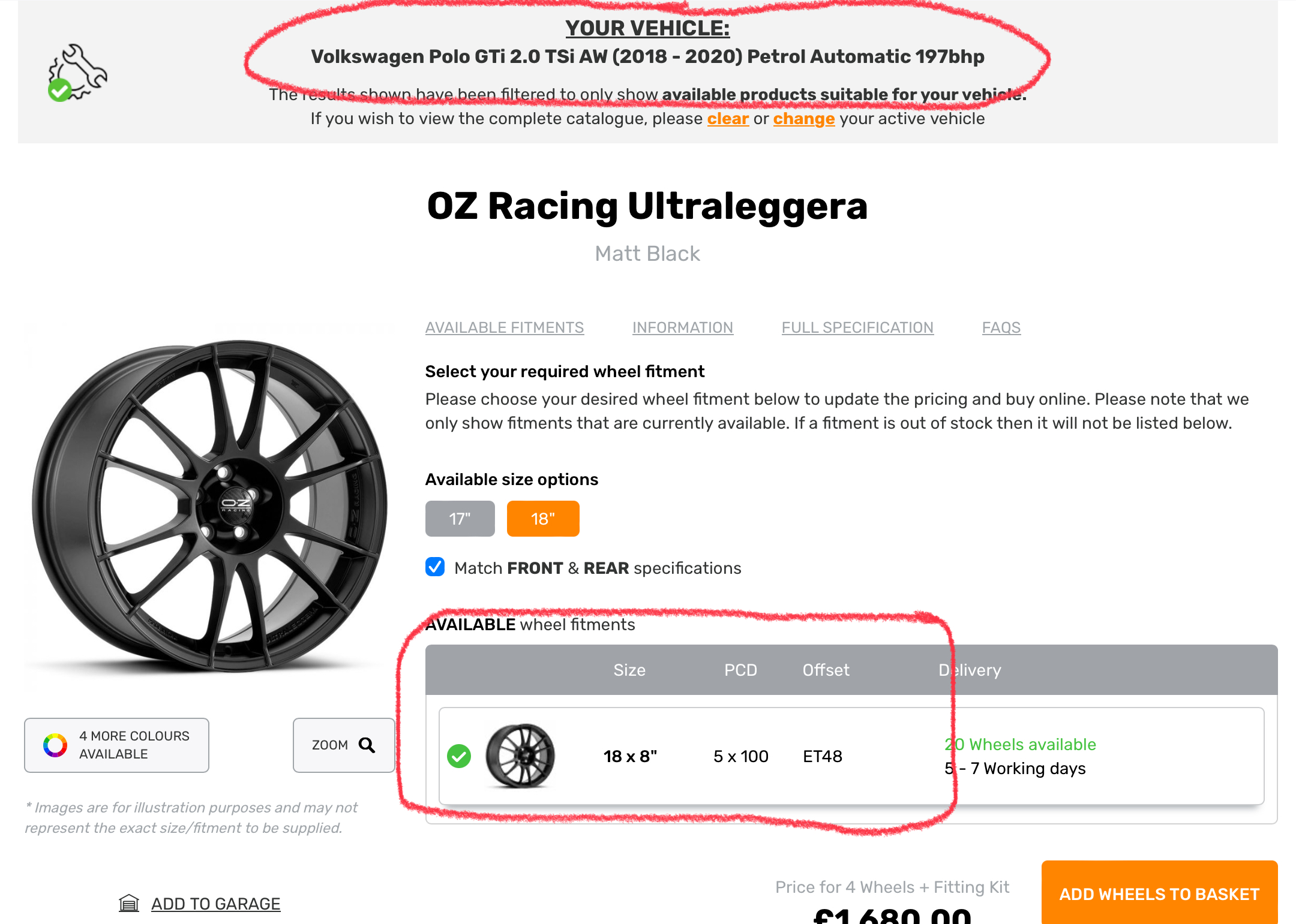

Hello
I have a question about some wheels i am looking to buy for my polo.. So as original fit of Brescia wheels 18x7.5 et 51 100x5 i was looking to get OZ ULTRALEGGERA MATT BLACK 18X8 100x5 ET48. Does this fit the car ?
Posts: 3850
Re: Wheel fit for Polo GTI AW 2020
They should fit without any issues - alloy wheel retailer Rimstyle confirm on their website (www.rimstyle.com) that 18 x 8J alloys with an offset of ET48 will fit the AW Polo GTI - see screenshot below.
If you use the calculator on www.willtheyfit.com and input details of your existing and new wheel/tyre set up, it will calculate any differences in poke and tuck of your proposed new wheel / tyre set up and your existing set up. Presumably you’ll be keeping the same size tyres (215/40 R18) as those fitted to your Brescia alloys?
