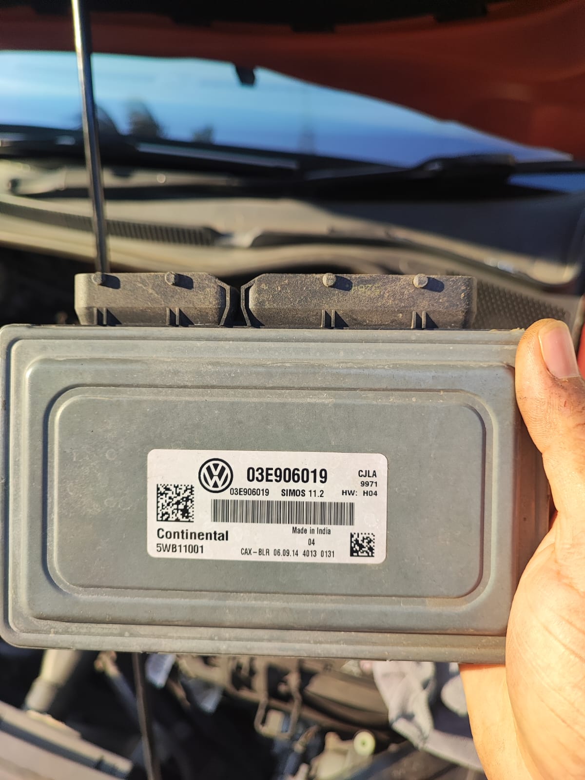

Sorry I got stuck in work.
so the ECU is 03E906019 CJLA 9971. Continental 5WB11001, I have attached the ECU photo for reference & BCM was 87R. Which I think comes from factory for 1.2 MPI Highline variants.
The problem while doing this I faced is, the Pin used for ECU pin 69 was still unknown which one to put, I did use the PIN use is used in instrument cluster. I chopped a bit and put it into the pin 69.
patil
Posts: 577
Post by patil »
Hi sorry for late reply. Your ECU doesn't support CCS function. You need to replace the ECU to updated version or flash the updated firmware in your ECU. Pin 69 is correct pin for 1.2MPI CJLA engine for CCS.
