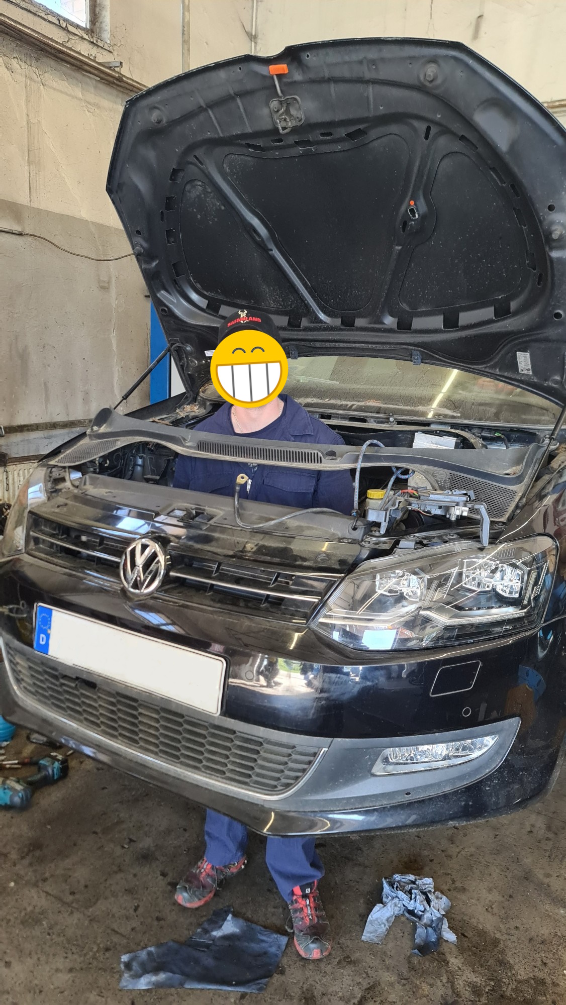

Now here the promised pictures:
My extremely helpful colleague, happily standing in my completely stripped out engine bay:
Jemand im Motorraum.jpg (773.85 KiB) Viewed 4248 times

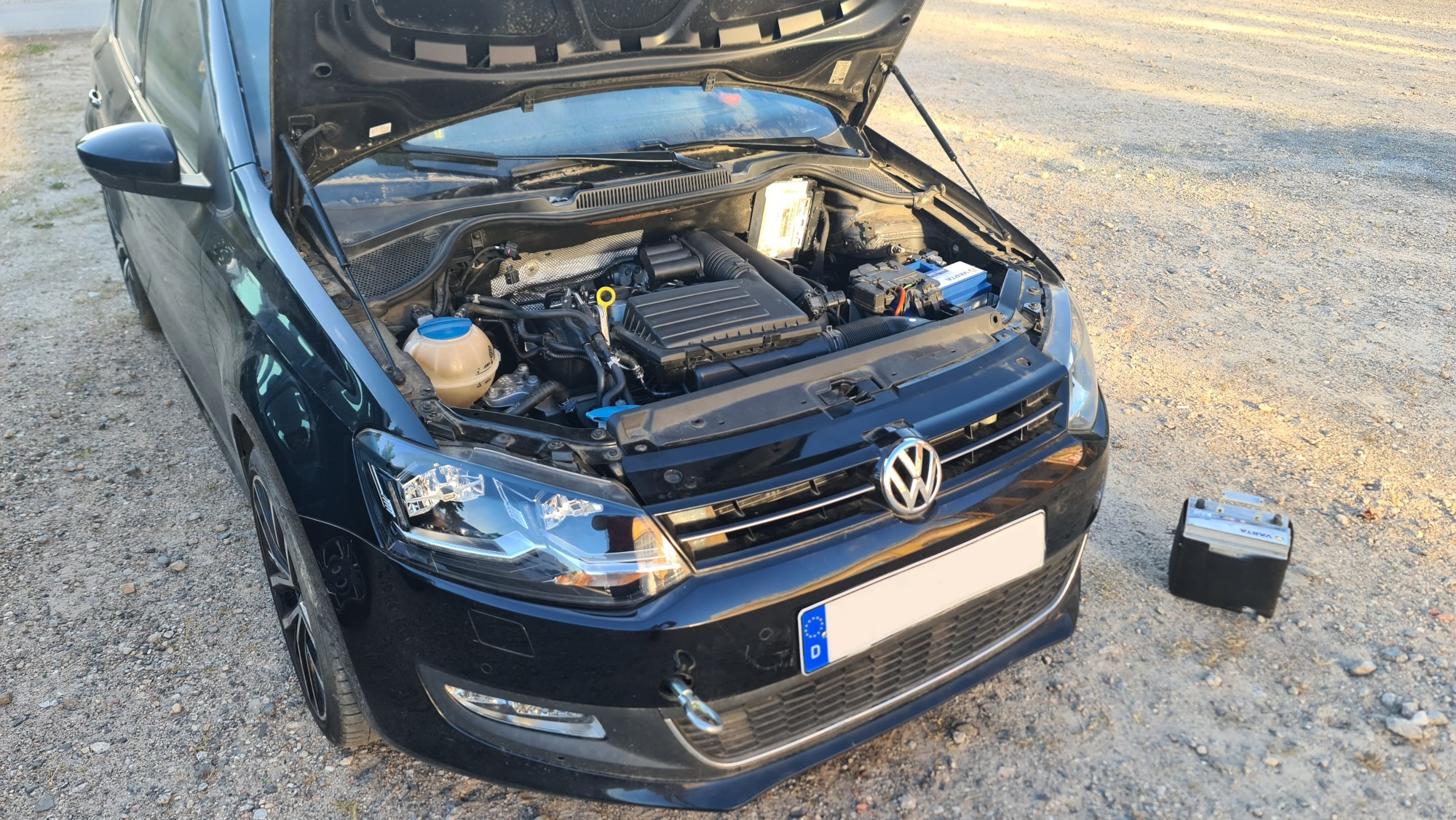

And my kind of finished looking engine bay about three hours later (ignore the crooked wiper :lol: ):
Eingebauter Motor bearbeitet.jpg (1.04 MiB) Viewed 4248 times
Things left to do: driveshafts (yes I know I should have done it right after putting the engine in), AC compressor, alternator, belt, exhaust system, starter. In other words: Just a few hours of work left and I might hear my car come back to live after more than half a year :D

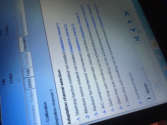

change some adaptation channels in 08 hvac to fix the fan issues

Thanks! That has got to be it!
Sadly, there are no labels in VCDS for the adaption channels, so I just guessed and changed the following:
Ch 1: 0 -> 1
Ch 2: 0 -> 1 (I installed one of these coombined rain and moisture sensors ages ago together with my high beam assist conversion)
Ch 3: 1 -> 0
Ch 4: I don't know the value, but I haven't changed it
Ch 5-7: 0 -> 1
Now it stopped moaning about the missing wires, but instead started infoming me about being coded wrong. So there is still some experimenting left to do. But thanks Michel, without your picture i would never have been able to fix that issue. :D

Concerning the start-stop-button I still haven't found the solution. Start-Stop itself is working on the other hand, so I might just procrastinate on that problem a little bit. For the technical inspection it just has to work at all.

Paulpelz wrote: Wed May 29, 2024 2:35 pm Concerning the start-stop-button I still haven't found the solution. Start-Stop itself is working on the other hand, so I might just procrastinate on that problem a little bit. For the technical inspection it just has to work at all.
Wrong. I couldn't leave it alone. And it turns out I'm an idiot.
I wired negative cables to two pins that should have +12 volts. I have absolutely no idea how I f*cked this up. I'll fix it tomorrow and report again!
