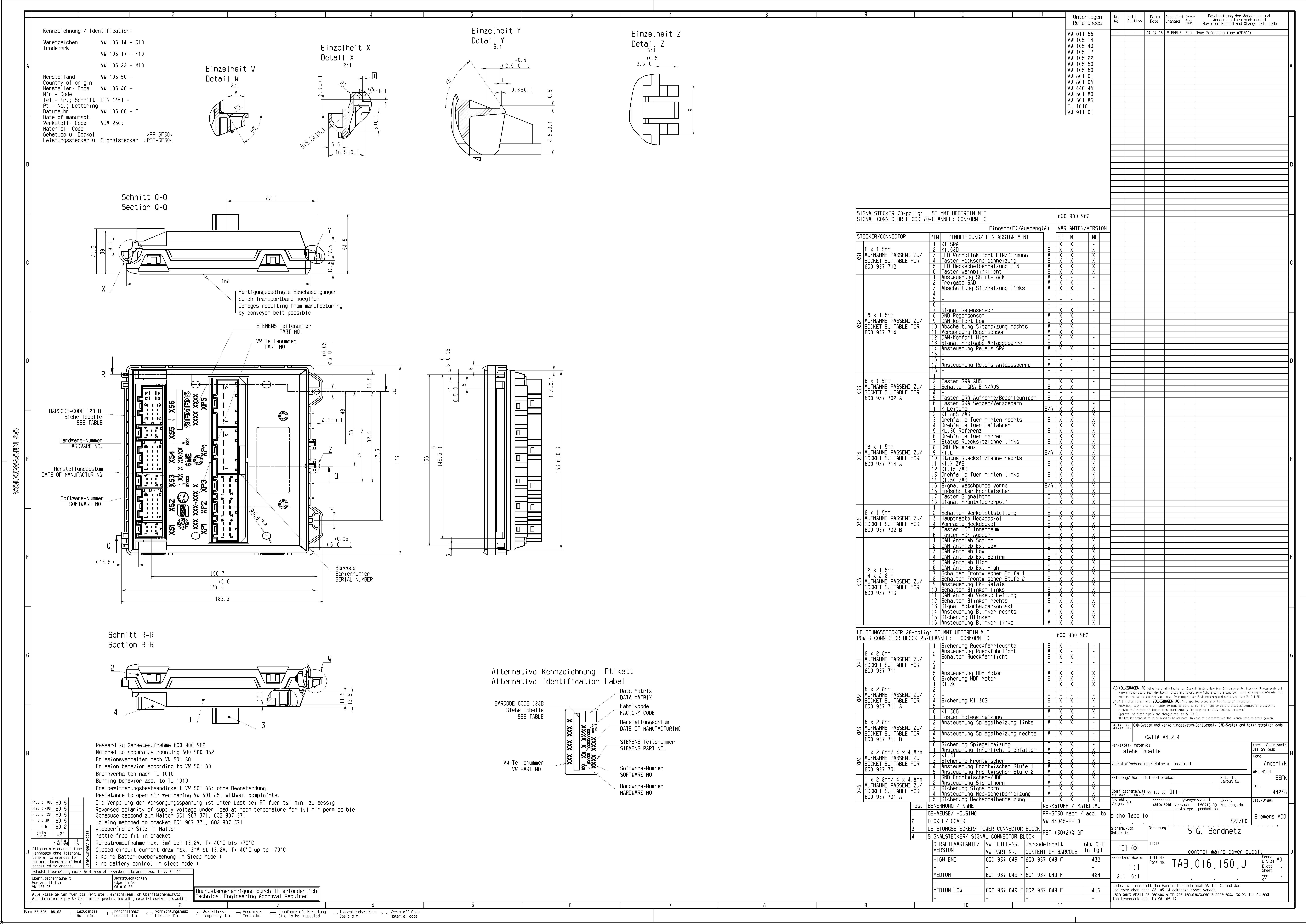

In the BCM you can find the wires needed
Look at this overview
PIN bezetting BCM Polo 9N 9N3.jpg (3.57 MiB) Viewed 18324 times
Maarten
Posts: 557
Location: The Netherlands
Re: Wiring for head unit (double DIN) on 2002 9N
Post by Maarten »
Backup light is rückfährlicht (rueckfahrlicht)
Handbrake might be the Anlasssperre

Thanks, I'll have a look. It should be possible to trace from there.
