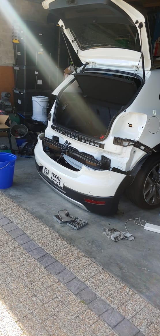

Not sure on front, but rear was easy to remove:
Image 2024-07-03 at 14.51.17.jpeg (100.96 KiB) Viewed 1200 times
Reminds me... still need new bumper stiffener
For this it was tail lights out by lifting flap in boot liner and turning out the big plastic screw.
Then unto all the screws in the wheelwells and underneath, all are visible and accessible. Then pull the bumper off the mounts; they're clipped in.
The mounts are the black items int he photo below the door shut and along the sides.
Headlamps should slide out. Don't see why a recode is needed. Just disconnect battery beforehand if you are concerned.
Not sure on the front bumper removal since I haven't done it yet.
