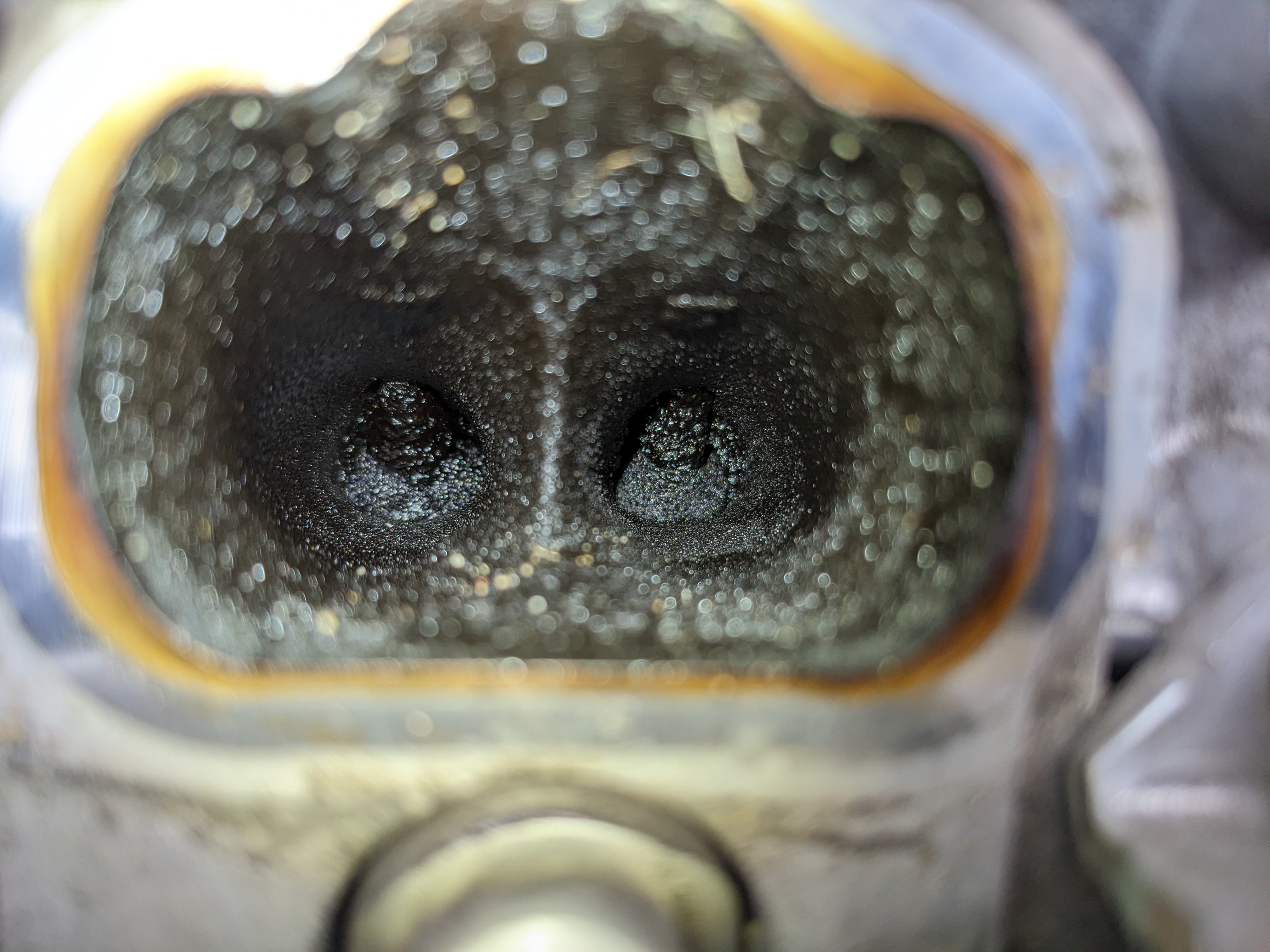

I had the same "issue" when trouble shooting my engine hesition when cold.
I was thinking about a bad temp sensor.
When I saw 106+ degrees I felt so bad. But after few research, it's perfectly normal.

Re: Help needed with 6r cbzb engine 77kw cooling system.
So what ended up being your problem and solution for the slaggish jerky hesitation ?Le_Combattant wrote: Tue Nov 12, 2024 2:54 pm I had the same "issue" when trouble shooting my engine hesition when cold.
This, carbon on the intake ports:
Thanx! How did you end up cleaning it ?Le_Combattant wrote: Sun Dec 01, 2024 2:20 pm This, carbon on the intake ports:
Soda blasting (or similar) in a workshop ? or did you do anything yourself ?
Ice blasting, company service (250 euros).Retali wrote: Thu Dec 05, 2024 9:45 amThanx! How did you end up cleaning it ?Le_Combattant wrote: Sun Dec 01, 2024 2:20 pm This, carbon on the intake ports:
