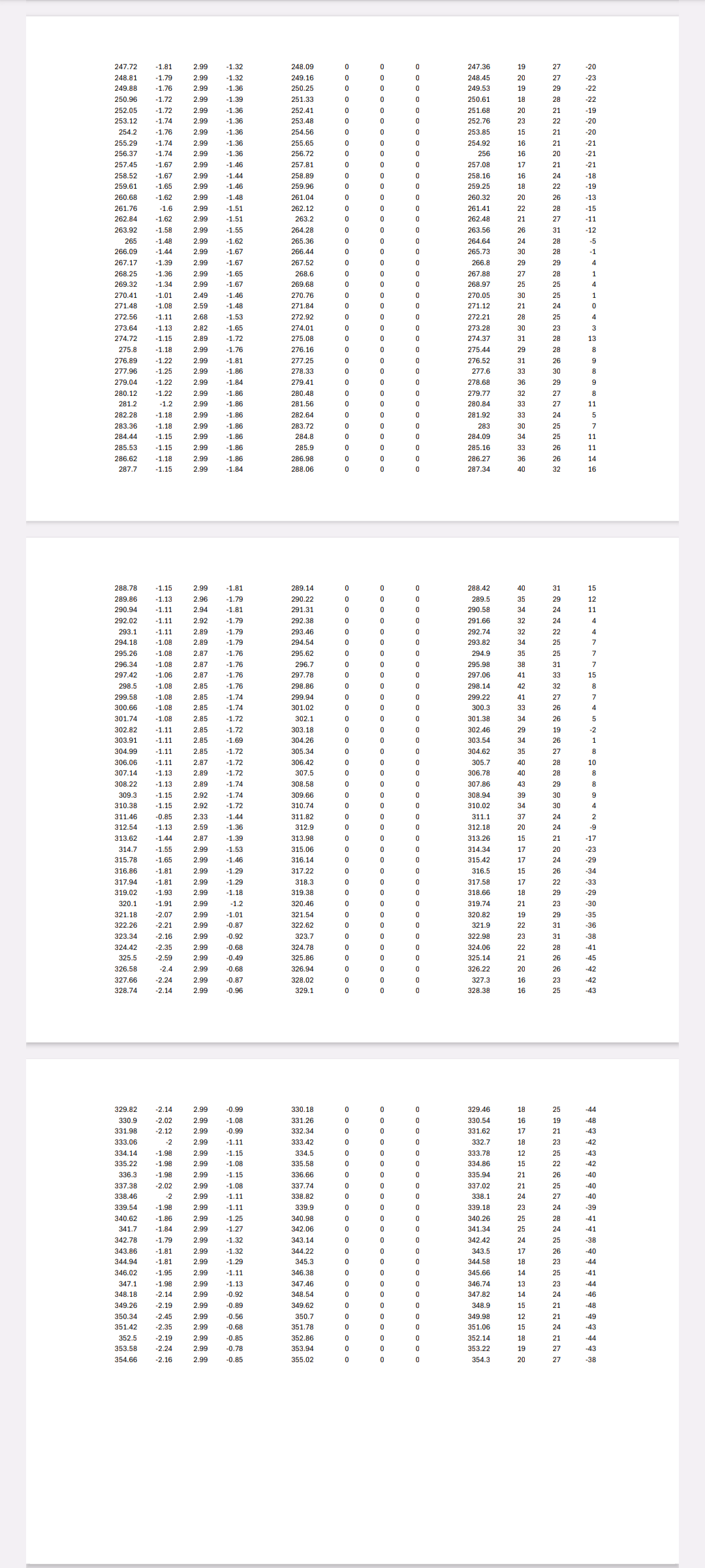

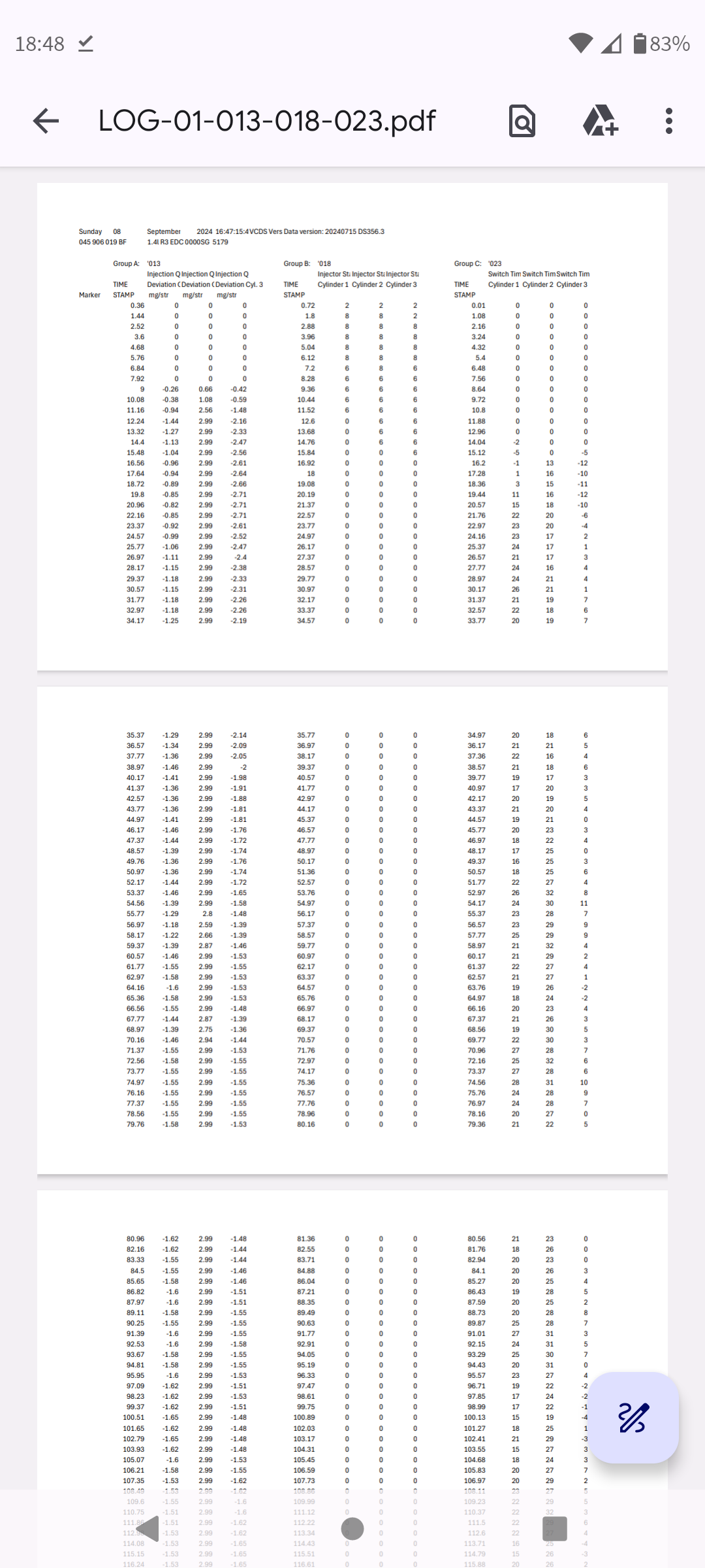

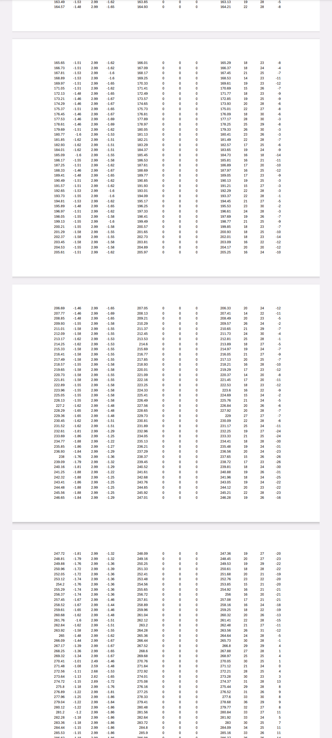

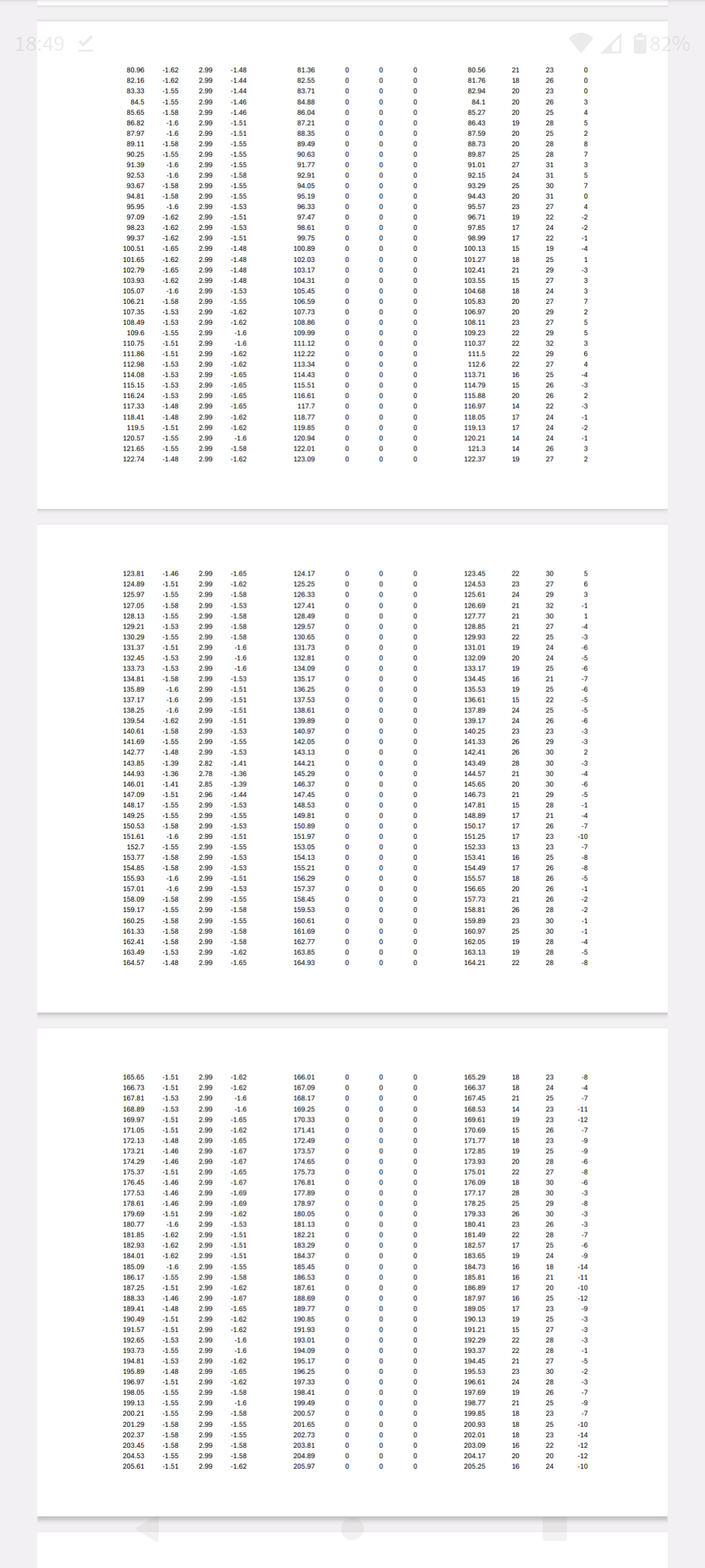

I suspect a failing injector. I've had no MIL light and the only faults I've logged are crank speed sensor, I believe from long cranking without firing. Cleared it did not return. I've just bought VCDS, officially, with a license and everything! Believing it's an injector I've logged blocks 13, 18 and 23. a print is attached.
Anybody got any good ideas, I'm stumped.
