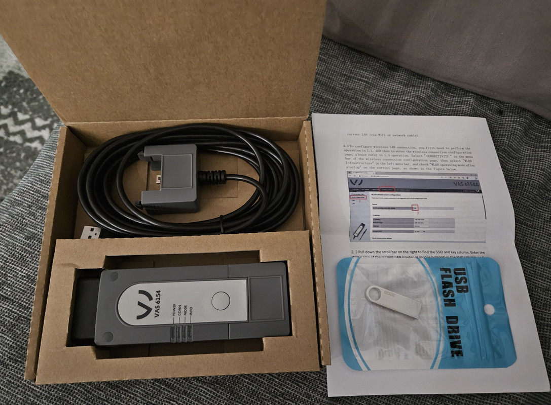

New toy
I haven't tried it yet. On the weekend I will play with it.

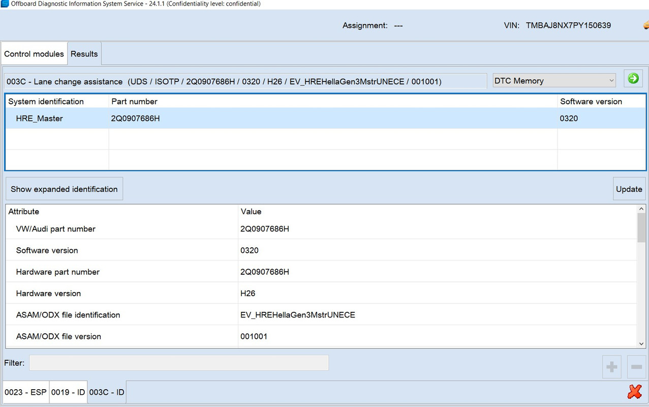

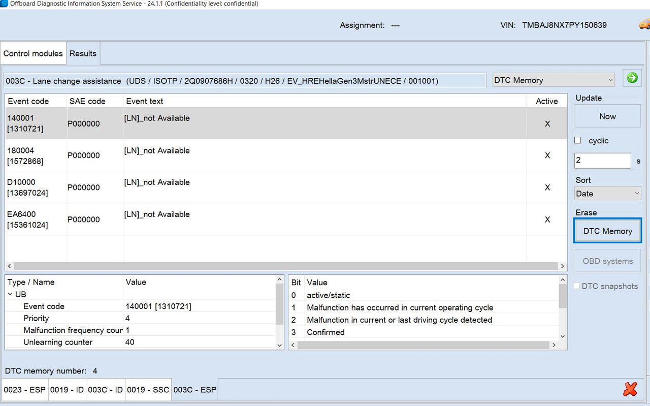

First attempt to view the 03C modules
I used the Self-Diagnosis mode. I couldn't find the 03C so i went to Networking Diagram, found the 03C and then read the DTC
I so the errors, and then i read the module
So i suppose that the Remove CP "line" is at the Diagnosis Mode.

This was excellent information. With the old 5054A I had tried to do a diagnosis and waited for over 10 minutes without success. So I thought that this function would only be successful when there is an Online connection.ciclo wrote: Fri Jan 24, 2025 6:52 pm ODIS S has a progress bar with ongoing and informative activities at the bottom and you must let it finish the reading processes when starting the Diagnosis, it is a bit slow and you must have some patience.
I will try it with the 6154 cable

With the 6154A the job was done in less than a minute (it completed the diagnosis)
Now I feel ready to go to my friend's workshop. I just have to find the time.

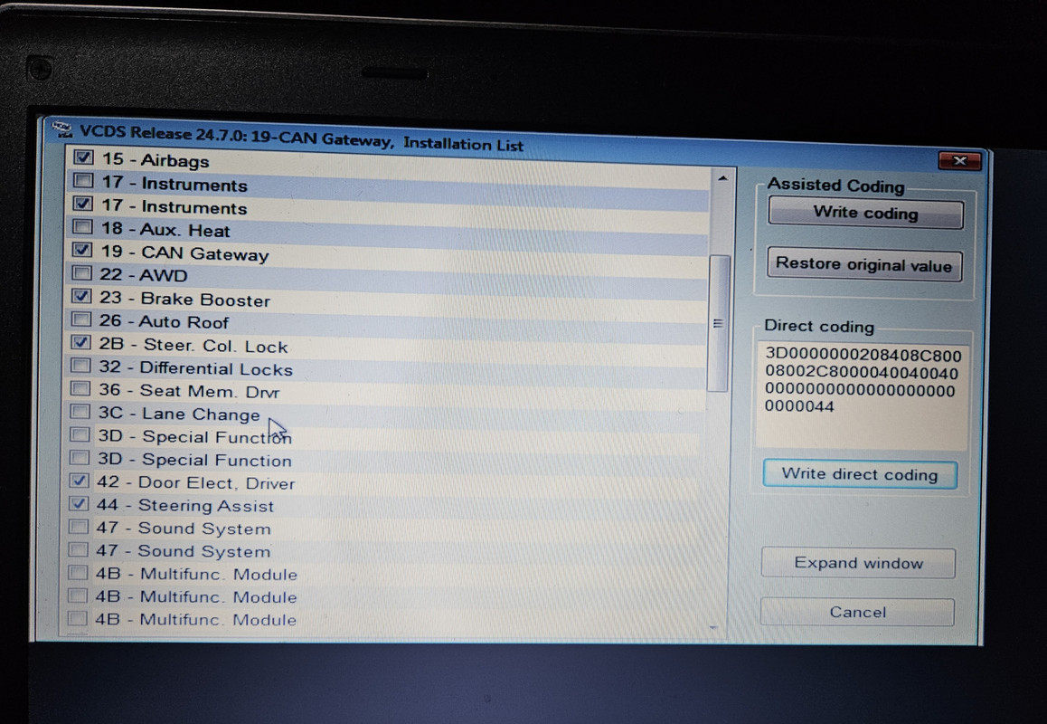

hi,
just a stupid question
How can I register BSD (3C) in my car's installation list using ODIS?
Using VCDS is easy (I'm already testing it and it works even when the radars are still in component protection)
patil
- Posts: 576
Re: Skoda Octavia MK4 2023, 2.0TDi DSG Ambition
Address 19
Coding 06
Coding bus master 06.03
Select address 3c from the list and accept
Coding 06

Well, i have some news.
Υesterday I went to my friend with the online connection to unlock the sensors. But it didn't work.
He has only the ODIS S 24.1.2 version.
At first we went into the sensors and did the procedure to Remove the Component Protection. Unfortunately I don't have any photos of the procedure.
The unlocking procedure seemed to be completing and we got a message that it was completed.
So I told him to try the coding. There it seemed that the procedure could not be completed. I went in with VCDS and declared 03C in 019. It accepted it. We went in again with ODIS and immediately an error appeared in the sensors.
We did the unlocking procedure again, but we got the message that it could not be completed.
After trying again and again, we gave up because I had to leave.
I don't know if we did something wrong. I'll try again in a little while when I find time to go again.
