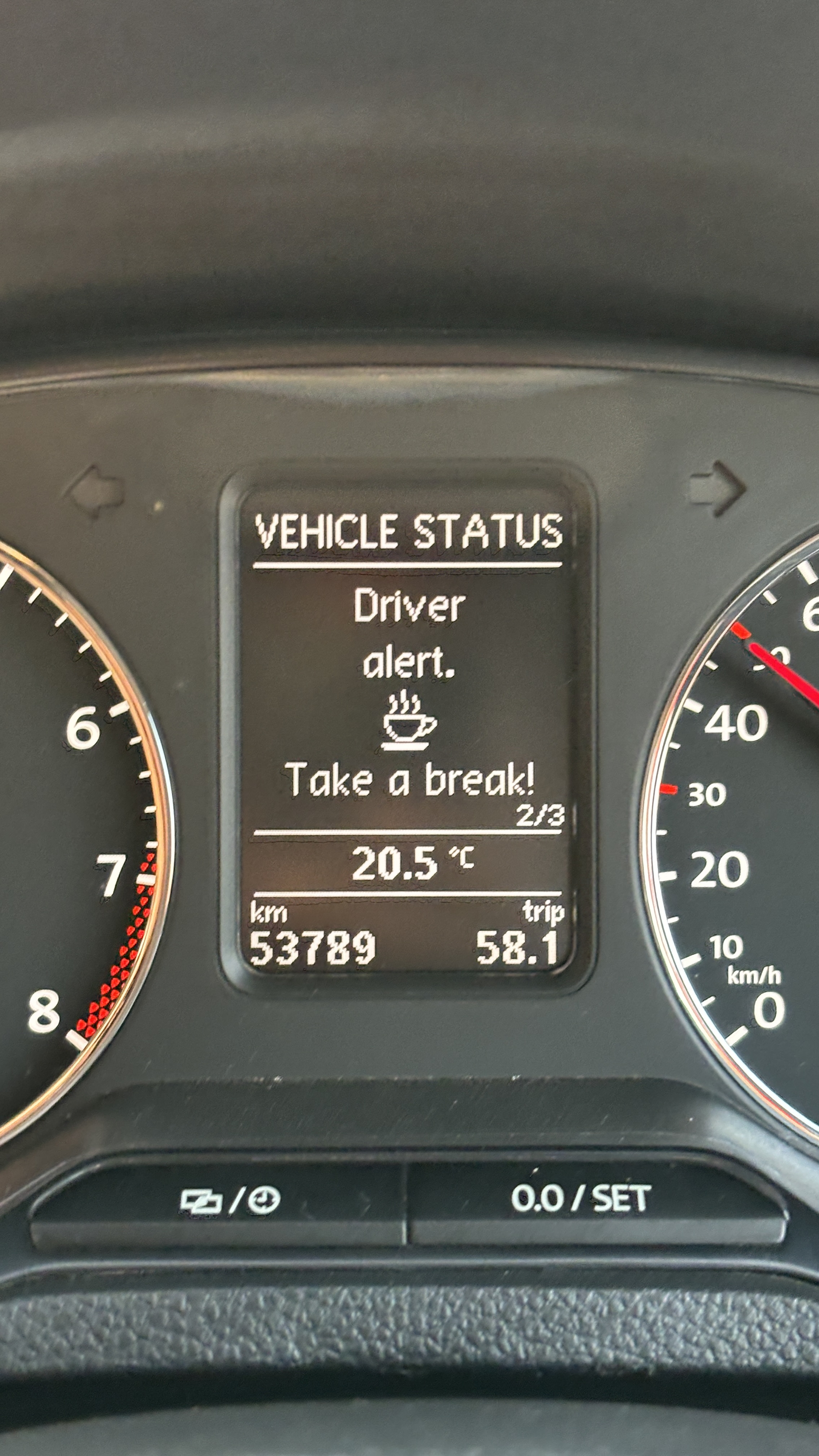

1. MKE Fatigue Detection
With ciclo's method I was able to activate this feature on my car with the help ODIS E. I must stay this is an useful feature while taking road trips.

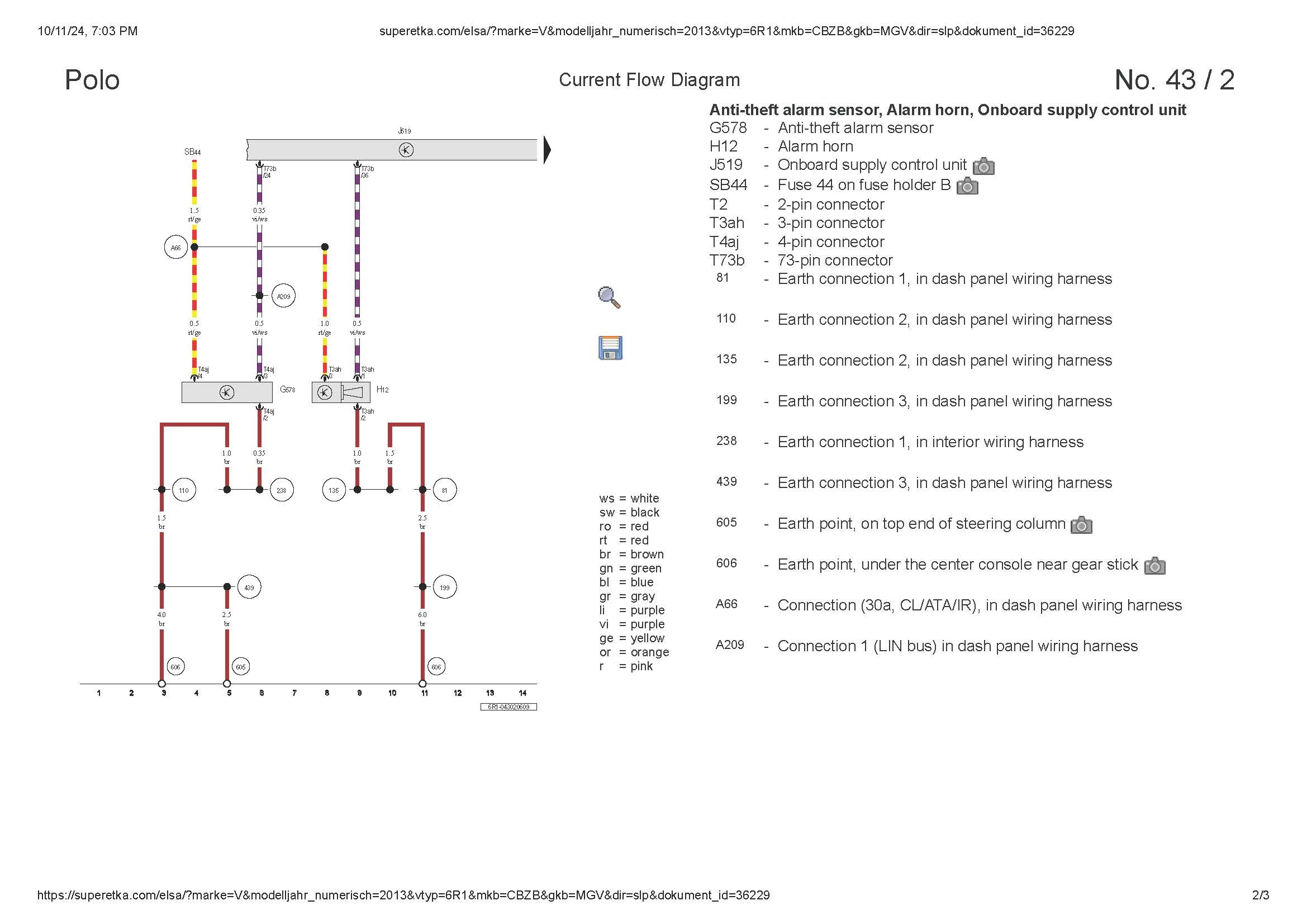

2. Anti theft alarm system on Polo 6R
This anti theft alarm system is present on all polo 6R across the world. It is even present in Polo sold in India before 2014. Post 2014 Volkswagen has removed this feature from Polo 6R(Sold in INDIA) for cost cutting reasons.
Anyways I recently was able to source the necessary parts from the used market.

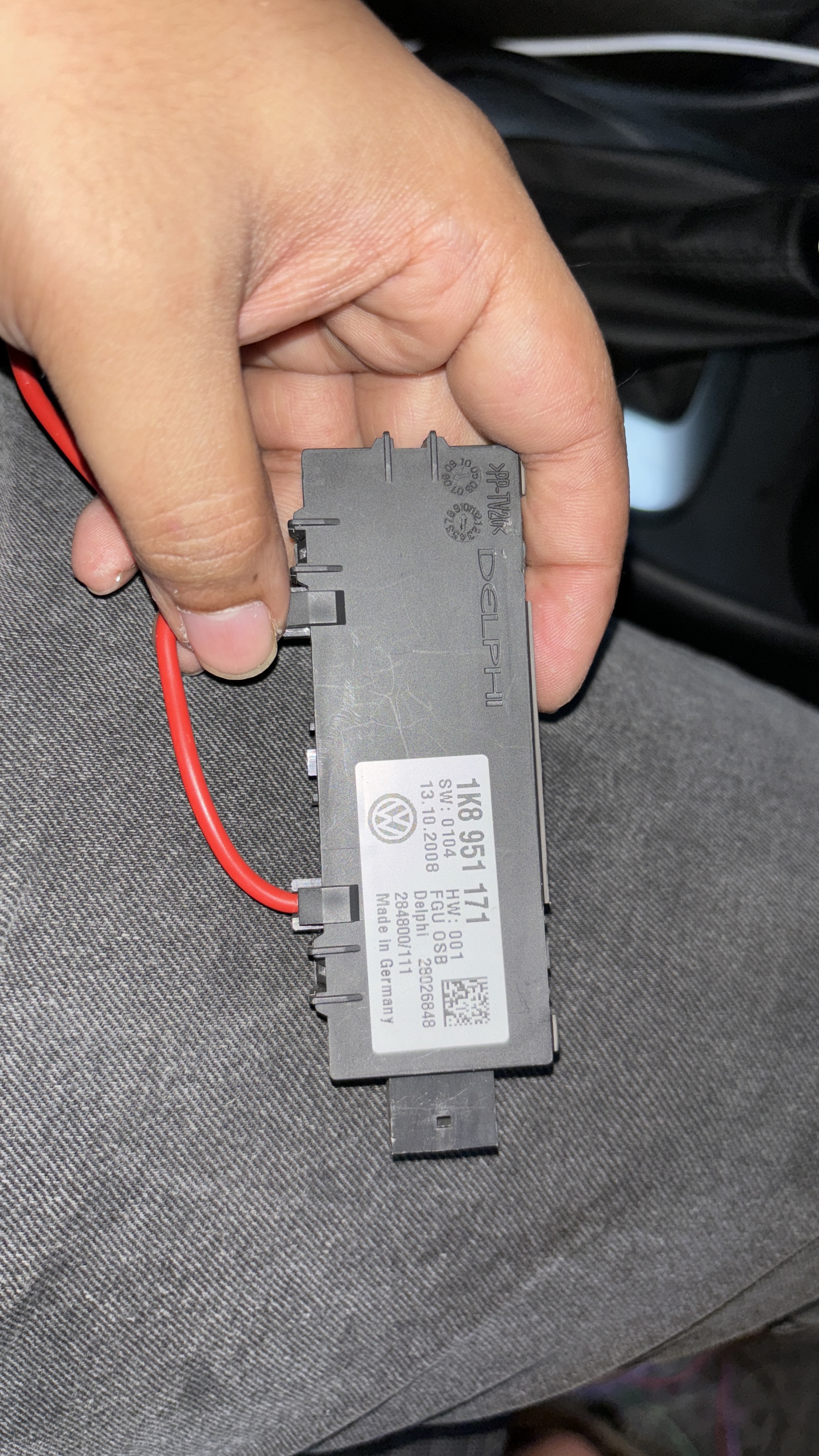

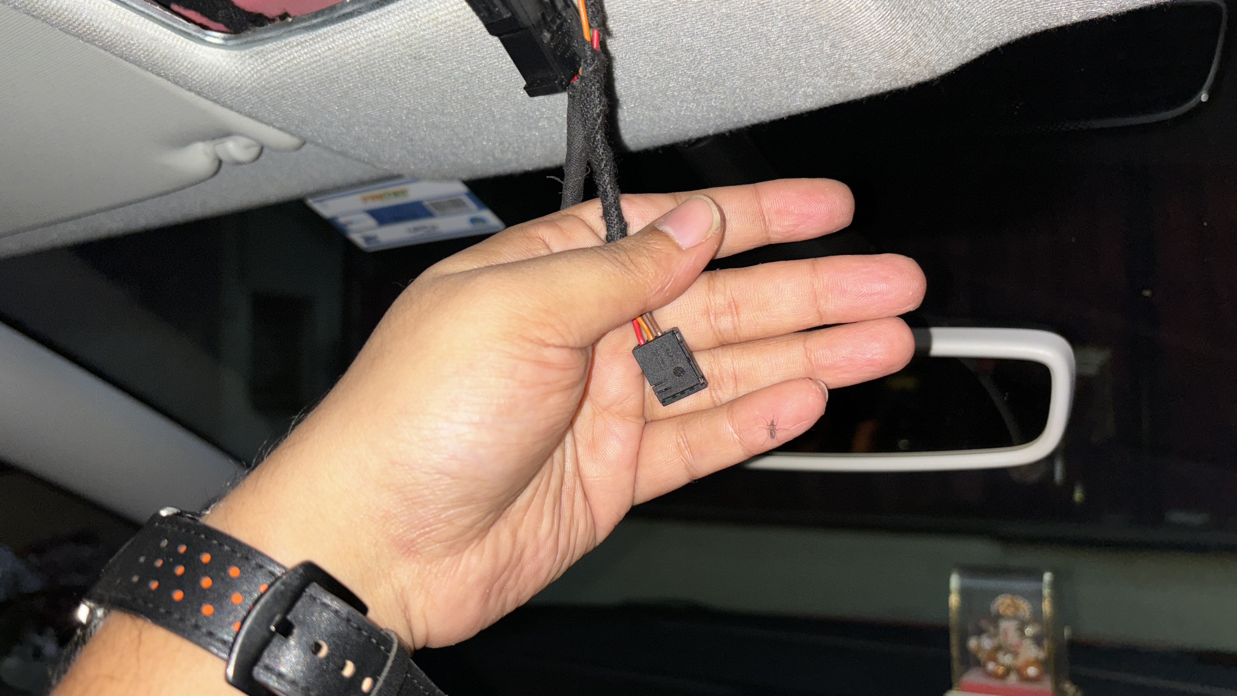

Inclination and Interior Monitoring Sensor. Part No: 1K8 951 171
Part No: 6Q0 962 109B
Connector for the sensor: 8E0 971 832
Connector for the switch:8k0 973 754

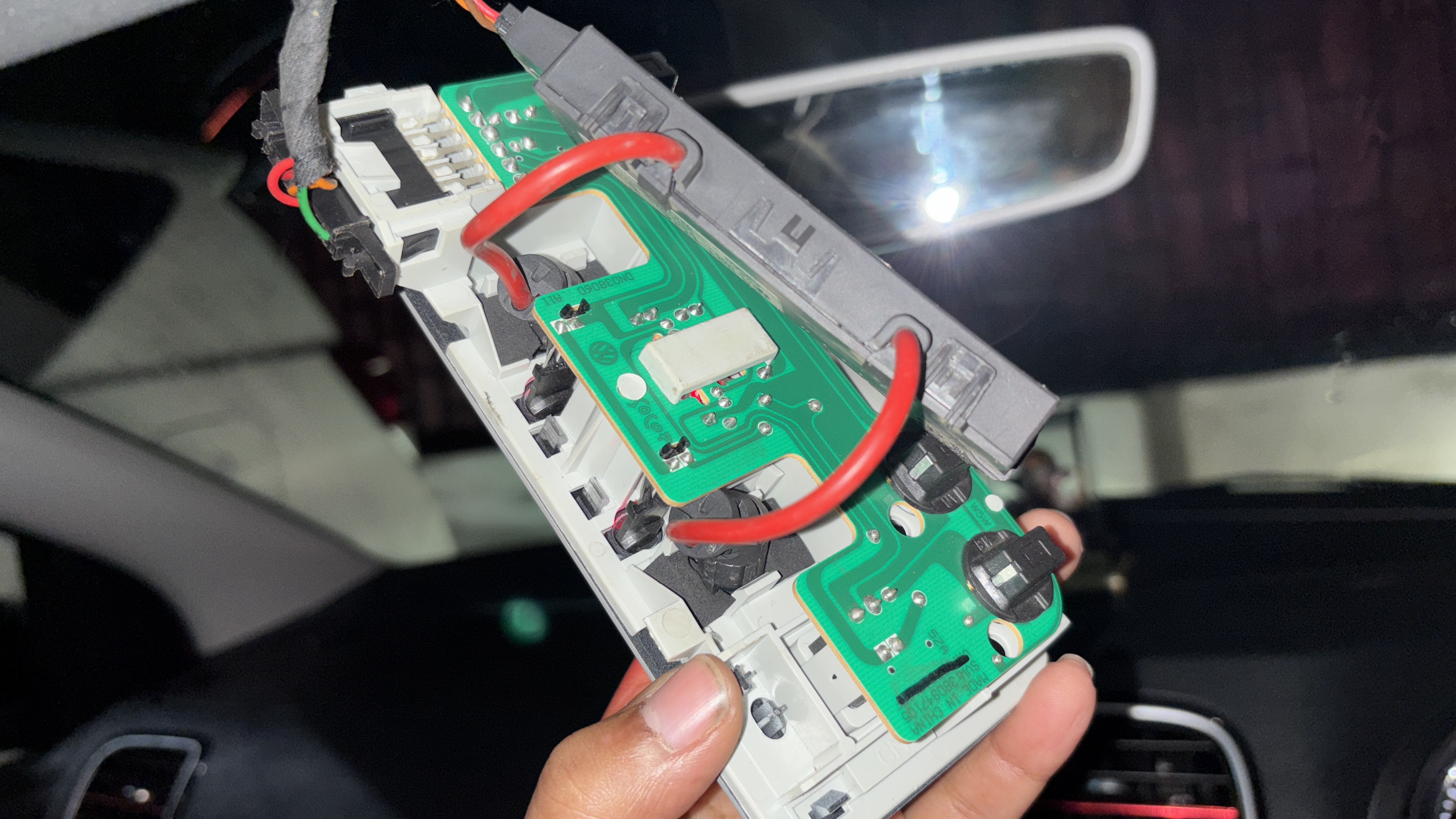

Since Polo sold in India does not have the bracket into the headliner, we have to insert the sensors in Cabin Light in the place where Bluetooth Mic are suppose to be installed.
superetka.com_elsa__marke=V&modelljahr_numerisch=2013&vtyp=6R1&mkb=CBZB&gkb=MGV&dir=slp&dokument_id=36229_Page_3.jpg
superetka.com_elsa__marke=V&modelljahr_numerisch=2013&vtyp=6R1&mkb=CBZB&gkb=MGV&dir=slp&dokument_id=36229_Page_3.jpg (186.63 KiB) Viewed 3534 times
superetka.com_elsa__marke=V&modelljahr_numerisch=2013&vtyp=6R1&mkb=CBZB&gkb=MGV&dir=slp&dokument_id=36229_Page_2.jpg
superetka.com_elsa__marke=V&modelljahr_numerisch=2013&vtyp=6R1&mkb=CBZB&gkb=MGV&dir=slp&dokument_id=36229_Page_2.jpg (207.21 KiB) Viewed 3534 times

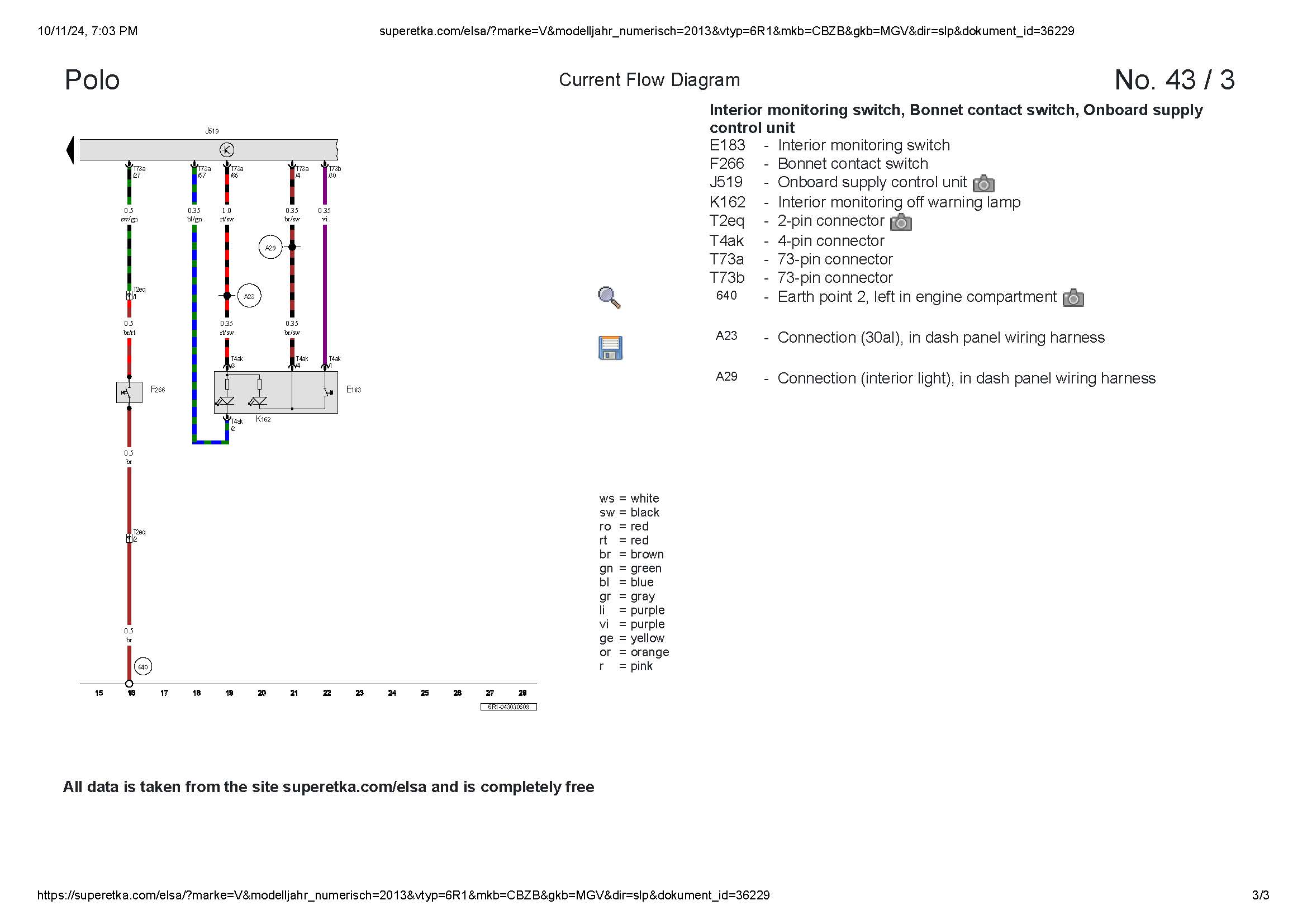

Wiring Diagrams for the above Retrofit

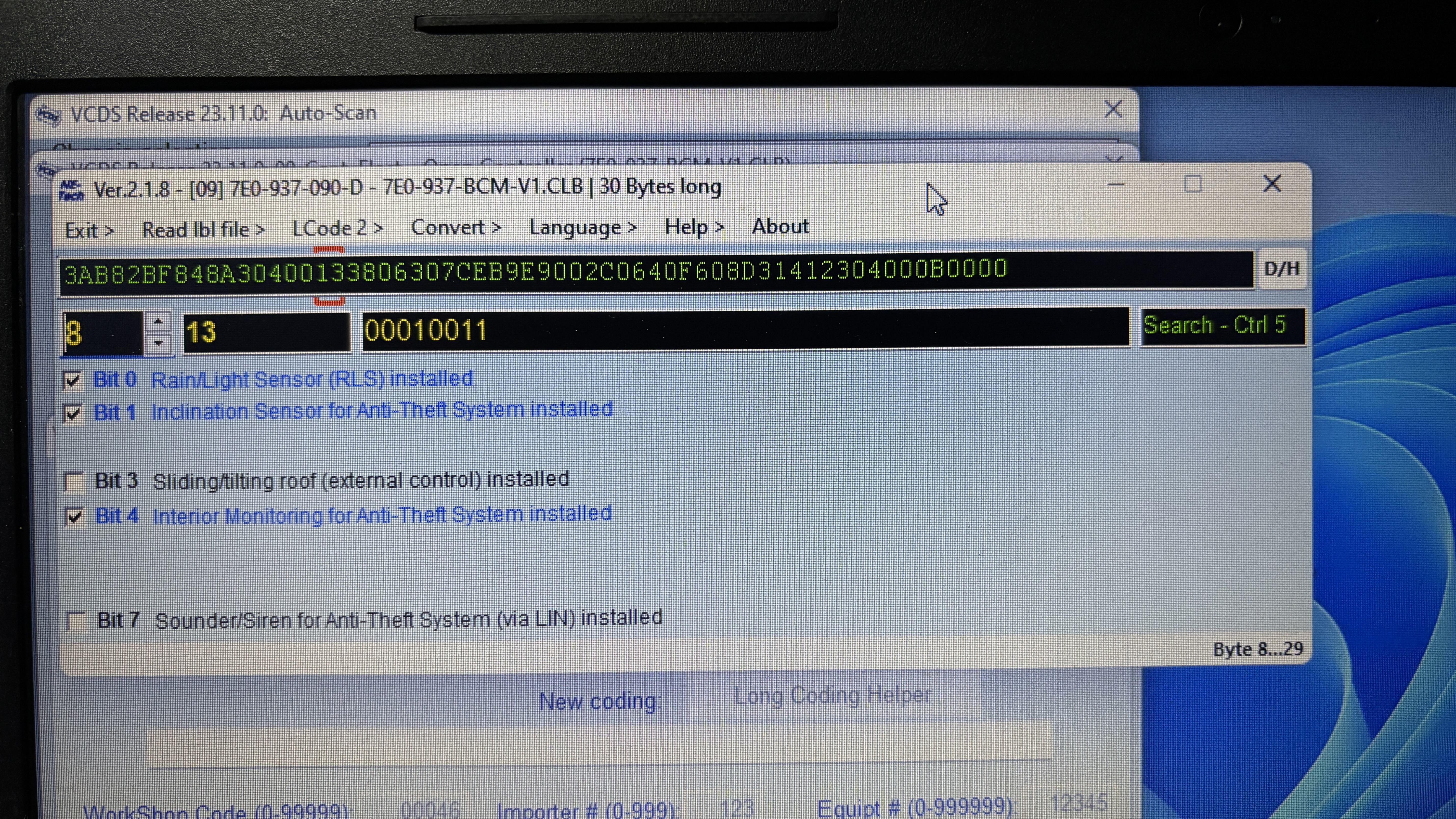

Coding and Adaptations:
Central Electronics 09
Long Coding
Byte 8 - Bit 1 - Inclination Sensor for Anti theft System Installed
Bit 4 - Interior Monitoring for Anti theft system installed
Yet to install the Anti theft alarm on my car. But this sensor works without the anti theft alarm too. It would activate the alarm in two situations. One if there is a movement inside the car after you have locked the car and the second if someone is trying to lift your car on jack. Obviously there is a way to disable it with the help of the switch.

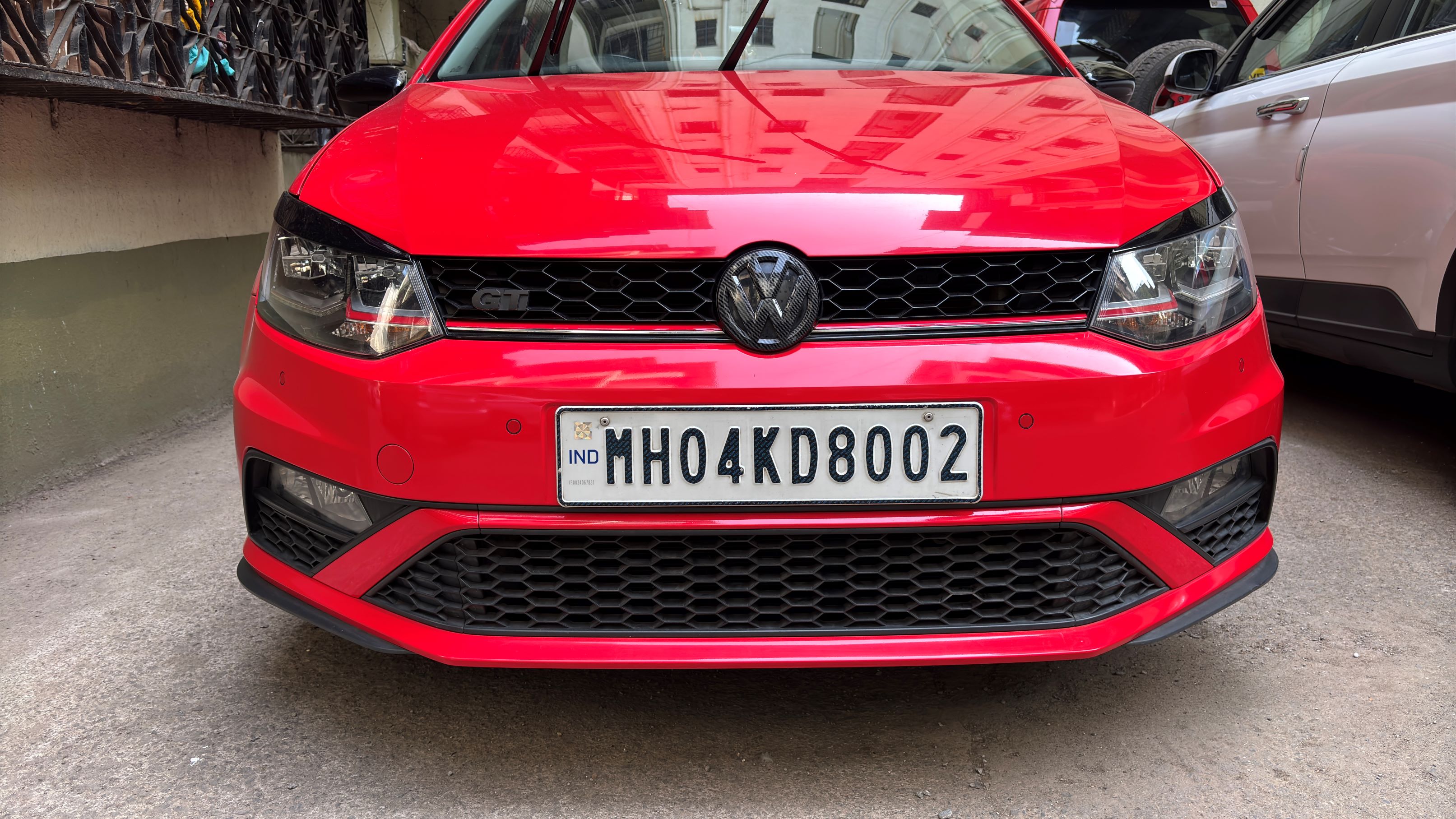

1. 8K OPS Auto Detect
Finally decided to go with this retrofit considering the traffic conditions in Mumbai(place where I live). Simple installation but the only problem I faced was flashing the modules to proper SW along with a proper dataset, as I don't have access to VCP. Only VCDS and ODIS are present with me.

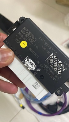

Parts/Tools required:
1. 1KD 919 472A/5Q0 919 294L.
2. PDC Button.
3. Front Sensors with seals and brackets.
4. OEM BEA000001 Tool for Cutting Out the Holes for PDC
5. VCDS/ODIS
6. Wiring Harness
7. Front Buzzer

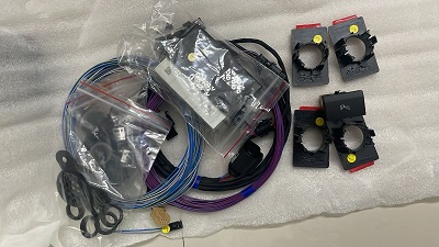

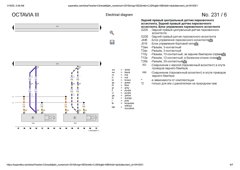

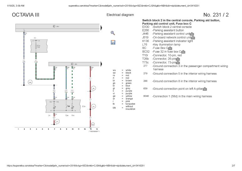

1KD 919 472A
Wiring harness with Parking sensors, seals, brackets and PDC Button

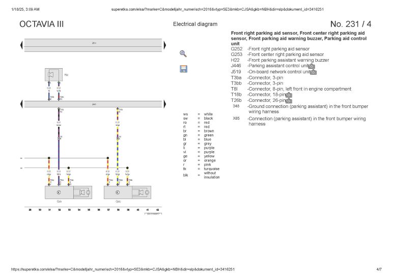

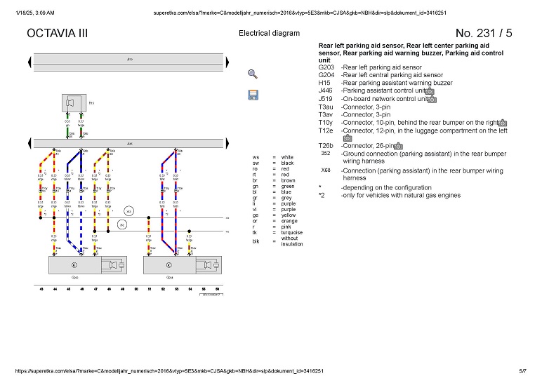

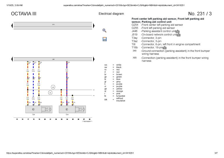

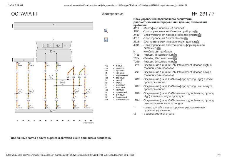

Wiring Diagram
8K Ops Auto Detect for Polo 6R_Page_2.jpg (43.74 KiB) Viewed 3129 times
8K Ops Auto Detect for Polo 6R_Page_3.jpg (43.5 KiB) Viewed 3129 times
8K Ops Auto Detect for Polo 6R_Page_4.jpg (42.68 KiB) Viewed 3129 times
8K Ops Auto Detect for Polo 6R_Page_5.jpg (91.17 KiB) Viewed 3129 times
8K Ops Auto Detect for Polo 6R_Page_6.jpg (88.04 KiB) Viewed 3129 times
8K Ops Auto Detect for Polo 6R_Page_7.jpg (111.44 KiB) Viewed 3129 times

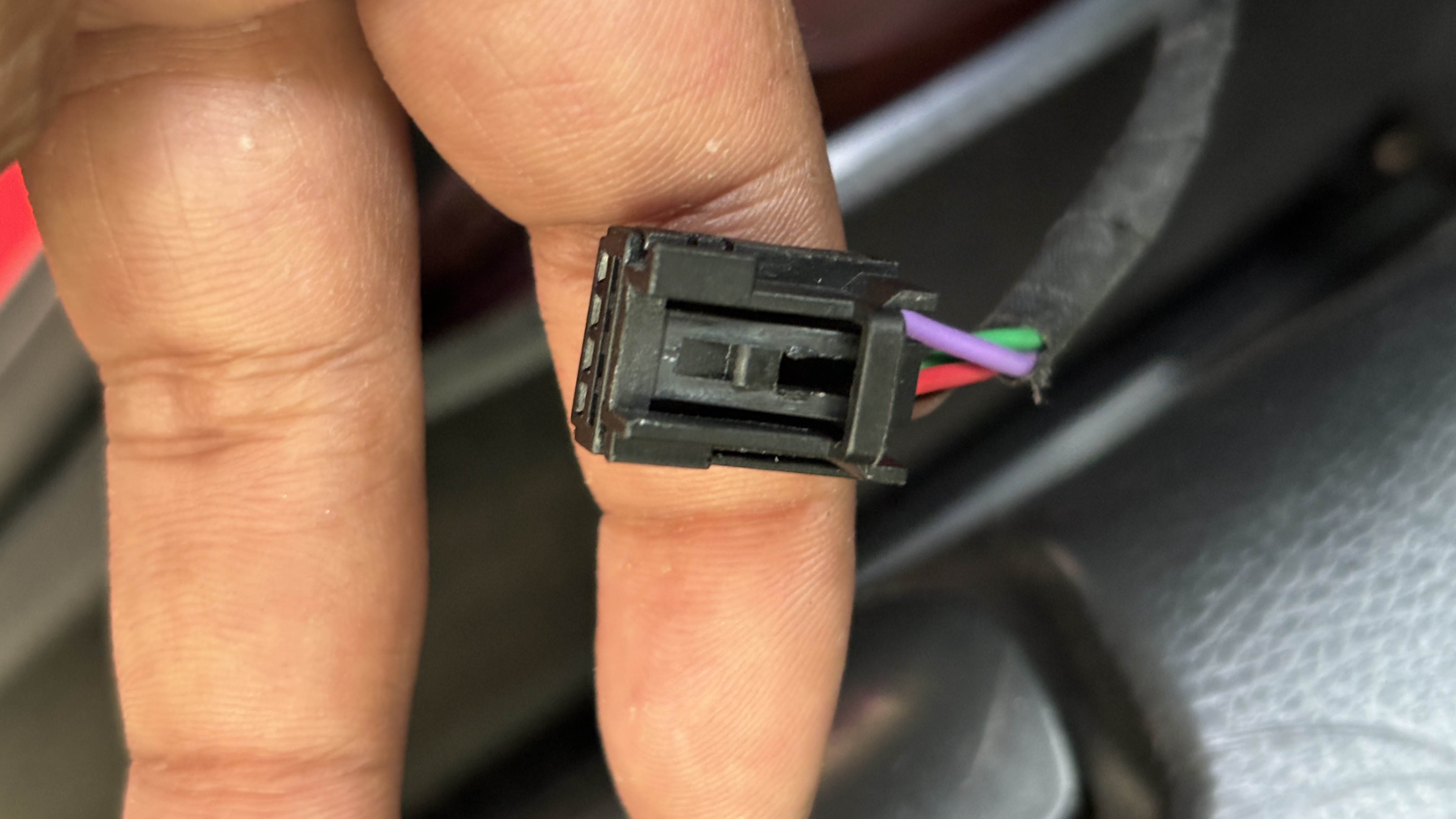

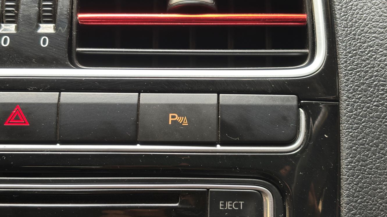

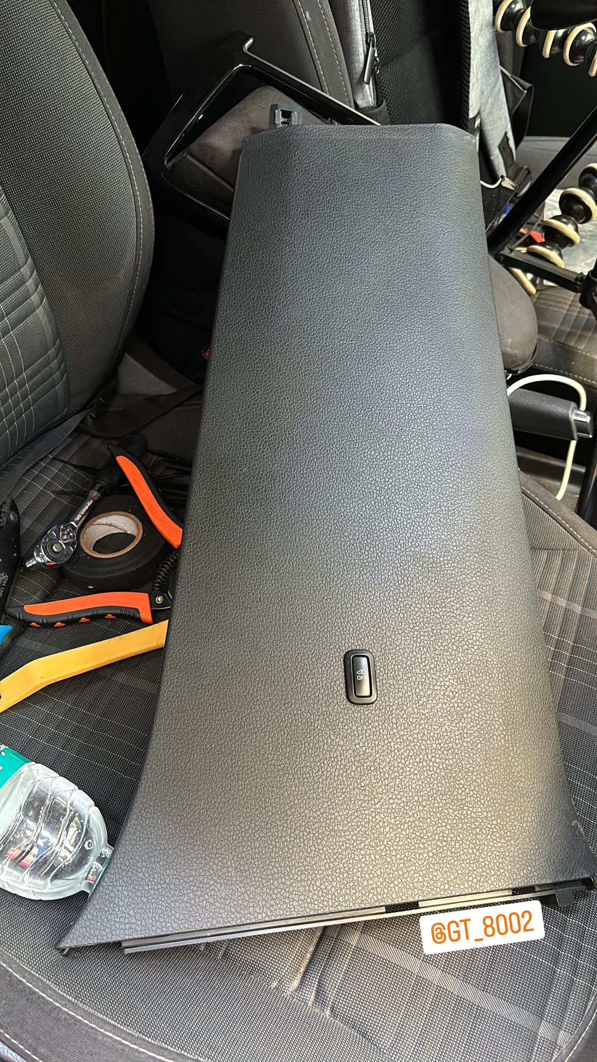

PDC Button
To install this remove the head unit, hvac, and unscrew 6 screws, pull the frame out and than you will be able to remove the center ac trim

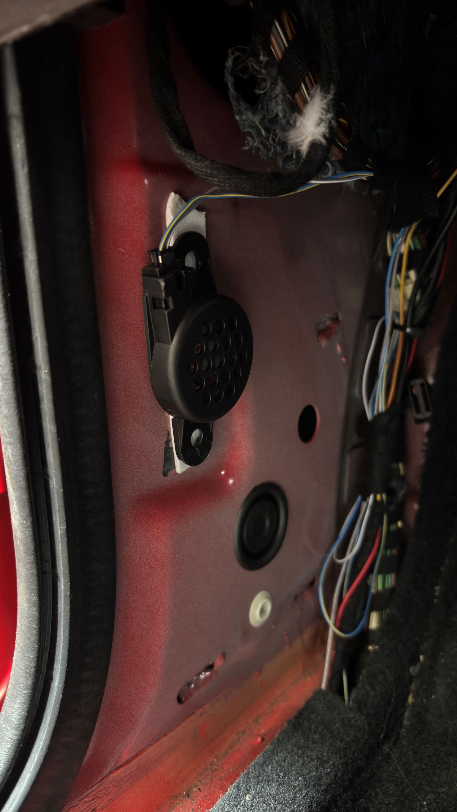

Front Buzzer Placement

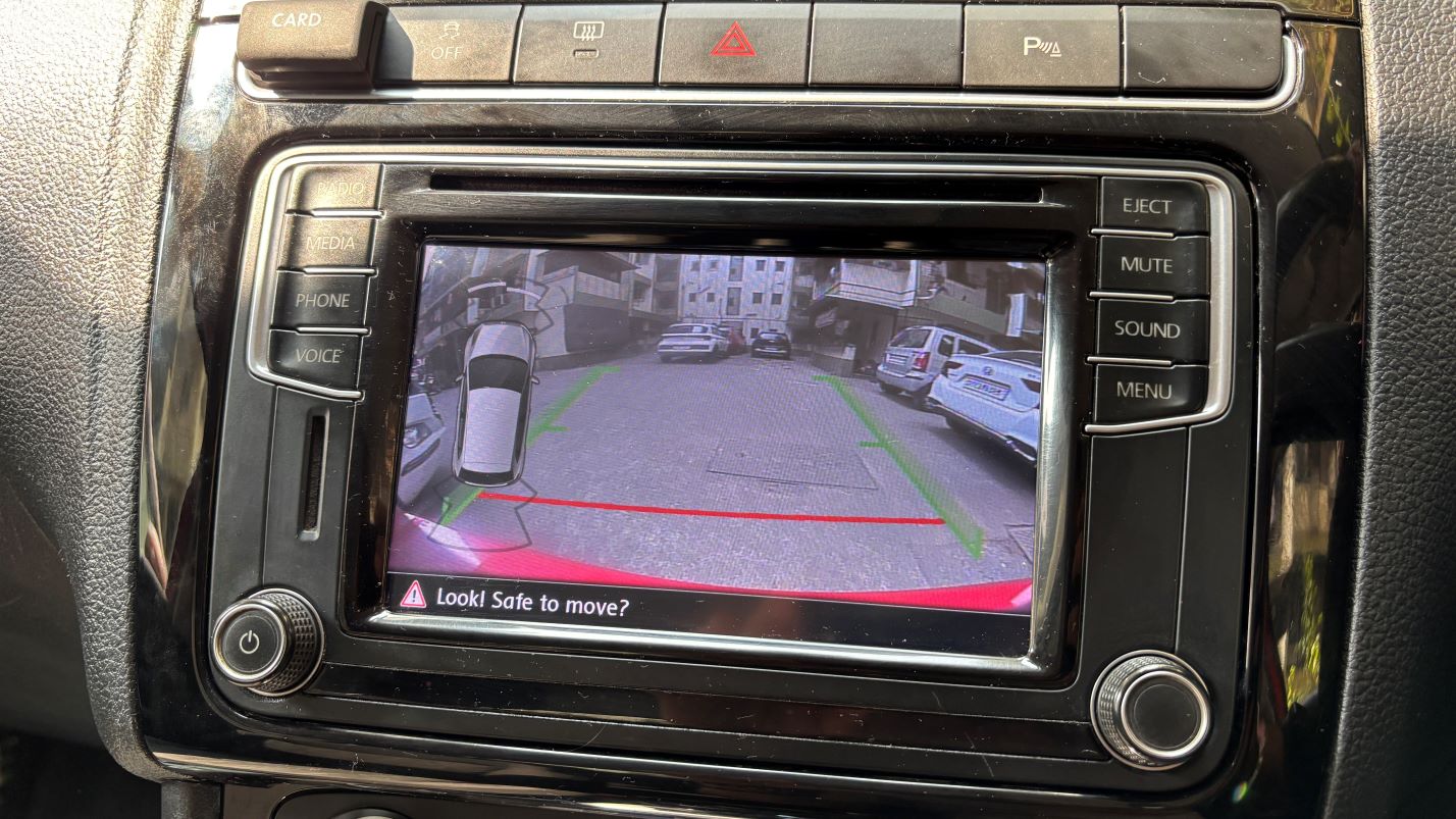

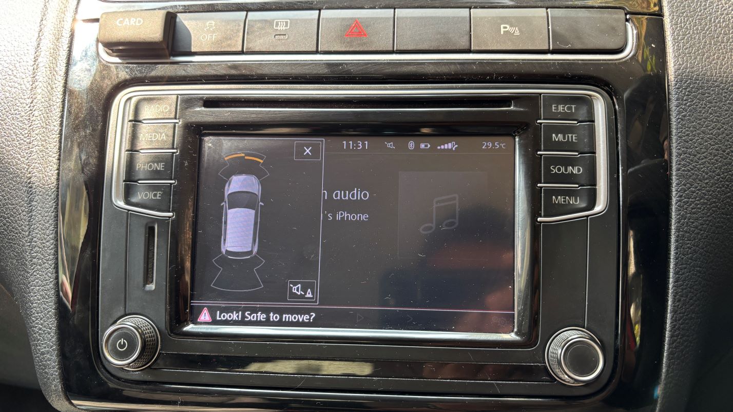

End Results:
Note: Auto Detect function works under the speeds of 15kmph
