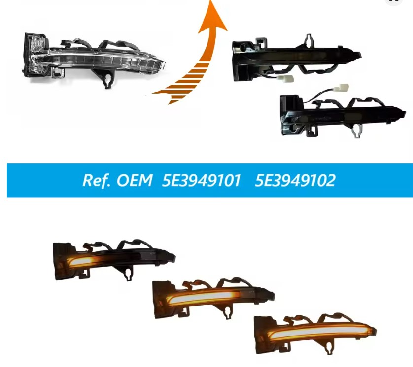

I've been looking for dynamic turn signals on the mirrors for a long time. I've installed them on my Polo and I'm very happy with them.
The day before yesterday I discovered this (finally) and I couldn't resist, I ordered them today.
https://www.aliexpress.com/item/1005008 ... ry_from%3A
I hope they are of good quality and fit properly.
Posts: 8908
Re: Skoda Octavia MK4 2023, 2.0TDi DSG Ambition
Curiously these dynamic turn signals are especially effective and striking at roundabouts, often preventing other drivers intending to enter the roundabout from doing so while you are driving through it.
IMHO, the worse the headlight turn signals are, the more advisable it is to install them.
