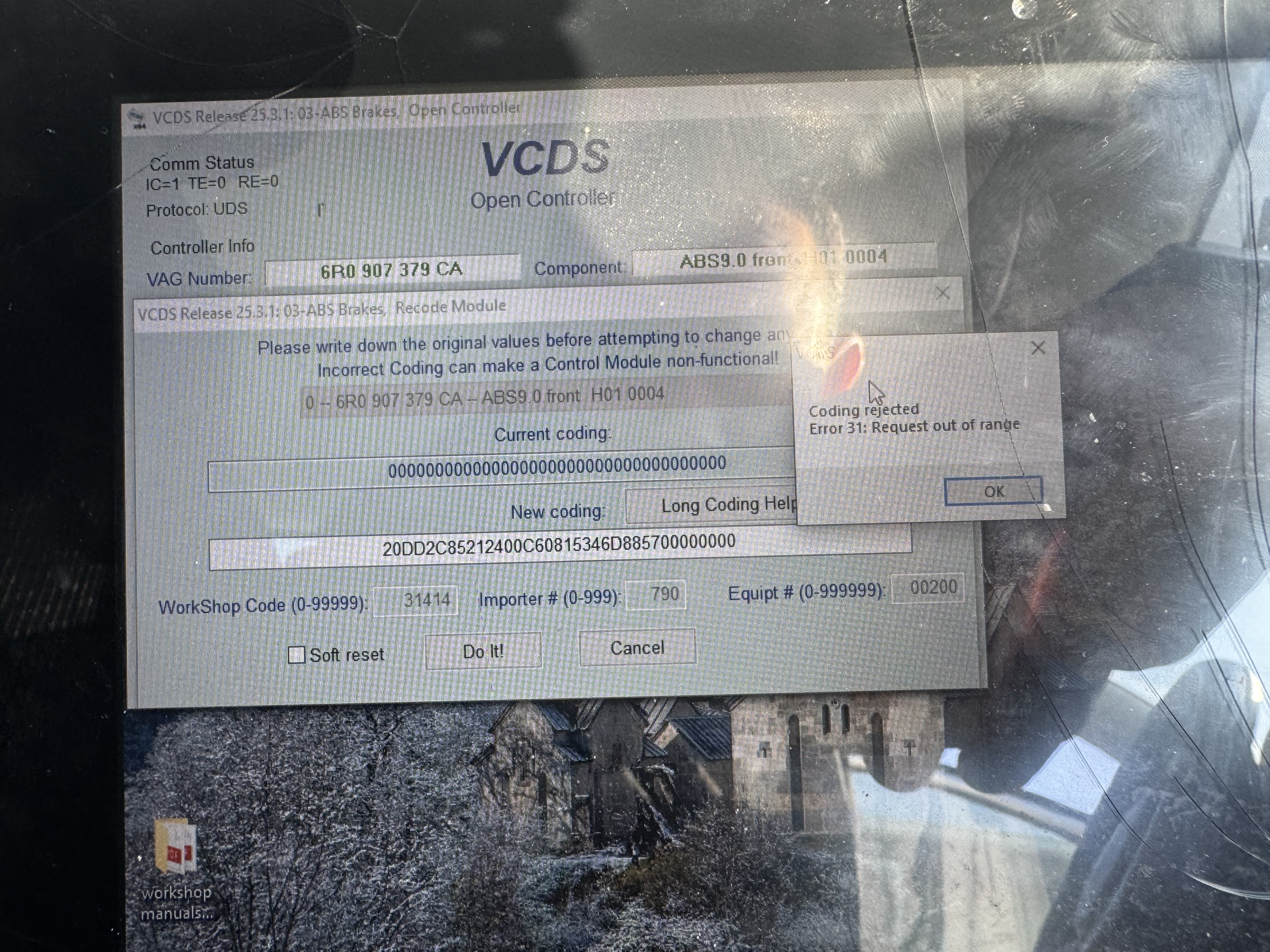

I was hoping someone could assist with calculating the long code using my vin so the abs pump can accept.

20DD2C85212400C60415346D885700000000

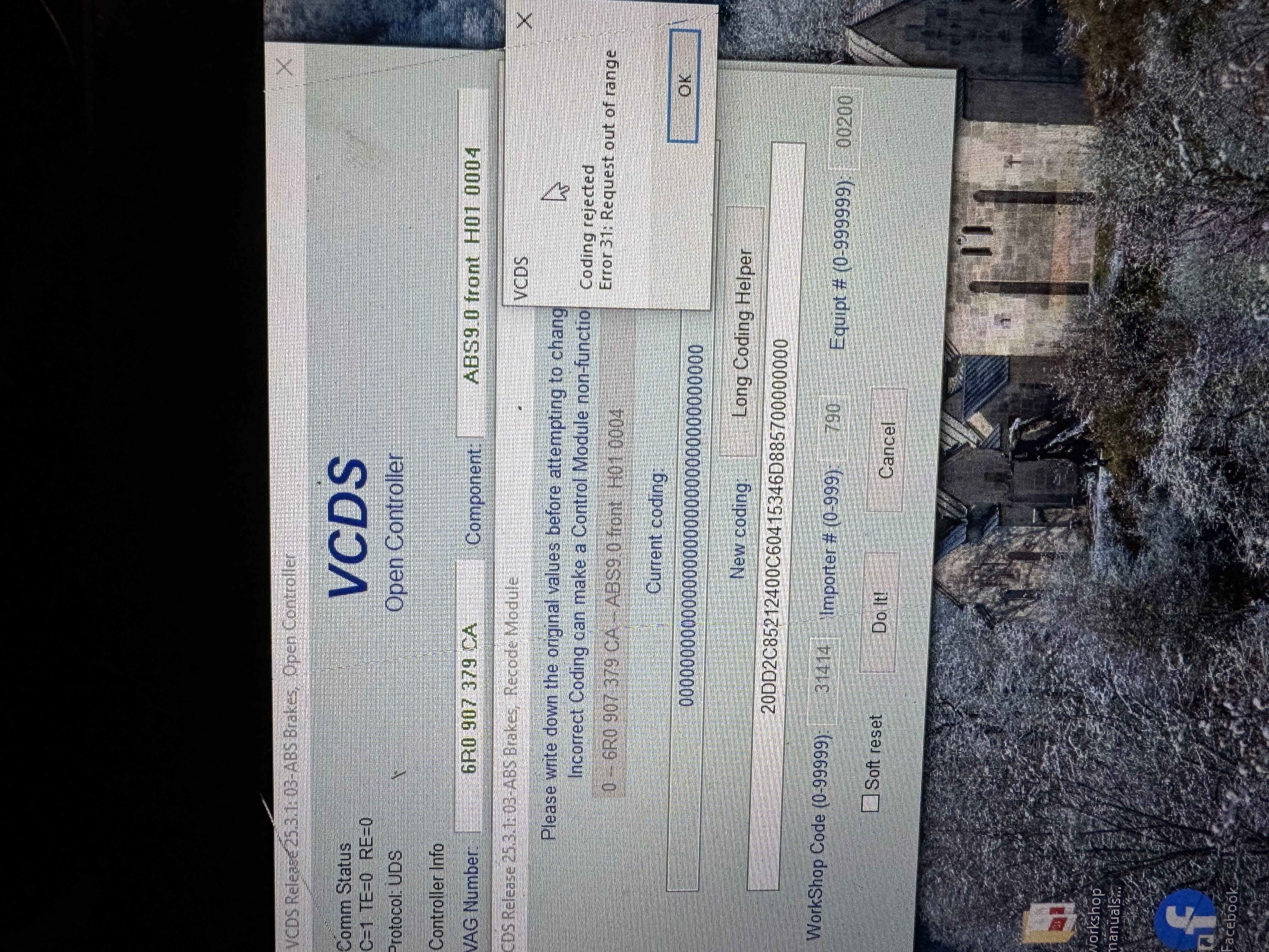

Post by 747aqw »
Getting the same error will attach screen shot now
Re: Polo 6R ABS CODING
If you have a legitimate VCDS, you could try the ross tech forum.
20DD2C85212400C60815346D885700000000
This long coding should work "based on the data provided", I don't know why the previous long coding I posted had a different/wrong Byte.🤷‍♂️ :) (sorry)

No success 🫣😵‍💫
Posts: 8982
So there's something beyond my control.🤷‍♂️
Does the equipment of that POLO Vivo include TPMS?
Coding must be done with IGN ON / ENG OFF.

Posts: 8982
Thanks, Michel.
As expected, ...my latest Long Coding is the only one I can set with the info provided for ABS non-ESP.🤷‍♂️
These ABS modules have their mystery...
747aqw
Posts: 10
Joined: Tue May 20, 2025 11:50 am
Drives: VW Polo Vivo 1.4 2022
Location: Cape Town
Post by 747aqw »
I am coding with engine off
Ignition on.
Posts: 8982
If you're able to get it to accept a new coding with VCDS via Ross-tech or with ODIS via a VW dealer, please let us know the results/coding, this will benefit other users in the future. Thank you.
prtvrk
Posts: 24
Joined: Wed Jun 01, 2022 8:52 pm
Drives: 6C
Location: Estonia
Post by prtvrk »
Non OE vcds? Use a proper loader.
747aqw
Posts: 10
Location: Cape Town
Post by 747aqw »
I am using a OE Vcds loader yes however I'm going to try odis online tomorrow then will give update
